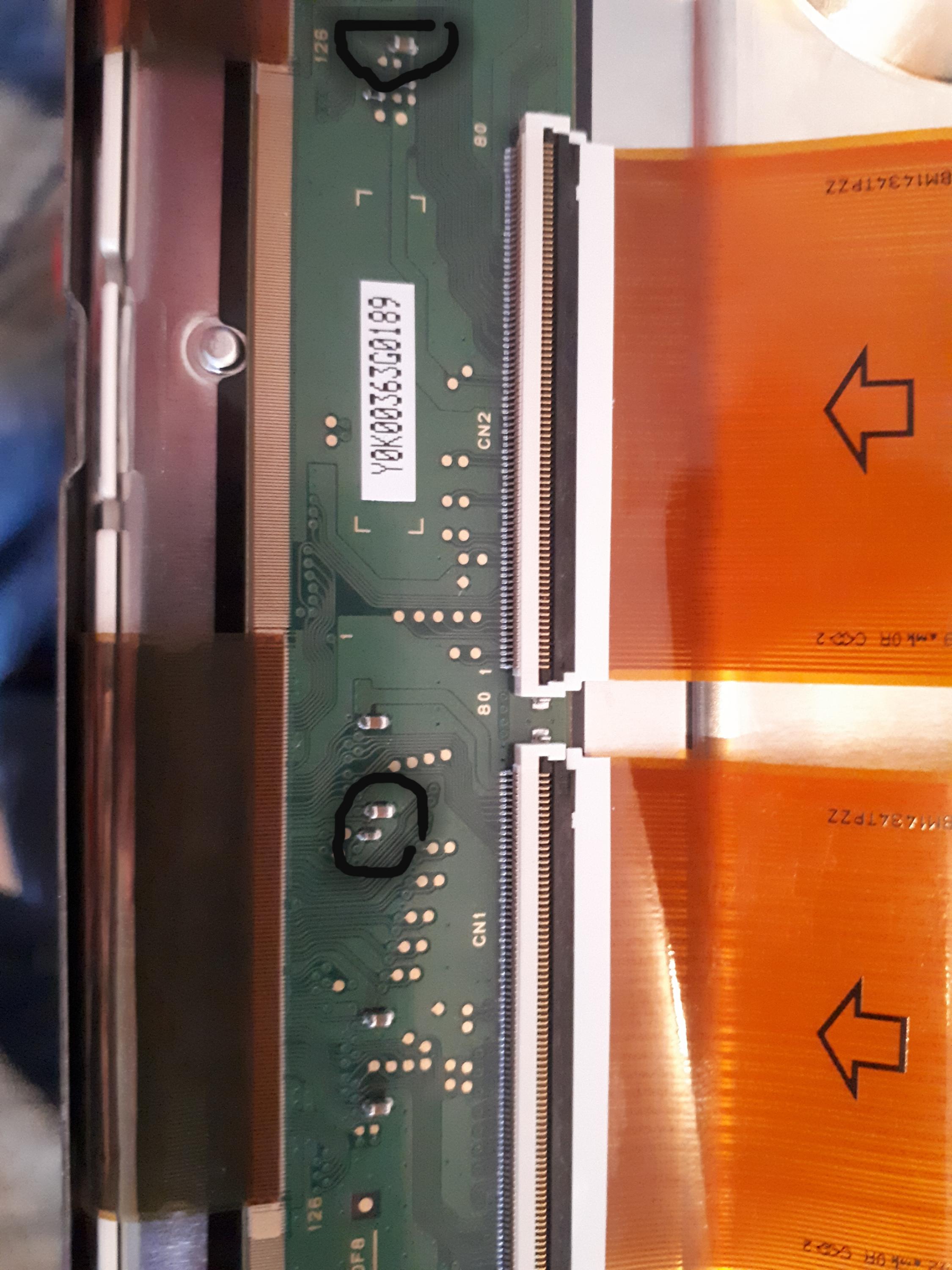

              Hi everyone been testing the caps on the board between lcd and tcon board at 200k all measure around 200k almost but 2 of them that are close to the ribbon cable near tcon only measuring 2.2k the small one i circled on the right and the one circled on the left. Weird thing is that when i disconnect the ribbons coming from the tcon there values start going up to 200k like the others. What can be the problem?

                Re: Can i test MLCC caps with multimeter?
                All that means is there are other components on the t-con that are in parallel with those caps. this is common.
                You ask: "What can be the problem?" maybe tell US what the unit is and the problem you are trying to repair.

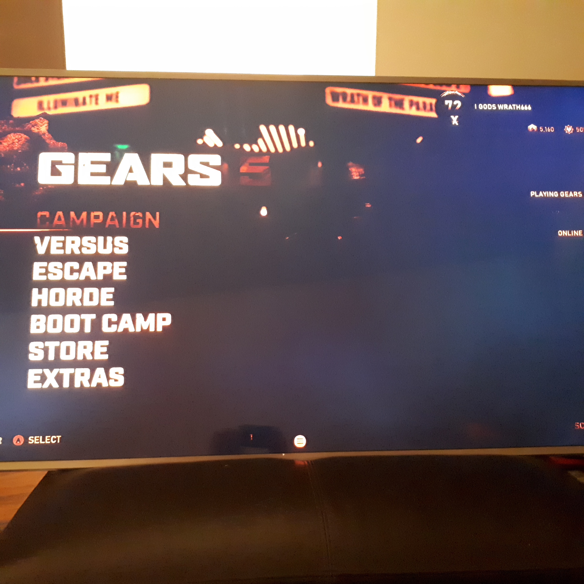

                    Its a samsung un60f7100 this is what my screen looks like when hooked up to hdmi every thing is red and laggy faded
