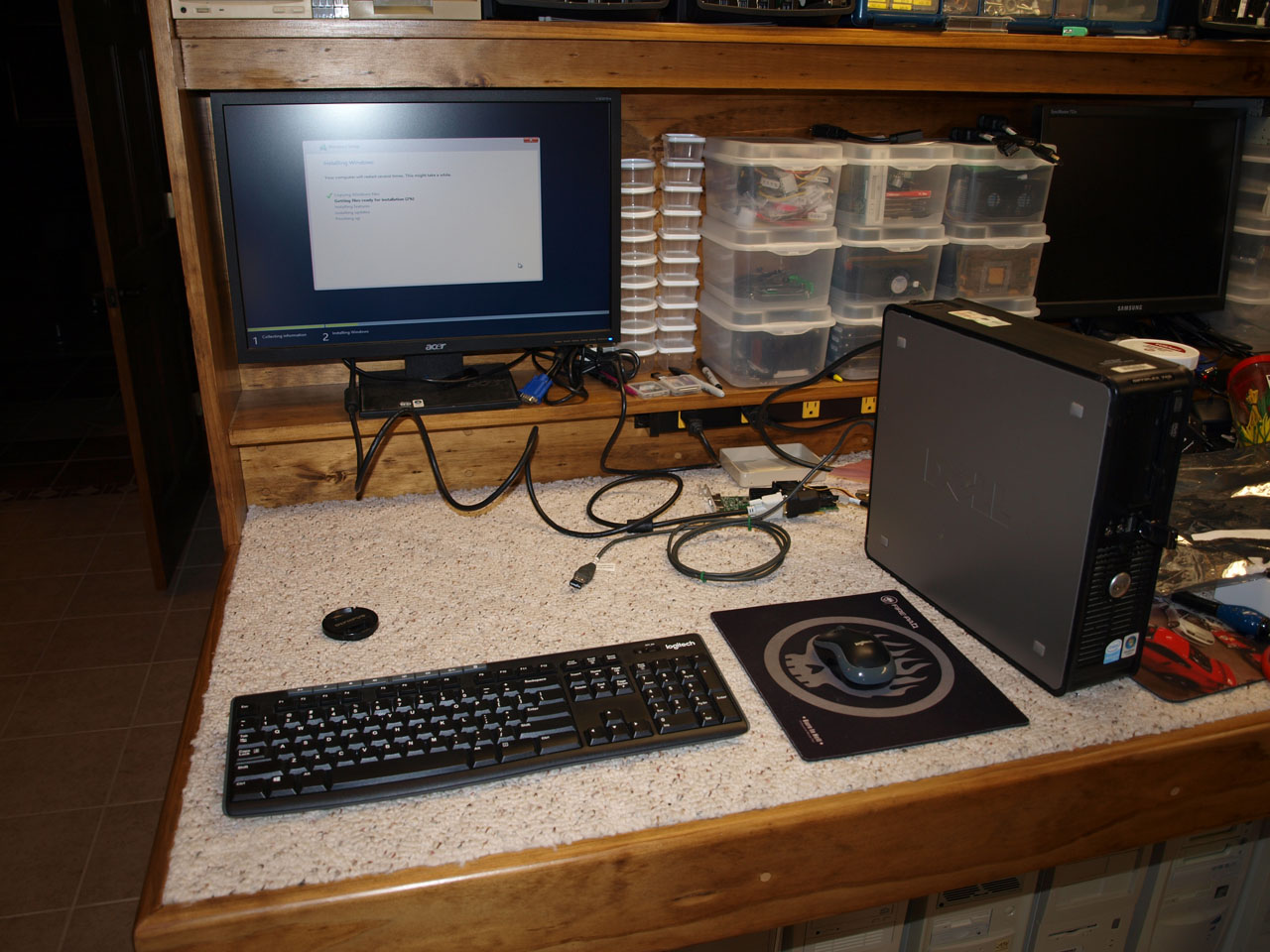

    I sold this Dell GX745 to a client back in 2010. He called last week and told me it quit. As old as it is, I upgraded him to a Lenovo M90Z I7 AIO I had on hand. I cracked this gx745 open this morning.....the polies held....all the little guys around them died this time!
    This is a Pentium-D @ 2.8 with an upgraded NVS295 GPU in it, 4gb RAM. 100% worthless system.....I haven't decided if I'll fix it or not... Case is dusty but in super condition....

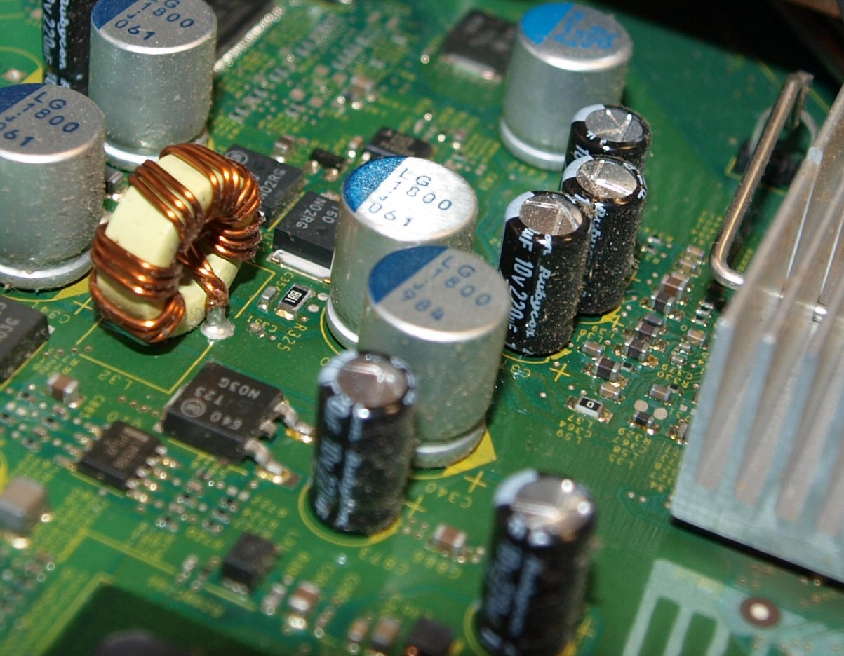

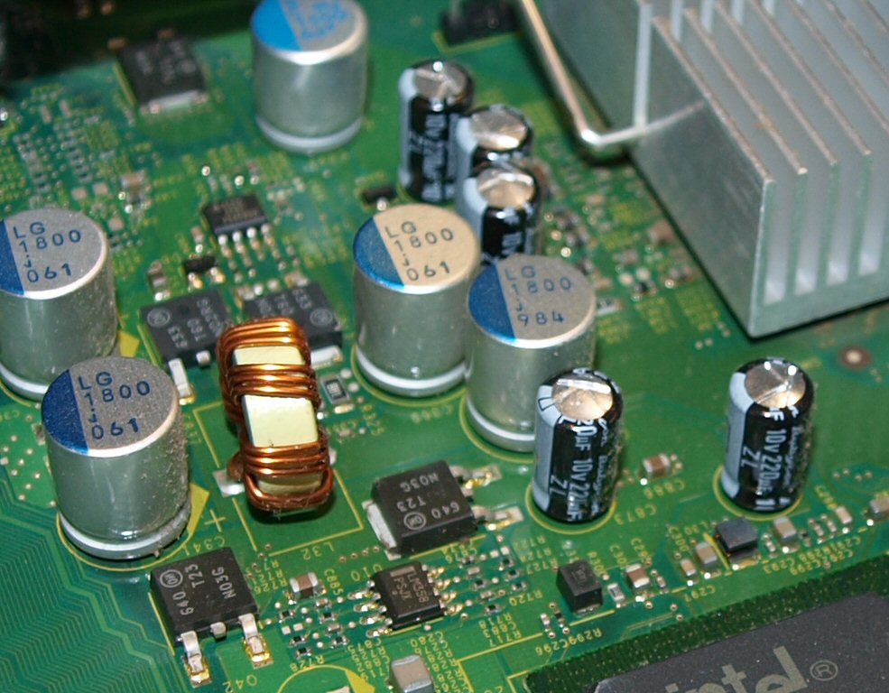

    Re: Just when you thought polymers gave a PC eternal life! - The GX745 SFF Calamity!
    that thread title is a little misleading there. damn! almost gave me a heart attack there and i was half-expecting to see ruptured/leaking/bulging poly pr0n like a woman with lots of... err... nvm... this aint the vip room! lol!
    i guess the autopsy conclusion and result from this gx745 failure is to do a full polymer recap in future with other similar types of toaster box systems. still, the electrolytic caps held up for 9 years before kicking the bucket. so the jap caps were pretty decent lasting nearly a decade in a toaster box system.
    the rubycon zl series is a 5000 hour rated series but the 6.3mm diameter parts are rated to 2000 hours in the datasheet and the 8mm parts rated to 3000 hours in the datasheet. the 220uF 10v parts are 6.3mm in diameter from the datasheet so its quite impressive a 2000 hour rated electrolytic lasted 9 years in a toaster box system!
    so i guess thats my forensic report on the failure of this gx745 system.

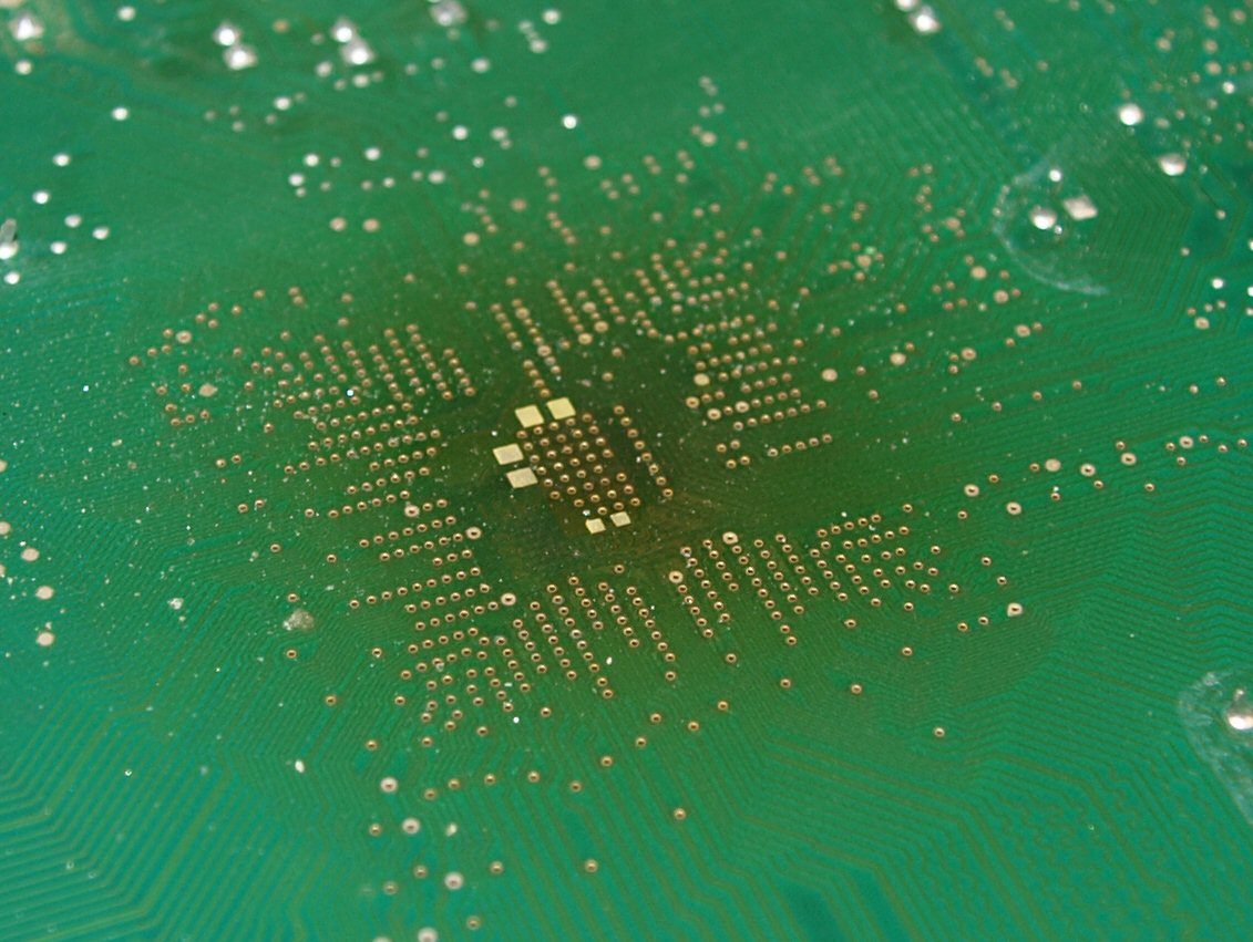

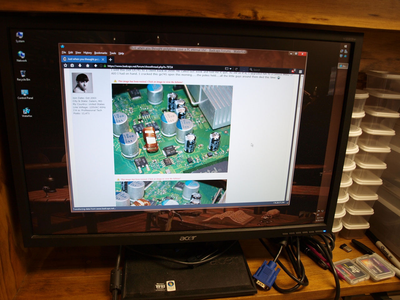

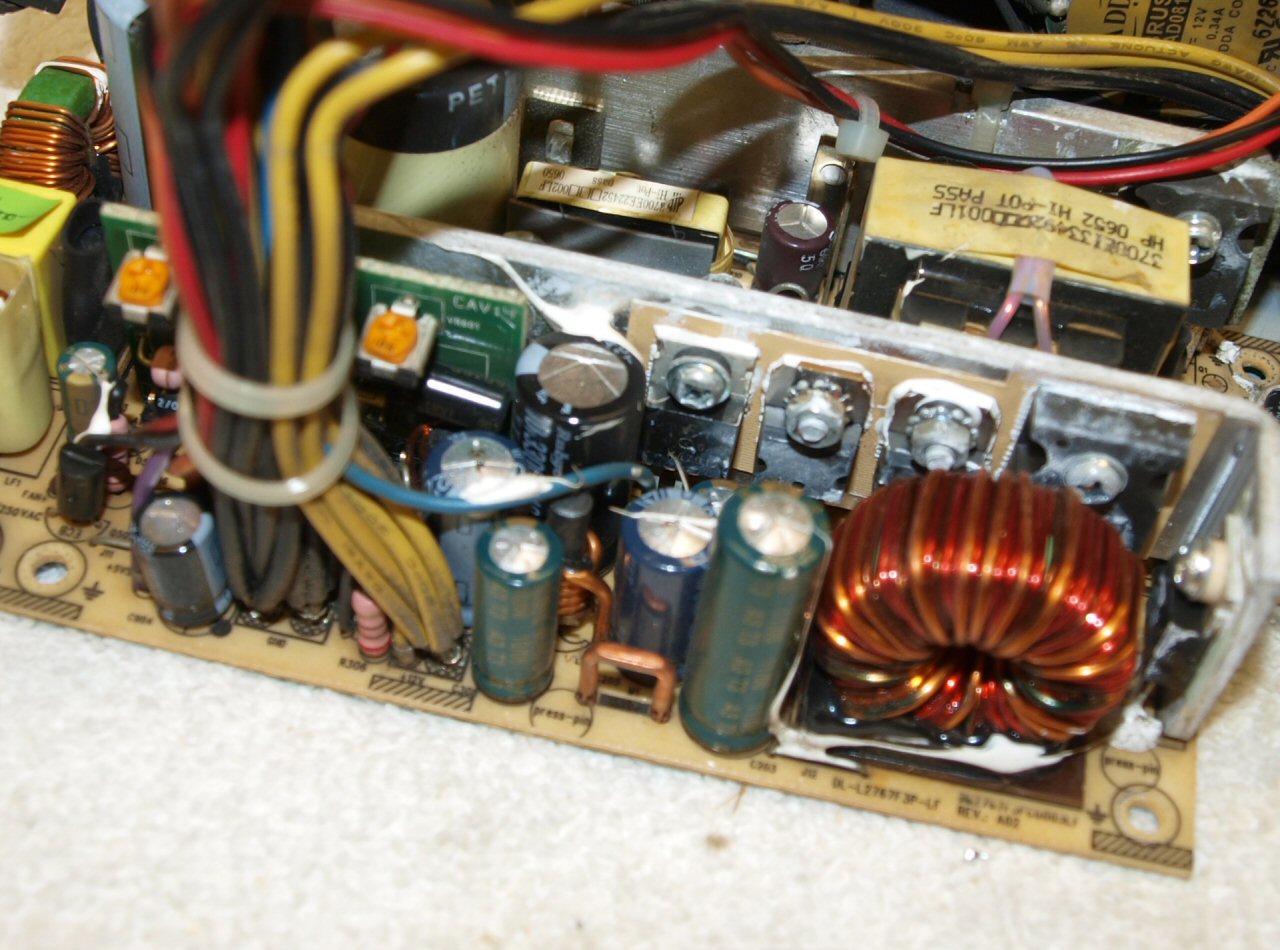

      Autopsy complete. Both the board and PSU were toast. I replaced the visibly bad caps on the board, and it came back to life. I was leary because of this:
      That NB chip has been HOT!! The cause was a completely gunked up front panel fan....the system stopped breathing....but the board pulled through.
      Now for the PSU:
      Bad teapos....what amazes me more is that they hung in there this long.... I should have replaced those before I ever sold the system!!

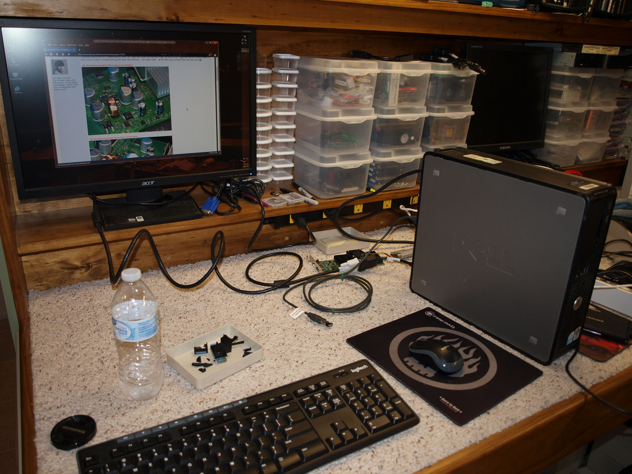

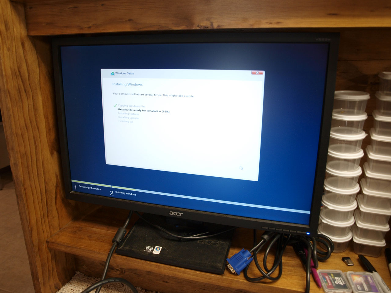

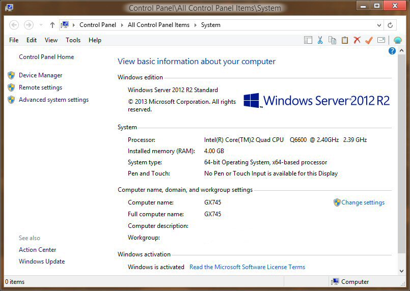

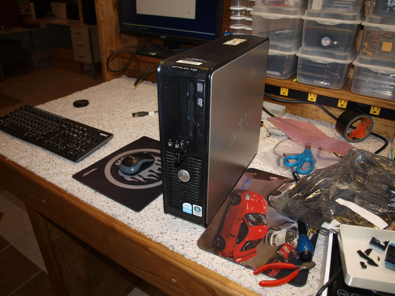

        Chalk this one up in the win column....but considering how worthless this system is, it was a complete waste of a Sunday......but I really had nothing better to do today....so here we are!!
        All back together....up & running, installing S2K12 R2.
        Inside is cleaned....but the outside will need a good cleaning.
        The plastic HDD caddy had gotten so deteriorated/degraded from the excessive heat from the northbridge + clogged fans, it became so brittle that it crumbled barely being handled.
        Overall, very functional web browser. With good caps & nice clean power, it runs very cool.....so here's to a Sunday completely wasted!

                      Note to self on the silicone.....I have a good supply of that.
                      I had a C2D e6700 in the bin, I swapped that out for the pentium-d. Lost 133 in core speed but gained 266 in bus speed.... System browses the web just fine. I'll find a home for it....someone will need it. I put S2K12 R2 on it....but I think it'd run w10 or mint just fine....or heck, throw win7 back on it....

                          Originally posted by Uranium-235
                          you can get a used Q6600 on ebay for <$10. should work on this
                          Wow, thanks. I found several for ~$7 shipped. Worth a 7-dollar gamble. FWIW, I did buy a replacement HDD caddy for $4 shipped, that actually has the fan in it. Since putting the C2D CPU in it, there was a BIOS nagger about the fan not being present....
