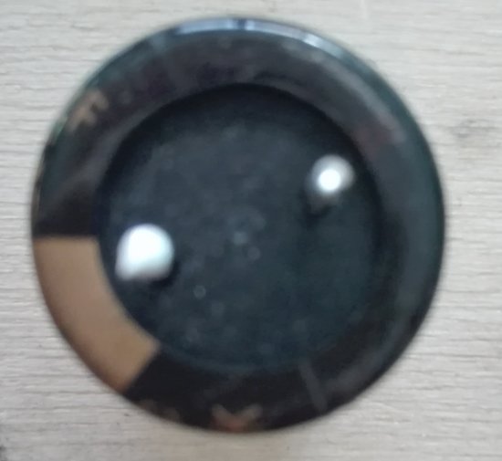

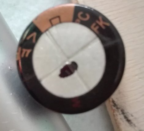

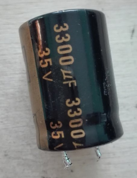

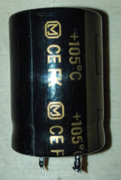

    Few days ago I replaced 5 capacitors on an industrial board.
    One was completely bulged.
    They were Panasonic FK type... but I suspect they were fake because the vent was not the classical T.
    I post here some photos to have your opinion.
    I was surprise because they were mounted on an UPS of a well known Italian company... and I can't believe they buy fake components.
    Ciao
    Gianni

    It looks fake to me. Some of Panasonic's high voltage caps have an X-shaped vent, but I think a cap that size would have the T vent. The bottom seal and printing are definitely wrong.

      Fake for sure...
      No T vent, and I've never seen Panasonic caps with that seal.
      Print is off and there's no stamped date/lot code.
      Looks like some "Hermei" or similar trash...

        100% fake.

          wrong colour anyway, FK series have a purple sleeve with gold print - not black.

            Thanks to all for confirm my suspect.
            I really don't understand why a well known company use fake components... and I'm not speaking of consumer appliances but industrial/professional products.
