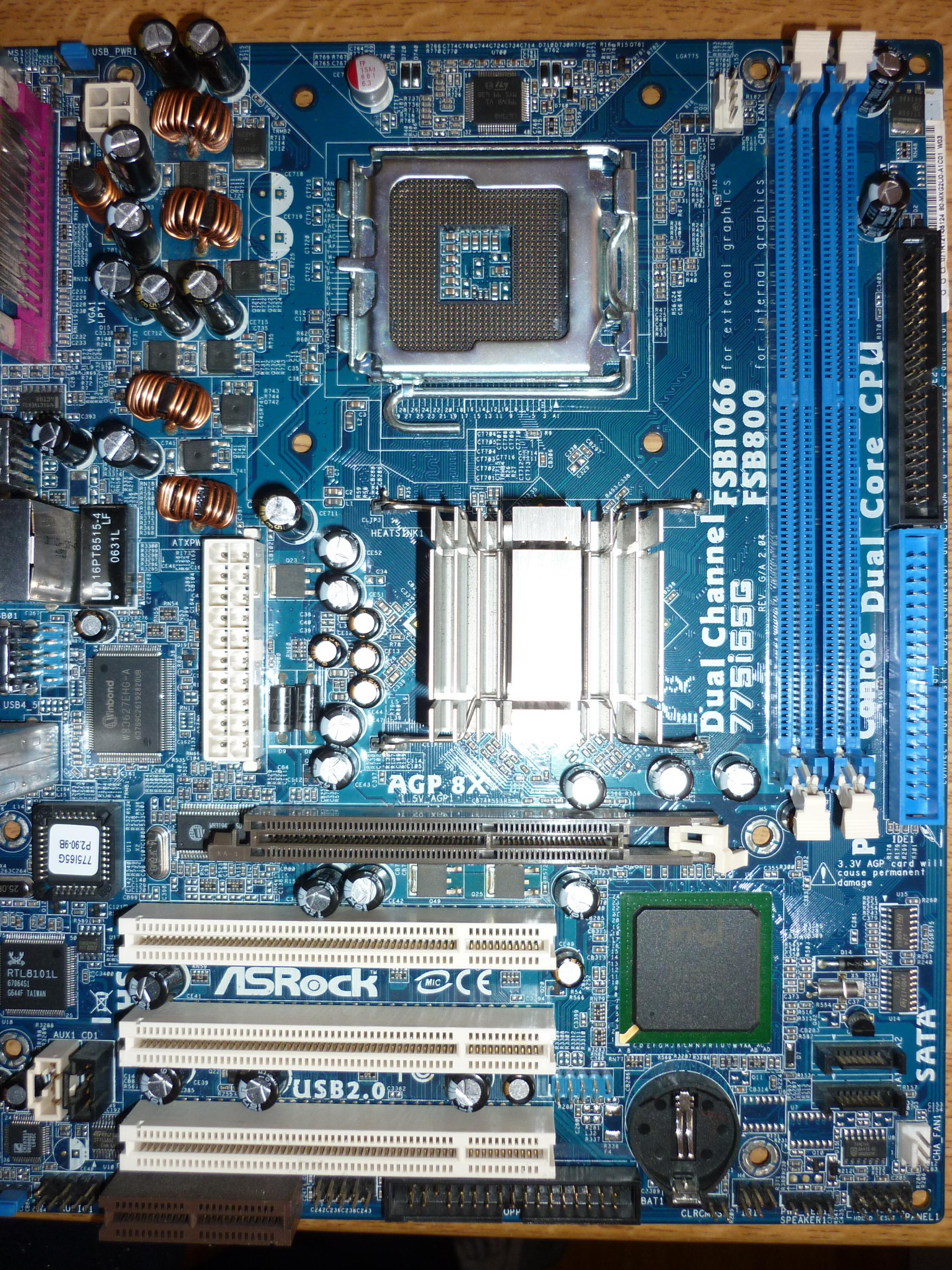

    I've noticed a few of the OST RLP 1000uf 6.3v 8mm caps on the board are starting to bloat a bit, does anyone know what decent caps they could be replaced with?
      • 31289
      Re: Cap Identification please.
      0.13ohms esr 555ma ripple.
      that's pretty crappy actually
      rubycon YXG is closest.
      or just be done with it and stuff it full of 1000uf 10v panasonic FR's or 820uf polymers!!!

        Any ultra-low ESR caps will do, I got some stash of Rubycons MBZ 1000/6.3 in D8x11.5 mm.

          I found some cheap-ish panasonic fm's on Ebay - EEUFM1A102L would these be suitable to replace the OST RLP caps on the board?
          Originally posted by Behemot
          I got eyes so I can see it's part of the Vcore. If you are unsure than check continuity between CE717 and CE718(9). Just remember this board was still under ASUS influence - reversed polarity markings.
          Yes there's continuity between CE717 to both CE718 and CE719 I checked it earlier.
            • 31289
            NEVER buy caps on ebay - 99.9% of them are re-sleeved chinese shit like chang/cheng/fuhkyu/suntan etc.

                  I would just like to know if the panasonic fm caps would be suitable to replace the OST RLP ones on the board?
                  Anyone know?
                    • 31289
                    #29
                    they could, but FM are unusual and i get doubly suspicious when i'm told they are on ebay.
                    usually it's FC and FR being resold or faked.
                    what's the sellers price and for what part number?

                            Just an update, finally got it sorted *wipes sweat from brow* first motherboard I've ever recapped.
                            Unknown vented 680uf 6.3v replaced with Nichicon L8 fpcap 680uf 6.3v
                            17X OST RLP 1000uf 6.3v replaced with Rubycon YXJ 1000uf 6.3v
                            The vented cap measured 3.9 ESR 757uf. All the old OST's were still 0.00 esr, even the bulged ones but I'm glad I've got them all replaced now.
                            The hardest part was clearing the holes, I ended up using a stainless needle on them. It was a bit of a struggle with the Antex XS25 as its only 25 watt, but I found adding plenty of solder to the tip helped with the heat transfer. These are all tips I've learned from reading these forums.
