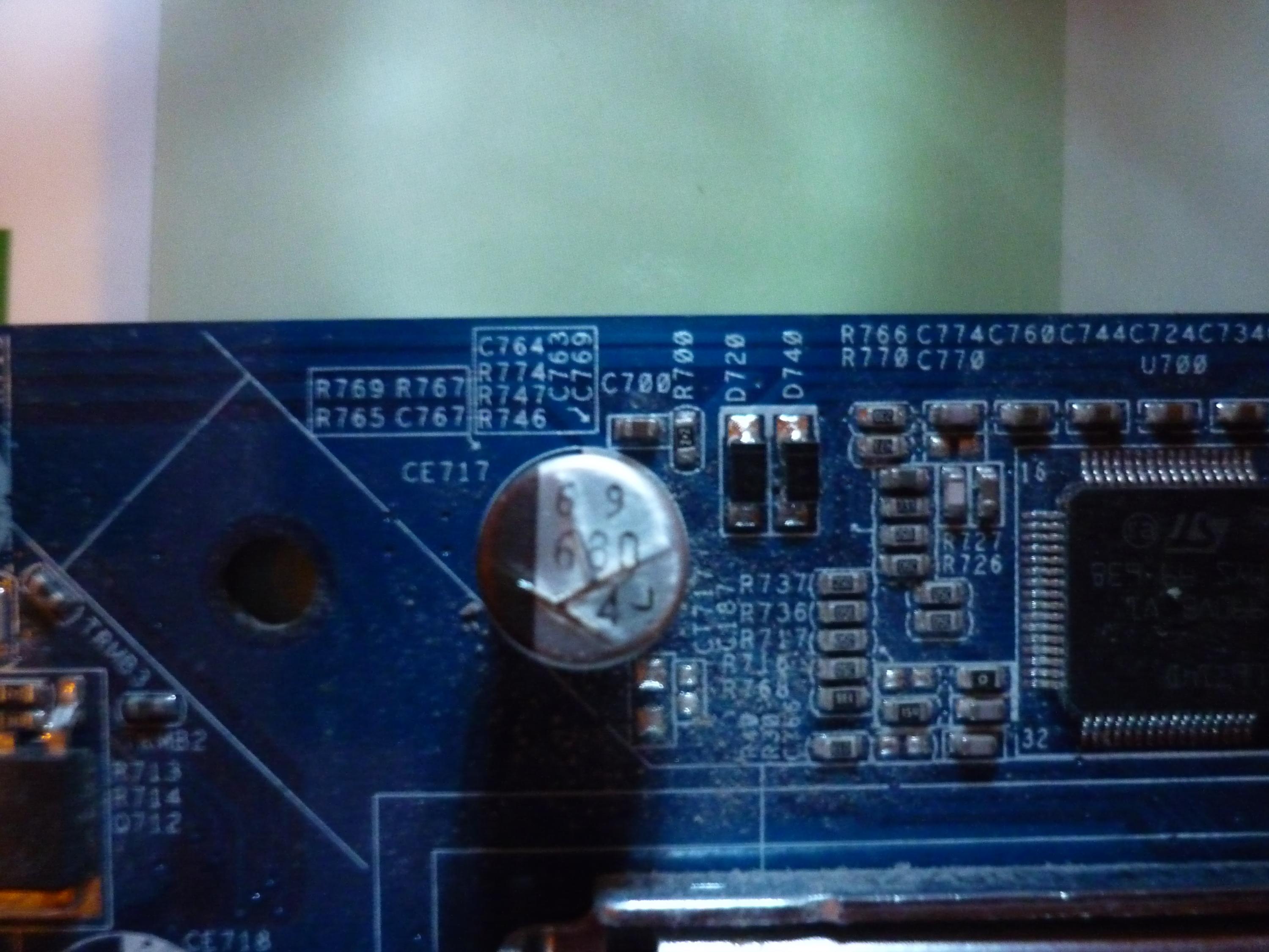

    Hi, can anyone identify this cap please. It sits under the cpu heatsink on a Asrock 775i65g motherboard. Pc still works perfect but I want to replace the cap before it causes other problems.
    • 31288
    Re: Cap Identification please.
    680uf 4v
    and you need to use a polymer cap that is not too tall or it will hit the heatsink.
      Thank you stj. BTW do you happen to know the make of the cap? so I can match the specs.
        • 31288
        no, just get a polymer - the spec will be far better than even the best electrolytics
          You can get with 2.5 V too, that's gonna be on some Vcore rail.
            Seeing how the thing vented, I wonder if it's an ultra-low impedance electrolytic in what looks like a polymer package.
            Replacing it with a real polymer cap, really soon, would be good. Is anyone familiar with Jovian distributors?

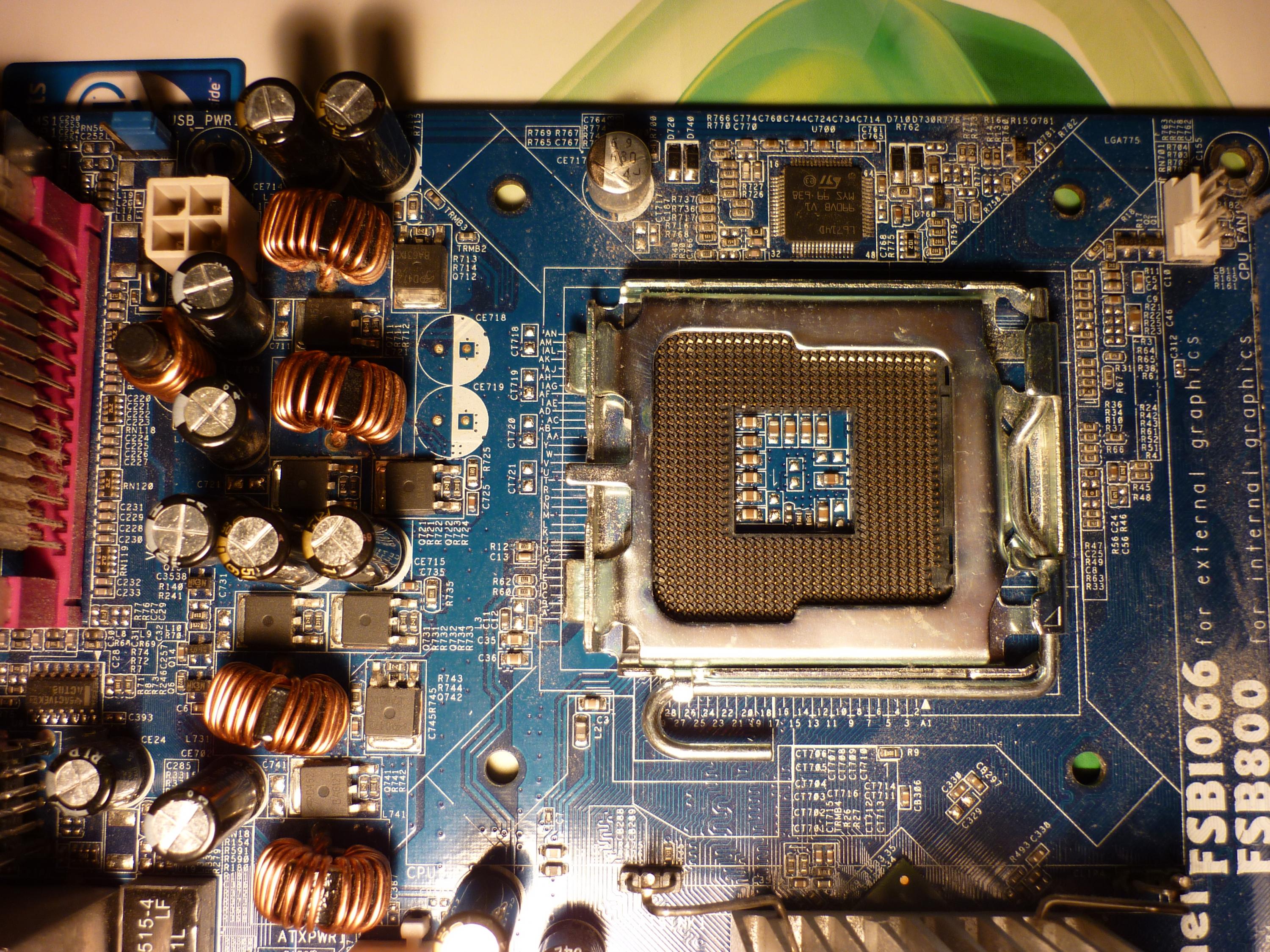

              hey flewpast' can we have a foto of the whole cpu area?
              • flewpastjupiter
                Antex soldermaster
                • Oct 2009
                • 30
                yes no problem, here you go.
                VRM Input - 4x Nichicon HM 1000uf 16v A0632
                VRM output - 5x Panasonic FJ 1500uf 6.3v + fake poly 680uf 4v

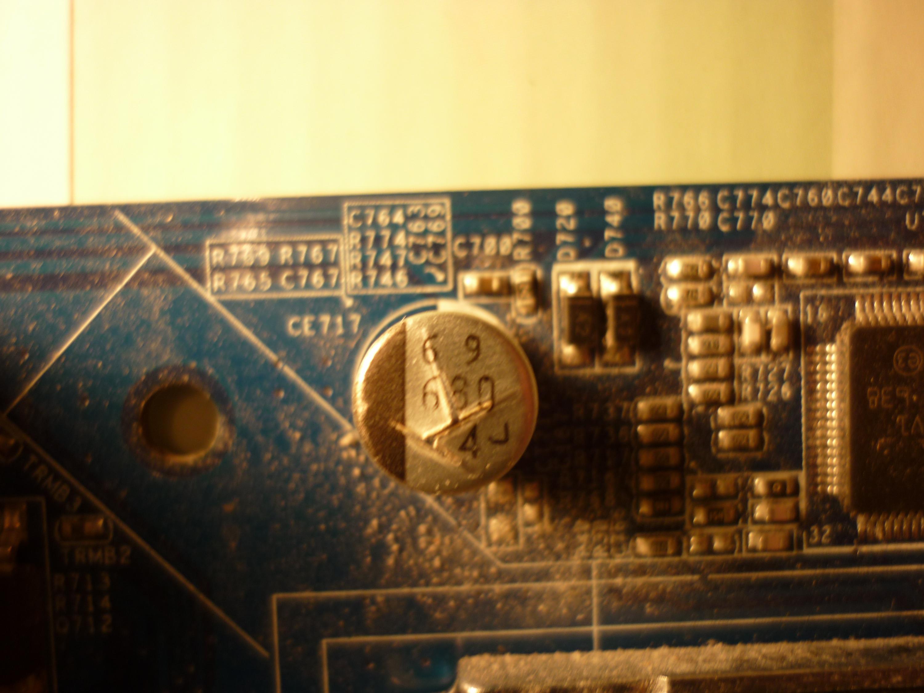

                  what's the diameter of the bad cap - 8mm? 10mm?
                  and the height - for clearance.
                    The diameter is 8mm and height about 9mm.
                      • 31288
                      order this.
                      http://uk.rs-online.com/web/p/alumin...itors/8392114/
                        ASRock 775i65G, somewhat strange PCB layout of rev. 2.04. Interesting board that is…
                        If you have any dead MoBo or graphics around, you can scavenge polymers from that, anything from 330 to 1000 uF 2.5-6.3 V would do, no need to go shopping for one piece. If you want better stability especially with overclocking, might as well fill those other two vacant positions, and the ceramics C1717 (?) to C1720.

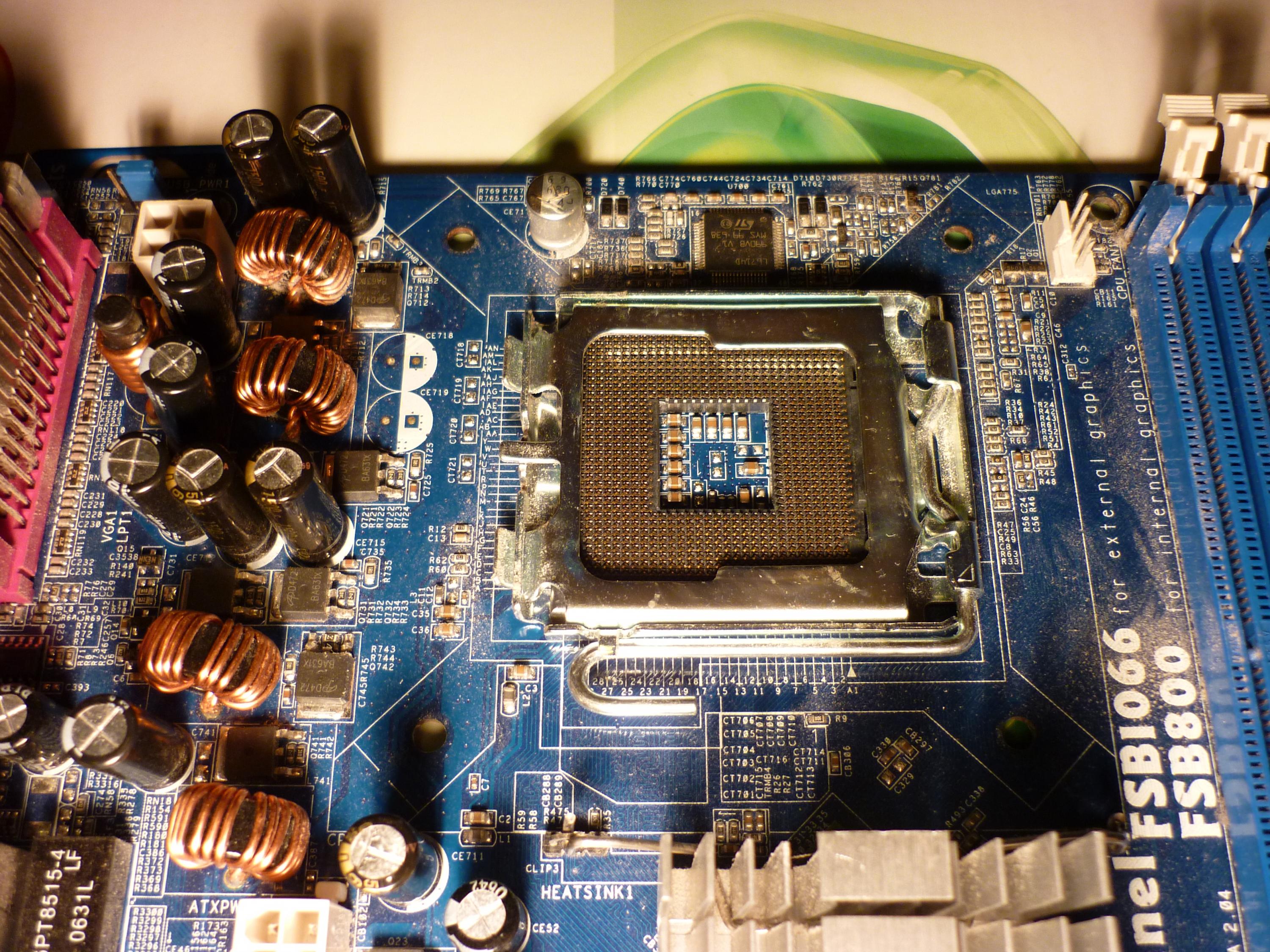

                            Originally posted by stj
                            Thanks for the recommendation but I was thinking of ordering these http://uk.rs-online.com/web/p/products/7149004/ with them being a bit more durable 5000hrs and the cap sitting under the heatsink.
                            Thanks for the reply. I've just had a look at an old Radeon 9700 pro and a Geforce 5900xt both are dead and all caps on them are surface mount ones.
                            If a 330 uf cap would definetally be enough I'll have another look on Rscomponents. Do you happen to know any ebay sellers that have genuine caps?
                            BTW what caps would be suitable to use in the two vacanct positions?
                                Basically any combination of polymers, really. Of course generally regarding VCore VRM, the higher the capacity the better. On the other hand polymers have much lower ESR and higher RC than even the best wet lytics so that's why you an go down with capacity without issues.
                                If you can get some 820/2.5 V ones for cheap you can use those, that would be one of the best choices. On the other hand not that the CPU stability, which itself (any of the Core 2 architectures ones) could handle 1066 MHz FSB any day of the week, would be an issue here, unlike with the chipset which supports only 800 natively and 1066 indeed is overclock for it…
                                Would not kill 9800 Pro or 5900XT anyways, those are collectors items these days, one of the most powerfull cards of theirs generations. Especially if AGP
                                Anyway, I can send ya pulled polymers from here, always got some. I don't carry new ones yet as I have little use for them yet and still have income of some from all the dead boards
                                  so what is the voltage on the board?
                                  you dont know - so why the 2.5v caps?
                                    Socket 775 - gonna be well under 1.5 V. Even my 478 Press-hot only runs at 1.33 V.
                                      I've just checked and its a 9700pro not 9800pro. I had it in the oven a few years ago to try to fix it and the 5900XT just BSOD's when windows loads.
                                      I don't know the voltage, but I thought a 2.5volt cap would be ok for the cpu vcore.
                                        • 31288
                                        what if it's not on the vcore?
                                        what if it's on the 3v3 line?
                                        im not saying it's not on vcore - i'm saying dont assume anything without checking .
