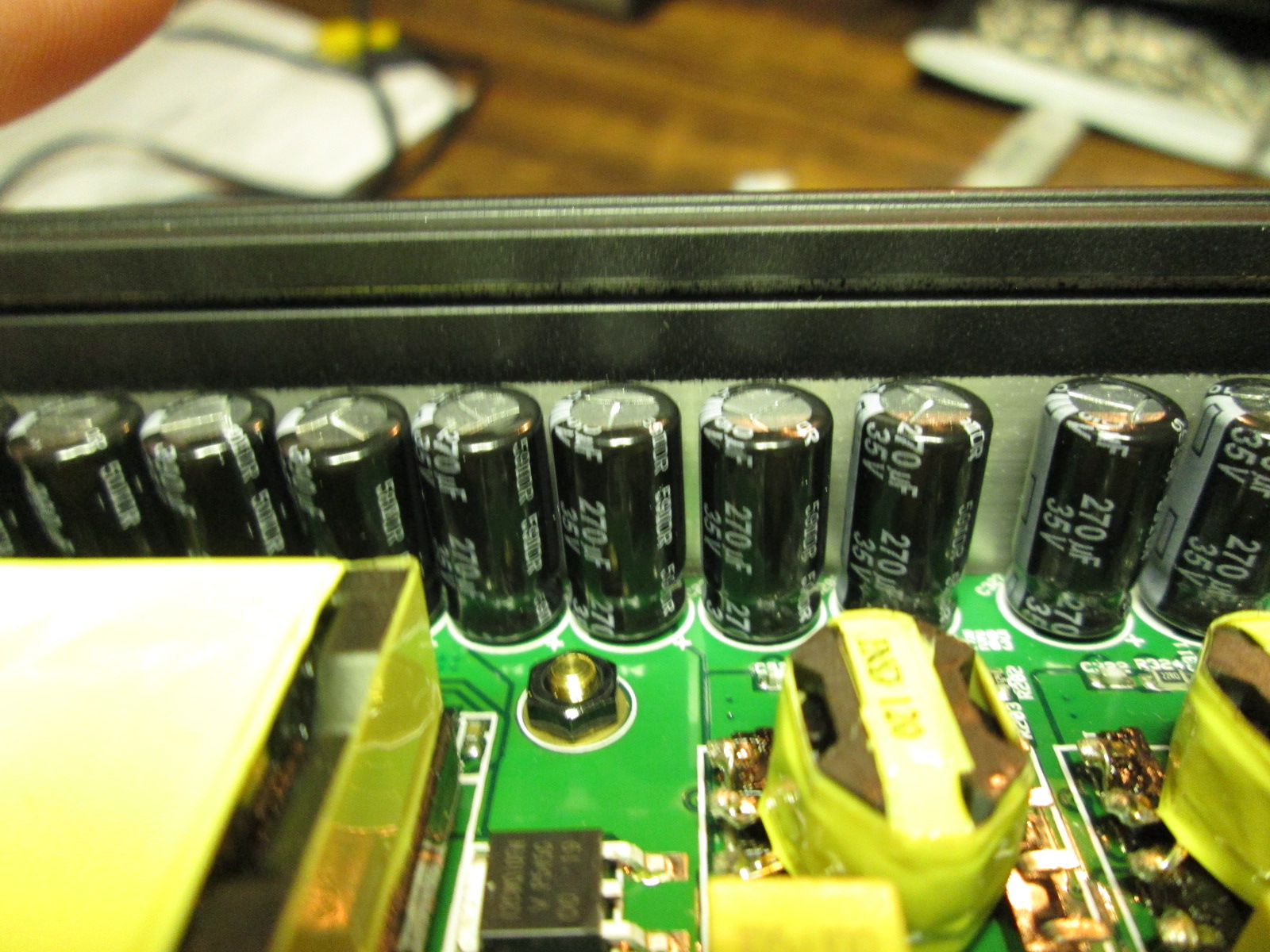

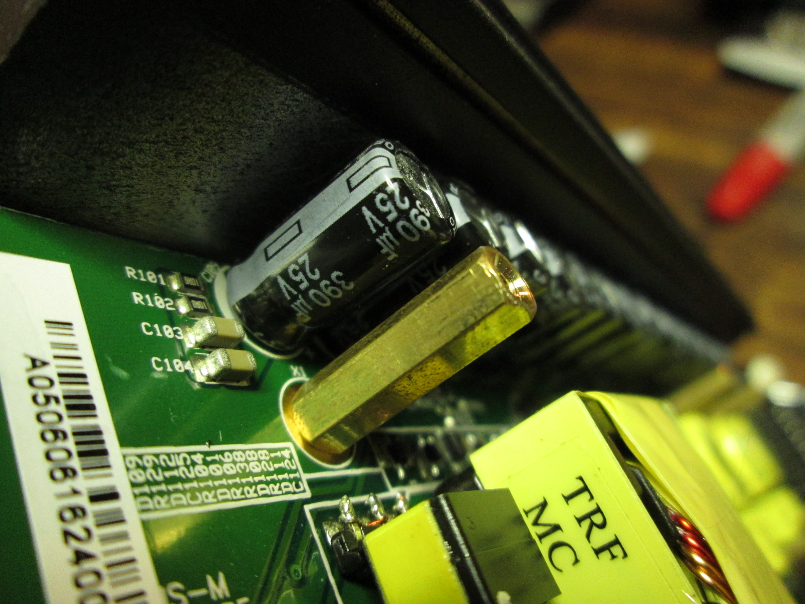

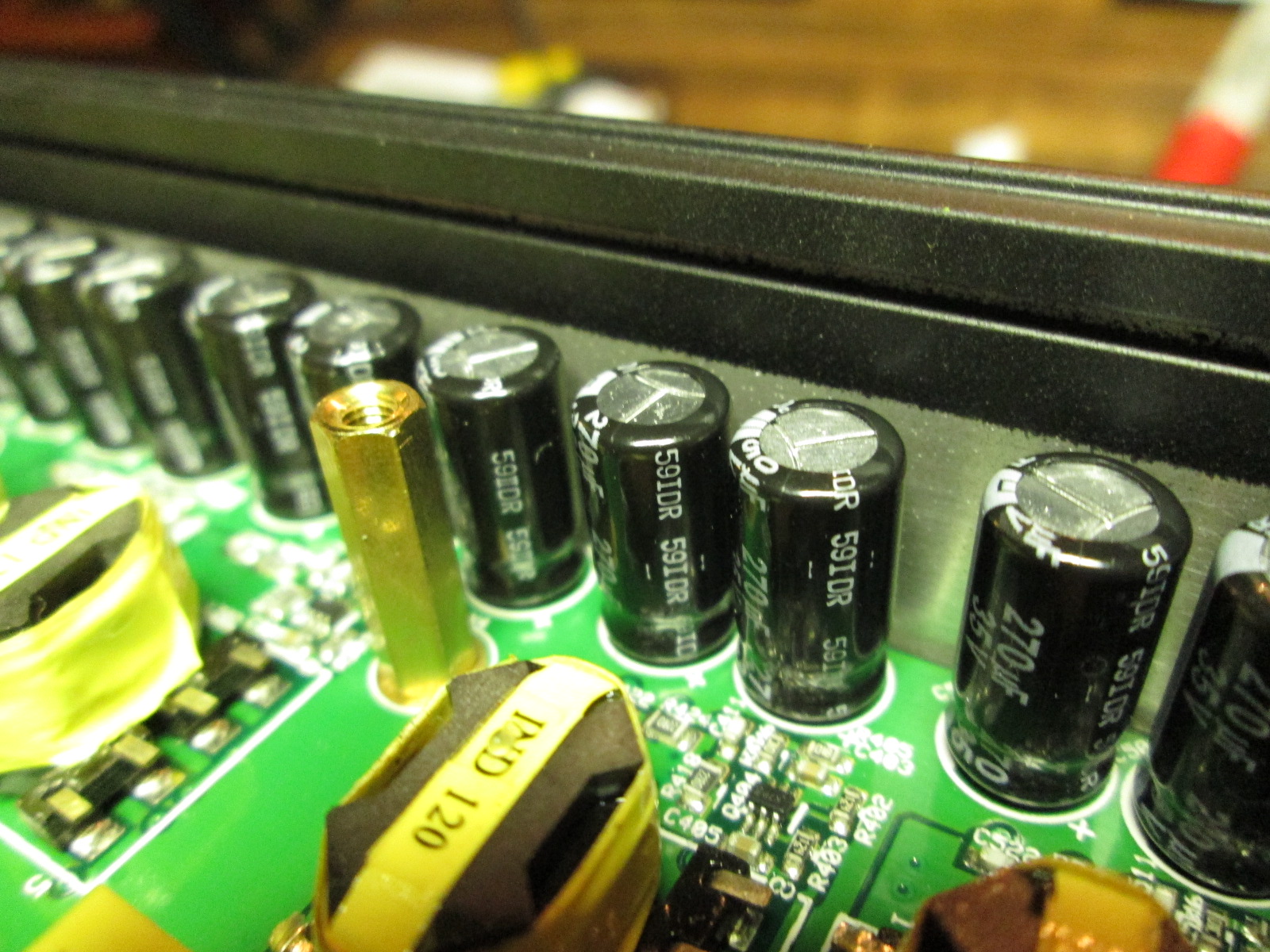

    Anyone recognise these?
    Alpine 445U
    Just curious what Apline uses these days.
    I think they are Panasonic
    thanks

    Re: Anyone recognise these?
    Photos 1 & 3: 270uF 35V Capacitors. Photo #2: 390uF 25V capacitors. Odd values for capacitors.
      They're Panasonic, since you didn't bother telling the diameter I can't say the exact series but at least FK,FC,FR have those values. Could be fake ones too.
        They look like FR series.
          Not odd at all. 220-270-330-390-470 all normal steppings.
