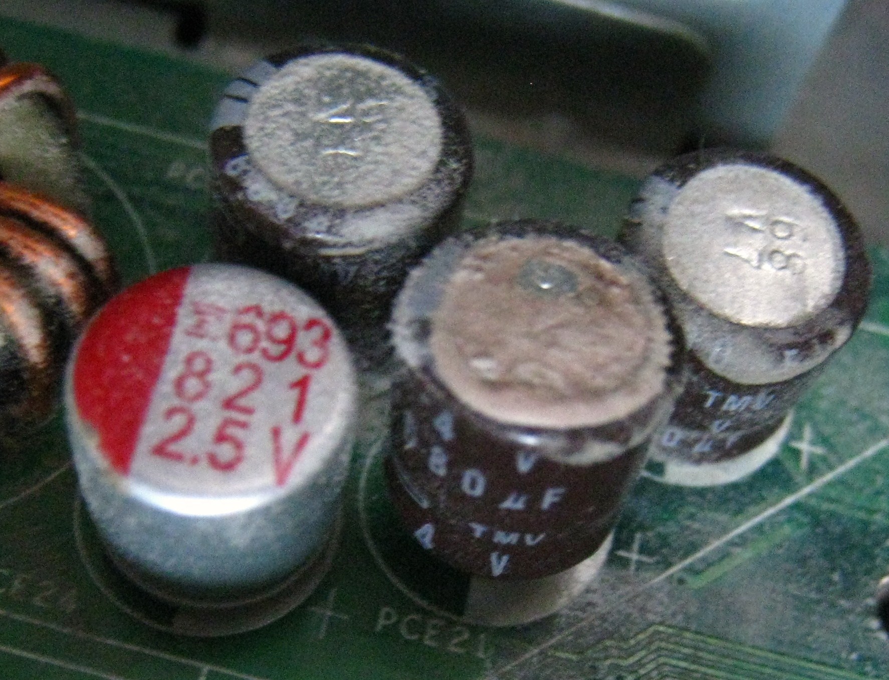

                        Should I replace this small cap? What does it control?
                        The caps I replaced initially were beside the heatsink in a row (see other pic)
                        Do these control\regulate the voltages that the processor gets?
                        Can I replace the blown one with an aluminum silvery1 one beside it?

                          Re: Recap a single bad cap?
                          I can't see in photo well enough to tell anything.
                          If it's blown you should replace it.
                          As you have blown KZG you should replace all of those.
                          As the TMV is 4v it is probably on Vcore CPU voltage.
                          TMV seems to be an OEM only part and there is no data table available.
                          You should probably replace it with a solid polymar as it -probably- is one.
                          Yes, suspect PSU.
                            So replace it with an identical cap? When you refer to solid polymer do you mean it has solid electrolyte? I was thinking (if possible) replace it with an aluminum one shown next to it (red writing on top...) Will these handle the heat better?
                              Here is a closer picture (attached) ...
                                From what I can tell the TMV is a hybrid polymer like the red Fujitzu next to it.
                                Not quite a 'solid' polymer but not a 'wet' electrolyte cap either.
                                They have a semi-dry electrolyte.
                                Those don't fail very often so it's probably either a random dud cap or a PSU issue.
                                  Thats where I was looking aswell.. I will probably just recap it with the same equivalent.. I was just wondering if its possible to use a cap similiar to the red fujitsu.. All solid aluminum shell etc.. Are their any benefits?
                                  Thanks..
                                    The TMV and the Fujitsu are the same kind of cap.
                                    The sleeve is only a way to mark them.

                                        Finished with the TMV cap under the heatsink.. Everything still works so far.. Noticed another cap bulging up near the ram slots.. This one is probably due to heat as I have 2 sticks in ultra heatsinks which don't seem to work to well - probably not designed to be side by side touching.. This one I believe was 6.3v 1000uf NCC.. Im sure it was KZG series..
