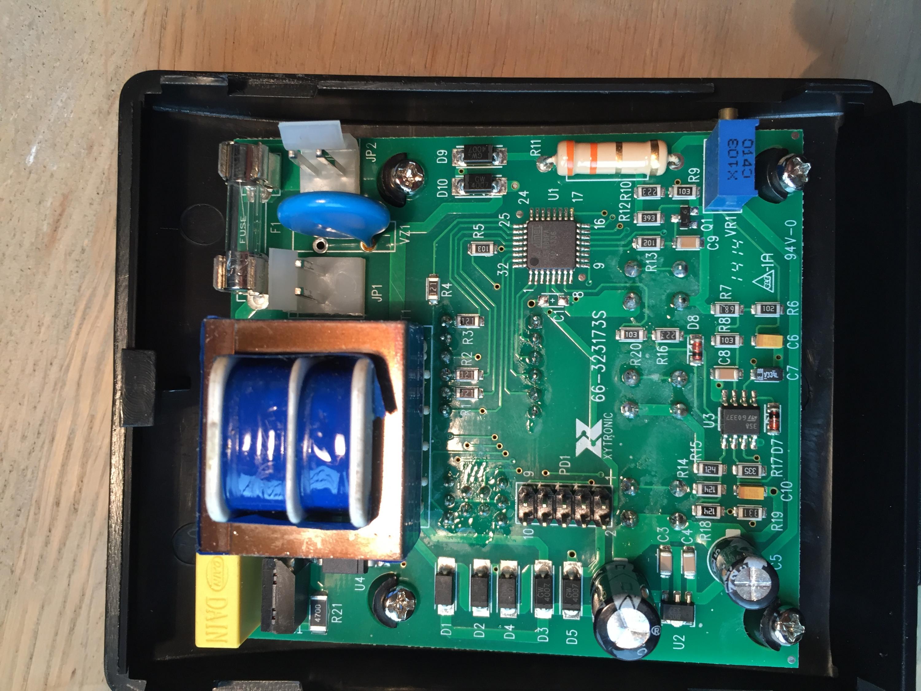

    Some time ago I got myself a new soldering station as I was planning to start doing some more soldering. This soldering station is mains powered so it is not comparable to other larger soldering station. I have not really been using it much, but I read that the Xytronic stations might have bad caps so i decided to open it up.

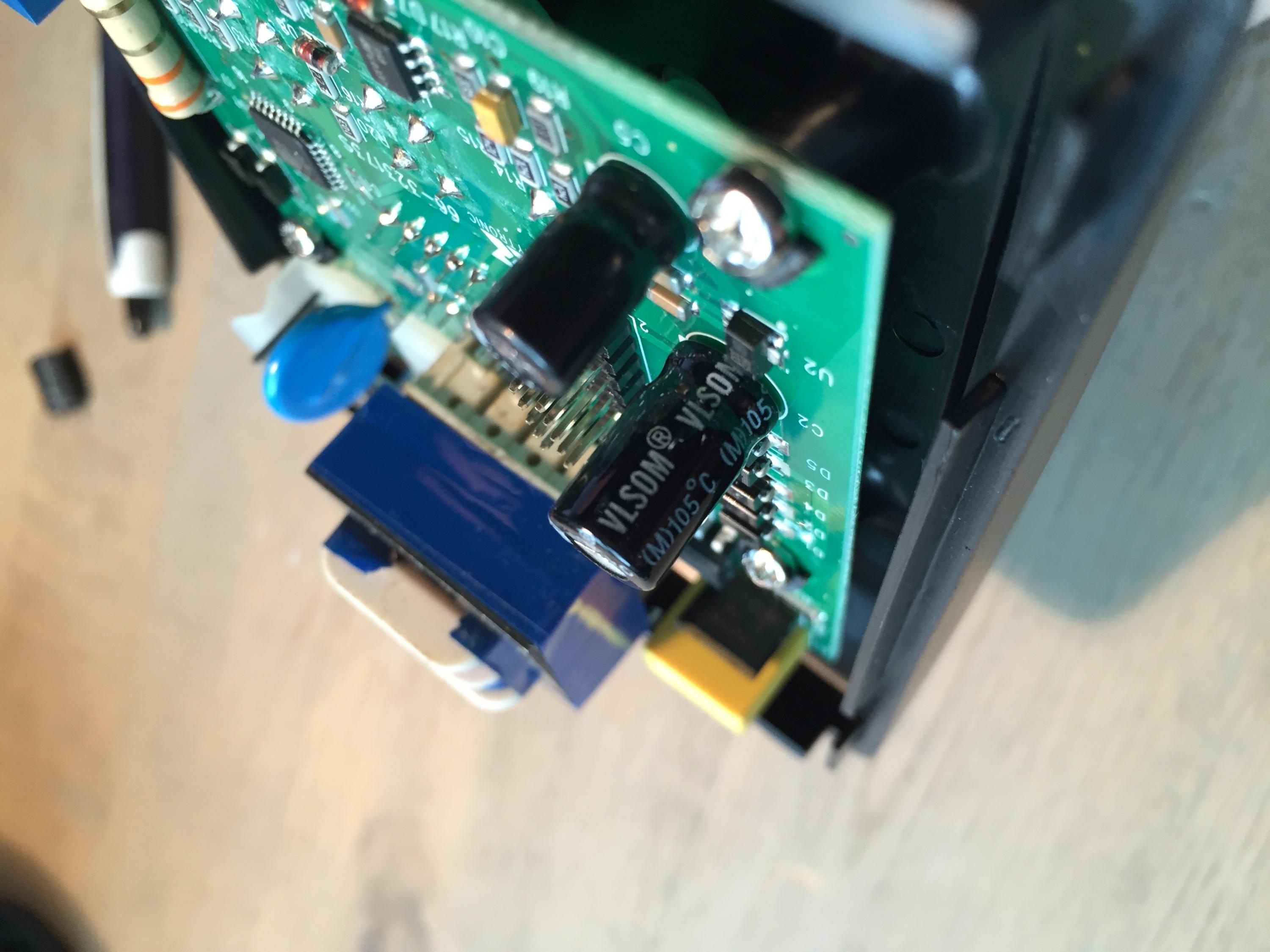

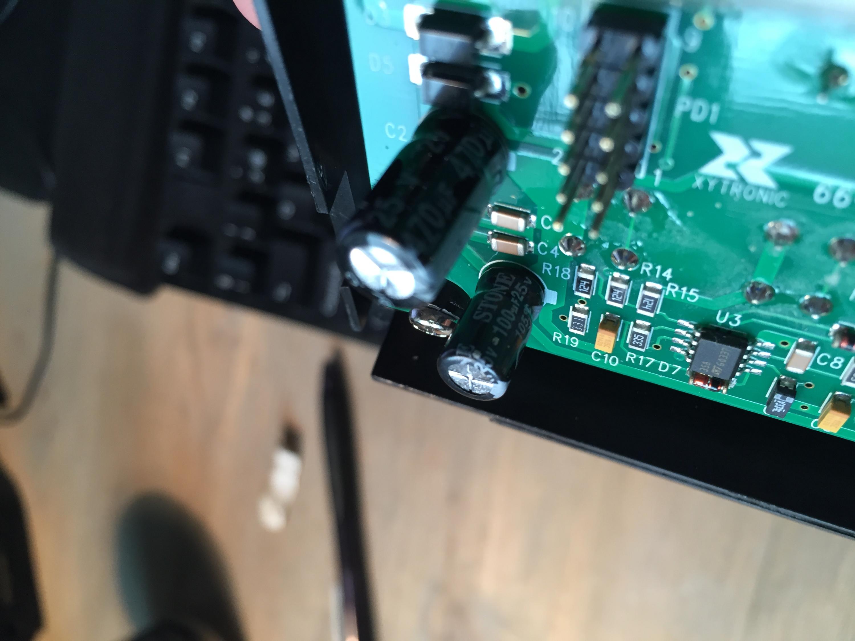

    So as far as I can see there are only 2 caps:
    VLSOM 470 uF 25V
    STONE 100 uF 25V
    So the question is if I should replace them with something better? If so what would you recommend? I can get Rubycon and Panasonic quite easily. See the attached pics for more info.
    Any input is appreciated!

              i would - i always change the chinese caps in stuff.
              i wouldnt panic though - i would still expect them to last a year or 2.

                  The soldering station doesn't use a switching power supply, it's just plain rectification plus capacitor, so we're looking at 100-120 Hz and low temperatures insides (they won't be as hot as near switching ICs or diodes).
                  So for these purposes, the capacitors inside will be fine and should last a good amount of time, no need to hurry to change them.
                  And when you do decide to change them, no need to go with very low esr capacitors or polymers (no benefit going with that), just pick something with long life rating.

                          Some linear regulators don't like very low esr capacitors. For example *1117 linear regulators prefer capacitors on the output with esr between 0.1 ohm and 1 ohm, some polymer capacitors of very low esr capacitors can have esr below 0.1 ohms
                          With such an output capacitor, the output voltage could oscillate or the linear regulator could reset from time to time, making the station reset.
                          On your pcb, U2 is most likely a linear regulator (probably a 7805, which in general isn't very picky about capacitors) ... U3 is probably a LM358 opamp which again doesn't care about capacitors....

                            STONE capacitors are garbage. Replace. I would just change both for peace of mind, it'll take you 5 minutes. Use general purpose series like Rubycon YXA.
