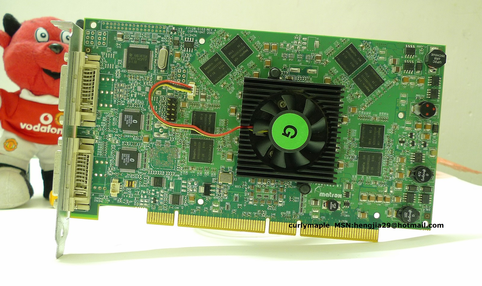

    as mentioned in the title, I have a Parhelia 256 pictured here:
    http://img02.taobaocdn.com/bao/uploa...zQT_012423.jpg
    which still works and seems to have no problems....however, I can plainly see on the back of my card there is a pair of surface mount pads that look like something broke off of them.
    I can see from the card, there are a few banks of vram and each bank is accompanied by what appears to be a small, surface mount, presumably ceramic-chip capacitor. I'm pretty sure the missing cap is going to be identical to these other similarly placed chips.
    I'm looking for all the advice I can get on determining capacitor value of a totally unknown, unmarked/unlabeled ceramic chip-type device.
    Thanks for reading.

    Re: Matrox Parhelia DL256 broken chip-cap
    0.1uf multi-layer ceramic (MLC)
    higher is better if it fits.
      Whoa! Thanks for the fast reply!
      1.How did you know that?
      2.Why would higher be better?
      3.I would think the voltage of the cap should matter too, right? or are ceramics weird and voltage at that level doesn't really matter?
      Thanks for your help
        • 31087
        1: because .1 is the usual value used across chip power pins.
        2. higher will smooth more noise.
        3: the voltage is going to be 3.3v or lower across the cap, and they dont make caps that low - so any will be fine.
        with ceramics you can go as high as you like without any issues - use 3Kv if you want!!!
        you can go salvage a pair of caps from any old logic board btw, like an old network card or a dvd player or whatever.
        the best thing about ceramics is they dont age.

          near the same bank of vram chips, there are several little black (I assume resistor banks, maybe zero ohms) that appear to be bridging some of the vram pins into the gpu. one of these little things seems like it was crushed, I assume by the same force that lobbed off the ceramic capacitor. it's certainly small enough I can't solder it by hand, but any thoughts as to what that might be?
          it looks like this, but the whole "chip" might be the size of the tip of a dull pencil
          http://p.globalsources.com/IMAGES/PD...stor-Array.jpg
          it's a 256MB card that's generally sold in 128MB versions, I suspect the things i'm looking at are used to announce the presence of the additional 128MB on the back of the card...but I'm honestly no expert.
            • 31087
            1k resistor array - atleast the one with 102 on it is 1k.
            probably acting as an inductor to remove any "noise" from the signal.
              allow me to amend, the picture I posted wasn't the actual chip in question, but the closest approximation I could find online at a moment's notice. Turns out the actual chips - all of them infact are black with no writing of any kind on them. is that a better case for them likely being zeros?
              thanks again, I really appreciate it.
                • 31087
                no markings means too small to print on.
                you would have to check one with a meter - they wont be 0-ohms
                10ohms wouldnt surprise me.
