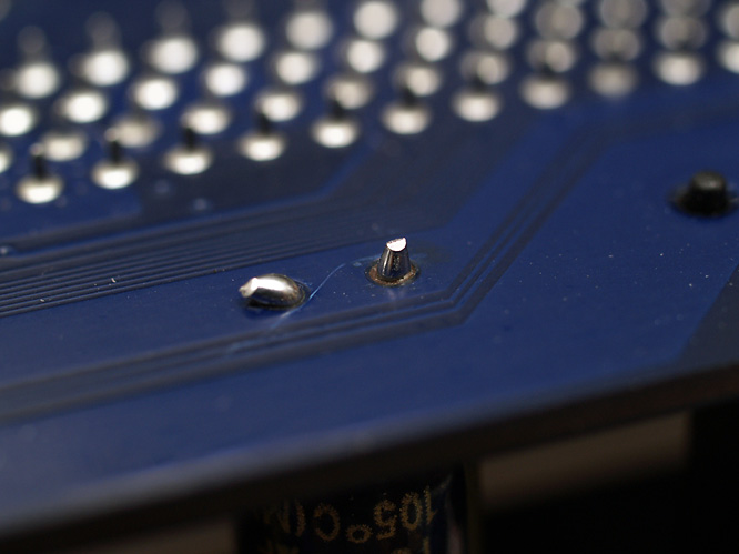

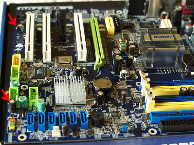

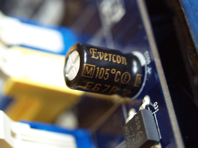

    I was reading this forum and found out that my new Foxconn MB has about two dozens of Evercon 6.3v 1000uF (fromerly GSC, I assume) and 3 Lelon.
    So I tried to recap those with Samwha WZ and WB series.
    While doing this, I made some mistakes.

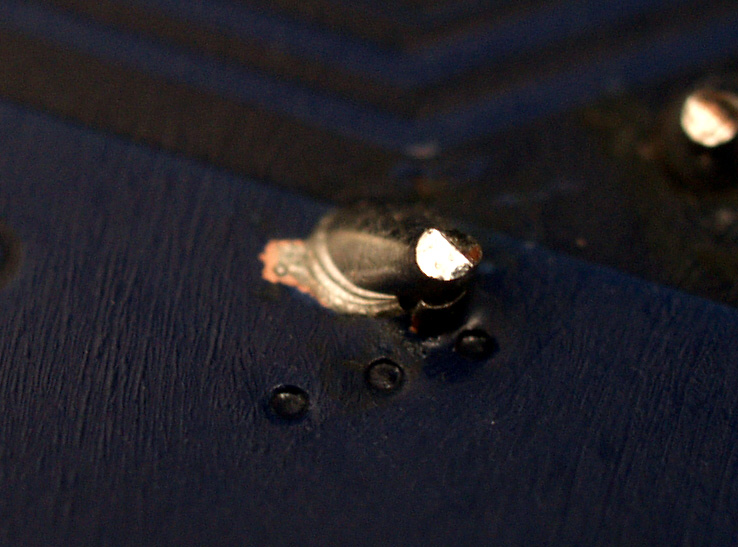

    As you can see in the picture, I had a pad blown off.

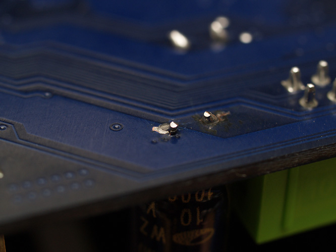

    After doing some research on this forum, I put out a digital MM and checked the blown off pad (it was below PCI slot and negative side). It seems like the via is still intact because it showed perfect connectivity with other cap's negative side. Am I right?
    Also, I've scraped some coating near a pad and soldered it with pad.
    It was the one located near USB and SATA ports and it was positive side.
    Should I cut the connection with a pick or something?
    Is this OK to use this board, or should I dump it?
    I have little knowledge about Electrics. I am worried that some other major component would fail if I power up this board.

    I think it should still be OK, it it's only the pad that went, I'm pretty sure that there's still the Vias inside the damaged hole. From the pictures I can see that the solder is sticking down very nicely so I guess theres still foil inside the hole. So I think you are still lucky in getting your motherboard to work.
    I had the same problem with my PC Partner motherboard a few months ago. I also damaged the soldering pads, but the vias was still OK and I put in new caps and it booted up well with no issues.
    PC Partner board: https://www.badcaps.net/forum/showth...7&page=1&pp=20
    About the continuity measurement, I'm not very sure about that, but I think the caps have to be in parallel to show a continuos connection. I better leave that part to others who know a bit more about the MM measuring techniques.
    The scratch you mentioned doesn't look too bad in the picture. It hasn't scratched the traces near the caps, all it's scratched is some paint (or solder mask), so there probably won't be an issue. Look at my thread on the PC Partner board, it looks much worse with all the scratches around the caps, but it still works fine.
    If you power it up and the vias is damaged, no it will not destroy any component, just make sure the cap you soldered isn't shorted due to excess solder etc. otherwise you might end up with a dead board and possibily some smoke. If the vias is damaged, your board will just simply turn on and have no POST or it may not even turn on at all.
    Hope it all goes well for you in the end.

          I tried it out and it worked well.
          It went through 2 passes of Gold Memory and now running MemTest.
          However, overclockability has been compromised somehow.
          I have an Intel Pentium dual-core E2160 and it took 333 Mhz FSB (1000 Mhz for Hynix PC6400 DDR2 RAM) before recap, but now it won't boot at 300 MHz or higher.
          Maybe I'll just stick with 299 MHz for now.

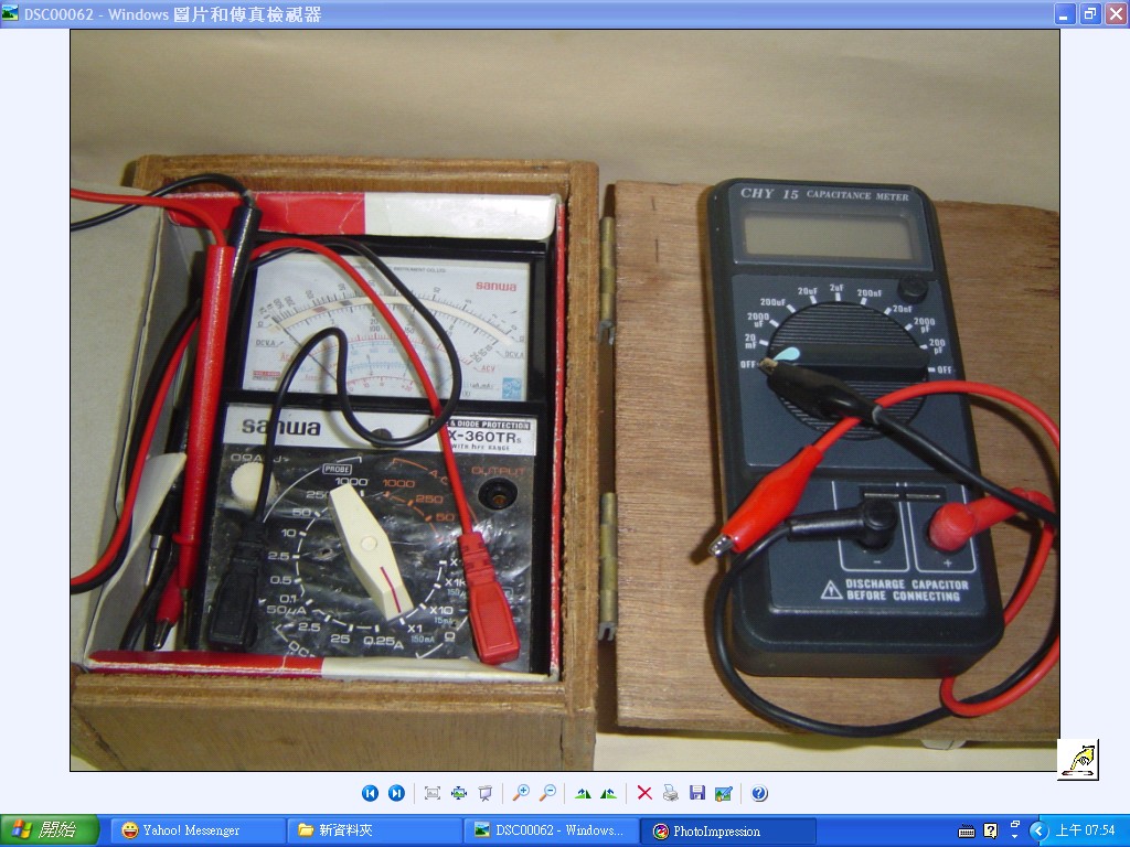

                          Dear Friend,
                          If the two pins of the PW SW/PW BTN on the mainboard yield the reading of low resistance (1XX-2XX ohms), it means no explosion with the power supply on but with no AC supply.
                          • Leung Kai-yan
                            • Apr 2006
                            • 32
                            Re: Recap gone bad
                            Dear Friend,
                            The job mentioned in the above post can be done easily with these instruments (see attachment).
