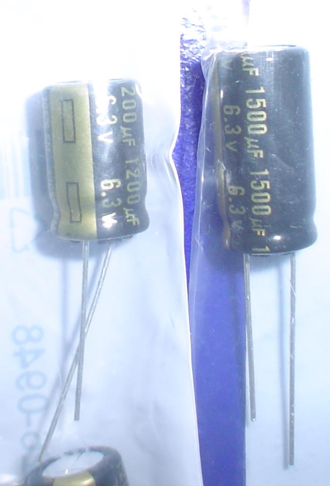

                      Anyway here's a photo of 1200 uf 6V3 and a 1500uf 6V3 Panasonic FM series
                      These are 10 mm diameter and pitch of 5mm (according to specs sheet)
                      Its alway better to go up but guess you got no choice if size is the issue and you cant source what you need...see what others think thought

                          Okay, the only cap I ended up having a problem with are the 1500uF 6.3V guys. The FM's only come in a 10mm while the Teapo's were 8mm and there are four of the spots on the board which are too tight to put the 10mm's SO I have to order four 8mm guys, which don't exist in a 1500uF anywhere in the Digikey catalog. BUT, I can get a 1200uF 6.3V in an 8mm. What is the really important part here? Because the original Teapo's spec out this way:
                          SC (8mm) 1500uF 6.3V ESR=0.085 Ripple=980mA
                          While a Panasonic specs out this way:
                          FM (8mm) 1200uF 6.3V ESR=0.030 Ripple=1560mA
                          I thought it was said that the capacitance isn't so important as long as it's close and the above specs are good, which in this case they are significantly better! Can I just put these 1200uF jobbers in place of the original junk?

                            being in mind, its plus minus 20 percent of 1200 or uf 1500 uf
                            As I said does some what depend on were they are being used for to what specs are being exploited.
                            If they are part of the VRM then you are reducing the total capacitance by about 1200uf nominal
                            but they also could be as much as 1440uf or a little as 760uf
                            (if I got the plus minus thing right)
                            They are a much better device for VRM use
                            so yeah if your not overclocking this thing or pushing it
                            to the edge I can't see why not.
                            Also if there is an extra positions empty for them in the VRM then put more in
                            (looks like not if this is the same as yours here )
                            If they are just dotted all over the place then yeah no worries.
                            Unfortunately I didn't order any 8mm's (EEUFM0J122L) so cant give you any measured specs but the 10mm 1200uf (nominal) ones (EEUFM0J122)
                            above measured at 1400 plus uF. (on 2 different meters)
                            (not saying the batch you get would be the same thought)
                            the 1500 uf came in close to 1500 plus (tens)
                            if as you say the crap teapos were running it then yeah FM's should do the job even if the capacitance is a bit lower.
                            (their better specs should hopefully compensate for less capacitance)

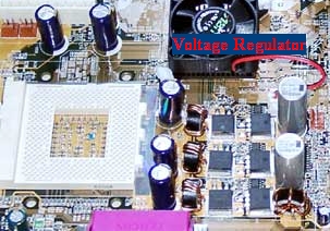

                                Let's see... what I believe is the VRM stage, the largest onboard inductors and fets or VR's are accompanied by too very large 4700uF Nichicon canister type caps and then the CPU slot itself is surrounded by 5 3300uF caps, which is no problem. The 1500's are sprawled all over the place. Two are between the motherboards input cable and the RAM slots(2 of the 4 I can't fit), three others are next to some other minor VRM looking equipment on the other side of the RAM slots, the last three of them are next to the AGP and a PCI slot(another 2 of which I can't fit).

                                  if they are dotted all over the place
                                  I can't really see a problem using the 8mm FM 1200 uf's
                                  (bugger re the link above anyway) here an articule with piccie
                                  (blame google picture search )
                                  Seems they are just by pass etc and not part of the VRM so yeah I dont see a problem. unless any one else does?
                                  If you lucky the bag might be more like 1500uf anyway , although can size, batch may alter the figure from the one's I measured
                                  BTW the 2200 uf @ 6V3 I have measured more like 2000 uf each so you can see the figure really is nominal.
                                  sorry I didn't order a bag of the others for comparison.
                                  Well good luck with it Logistics
                                  better then the crapola that was there
                                  The VRM input would be the big 4700uf and the outputs 3300uf most likely from what I can tell from the picture
                                  (these are the ones to really worry about ESR with)
                                  Cheers

                                        Here is a trim of the VRM circuit above,
                                        (I am not totally sure if the 2 caps near the ATX connector are part of it
                                        but 5 X 3300 = 16,500 uf 3 x 3300 = 9,900 uf)
                                        I suspect they are thought
                                        Someone here could tell you for sure
