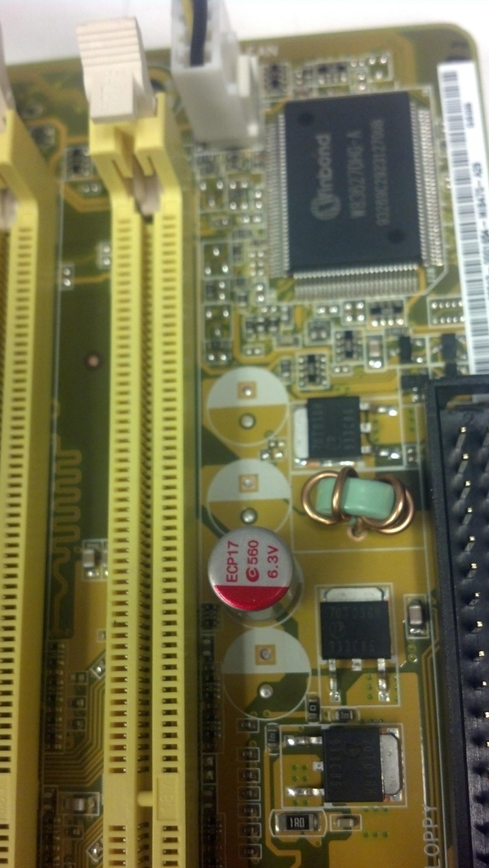

    I've never really thought much about adding missing caps, but on this Asus motherboard it looks like there is only one cap for RAM filtering. Would this benefit much from adding 820uF 6.3V nichicon HN caps? I was planning on leaving that Apaq if the added caps would help it. I think this motherboard has around 10K hours on it (Had lots of failed TK caps)

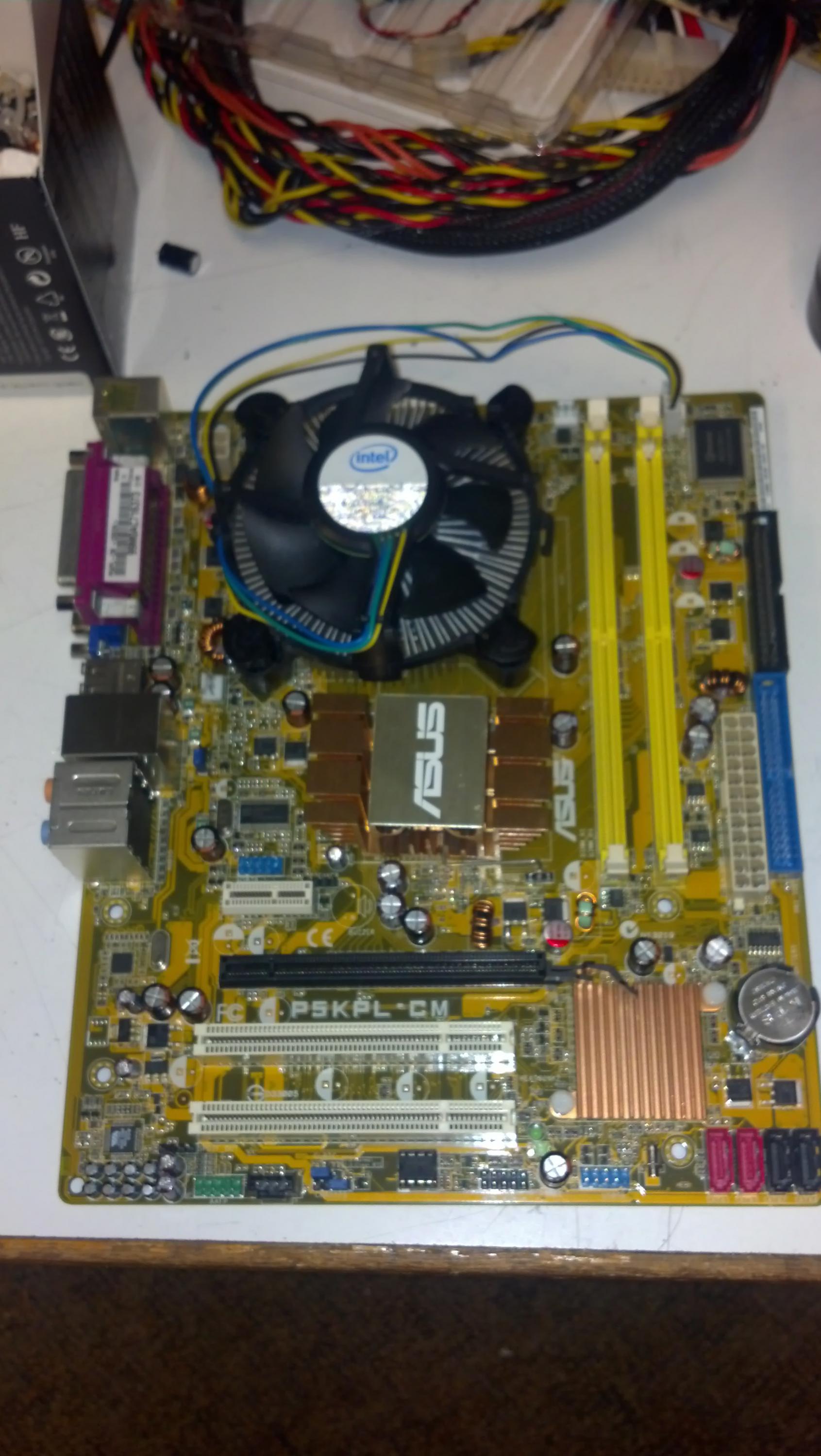

    Since this is an Asus board, there are quite a bit of caps that weren't installed throughout the board.
    *OT* I hate how Asus installs their caps to make it look like they're in backwards

    Looks like a synchronous buck type of regulator circuit is used for the RAM, so adding caps probably wouldn't be a bad idea at all.
    Also, since this is a P5 motherboard, have a look at this thread:
    https://www.badcaps.net/forum/showthread.php?t=32502
    And yeah, if you're not careful, it is easy to put caps in backwards on those ASUS motherboards. For me, I've done more ASUS recaps than other motherboard brand, so I have to be careful not to put caps in backwards on "normal" motherboards .

      Thanks for the reply. This thing has been in one of my daily rigs since the 29th so I guess I'll just solder on those HN's when I've got some down time on it. i was looking at pictures of other P5KPL-CM's and some use 2 or 3 KZG's, I guess one polymer was enough to get the job done for filtering. Although I don't 100% trust Apaq polymers, the board is getting low ripple from a good recapped PSU.
      I saw that thread, and I will keep it in mind yeah, I had to catch myself a few times!!

          Re: Installing missing caps on motherboards
          In synchronous buck regulators (like that one), I always like to see at least 2 caps or more doing the filtering. Relying on only one capacitor is just asking for trouble if something was to happen with that cap.

            what makes you guys think that if the capacitors were deleted from the final design, that the circuit traces are still live to them?

              In all likelihood, they weren't completely removed from the design. They were just not installed in order to cut costs. Usually, If I'm considering installing additional caps, I just check with a DMM that the empty slots are actually connected in parallel with the caps next to them.

                This motherboard looks to not have been planed to be a monster high-performance board for overclocking, therefore all the set of capacitors are calculated according to it capabilities.
                Capacitors are cheep for such industries, they did not use additional because this specific motherboard does not need them.

                  I'd like to see at least another cap there too but that poly does has a ripple rating of 6100mA which seems like plenty for two RAM sticks that won't be getting overclocked. Still might add some caps when it's down, like when I upgrade the Core 2 Duo to a Core 2 Quad Would it be worth the effort to replace the Apaq's with some higher quality polymers?

                    Sweet! I found a couple hiding at work. A Q6600 (2.4GHz/8M/1066) and a Q8200 (2.33GHz/4M/1333). Stock, which one would be better? I'm thinking the faster FSB would be better than more cache, but the Q8200 also has 10TDP less.
                      You think it actually take effort to replace a cap?!
                      Yeah, I would say go for it.
                      As for the CPUs, I'd say both would be similar in terms of performance.

                        Yeah, I figured. I think I will go with the Q8200 because it's 45nm
                          My eyes and a meter for starters. It would cost them more to retool the line to not include the circuit traces in most cases when producing the boards.

                                I'm running stock so I decided to go with the Q8200. brethin, what values do you normally add when you are installed the missing capacitors, just the same values that are in the vicinity or do you measure voltage and just add something like 1000uF caps?

                                  Assuming they are in parallel, then I'd just use the same as the other nearby caps (in your case, I'd go with 560uF polies)
                                    Why would they remove the traces and leave the holes and silkscreen markings?

                                      There can be other explanations for this.
                                      They could have designed the board that way to give them option to use cheaper electrolytics and parallel them for lower esr. The esr was probably low enough with a single polymer capacitor so they had no need to fill the other locations.
                                      Other explanations... could be that the designer just copy pasted the whole circuit for the memory from a similar model with 4 memory slots. Or maybe the design changed at the last moment.
                                      Anyway, this particular board.. they cheaped out quite a bit on everything. They dropped the capacitors by the pci slots, the ones for the pci express... some pci cards could be unstable but I guess they just figured nobody uses quality pci cards anymore.
