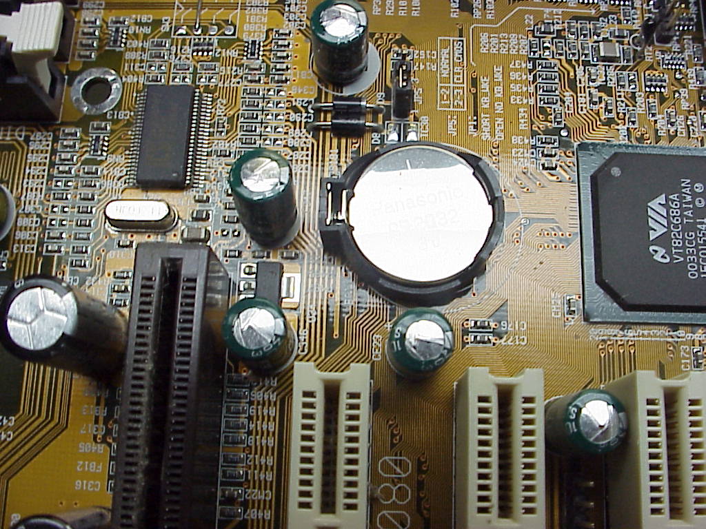

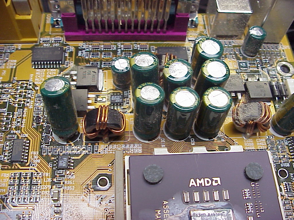

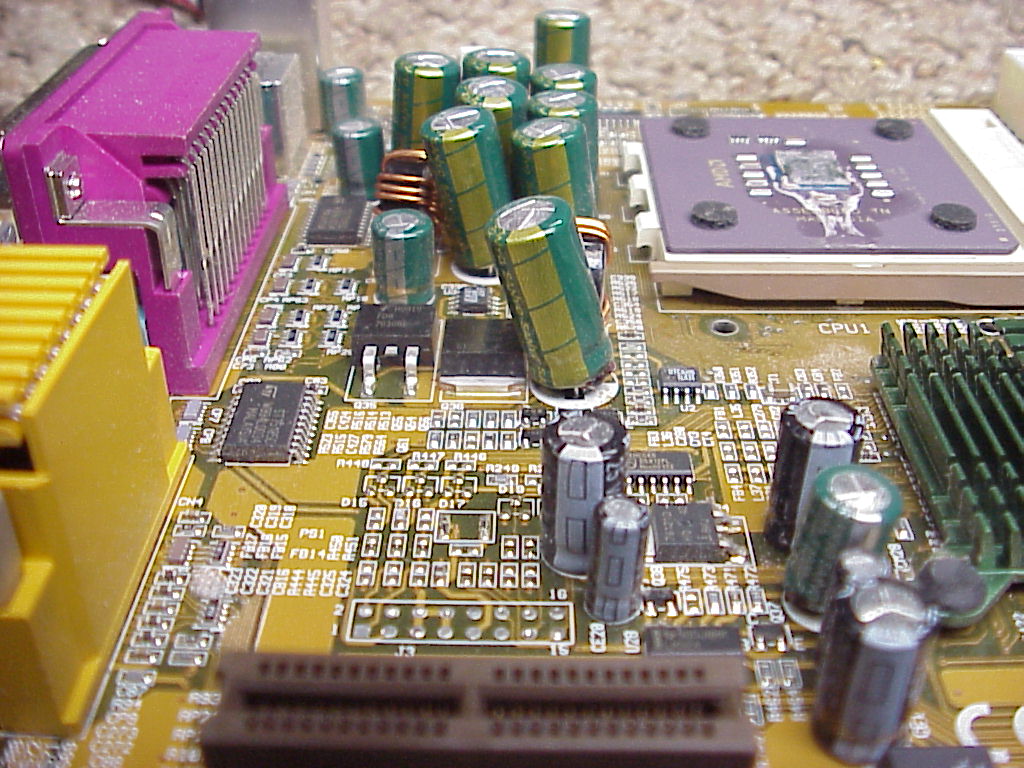

    unknown 462 mobo with many popped sanyos!
    had a pos psu but no bad caps in it.
    nearly every sanyo on this board is blown.

    Wow, never seen a blown Sanyo, let alone more than one.. Are they marked as Sanyo WG's??? You might have had a CPU overheat condition there, looks like the caps closest to the CPU suffered the most.. I've got a KT7 with some blown Nichicon HD's on the VRM input side, and it was obviously overheated as the board actually changed color in the VRM section to a darker shade of orange. Of course the CPU survived somehow..

      Re: unknown 462 mobo with many popped sanyos!
      Maybe someone tried to do a fanless system?
        btw this is a transcend board.
        it had good airflow.
        i bet the "gutless wonder" AN psu was to blame here.
          the psu may have contributed to the failure but caps blowing their bung out is an indication of bad manufacture / poor raw materials. do they look like fakes?
