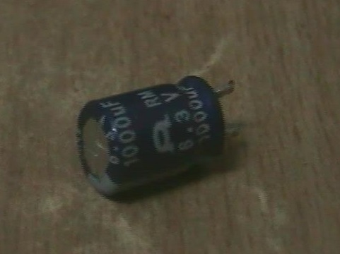

    Hi forum members i'm new to this motherboard capping thing. 5 days back my pc started showing unusually high temperatures in the cpu vcore ,hdd and other components some thing like cpu=72 c, HDD= 65 c etc and i started getting really worried then the next the the computer totally started giving weird errors like blu screen and hangin and shutting etc untill 2 hrs later it stopped even booting... i used the pc anyliser (ordered from ebay 6months ago) and it atleast give me an idea that the cpu is fine the i checked the other parts one by one till i came to conclusion that the board was the culprit. then the next day a friend ofmine came to fix his pc to my place i made his pc and connected online to check for solutions of what could be the problem. after nearly half a day of searching i landed on badcaps forum and read that capacitors regulate voltage(and symptoms of bad ones were the same as mine..) so i checked board again and found 15/16 capacitors were bulging and of those 6 were in critical condition i.e. blown from the bottom..... that evening i went to nearly all the electric shops but could, get the required capacitor i.e. 820uf 6.3volt 105 c the closest i could get was a capacitor with A -->(1st issue =A=?? what brand...??? even shopkeeper doesnt know...)written on the top 1000uf and 6.3volts 85c-->(this is the second issue the 85 c instead of 105c ) which is worrying me i replaced all the caps with these ones and started up the pc and it booted and is working but i didnt use pc for more than 15 mins as i thought i'd ask here for advise as what to do
    1. 1000uf 6.3v 85c--(is the only cap available in my area)
    2. online ordering---(didnt find a site in india to order from as order from out is to expensive cause at that rate i'd get a new board)
    3. i used these and i want to know that how long it might work till i get the rated ones from one of the metro politian cities)....
    please advise as i didnt turn on my pc yet and still using my friends PC...

        Oh man the long text without paragraphs is killing me.
        you need: 820uf 6.3volt 105 c
        820uF is capacitance. You should keep it the same, since you don't seem to have experience in electronics. Sometimes it's possible to use the next standard capacitance value (which is 1000uF) but it really depends on how that capacitor is used.
        6.3v is how much voltage the capacitor can handle. It's a higher limit, so you can use a 10v rated capacitor, or a 16v rated capacitor and it will still work. The rating just has to be larger than the maximum voltage going in the circuit where the capacitor is.
        However, capacitors with bigger voltage ratings also have different specifications which can affect how the circuit works.
        A followed by some numbers doesn't tell you anything. It's most often a company code which tells them the batch number of the capacitor for quality control purposes, or it tells you when the capacitor was made (usually in the format yyww - yy = year ,ww = weak of the year)
        Capacitors are rated in hours at a temperature. That value means the capacitor will work within some quality parameters (the uF value +/- 10-20%, esr +/- some percent, etc) for up to that many hours at that temperature.
        If the temperature is lower, then the capacitor will live longer.
        Traditionally, it is said that with each 10 degrees Celsius lower than the rating, the number of hours doubles.
        So if you have a capacitor rated for 2000 hours @ 105c, you can say it's 4000 hours @ 95c , 8000 hours @ 85c , 16000 hours @ 75c and so on.
        Your capacitor is rated for 85c, so you may have one that's rated only for 1000 hours @ 85c which means it won't last a long time if the motherboard is not kept cool.
        Anyway, the problem you have is that you don't know who made the capacitor and what specifications it has. Other than capacitance (uF) and voltage rating, you need to know how much RIPPLE the capacitor can handle and the ESR value (a sort of internal resistance).
        Motherboards require a special type of capacitors with very low ESR values and relatively high ripple values - 85c capacitors generally are not designed for this usage.
        In your case, the 85c capacitors may not be up to task: the circuit which delivers power to the processor may work with them just to start the computer or watch a movie, but if you do something serious with the computer, the capacitors may be simply too bad and "stress" that circuit, making it work harder and overheat or make your computer unstable. The capacitors themselves may overheat because of the higher internal resistance.
        Capacitors that work on motherboards are a bit expensive compared to those no-name 85c capacitors you find locally. Motherboard companies buy 10.000 capacitors or more at a time, so they get really good prices, compared to you buying 5-10 capacitors.

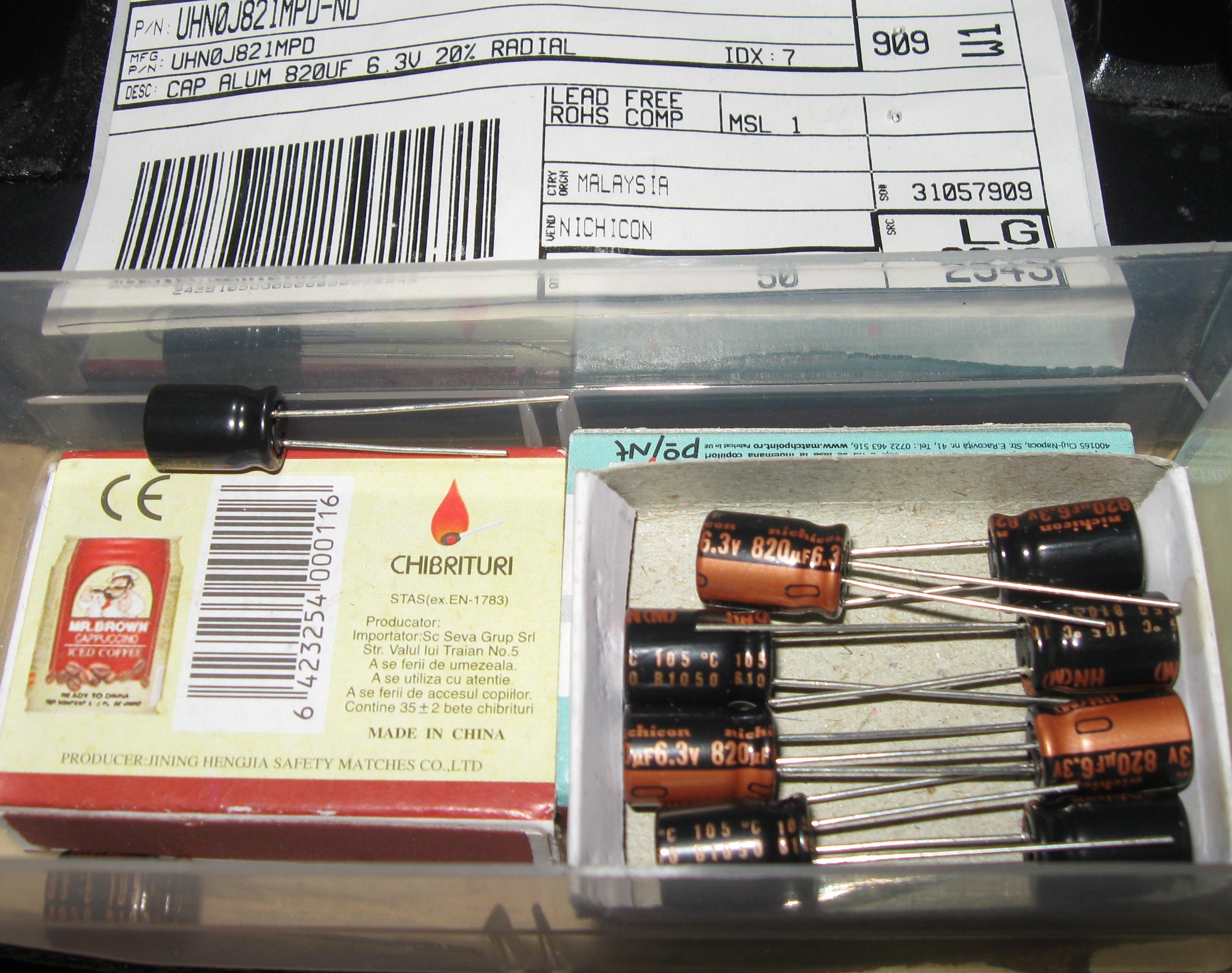

                    I just checked what I have here, and I have some Nichicon HN 820uF 6.3v about 35-40 pieces left from an order I made a couple of months ago.
                    Technically, they're better than the ZLH series from Rubycon but the ZLH should be good enough for your board as well.
                    I paid about 0.409 dollars for each which should work out at about 22.5Rs so if you have some way of paying me for them, i can send them to you for that price plus 2$ like i said, for stamps and envelope and all that. So about 8.5$ in total. Maybe add 1$ if you want expedited (to get to you in 7-10 days instead of two-three weeks).

                          Yeah, pretty much. If you have paypal, it works out super fast and simple. Just pm your address and tomorrow (monday morning) i'll send them..
                          like i said, probably about 25-30 left out of a 50pcs order (click to zoom):
                          I keep them in matchboxes so that they aren't affected by humidity and mostly because i don't like them just thrown in a bag.

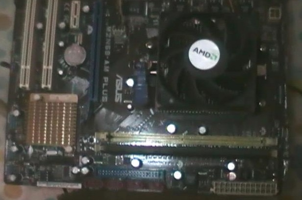

                                    Ok first of thanks everyone for helping and yaa i didn't turn of my pc till i fixed that over voltage issue
                                    i went out for a while then returned on the 1st of june. i started working on my motherboard again with
                                    the new ZLH series i got from RSdelivers and removed the temporary ones(image below).

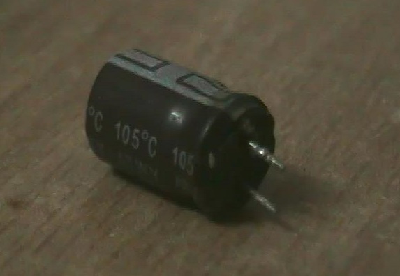

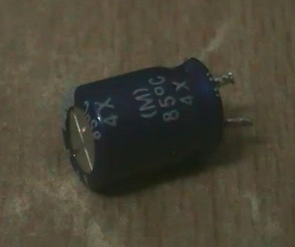

                                    this is one of the old busted cap 1 of the many 16 caps. i don't know what make it is(only written TK)

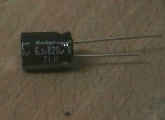

                                    and this is the new good one
                                    fixed all new caps and now my board is back to normal with hdd temperatures around 39-45 c
                                    the cpu normal temperature is around 52-55 and gaming temp is 59-64 which i guess is ok cause my friend
                                    said AMD athlon 64 x2 tends to heat a lot and thats normal (lol i wonder) and that left me with just the gpu
                                    heating 64c to 68 c weird but then when i asked in another a tech here he said Zotac gpu have heating
                                    problems so watch out for that...
                                    well all is ok now... My system is 4years and 3 months old (including the GPU) and all parts served well
                                    without any issue till this problem.
                                    I guess its time to bid them farewell and get a new system......
                                    One more thing i forgot to mention...My smps power line for the board cpu (the 4pin socket ) i said in previous
                                    post that the wires were hard and they were like burnt, well i had and old broken smps so i switched the wires with each other and i noticed the old ones wire had more temperature tolerence than my current smps (old broken smps 95 degree c and the burnt one i removed was 85 c) and also the wires were more thick....
                                    Now everything is working fine.....
                                    Thanks everyone for the help ......

                                      Looks Good. Your old caps were TK brand. It stands for Terrible Kapacitor (OK, just kidding. It's Toshin Kogyo). They are one of the most unreliable brands I know of.

                                        That looks like a Partsnic cap
