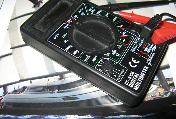

              yes. you can get one for about 5-10 euro. Here is a cheapie one (and a very common design) i think its a necessary item for the toolbox.

                And will a cheapie one do? or are cheap ones really bad?I'll try and get one of those on monday.

                  the above one is a DT-830B which is a very common design used by many manufacturers. i think its fine and very useful.
                  i cannot guarantee that it will be useful in this specific case but for the toolbox definitely i could not work without one.

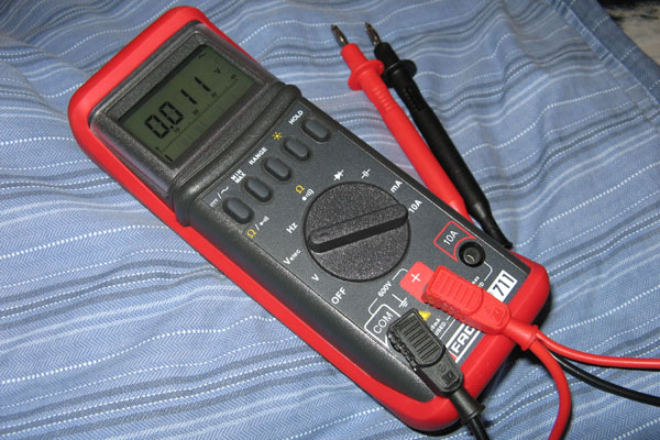

                                  • Spacedye69
                                    • Nov 2005
                                    • 698
                                    • US
                                    Re: MY pc wont turn on!! HELP!!!
                                    Wait till the disease called Walmart spreads to your area. They have them there for around 12-15 USD.

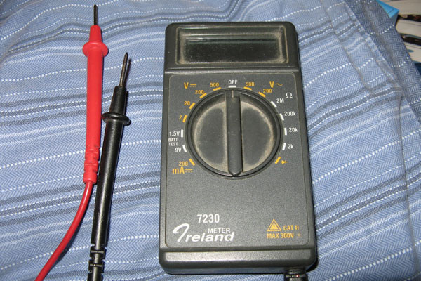

                                    • willawake
                                      Super Modulator
                                      • Nov 2003
                                      • 8457
                                      • Greece
                                      wait until the pakistani street vendors come to ireland. i got one with temperature probe for 5 euro
                                      but yeah they can cost up to about 200 euro and over especially if they are called fluke (hello tiresias)
                                      this one is really cool cos the probes are designed to fit in AC sockets. actually its not even mine, its my dads, i think i have some explaining why its in my toolbox.
                                      shit i even have one called "ireland" lol
                                      if you dont have one of these you are just not cool in my book.
