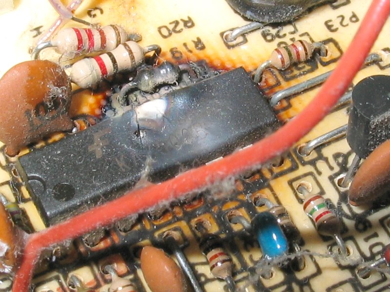

    I received 3 VP6's this week that were completely trashed. I get emails and contacts all the time from customers who say "It would only crash once in a while", or "I didn't think the problem was that serious"... ARGGGG.... This VP6 is a prime reason why the minute you suspect or discover bad caps, replace them!! Don't wait!! Bad caps will not cure themselves!!
    Sadly, this and the other 2 VP6's I received like it were destroyed. I didn't even bother to recap them , because the VRM FET's and the AGP power FET's were all shorted, and the torroid coil by the AGP was burnt beyond recognition. With damage like that, the voltage regulators are always fried, and many times the northbridge is also fried. In this particular VP6's case, it also BBQ'd 2GB of really nice Micron ECC PC133. You will note from the pictures the melted labels. This shouldn't have happened!! The only thing I pulled out of that board that was good was the CPU's, and I'm surprised they survived.
    If you question your caps, take an expensive lesson from the owner of this board! REPLACE THEM ASAP!!!

      break out the marshmellows baby........anyway, that is a perfect example for a class lawsuit. When you are dealing with fire hazards that is a major issue. Imagine a server cabinet burning down over the weekend from a bad PSU. It would not be pretty.

          Something like this K7S6A? It's not my board - owner http://daso.wz.cz

            i have seen lots of those type vrm's melt down like that.
            and it always kills the cpu.
            esp. amd chips.

              Similar...but the FETs did not desolder themselves

                The desoldered devices on which you can recognize the mfr's logo - possibly Shindengen - and most of the mfr's P/N, S?S2525L, are dual rectifiers. The devices that are "extra well done" are the MOSFETs. I'll bet the smell was delightful ...

                  I've repaired some boards with this problem (some K7S5As and M805LRs) but they weren't as bad as this one. The MOSFETs were always bad, the rectifiers were always OK. Some of the base driving transistors were bad, some were OK - the older boards have two separate SMD driving transistors for each MOSFET, K7S6A has only two for all MOSFETs (at least they're in TO92 so can be replaced more easily). And of course bulged caps - always G-Luxon.
