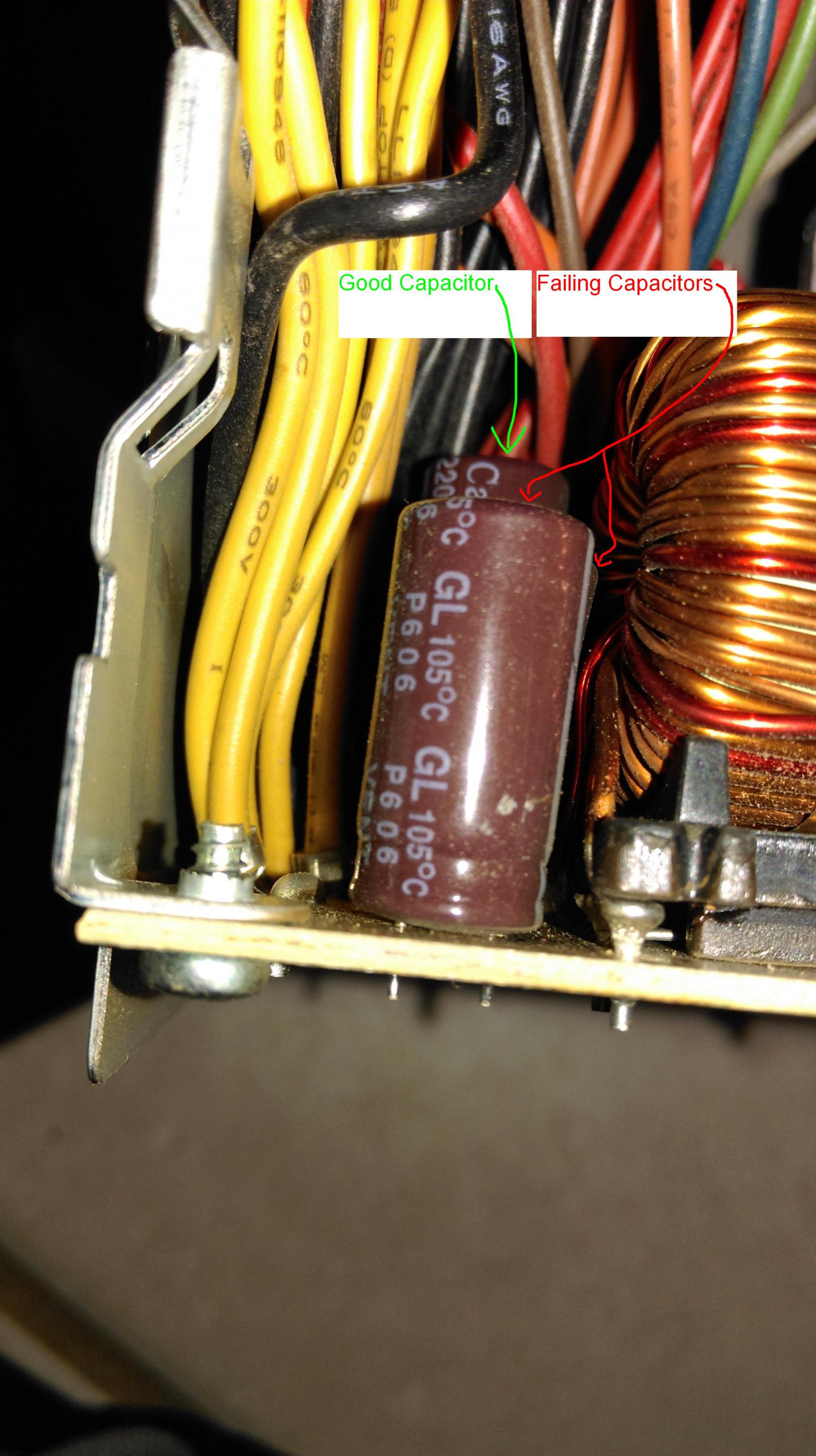

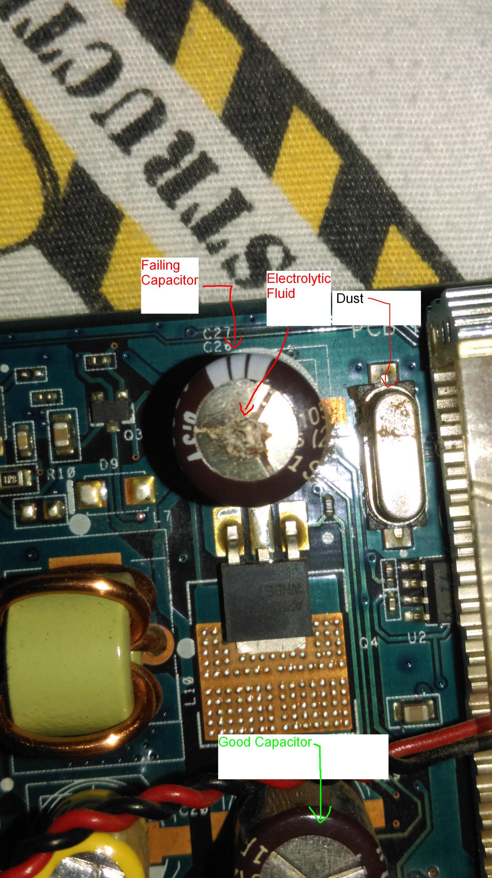

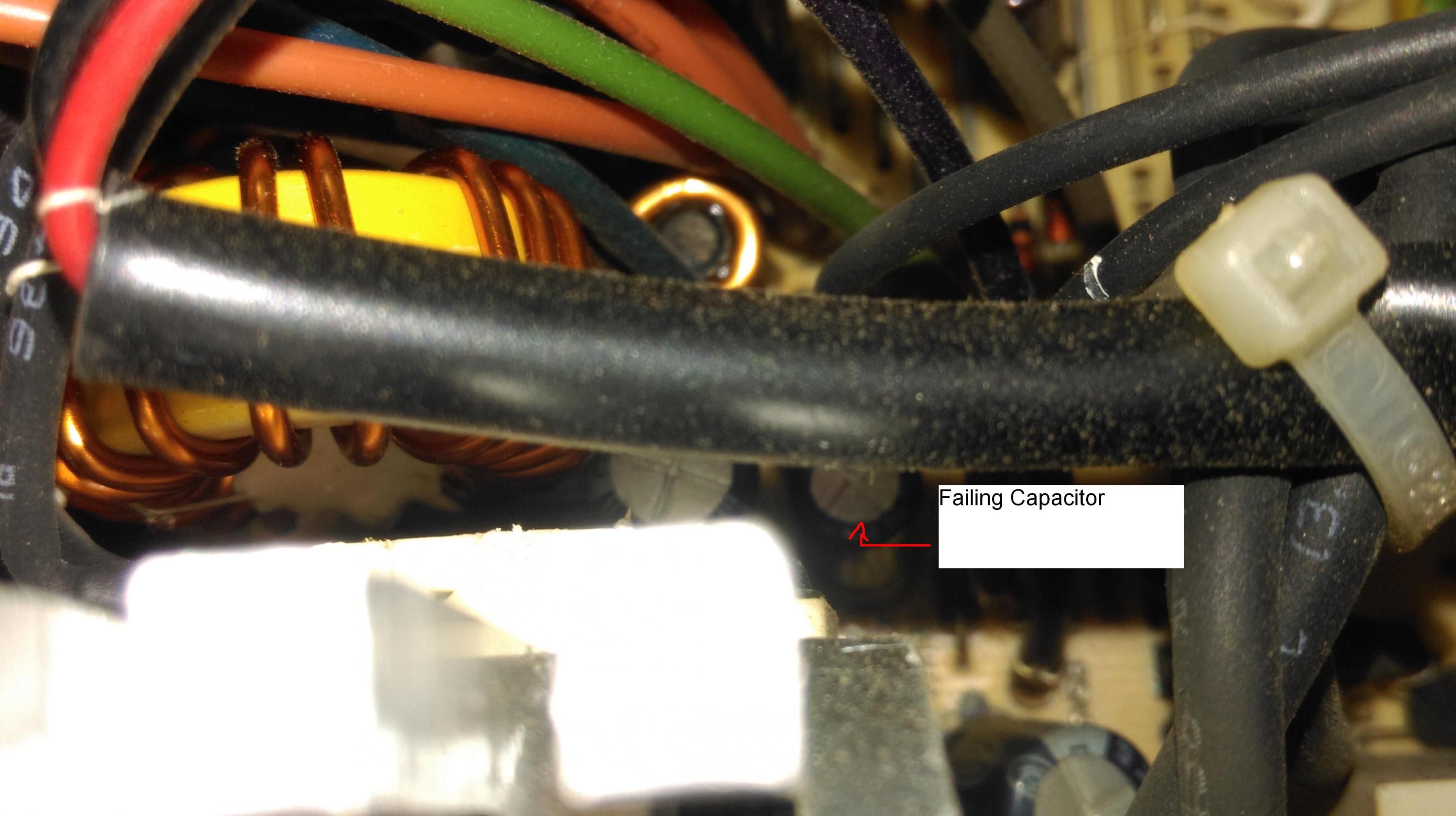

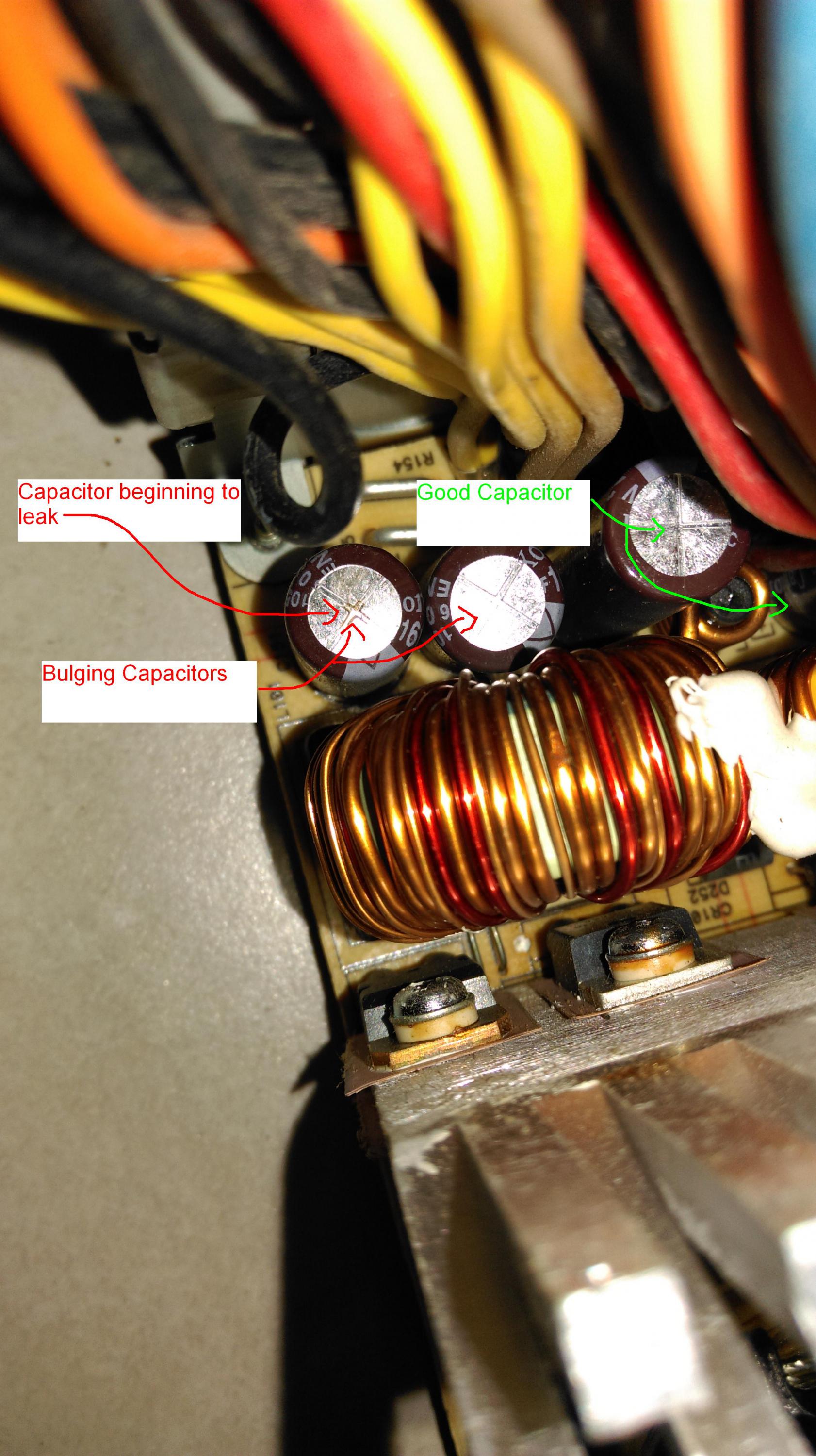

      I have a 8 year old computer (may not be 8 years old) that has a PSU and a GPU with bulging caps. For whatever reason, the computer still works. The GPU issue probably started while this computer was being gamed on by some friends.
      Photos:
      PSU caps:
      https://www.badcaps.net/forum/attach...1&d=1420420251
      GPU cap:

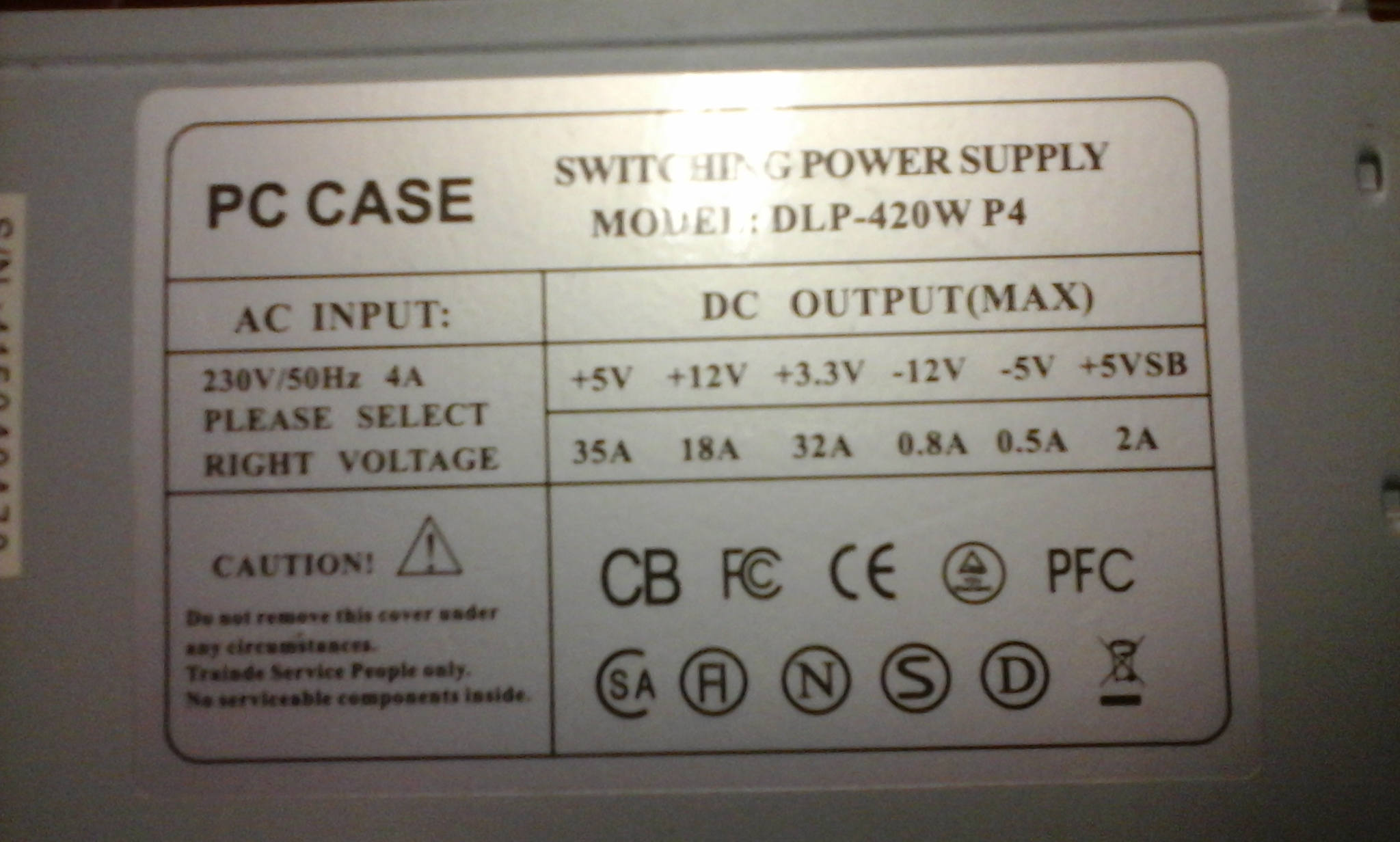

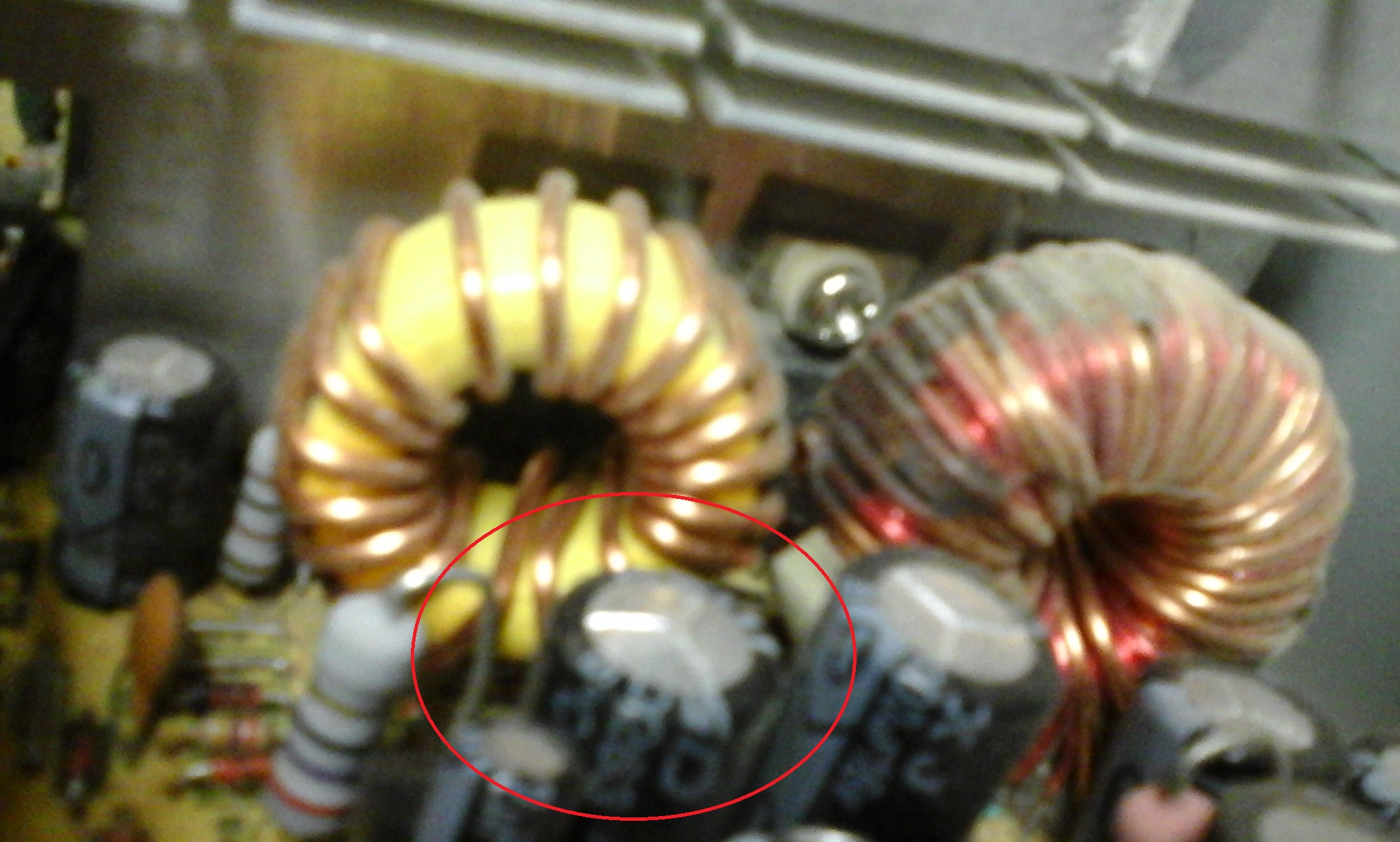

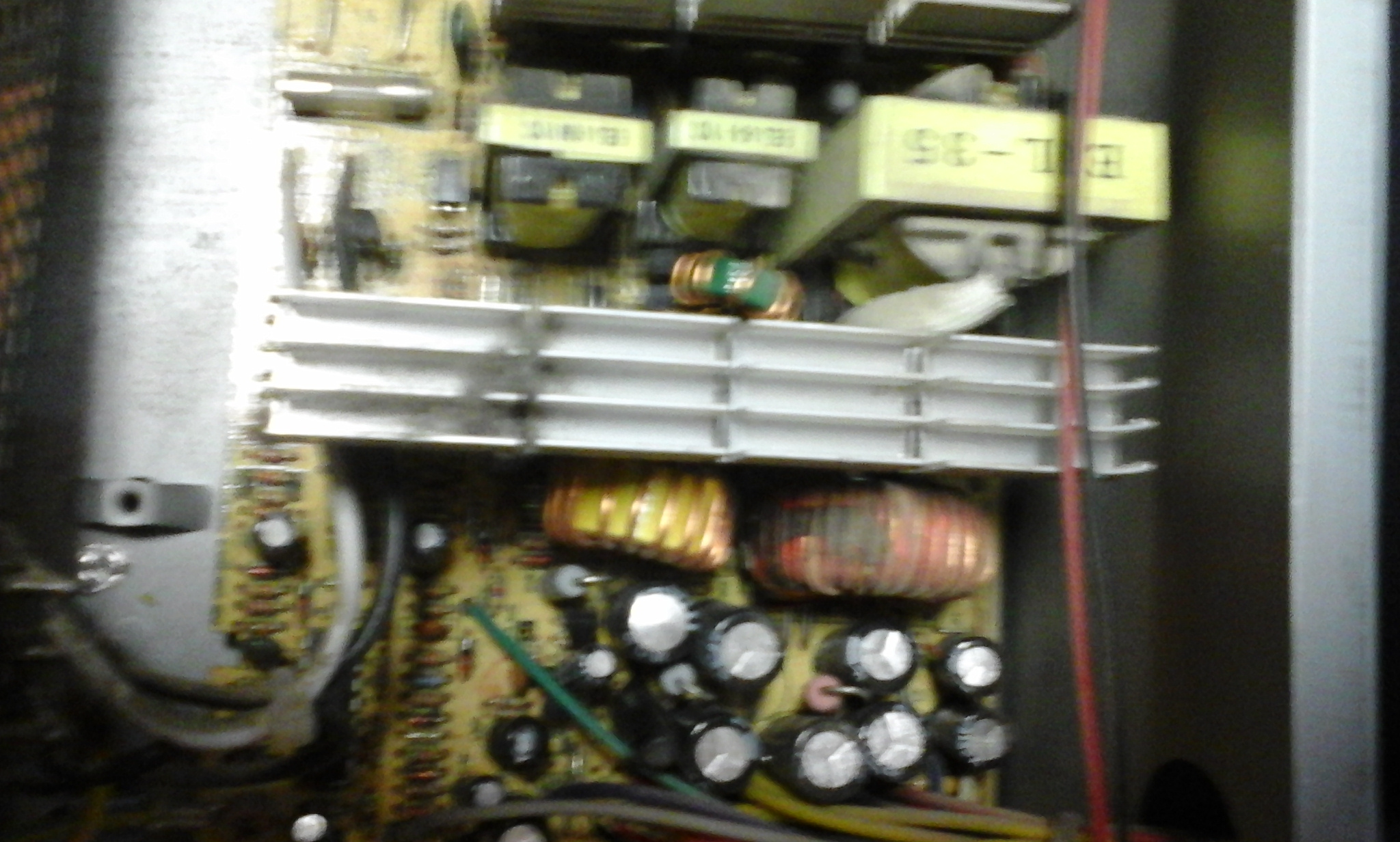

        PSU pc case kill the motherboard (motherboard repaired, working now):
        Label PSU:
        PCB:
        Bad cap: (brand unknown)
        Motherboard killed:
        Therefore, should not put sources of cheap supply.
        Bye

          #44
          Re: This is Why You NEVER Ignore Bad Capacitors!
          The PSU probably had nothing to do with it, unless you already replaced them the 16v capacitors that are directly connected to the psu's 12v are not affected. The KZG capacitors are after the dc-dc converter for the cpu.
          The KZG series of capacitors from UCC is notoriously bad, they go bad in time in lots of computers even if they were equipped with high end power supplies.
          They probably died due to heat from the cpu heatsink and from simple "wear and tear", i mean long time use of the computer. Like i said, these series of capacitors is simply bad.

            #45
            Yes, there was a batch of defective KZG/KZJ.
            But this source was very unstable electrically, because broken a hard disk.

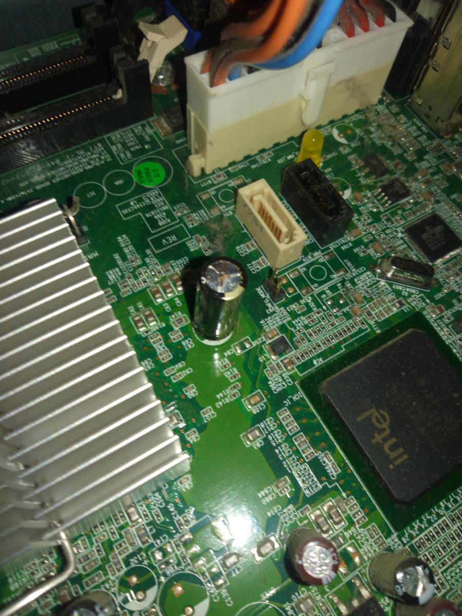

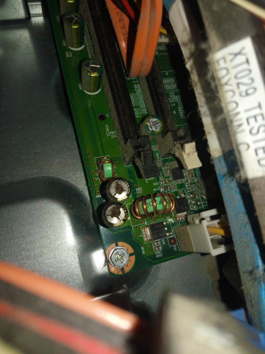

                                  Hello BadCaps users! This'll be my first post here.
                                  I recently got a Dell Optiplex in for repair, the symptom being overheating and shutting down randomly.
                                  Come to find, 3 motherboard capacitors have gone.
                                  I'm not sure of the brand, but if I'm not mistaken they're Nippons?
                                  They have a similar logo and I can't see the sides of them very well, I will take the motherboard out later and invesigate further, but thankfully these were caught before any severe damage was caused.
                                      Nippon Chemicon KZJ's
