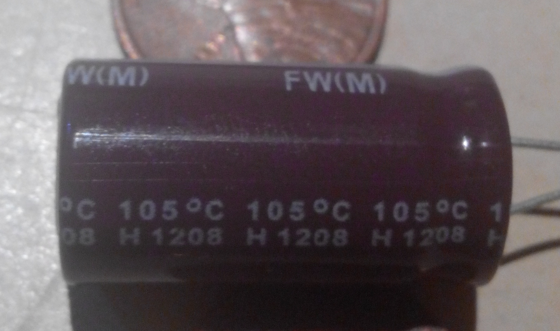

                                  • gunnish
                                    • Oct 2013
                                    • 33
                                    • Sweden
                                    Re: Any more info on counterfeit Nichicons?
                                    These got to be fake right?
                                    Cheap bung
                                    FW 105 degrees is unheard of
                                    Fw usually is not brown, but gold.
                                    • ben7
                                      Capaholic
                                      • Jan 2011
                                      • 4059
                                      Cheap bung
                                      Yep they are fake. Wrong bung and wrong color scheme.
                                      105 degrees celsius is a common temperature rating.
                                      Muh-soggy-knee
                                      • LLLlllou
                                        • May 2011
                                        • 201
                                        He meant FW series is an 85 degree series, not 105.
                                        ... and yes, they are VERY fake.
