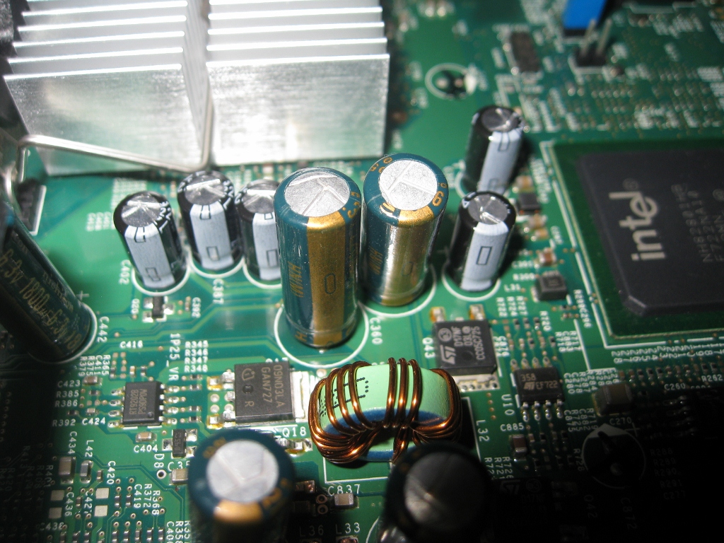

    Hi there guys,
    Great forum, just tried recapping a functional Dell Gx745 sff motherboard (BTX motherboard and proprietary).
    So... replaced 6.3V x 2200uF capacitors with new ones from Sayal Electronics here in toronto (Nichicon caps).
    The computer runs fine.
    HOWEVER, 2 of my new caps that I installed exhibit some mild "bulging" even before I powered up the system. I examined them all and tested them before installation with a multimeter so I knew they were at least visually good.
    Are they bulging because I overheated them? Is this of significant enough concern that I should recap them again?
    I used a 40watt Soldering iron to place on. Maybe should have used 40W to remove caps and 25 W to solder on.
    Many thanks, I'm a newbie to motherboard recapping.

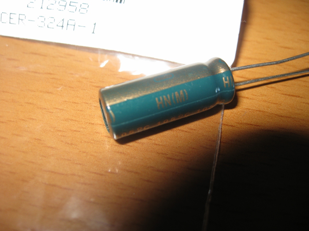

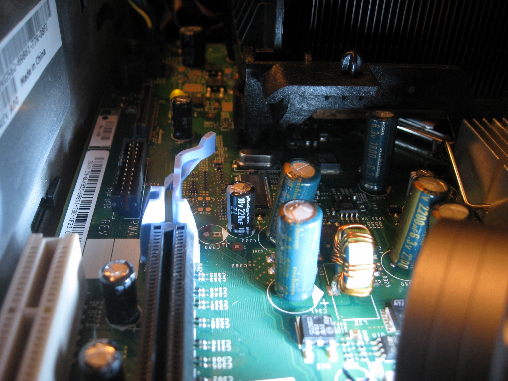

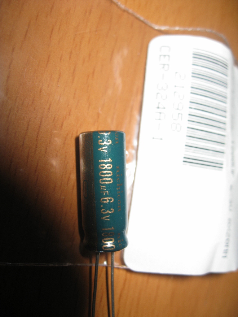

        Many thanks for the quick replies. I have taken some pictures and included them here.

          AFAIK Nichicon caps don't have a K shaped vent, so they're probably fake. The K design also looks like a Sanyo type, so it's probably the same company who makes the fake Sanyos. Every Nichicon I've seen has always had a cross shaped vent (+ or x).

            Those are definitely fakes.
            Nichicons always have a "X" vent on top, not a "K". The color scheme is wrong too.
            Nichicon HM/HN are black with white (sometimes gold?) text, not green with gold text.
            You've been ripped off. If you bought them on ebay, leave negative feedback.
            edit: oh and that's more than just a "mild bulge". These have already failed without even being used. Should tell you something about the "quality" of those caps..

                Better recap it again very soon before they take out a MOSFET or leak electrolyte on the motherboard.

                        No, it's very unlikely you damaged them from the soldering.

                            In my experience, it takes A LOT of heat to kill good caps. I know because at the place where I work at, we regularly reflow Xbox 360 consoles and when we do that, the caps often heat up to 100+C on the machine. So far, all of them have been fine as long as the heat doesn't go much higher than that. If the board is left on the machine for very long, only then the caps would start to bulge - that's usually 10+ minutes where the whole board is at 220-230C (so the caps are probably no less than 150C).
                            In any case, I very much doubt your caps could have reached that temperature by just heating them with a soldering iron. More than likely, they bulged because they are cheap fakes.

                              They are obvious fakes, thats the sole reason they died. a soldering iron (even a good one) can't bulge a cap unless you intentionally try to... as in keeping the iron on the joint for hours and hours.
                              Get some real caps at the badcaps.net store and redo the recap. Every cap you installed needs to go, even if it hasn't bulged. Fake caps only belong in one place, and that's the "never buy" list.

                                      They look quite like these. http://m.dealextreme.com/p/16v-2200u...ece-pack-91279
