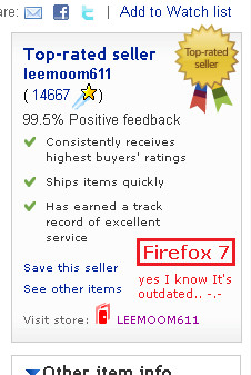

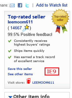

        Re: Fake Rubycon MCZ?
        He has 99.5% positive "feedbacl."
                Still using IE? shame on you :P
                That only happens if you resize the window in IE. In Firefox etc., it's fine.
                  I did use IE8, but I didn't resize the window.
                    Well.. depends on the screen resolution :p
                    On my desktop, I pretty much have to resize the window to get that glitch (1920x1080), but on my netbook it's always there due to the tiny resolution (1024x600)
