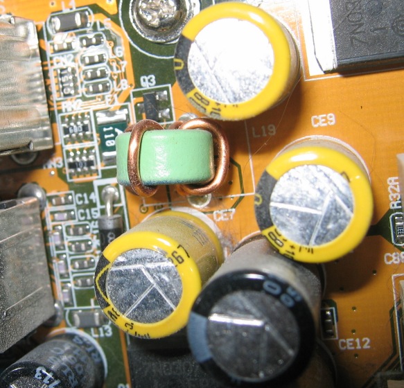

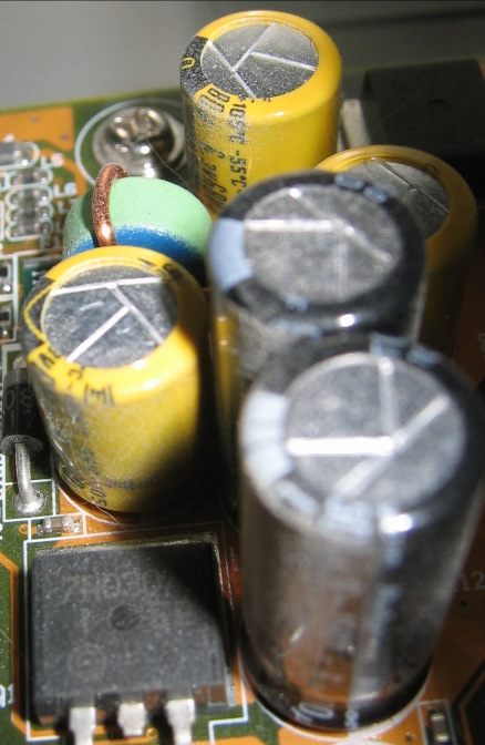

      Here are the photos of the yellow caps - perhaps you can identify them? The tall black caps are definitely Rubycon (not Rulycon), a good make.

        they are fujitsu fpcap. on rare occasions they can have problems.
