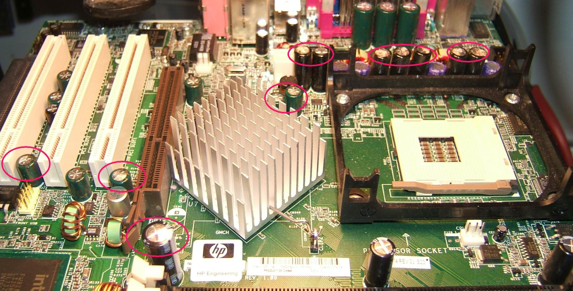

    My HP board has two failed caps near the cpu socket. They are rubycon 6.3v 1800uf MCZ should I replace the two failed ones with the same brand/type or replace all 7 with a something else?
    If only replacing the two that failed does the brand matter or just the specs?
    Re: Looking for a good substitute
    What has caused the MCZ caps to fail? Please list other capacitors on your board. You should also open up your power supply to look for bulged caps in there. MCZ should not ordinarily fail and they probably failed because other lesser caps on the motherboard or in the PSU have failed and placed more ripple on them.
    MCZ can be replaced with Nichicon HM or other Rubycon MCZ which the owner of this site sells. The owner also carries Samxon GC which is another suitable replacement for MCZ.

      I have not disassembled the system yet but I just found a post from another user that has a identical board.
      Here.
      If you at the board the two that failed are right next to the P6 connector.
      There are 7 of the rubycon's and 4 others as you see in the pic that I cannot make out the writing.
      On my board the four are yellow and half the height of the rubycon's.
      I will pull the PSU this weekend to check if any caps have failed inside.

        You see those two brown caps to the left of the black memory slot? Anything like those will also have to be replaced.
        The yellow ones are Fujitsu Bumblebees and the blue ones you see in this picture are Sanyo OSCONS. According to PCBONEZ, the yellow ones are superior to the blue ones.

          If you don't mind me asking, why do those have to be replaced? On my board they are blue Teapo 1500uf 6.3v
            in the pic above, they're Nippon Chemicon KZG, which can't stand heat and fail without bloating.
            same thing goes for teapos..

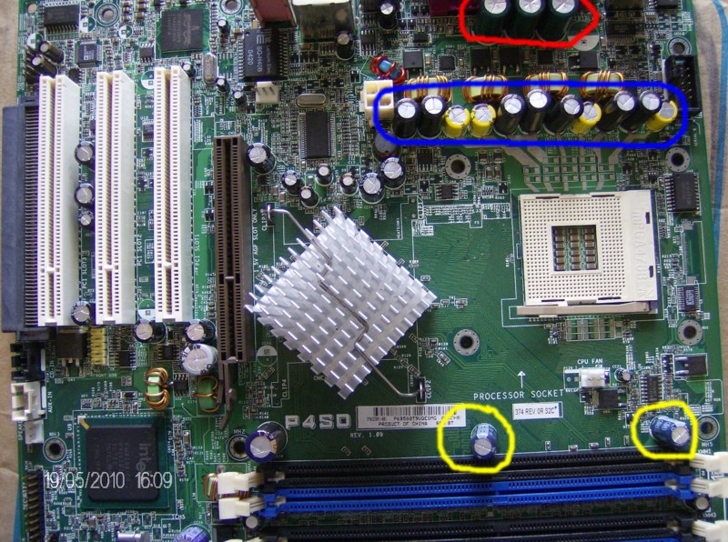

                          OK guys I think I'm confused, so lets back up a bit if you please.
                          here is what my board looks like, same revision as well.
                          As I said before the only two that are leaking are the two next to the P6 socket just to the left of the two yellow caps.
                          they are rubycon 6.3v 1800uf MCZ seven total.
                          I don't know what the yellow ones are or even if they should be replaced but they say 2.5v 820uf adnd as you can see there are four of those
                          The two by the black memory slot say Teapo 1500uf 6.3v and the one larger one by the P in P4SD says rubycon 6.3v 3300uf mbz. The three back by the parallel port say teapo 16v 1200uf.
                          I understand that poly caps would be better in place of the 7 rubycon 6.3v 1800uf MCZ.
                          here are my questions
                          1. If replacing the 1800uf rubycons do I also replace the yellow ones as well and with what.
                          2. other than the two teapo's next to the black memory slot should any others be replaced.
                            Caps circled red (Assumimg they are 1500uF, 16v)
                            Caps circled blue
                            Caps circled yellow (Assuming they are 1500uF, 6.3v)
                            I'd probably replace the yellow ones by the CPU, since, I have known them to bloat and fail. All of the others should be fine.

                              Thanks for this info.
                              The ones circled in red are teapo 16v 1200uf would the ones you suggested still work.
                              Also everything circled in blue gets replaced with the same poly caps correct/ even though they have different values?

                                You've pictured a board worth saving with Rubycon and Panasonic in all the right places. Only a few caps are bad and should be replaced. My board 323091-001 is not worth saving and is only good for showing where the hot spots are.
                                12v: Teapo SM 1200uf 16v (qty 4)
                                Vcore: Sanyo OSCon 820uf 2.5v (qty 4), Rubycon MCZ 1800uf 6.3v (qty 7, bulged)
                                Memory: Nichicon HM 3300uf 6.3v (qty 1, bulged), Nichicon HM 1500uf 6.3v (qty 2)
                                Board: Teapo SC 1000uf 6.3v (qty 10, 4 bulged)
                                Small caps: G-Luxon, GSC, or worse

                                        Originally posted by v b chil-n View Post
                                        The ones circled in red are teapo 16v 1200uf would the ones you suggested still work?
                                        Yes. Generally, you can get away changing the capacitance slightly. Also, it looks like you have an extra unused cap spot there. If you like the idea of poly moding them, you could use four of these. It's a significant drop in capacitance but it works fine with polys.
                                        Also everything circled in blue gets replaced with the same poly caps correct? even though they have different values?
                                        Yes. The yellow ones are actually polys. The reason for replacing them is because if they are different, you will be putting more load on some caps than others, so replacing them all is a good way of evenly distributing the load.
