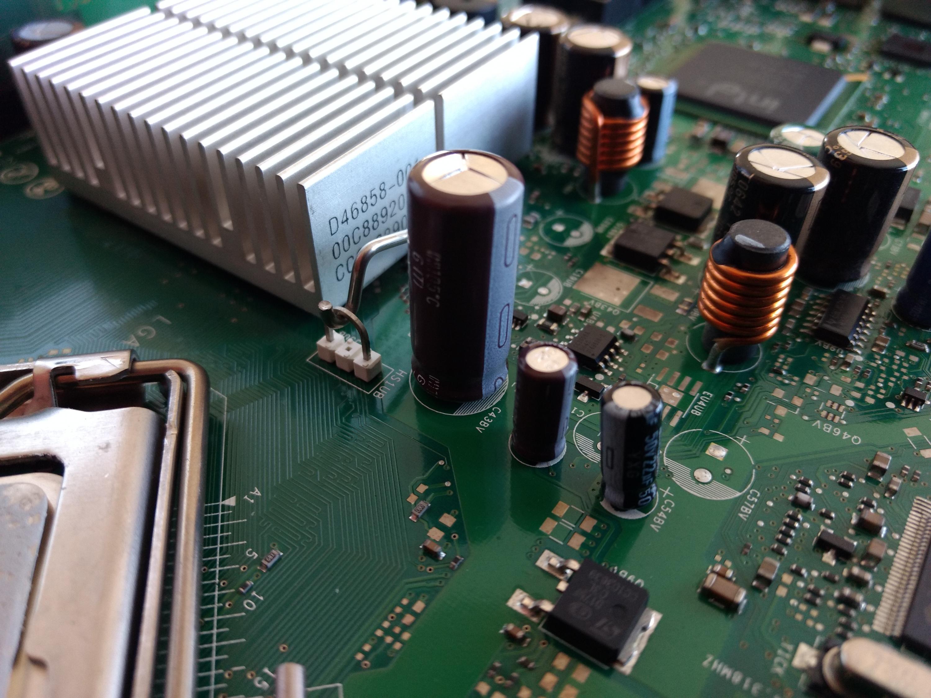

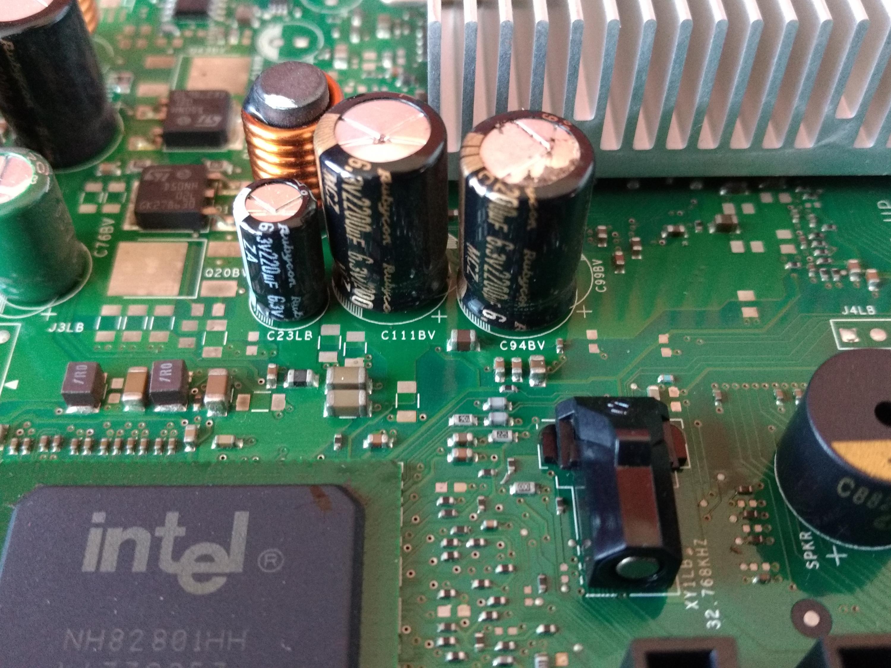

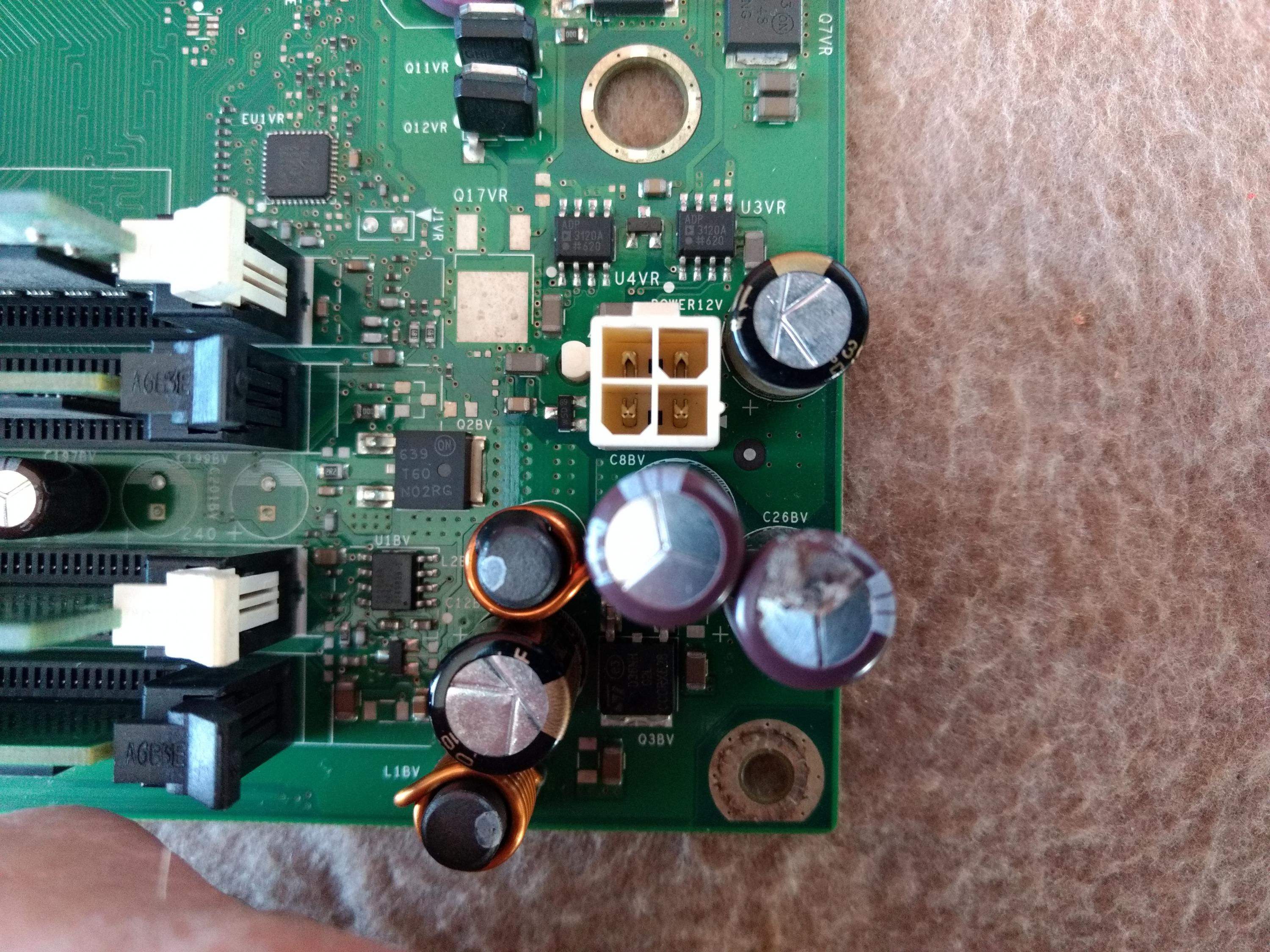

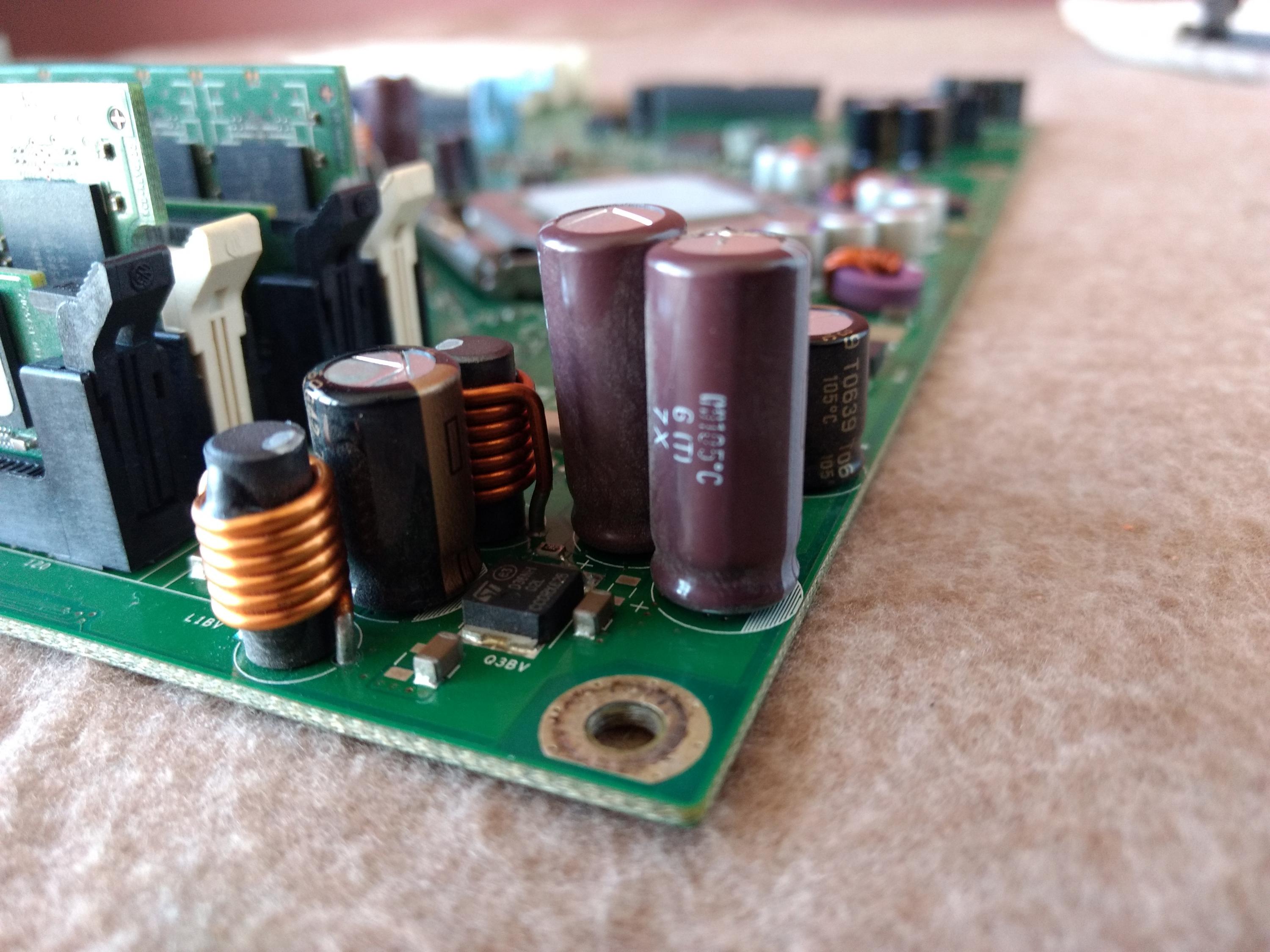

    Hello, I'm working on an old Dell XPS410 with burst capacitors. I'm trying to source either an equivalent replacement, or a replacement that will work. It's been suggested to me to use Poly caps as a replacement, but I have no idea what to order or what will work.
    If anyone has a link to where I can buy what I need that would be even better.
    These are the caps that have burst:
    Board location: C8BV, C26BV, C43BV
    Brand: United Chemi Con
    Series: KZG
    Size: 10mm dia X 25mm height
    Impedance: (ohms max/20c, 100kHz) .012
    Ripple: 2800 @100khz
    Ratings: 6.3v, 3300uF
    Board location: C94BV, C111BV
    Brand: Rubycon
    Series: MGZ
    Size: 10mm dia X 20mm height
    Ratings: 6.3v, 2200uF
    I have added pictures below. Thanks for your help everyone.
