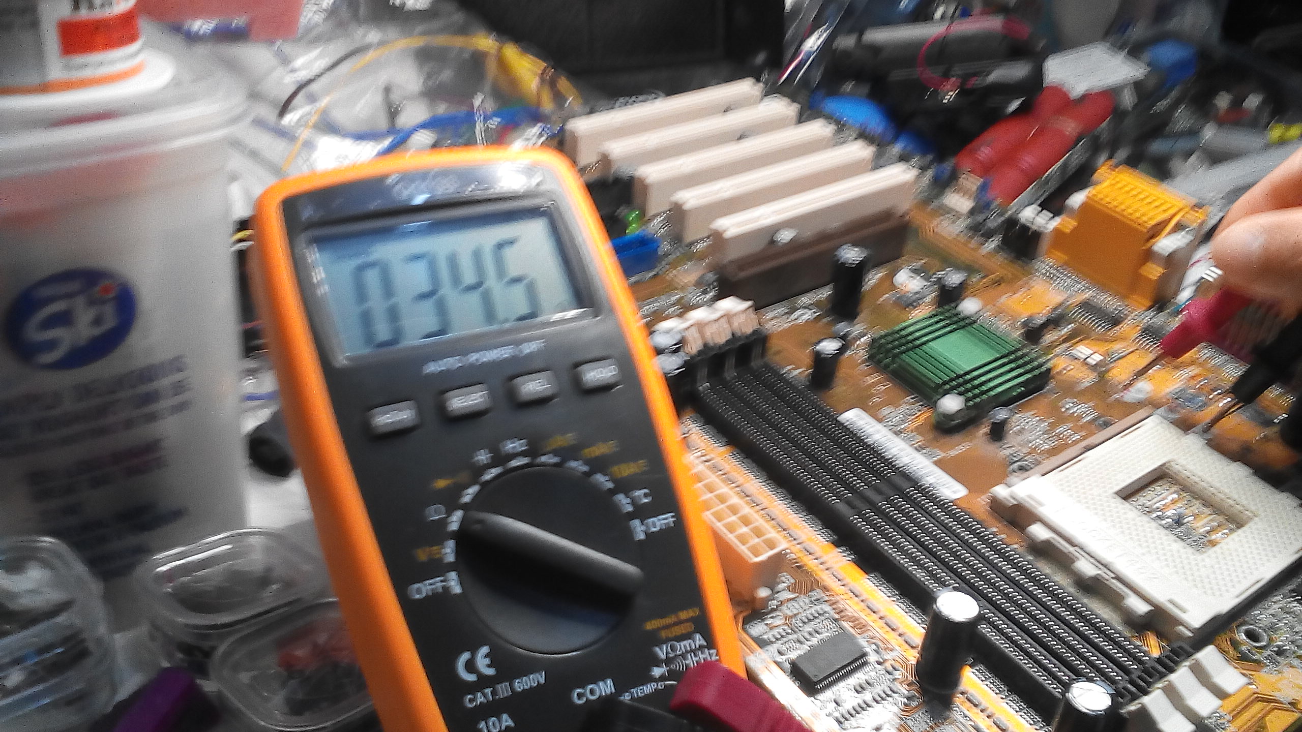

Yes we are talking about capacitors, but I'm testing the resistors as well near the capacitors while I'm there, curiousity....
I'll let you know the resistance value of the capacitors I've taken from the bottom of the CPU...Comment

Why don't you concentrate on that section first in the diagram instead of moving to another section?
Where does the output of that section go to?
The low resistance still there ON THE OUTPUT CAPS if you lift L2, L3?Never stop learning
http://www.badcaps.net/forum/showthread.php?t=24809Comment
Re: Testing VRMs
because there's no short to the ground from that section....with the value 35 ohms without CPU...
yes the low resistance is still there when I remove L2 and L3....
the output is going to the CPU....that section is taken from datasheet so it's not exactly the same with the board....but that's the chip on the board...
I can't measure the resistance of those capacitors with CPU since it's on the bottom of the CPU...Comment
Re: Testing VRMs
So you are getting 9 Ohms when CPU is installed and 35 Ohms when CPU is removed?Never stop learning
Re: Testing VRMs
yes 35 ohm without CPU.....now 35 ohm only from those small capacitors below the CPU...
do you reckon one or some of them are faulty ? because from my experience...ceramic capacitor never give me a very low resistance....
Have you got one before with SMD MLCC faulty ? overvoltage and overheat from the CPU I reckon ....Comment
Re: Testing VRMs
BTW, you never tell us what dcv you were getting at the output of that power supply.Never stop learning
Re: Testing VRMs
cearamic capacitor never give me a very low resistance: when they fail they will short out or have very low resistance. MLCC cracked easily.Attached FilesLast edited by budm; 09-14-2016, 07:16 PM.Never stop learning
Re: Testing VRMs
BTW, do you other mother board that you can check the resistance of the Vcore and GND?Never stop learning
Re: Testing VRMs
From 7 caps I have taken off....value = 5uF and resistance is on level M ohm until OL...
which normal....character of charging of capacitor...I have another 16 to 18 caps to analyze now...hmm...abit fiddly...small on the bottom of the CPU....Comment
Re: Testing VRMs
I measured from other working motherboard...even lower from Vcore to ground = 2.1 ohm with CPU....
I have a doubt if it's ceramic caps problem....I suspect I have problem with my buck controller....it's generating voltage more than the CPU needs and shut down...Comment
Re: Testing VRMs
In my experience, CPUs and GPUs always measure low resistance, typically under 10 Ohms. So the reading bianchi77 got on the CPU output isn't indicative of anything wrong at all. Now, if he removes the CPU he *may* get a high resistance reading of a few hundred Ohms to a few KOhms, *IF* the Northbridge doesn't use CPU V_core for its power (which is the case only with only *a few* motherboards).Comment
Re: Testing VRMs
Possibly, although I have seen only a few short out with such a high resistance (34.6 Ohms without CPU in socket). Most go short-circuit like a piece of "wire" (i.e. sub-1 Ohm)
Any thick traces going from CPU V_core to Northbridge? If yes, that means the NB is powered by CPU V_core as well, and that's what would be giving you the still-fairly-low resistance of 34.6 Ohms.
If you are trying to find a short-circuit on CPU VRM, *ALWAYS* remove the CPU from the socket. Otherwise the CPU will give you a low resistance reading and you will never know where the short-circuit is coming from.
Could be his multimeter, if he is using a cheap one. I know my Harbor Freight meters will sometimes show 1 Ohm with shorted leads and other times up to 3 Ohms, depending if I don't play with the rotary dial.
That's why I never take it for granted that anyone here is using perfect test equipment. Always watching out for "weird" and "off" measurements.Comment
