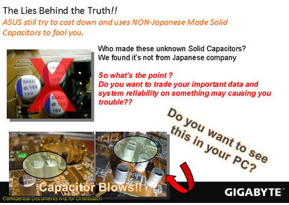

    Hey guys..
    I heard that Asustek using Non-Japan Solid Caps around Mobo... I read it on Tom's Hardware site...
    and the EPU is not working LOL ! ..
    http://www.tomshardware.co.uk/asus-g...ews-28229.html

    Re: OMG ! .. Asus Using Non Japan Solid Caps ??
    ouch
    wonder what asus did to them, to receive this?

                Originally posted by wan901
                Hey guys..
                I heard that Asustek using Non-Japan Solid Caps around Mobo... I read it on Tom's Hardware site... [/IMG] and the EPU is not working LOL ! .. http://www.tomshardware.co.uk/asus-g...ews-28229.html
                too bad the pics are not clear enough to id the burst caps.
                i doubt those are polys anyway.
                sacon fz?

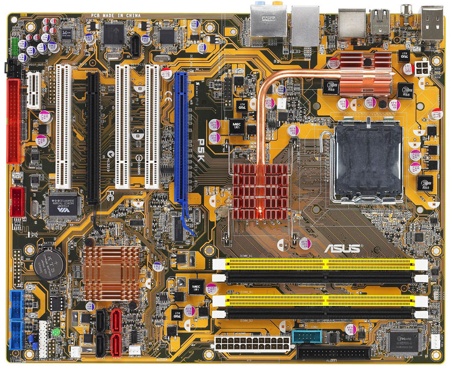

                  I pulled the P5K-SE board out of it's box to see if it looked similar too the blurry pics. The Symbol in the upper LH corner of some the caps looks identical.
                  Like this:

                    I would recommend everyone to have a look on Asus P5K SE/EPU on Asus website. At least 3 capacitors are not Japan Japan-made conductive capacitors.
                    But the link is broken (the 'h' is missing):
                    ttp://www.asus.com/999/images/products/2067/2067_l.jpg
                    It's a picture of the board i bought.

                      another observation: judging by the wimpy HSF and the layout (and the PCB color) in picture # 2 and 3, that device seems to be rather than an older VGA card than a MB.
                      can't tell how how old it is, but I'd say something between 3-4 and 6 years (the first BGA ram chips were used in ~2002).
                      not really surprising to see bad caps there.

                                Phenos got it right in the other thread; the ones pictured in the
                                Gigabyte presentation (and Asus boards) are not Elite, but APAQ (Taiwan).

                                  I pulled out the pocket 30x scope and took another look. My Asus P5K-SE board contains Fujitsu, Chemecon, and what i think are Matsuki caps.

                                      woah.... i founded that purples caps on APAQ's Website ... looks like it was Taiwainese Caps... ^_^ lol ---> http://www.apaq.com.tw/products/ap_conarec01_en.htm
                                        thanks for that
