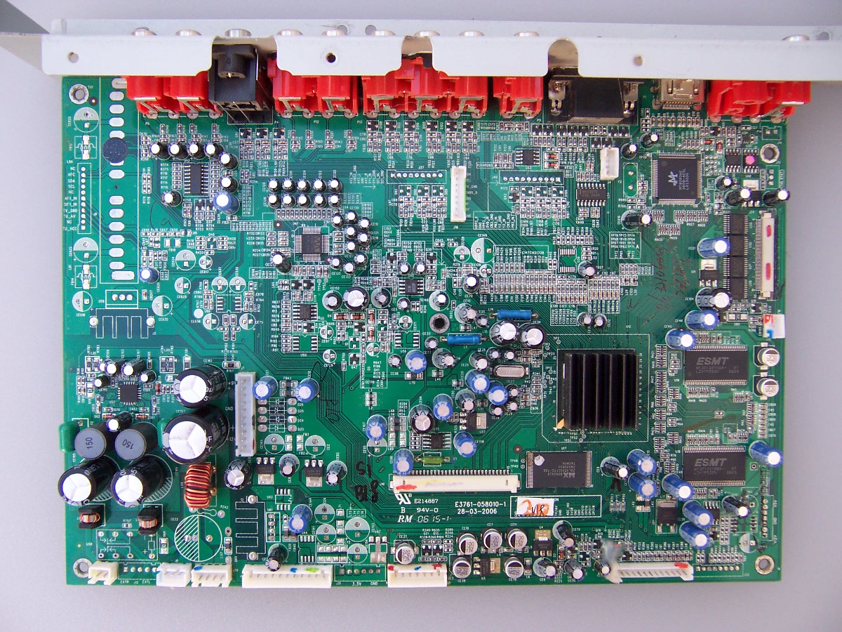

    Is this the same board you have?

                You need to replace all the caps in that PSU.
                Those Megmeet PSU's get HOT and are known cap blowers.
                I recapped an Akai LCT2785TA a year or so ago.
                Same PSU.
                Your other boards look darned close too.
                I think it may be the same TV with different plastics.
                I replaced 100% of the PSU caps and everything down to and including 6mm on the other boards.
                Was a LOT of caps..
                Yeah, I've been doing some research and I think that you're right, Akai and ILO are the same TVs with different plastics.
                So, was the Akai having a similar problem, sound but no picture?
                I ordered all the caps for the PSU from Digi-Key. I'll keep you all posted!
                  Yup, that be the one!

                        sorry to bump an old thread but i found it via a google search, i have the same exact model tv and when i got it, it would come on stay on for a bit and then cut off.
                        i googled and found a site that said something about a bad cap, so i went in and replaced the cap and the tv worked great for a few months and about a week ago it started again.
                        so i took it apart and checked all the caps and they all looked fine so i put it back together and now it wont come on at all, i plan to take it apart again soon but was wondering if anyone had any ideas i could try
                          What brand of cap did you use as a replacement?
                          There are different types of caps. Some caps are general purpose and others are low ESR (ohms). If you used a general purpose cap, it may work for a while and then eventually fail.
                          Bad caps can fail without visible physical symptoms (i.e. bloated or domed). They can be out of uF tolerance or have high ESR (ohms).
                            i dont know, i got it at radioshack i know thats a no no, but i have trouble finding these types of parts for some motherboards i got that have bad caps cause i cant figure out which ones i need, so i just went there and got the one i needed (what i mean is theres so many to choose from its hard)

                              Order from digikey or mouser since you're in the US.
                                RadioShack sells general purpose caps.
                                If you live in the USA, there lot of low cost options like digikey.com.
                                A list of recommend caps is at
                                https://www.badcaps.net/forum/showthread.php?t=2280

                                    i guess when ever i get around to ordering i should ask what i should look for on those sites as they are very confusing to someone who has never ordered any of these types of parts before
                                    Yes, make a checklist and we will help verify.
                                        Since you have the same model I'll poke around and see if I still have the caps list I made up.
                                        I've moved since I did that one so I may not have it anymore.
                                        But I'll look...

                                          thanks for that til then I have made a list of some caps that to me look bad so here it is and thanks for all the help
                                          cap list for power supply
                                          3 470uf 35v
                                          3 1000uf 35v
                                          1 22uf 450v
                                          1 470uf 16v
                                          2 1000mfd 50vdc
                                          cap list for tv board
                                          1 470uf 50v
                                          6 470uf 16v
                                          1 330uf 25v
                                          3 1000uf 35v
