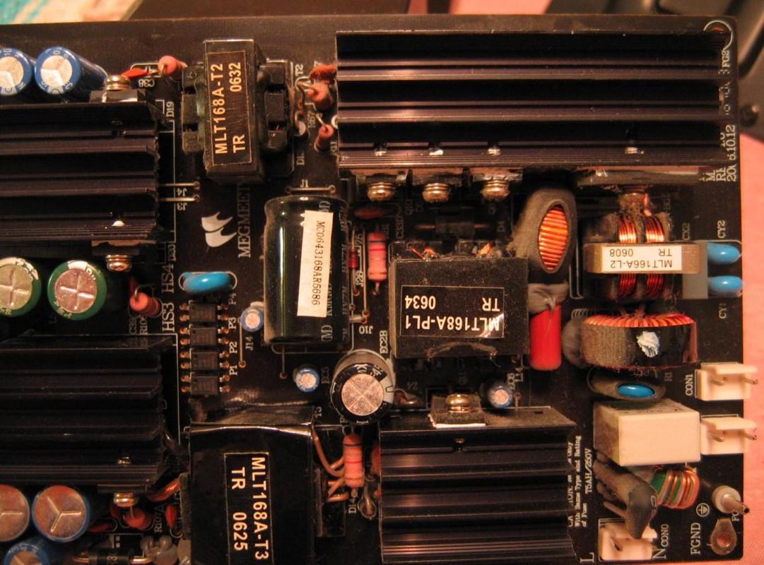

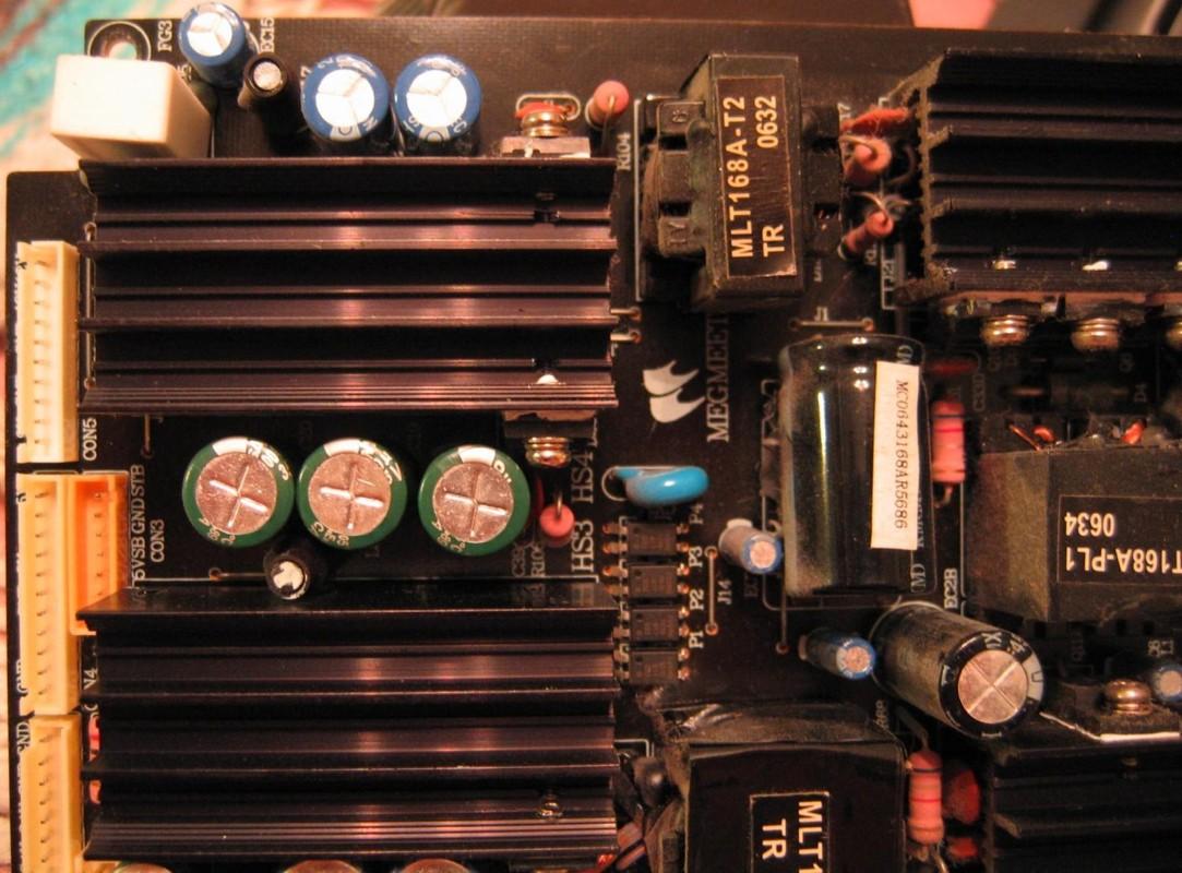

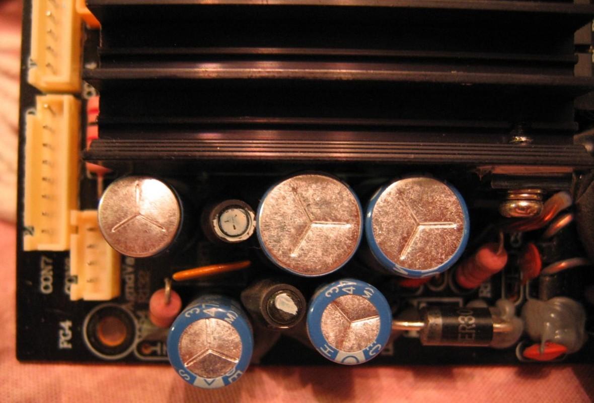

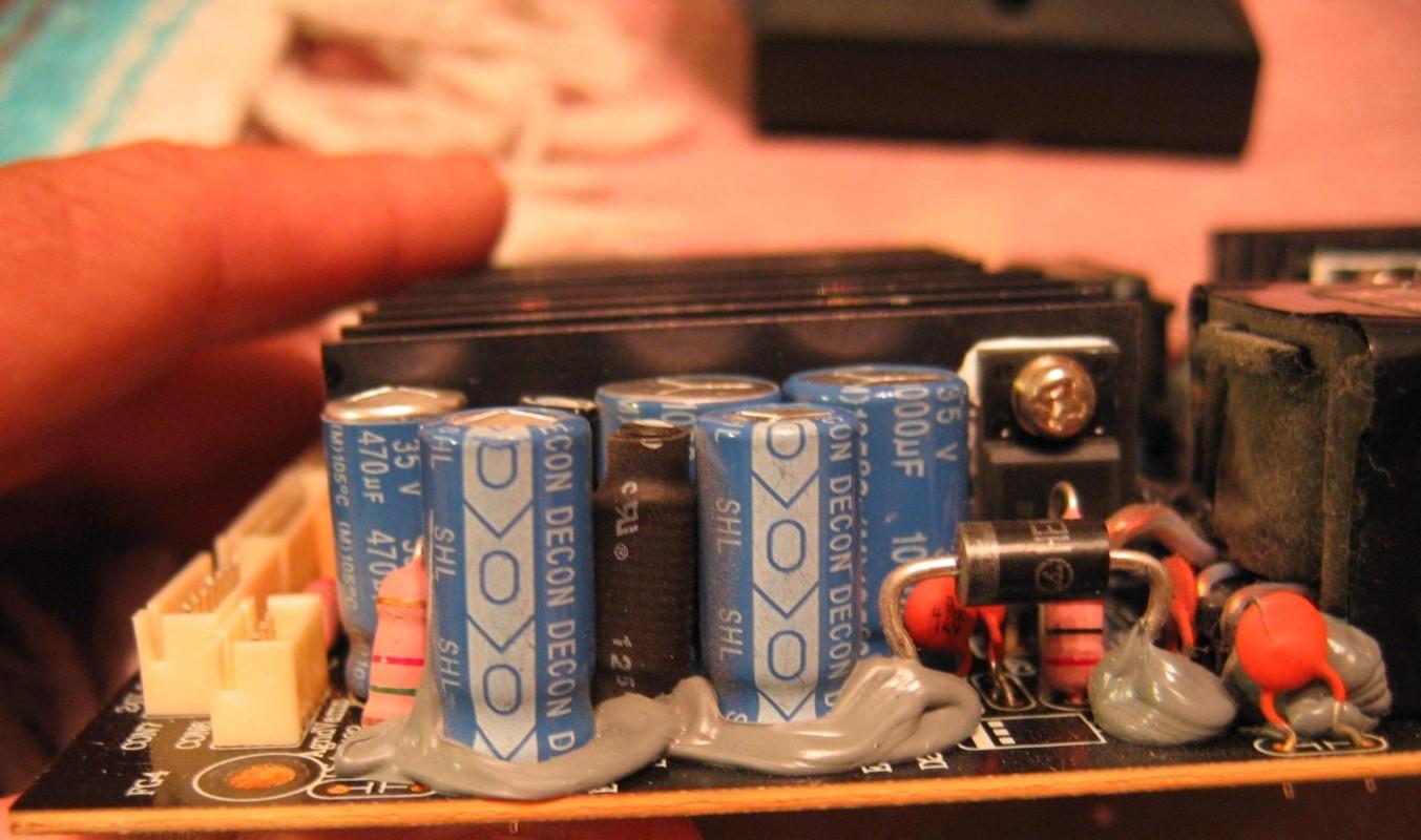

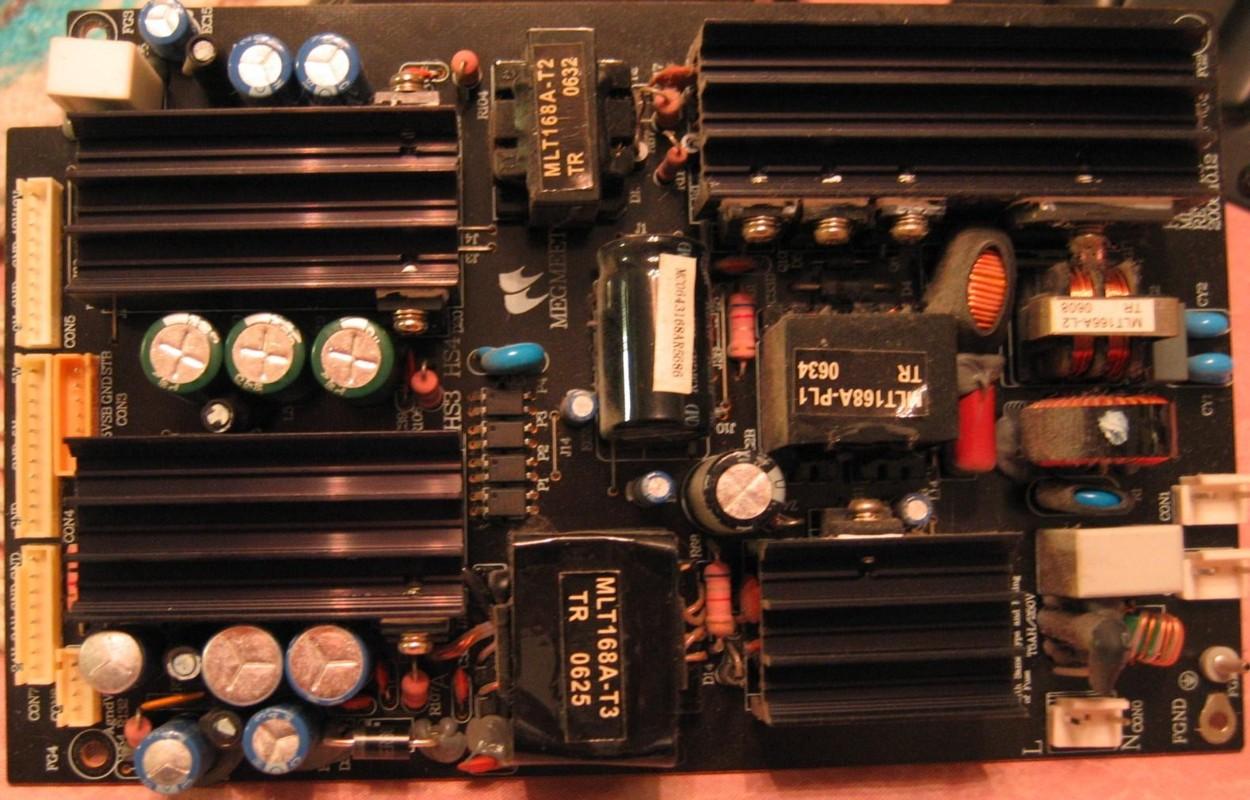

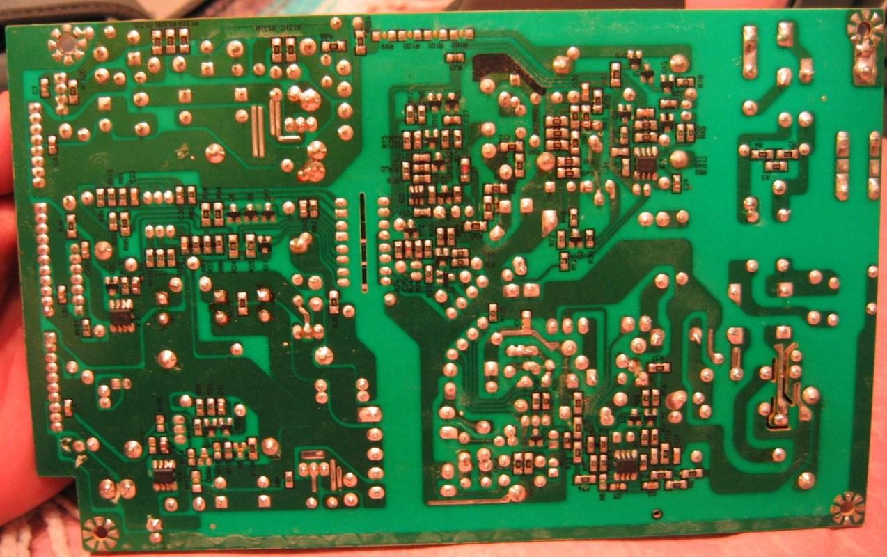

                Okay, I found bad caps in the power supply (is that what you mean by inverter <<<NOOB!). The part number on the power supply is MLT168A.
                I've attached some pictures of the power supply. The last two have the bad caps. Should I stop here or keep on digging? Thanks all!

                  We would probably like pictures of ALL your boards. The two bad caps may not be all that is bad.
                  edit: Some designs have their inverter and power combined on one board. Some are separate. Just depends on the manufacturer.

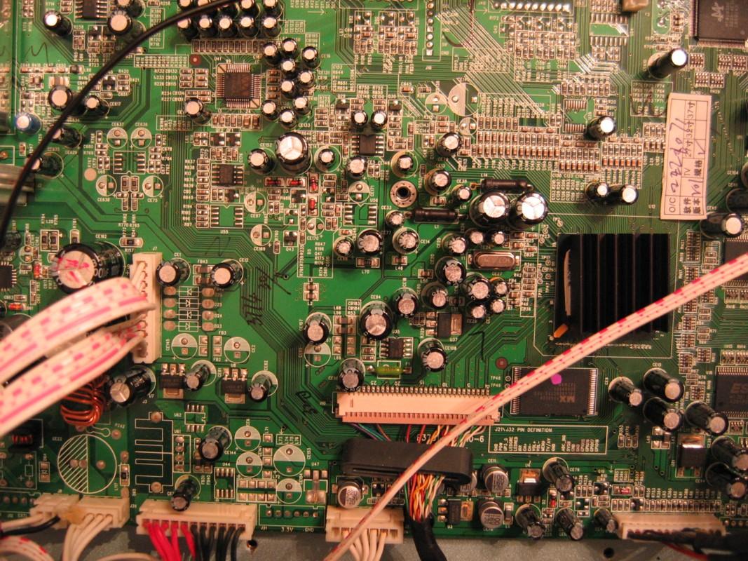

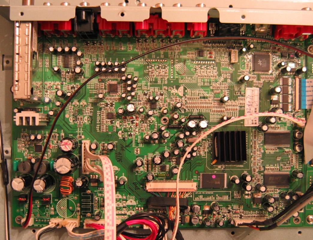

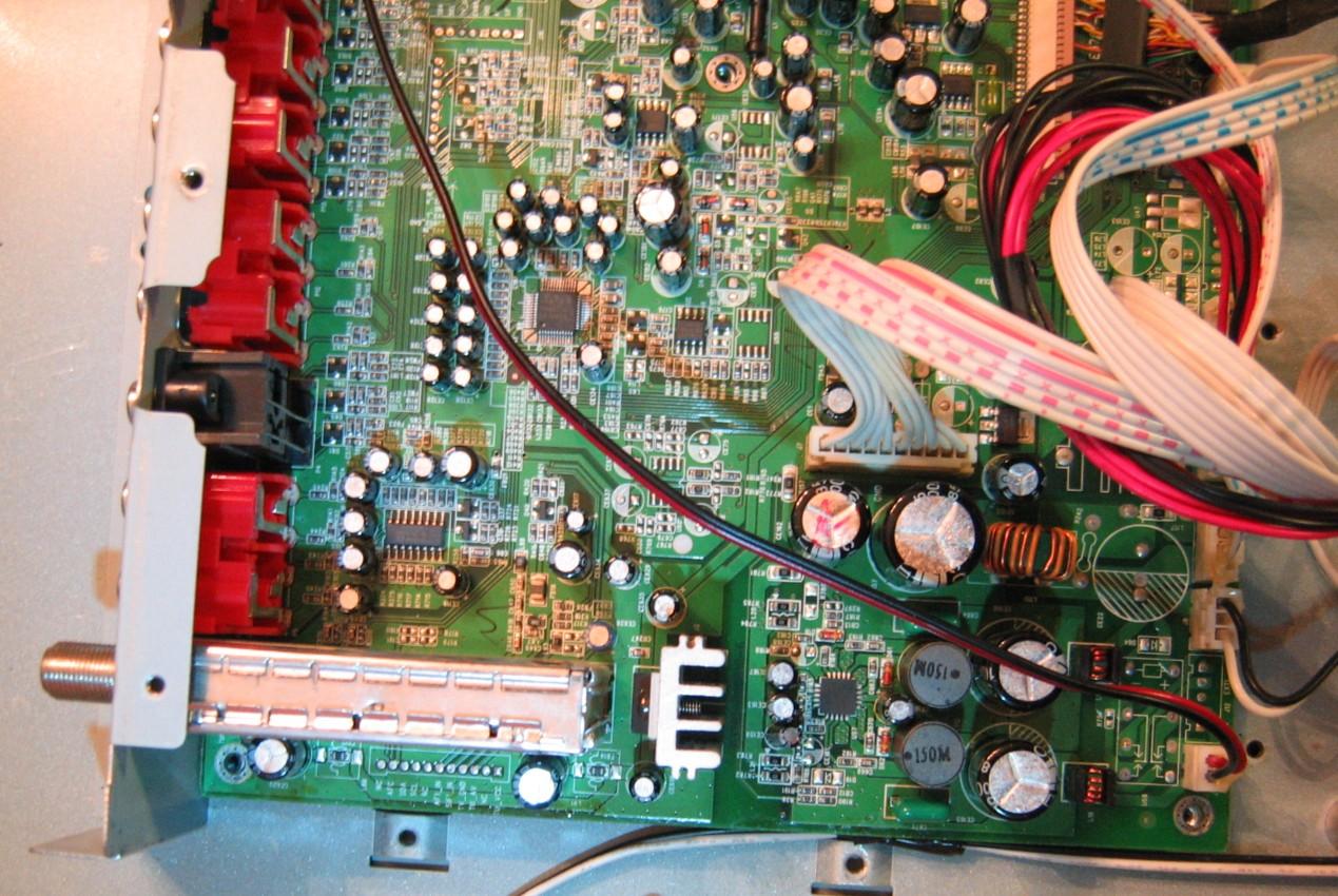

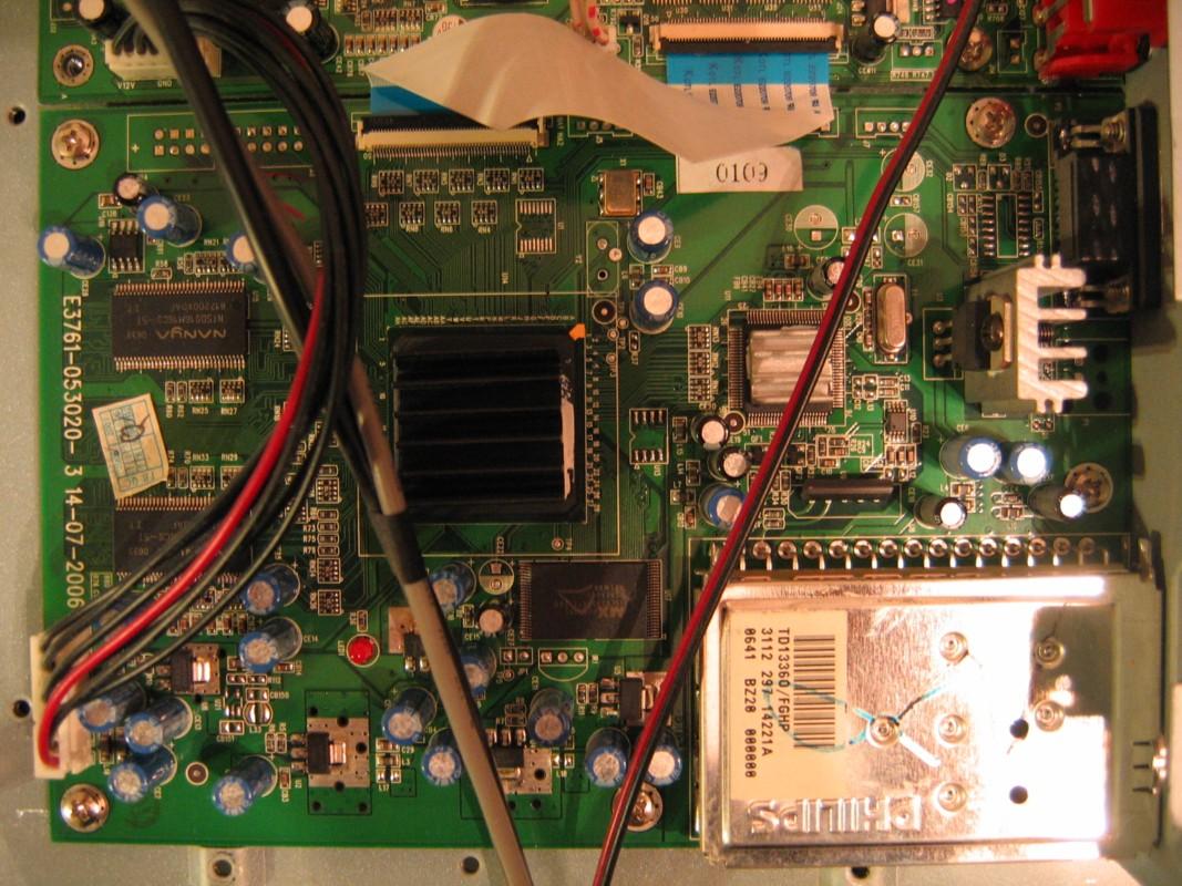

                    Okay, I attached photos of the mainboard and the RF board. The mainboard is new, it was replaced last year under warrantee. The HDMI-IN in the mainboard stopped working, so they replaced the whole board. I'm not seeing any more bad caps on these two boards.
                    I'm having a little difficulty going any deeper. The metal panel under the mainboard and RF board has all of the screws out but is not budging! There must be hidden screws somewhere but I'm having a humdinger of a time finding them!

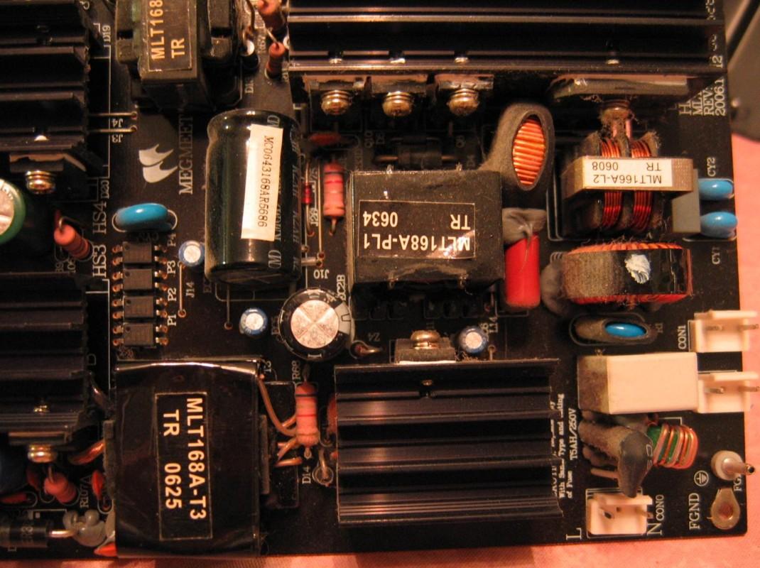

                      From a quick look I spot one green picofuse on your board. It wouldn't hurt to quickly measure all your fuses to ensure they are all good (0.3 ohms or less).
                        Dumb question #3 - Which board?

                          Actually, it is not a dumb question. I am too tired today to go back and count, but I think I have been asked this question in one variation or another at least 5 times this last week.
                          I circled it in red on your picture. There may be more, but you have the best view to find them all. A open fuse may also be the reason you don't see the backlight come on (in addition to bad caps).
                            Thank you, I'll measure the resistance in that fuse in the morning. I only wish that there was a website called BadRotors.Org so that I could repay the favor (I'm a mechanic by trade)!

                                I'd suggest replacing every electrolytic cap on the power supply board. Those Decon caps look like candidates for the badcaps list, and I'm not sure what else is in there.
                                One other point. Because of the way you took that first picture, those two bad caps stood out perfectly. Heck, I can even see the dust on the coils!! The last picture showed the manufacture's name. The rest were unneeded.

                                  Bill, call me Mr. Overkill! I just wanted to make sure that I covered the whole power supply.
                                  The power supply has 11 no-name caps and 1 Samxon (22uf/450V)! What is the sense of that?

                                    That's why I avoid TVs with names like Haier, Ilo, Insight, Memorex, Viore, Element, Emerson, etc. They are slapped together in China of the cheapest components available. They are sold by the container load with a very limited warranty, and no service information available. The distributor sells them and promises to replace any that fail within a certain period - typically 90 days. They MIGHT have a deal with a parts swap operation where any TVs that fail are disassembled, defective boards identified, and replaced with still working boards from TVs that had other failures "Factory refurbished".
                                    I just did a quick check on prices from a major national retailer. Here is what it costs for a 32" 60Hz LCD TV. The first three will have some sort of service organization and service literature; I would expect a 1 year warranty. The last four I'd expect a 90 day warranty, and at best you have to ship it back to the "factory" for replacement.
                                    Sony $449; Samsung $398; LG Electronics $374; Viore $349; Vizio $349; Viore $319; Emerson $309

                                        You need to replace all the caps in that PSU.
                                        Those Megmeet PSU's get HOT and are known cap blowers.
                                        I recapped an Akai LCT2785TA a year or so ago.
                                        Same PSU.
                                        Your other boards look darned close too.
                                        I think it may be the same TV with different plastics.
                                        I replaced 100% of the PSU caps and everything down to and including 6mm on the other boards.
                                        Was a LOT of caps..
