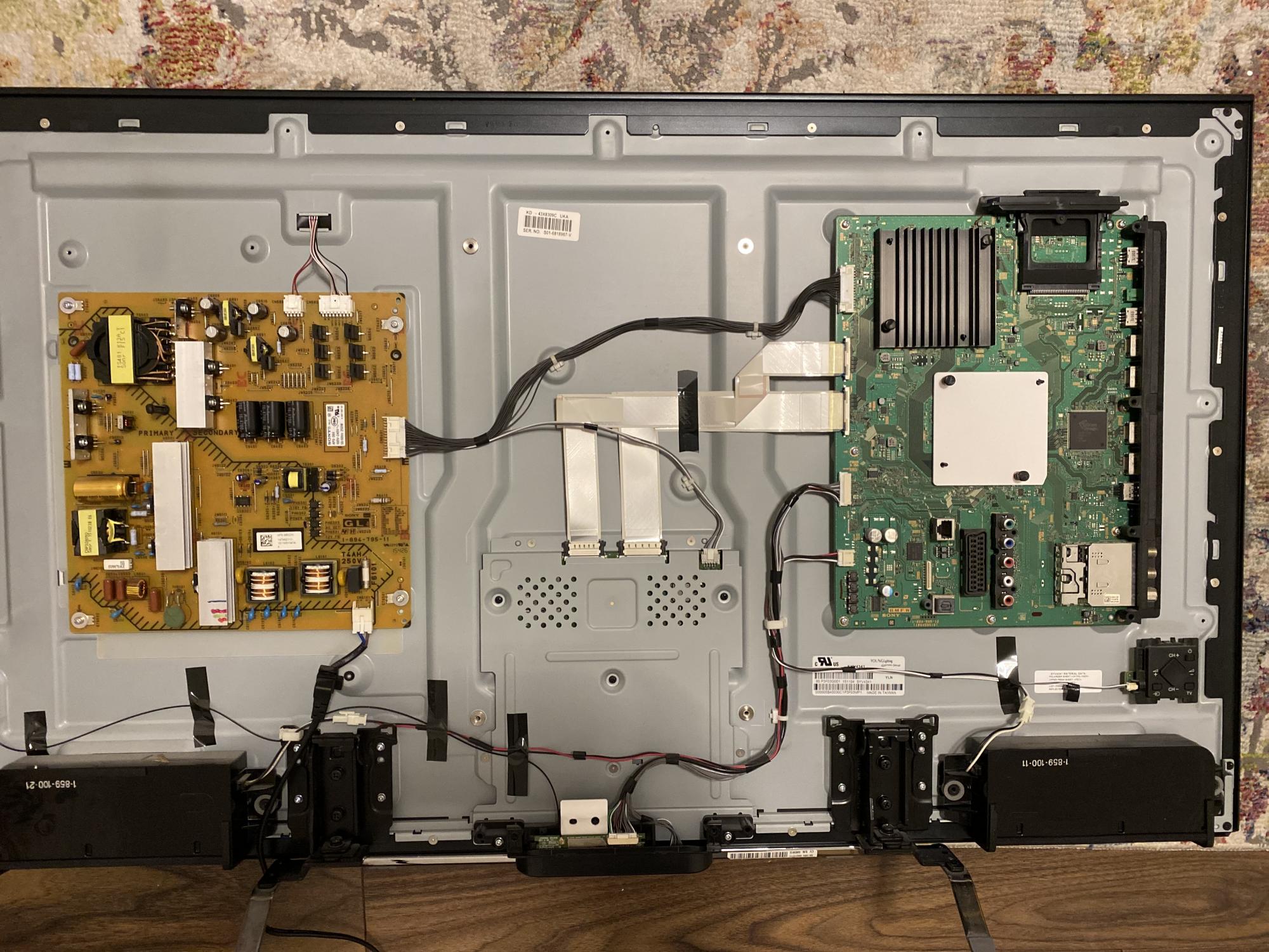

    This tv is coming with no light at LED standby, no picture, no sound.
    When power button is pressed nothing is change

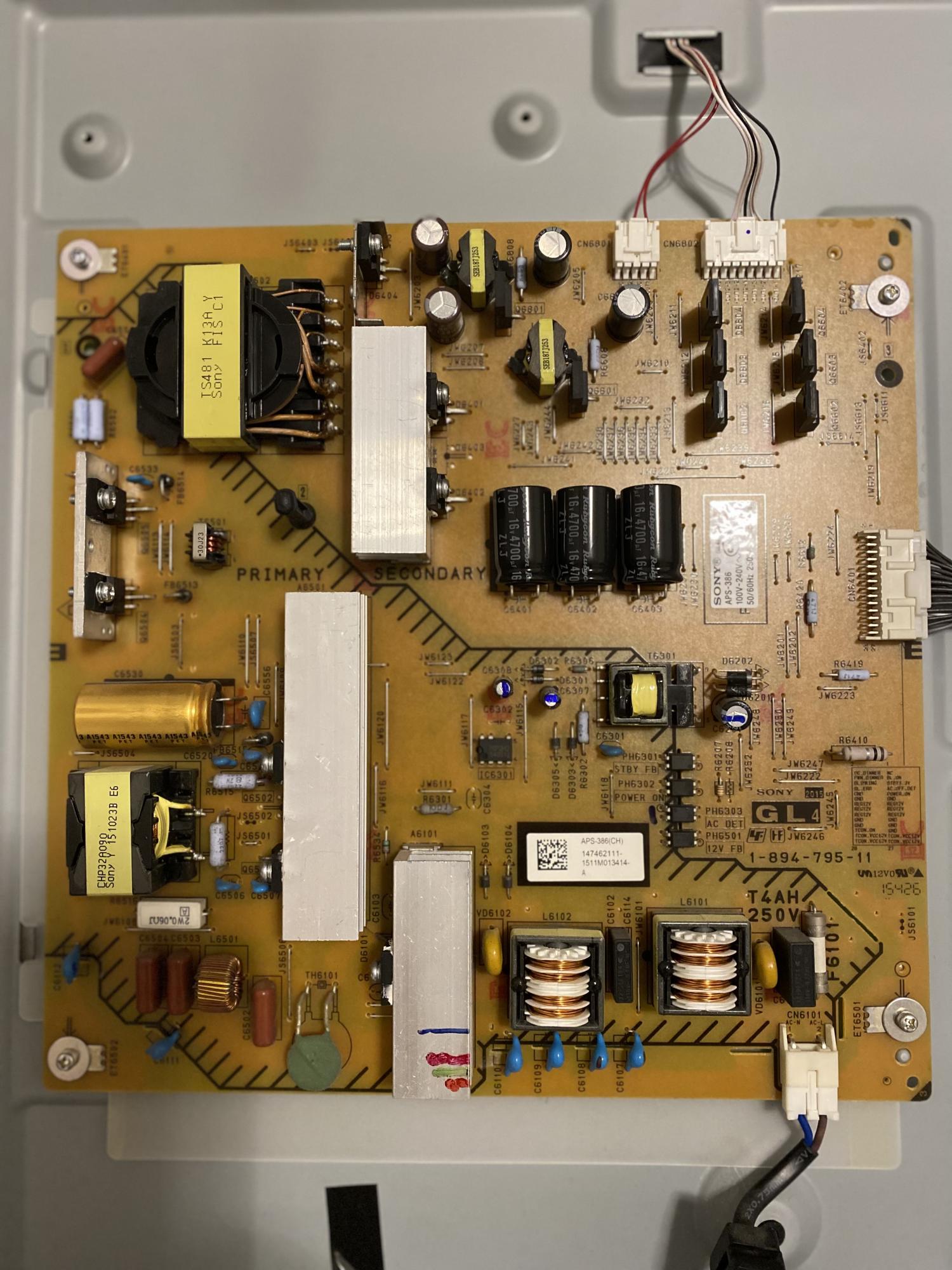

    I checked the power board and found 3.3V and 12V.
    I made allready a hard reset with volume- and power button .
    Any ideeas ?

      can you post good straight on pictures of each board and one of the whole back, as to see how everything is connected.

        Re: Sony KD-43X8309C
        Pictures of the tv

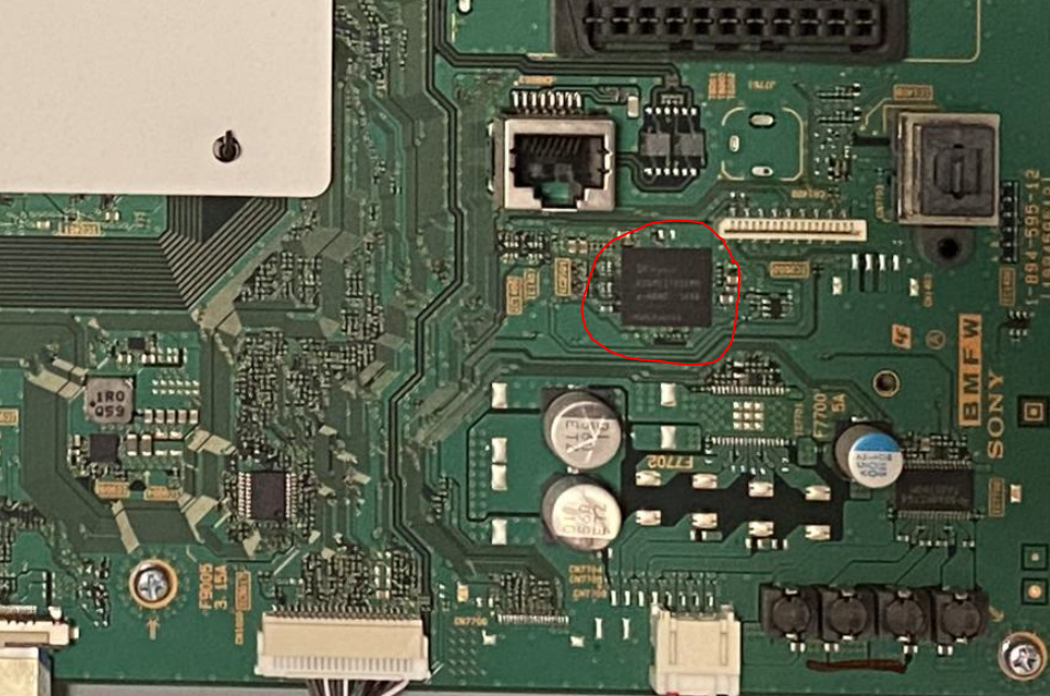

          can you get a clear close picture of the map/legend right there by R6410, maybe check all the diodes and resistors on top of the board.

              ok, also see if you have the ac_detect voltage there on your connector on powerboard, and trace the standby wire back to mainboard and see if you have that 3.3 voltage on the mainboard connector.

                On CN6401 ac_off_det = 3.475V and standby voltage on the mainboard is 3.475V
                The backlight LEDs are ok and voltage on the rectifier diode(cathode) of backlight power supply is 65.6V

                  Main board is the main suspected, almost 95%, on it near the power connector, that 20 pin soic chip is a PIC16 microcontroller? if yes must be reprogrammed, not sure it solves..

                    does the optical port on mainboard light up when you try to turn on tv?

                      Looks like a bad EMMC, in more than 95% the EMMC has reached the "end of life" status and must be changed with a new loaded EMMC.

                        Whatching THIS.. and .. THIS.. it seems a proper PIC microC, so i bet for that..
                        THe tv has no signs of life so bad standby SW, that reseats in the PIC..

                          In these chassis, eMMC Flash and the MediaTek processor (SoC) are mainly dying.

                            Thank you for your support. From the beginning I suspected the mainboard with a bad eeprom .
                            Indeed, it's a PIC microcontroller on the board PIC16F527. Can be reprogrammed or replaced?
                            If it is a bad EMMC can be replaced?

                              eMMC

                                must be reprogrammed, two ways to test, first reading it normally, TL866II+ could support maybe, save, freeze the chip, read again, compare dumps, if changes write the second back. Other way, search the web for a dump.
