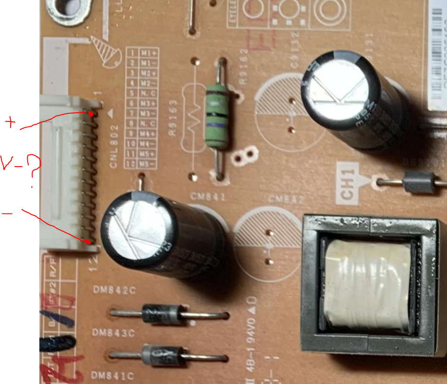

    Samsung UN55J6200AFXZA Sound but no Picture
    As title states, sound but no picture. I have done all of the rudimentary troubleshooting steps- flashlight test no lights visable. Checked Source and it is correct. Tried different, verified good HDMI cable, swapped satellite receiver boxes etc and no luck. I see lots of kits with replacement boards, but before I start throwing parts at it I'd like to know if anyone has suggestions. The brown power board has a couple of spots that are suspect. They are a darker brown circular color. Not sure if that is just from normal use or if something may be burnt. Not sure if a suspect power board is capable of no picture but still having sound or not. Any help would be appreciated.

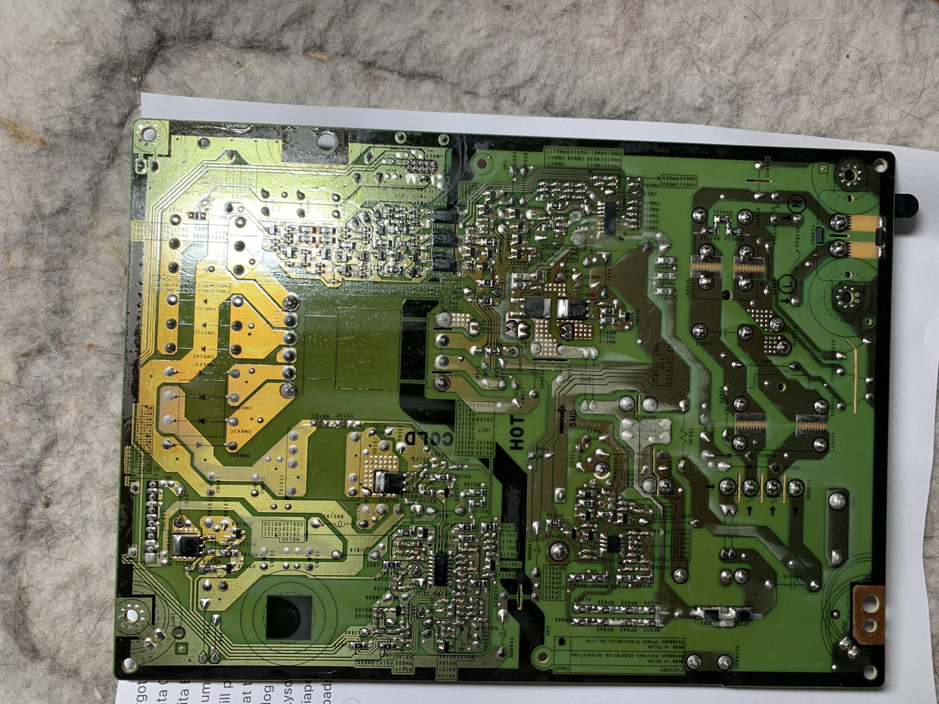

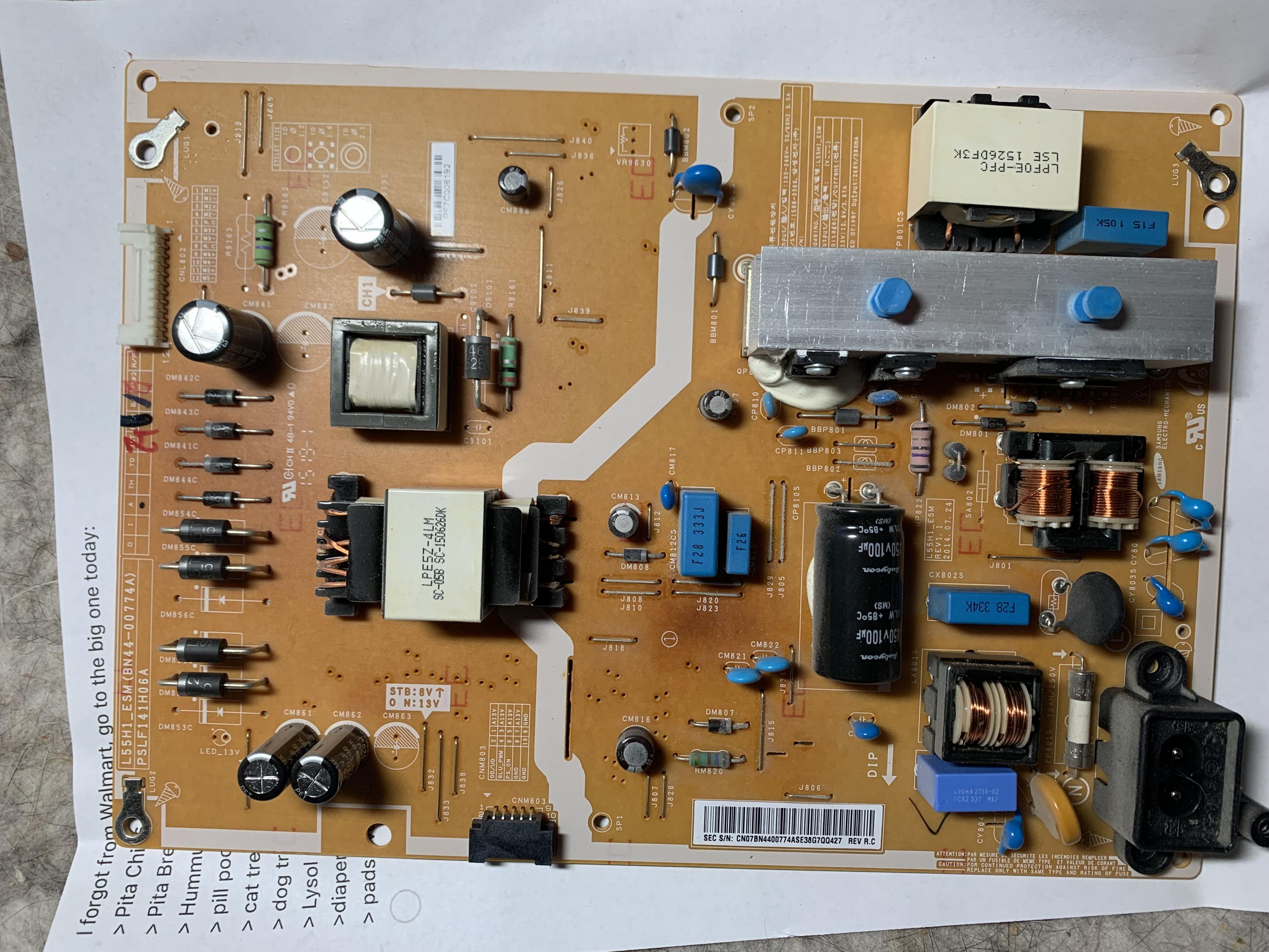

        Re: Samsung UN55J6200AFXZA Sound but no Picture
        how bout some good clear pictures of all the boards and one of the whole back as to see how everything is connected and a good one of these burn marks you speak of.
          When I took the back panel off, all cables seemed to be secure to my eye. Attached are pics of the power board front and back. If it is the back light or lights, do they typically all go out at once or a few at a time?
            What is the output voltage of led driver? If a high voltage appears, and then begins to fall, then the backlight (Leds) is not working.
            You have a backlight, like a garland, one LED burns out or breaks, then others stop working.

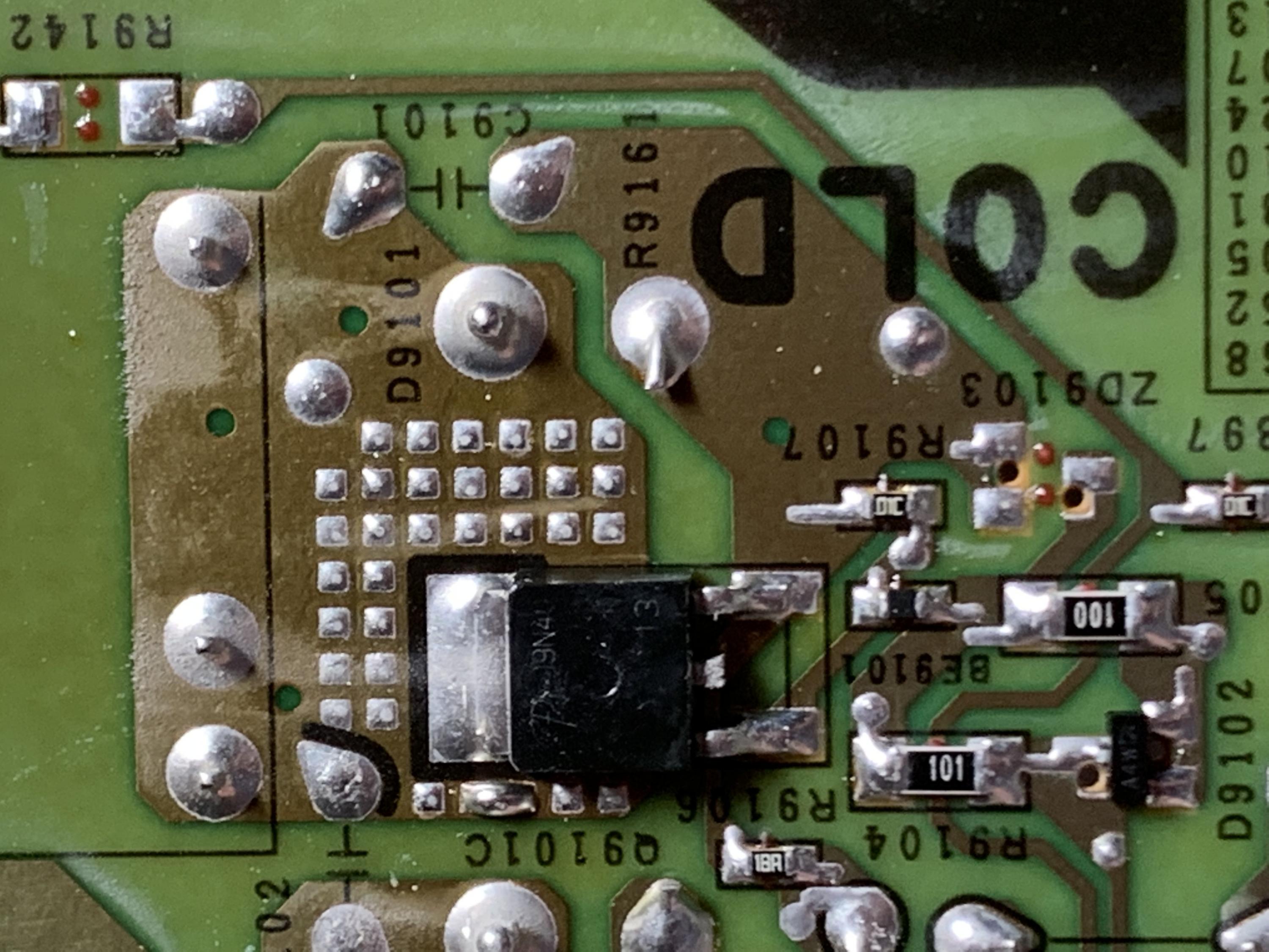

                you have at least one bad solder joint, picture isnt real clear, theres one just above the word cold, look them all over closely, reflow any that look a little suspect, careful not to bridge anything with the solder, examples of bad joints in case anyone needs it: https://www.google.com/search?q=bad+...ih=607&dpr=1.5
                      ok, did you touch up the bad solder joints?
                        No, I guess I missed that post. But looking back I can see where it was mentioned. So, speculating here, once solder joints are repaired if I do the same test again and the backlights do not turn on, what does that mean?
                          Is the solder joint your questioning visible in this close up?
                            Originally posted by AlanP64
                            Sorry for the delay, work gets in the way. I appreciate the comments and suggestions thus far. I did the test as described above, no backlights visible.
                            Have you checked the voltage (post #6)?
                                  No, I will dig out my multi-meter.
                                  If there is a constant voltage of more than 200v, then the backlight will have to be changed.
                                        I'm seeing 0 volts between those terminals. So, I assume that to mean there is at least an issue with the power board but there could still be an issue with the back light as well.
