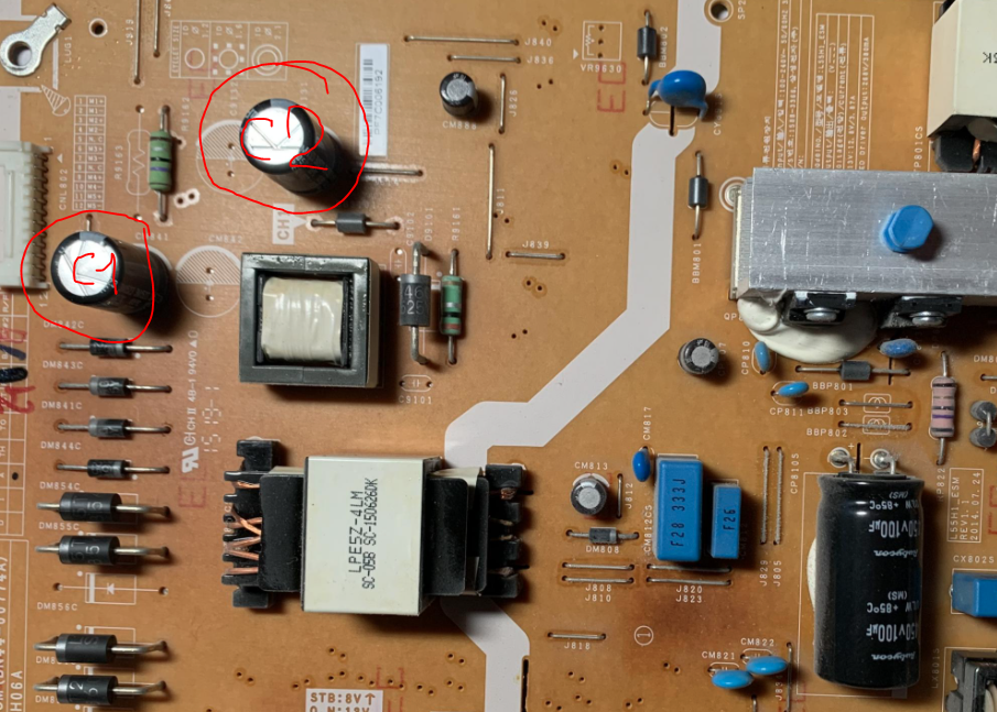

    Is there voltage across these capacitors?
    • lotas
      • Jan 2016
      • 4753
      • Russia
      Re: Samsung UN55J6200AFXZA Sound but no Picture

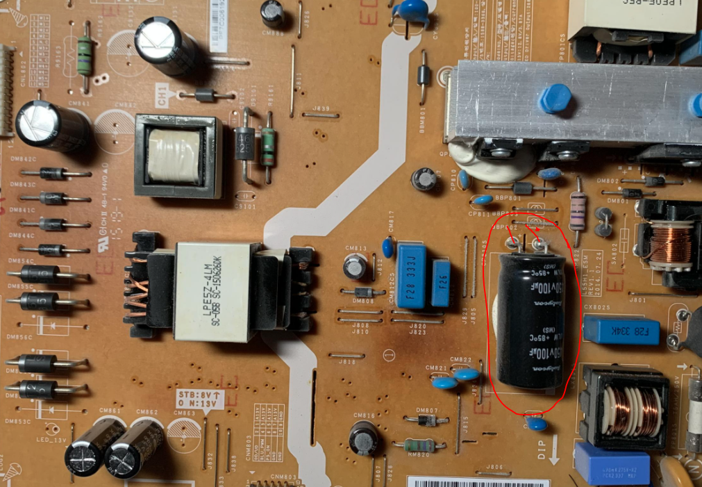

      And what is the voltage on this capacitor (in standby mode and in operating mode)?
      • AlanP64
        • Oct 2022
        • 13
        C1 = 200
        C2 = 300
        Black capacitor in standby = 220
        Black capacitor operating = 390

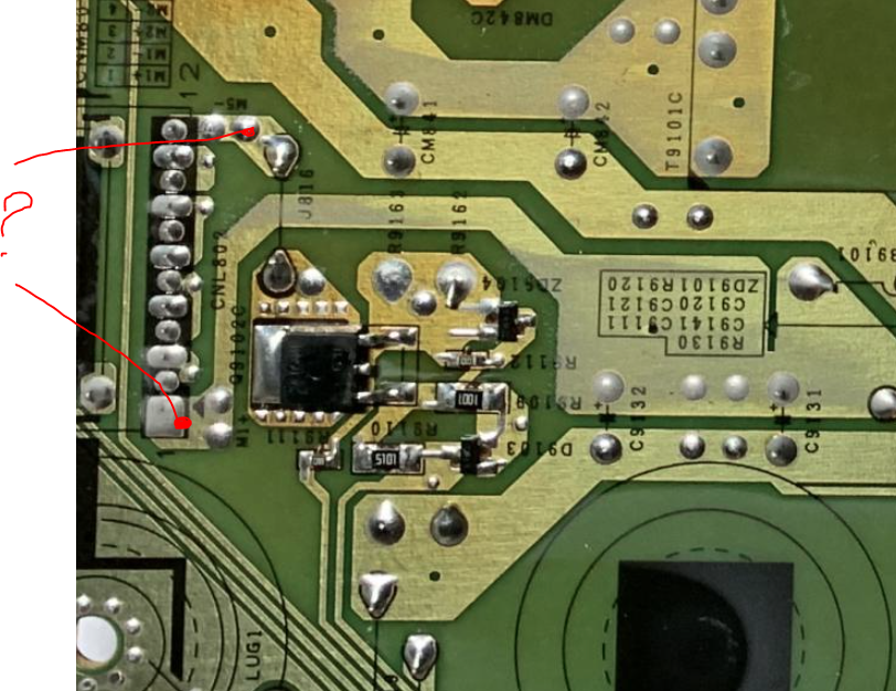

          Strange, maybe 1 pin is not used, check it like this.
          • AlanP64
            • Oct 2022
            • 13
            Nothing at all.

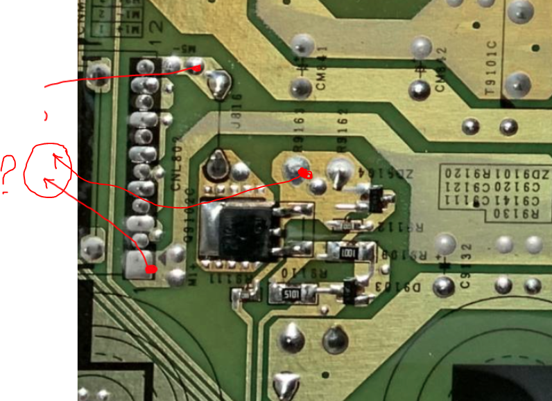

              And here.
              • AlanP64
                • Oct 2022
                • 13
                Originally posted by lotas
                And here.
                Bounces between 290 and 318 volts.
                  And here.
                  So, with the results of my last voltage reading, is it safe to assume I at least have an issue with the power board in that it is not allowing voltage to the backlights? I believe what your testing has been is to diagnose the board at a specific component level? I found a new board for a good price so I am not opposed to just replacing the board itself.
                  • Davi.p
                    Hobbist Tech
                    • Sep 2009
                    • 4462
                    • Italy - Milan
                    #29
                    don't buy the board, before test in diode mode every combination of pins of the big transistor in last photo
