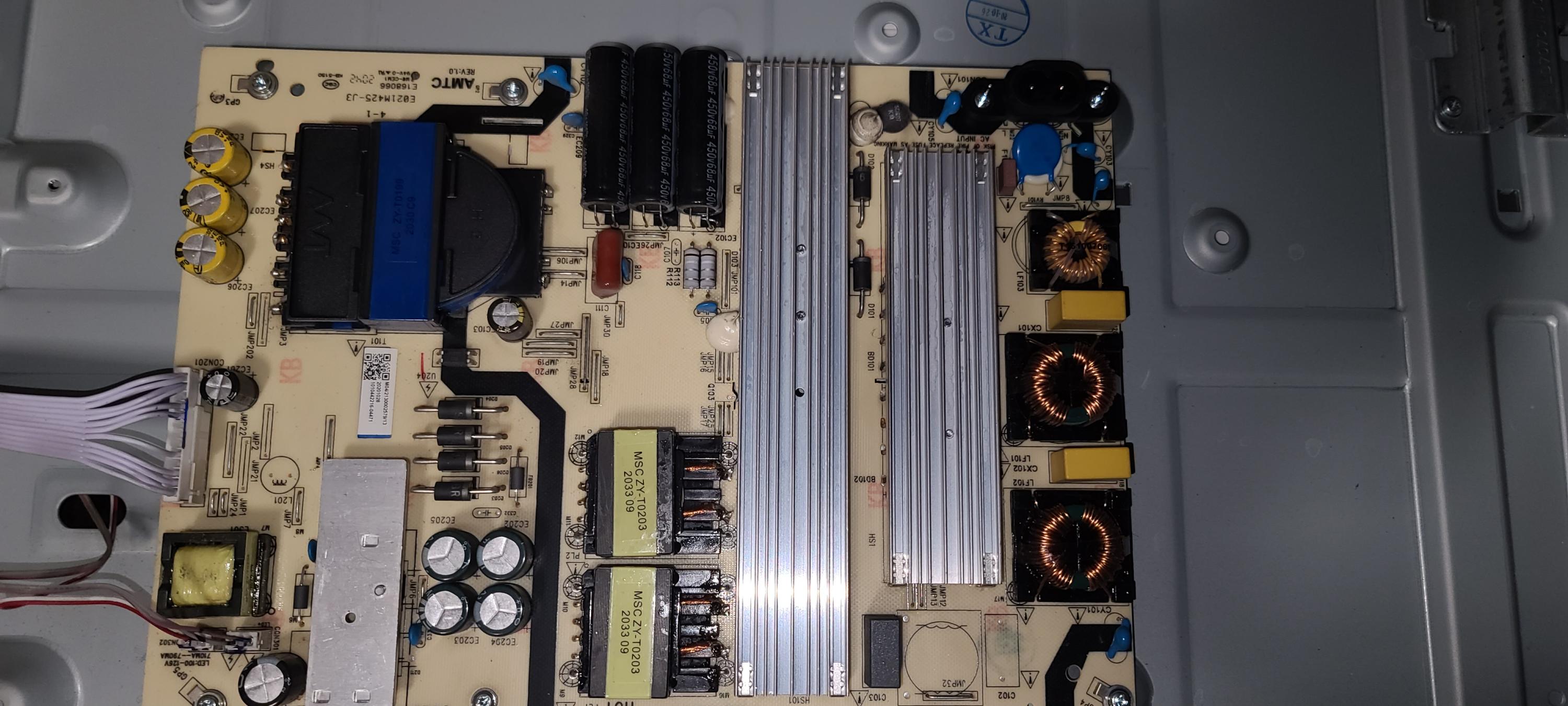

    This unit will flash the backlights once on powerup. Still responds to remote commands, and plays audio.
    I have a backlight tester.
    Two backlight connections to PSU. I have them connected opposite of OEM in the picture.
    CON301 - Red/White wire - tests 95.5v on my backlight tester.
    CON302 - Red/Gray wire - tests 92.5v on my backlight tester.
    Is a 3v difference between strips enough cause to tear down the panel? It doesnt trigger any red flags for me. The backlight flash is enough for me to knee-jerk blame bad backlight strips as a first guess assumption.
    Voltages on PSU board
    3 large main caps - 370v DC
    GND
    ADJ -
    BK -
    +5V - Not Connected
    PSON -
    +5VSB - Not Connected
    NC - Not Connected
    ND - Not Connected
    GND
    GND
    GND
    +12V - 11.98v
    +12V - 11.98v

            Voltages on PSU board - powered ON
            GND
            ADJ - 1.712v
            BK - 3.19v
            +5V - Not Connected
            PSON -2.94v
            NC - Not Connected
            ND - Not Connected
            GND
            GND
            GND
            +12V - 11.98v
            +12V - 11.98v

                                Found another surge of energy, and read up on some other threads.
                                currently following https://www.badcaps.net/forum/showth...=110193&page=3 , since it seems to detail a common issue on these power supplys.
                                Originally posted by R_J
                                R355 is acting like a fuse for the Auxiliary supply from the transformer, D107, EC103 If this resistor is open, the power supply will try and start then fail and try again.
                                Originally posted by triplefour
                                R355 was not open it just shows as 20.1k when it should be 2.2ohm. R354 seems in spec. 4701 marking means 4.7k and it reads about 4.6k
                                The same is true for my board. R355 was actually two resistors stacked in parallel, both marked 2R20 = 2.2ohm. Removed them and each resistor read 12.2 ohms out of circuit. Tested again a few mins later, now reads 11.6 ohms.
                                R354 is a single resistor marked 4071. This one read 4.7K, which was exactly on spec.
                                I don't think this is the cause of my particular issue, but it does appear that it's suffering from the same issues plaguing the OP in the other thread.

                                  Just repaired 2 of these myself. 10 uf 450 v capacitor on power board. It is right by the plugs that go to the backlights.
                                  • EazyBone
                                    • Jun 2023
                                    • 1362
                                    • United states
                                    Re: Onn 70" Class JE695R3HB9L - No backlight
                                    This was the fix for me. I had 12v to main, tcon working, sound but no picture.
                                    I had a flash of light from backlight and then it shut off. I manually used LED tester on each side while the TV was on half on each side and has picture. Each backlight seemed to be working.
                                    The backlight was getting 380v and 240v which is obviously off from what It should be.
                                    Noticed the cap next to LED was round very slightly.. took it out it tested at 0 capacitance. Replaced and is working.
                                    Old thread but this was the answer for me.
