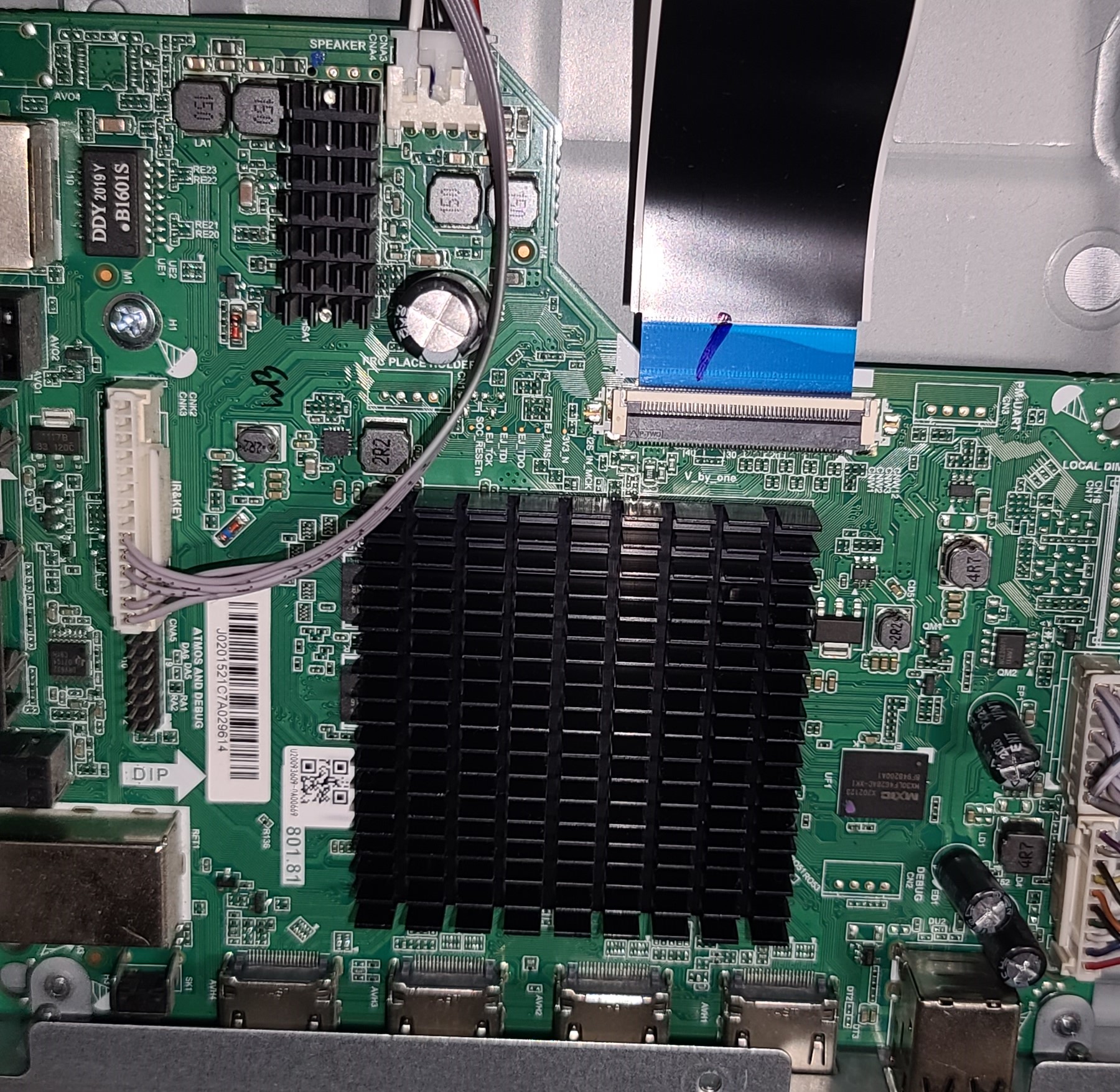

    This unit will flash the backlights once on powerup. Still responds to remote commands, and plays audio.
    I have a backlight tester.

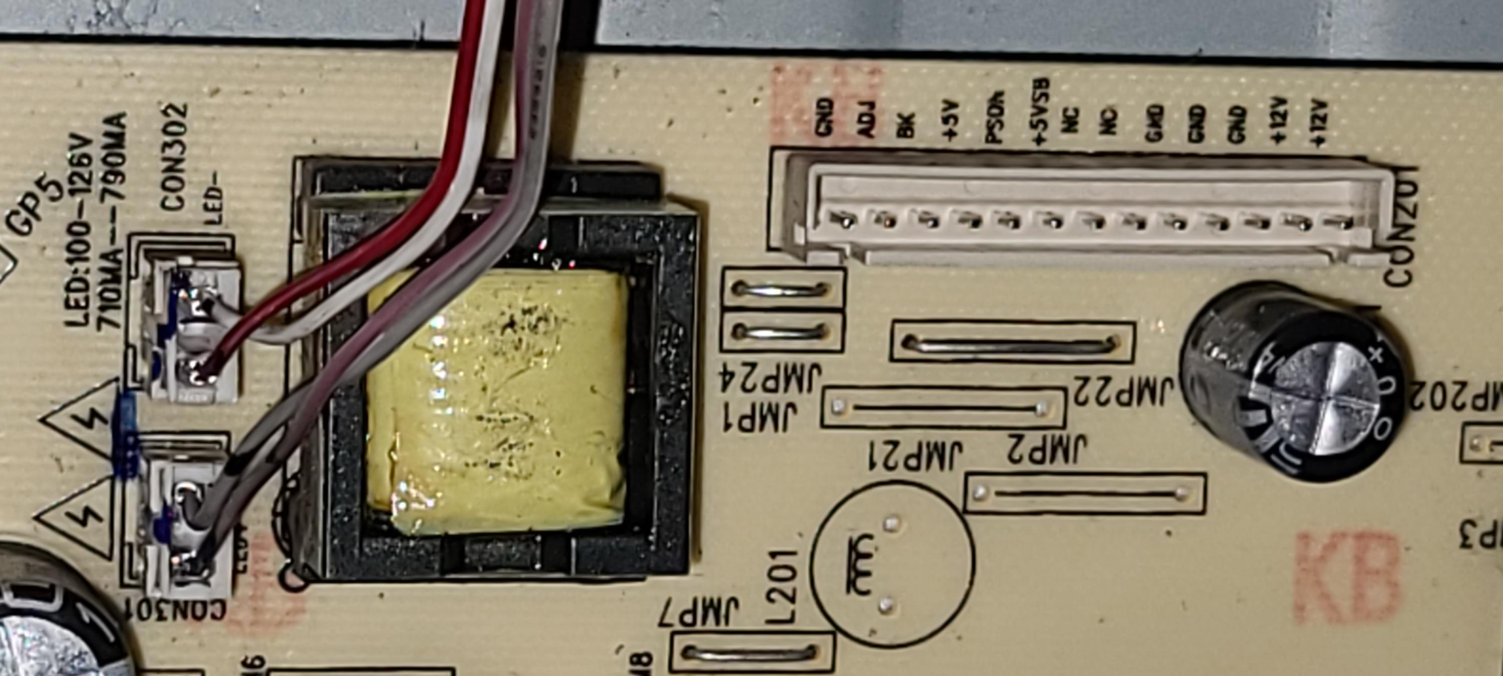

    Two backlight connections to PSU. I have them connected opposite of OEM in the picture.
    CON301 - Red/White wire - tests 95.5v on my backlight tester.
    CON302 - Red/Gray wire - tests 92.5v on my backlight tester.
    Is a 3v difference between strips enough cause to tear down the panel? It doesnt trigger any red flags for me. The backlight flash is enough for me to knee-jerk blame bad backlight strips as a first guess assumption.
    Voltages on PSU board
    3 large main caps - 370v DC
    GND
    ADJ -
    BK -
    +5V - Not Connected
    PSON -
    +5VSB - Not Connected
    NC - Not Connected
    ND - Not Connected
    GND
    GND
    GND
    +12V - 11.98v
    +12V - 11.98v

    A backlight tester is not the perfect tool in diagnosing faulty led's. Many times I had the same symptoms and it turned out as backlight failure. Remember that the LED tester does not test these led's under load (280mA - 300mA). The power supply has very sensitive circuitry that trips out the power supply under certain conditions like over current or overvoltage. The one time it was a bad solder connection under one of the led's causing this problem.
    By the way, there is a reservoir cap for the led supply voltage on some designs that goes either bloated or high on ESR which can also cause the same problem.
    The discrepancy of 3V tells me one of the LED's is shorted out. If there is one that has failed there could be more issues with them.

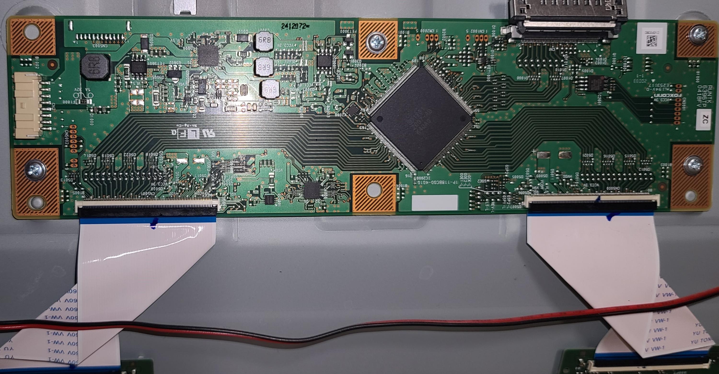

          I'm attempting to power the backlights with the LCD drivers and panel disconnected from the TCON. Maybe that could be the current problem, but I"ll have to jury-rig a way to connect without completely reassembling the panel.
