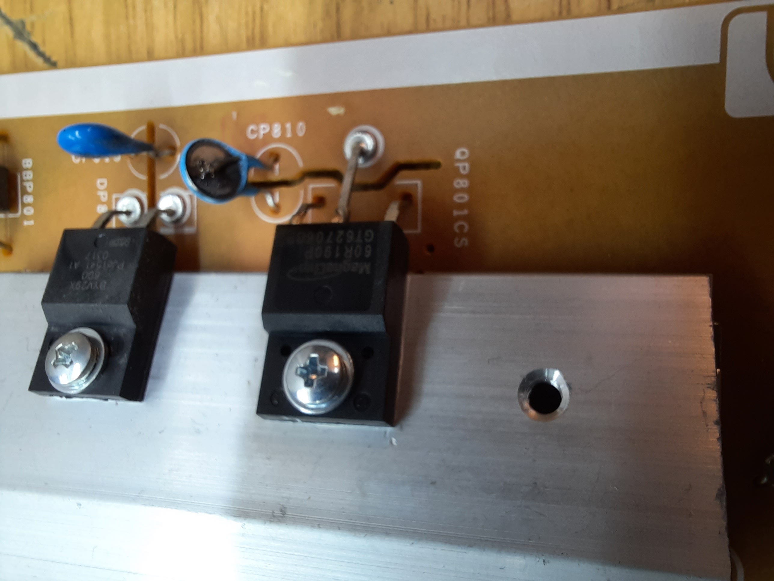

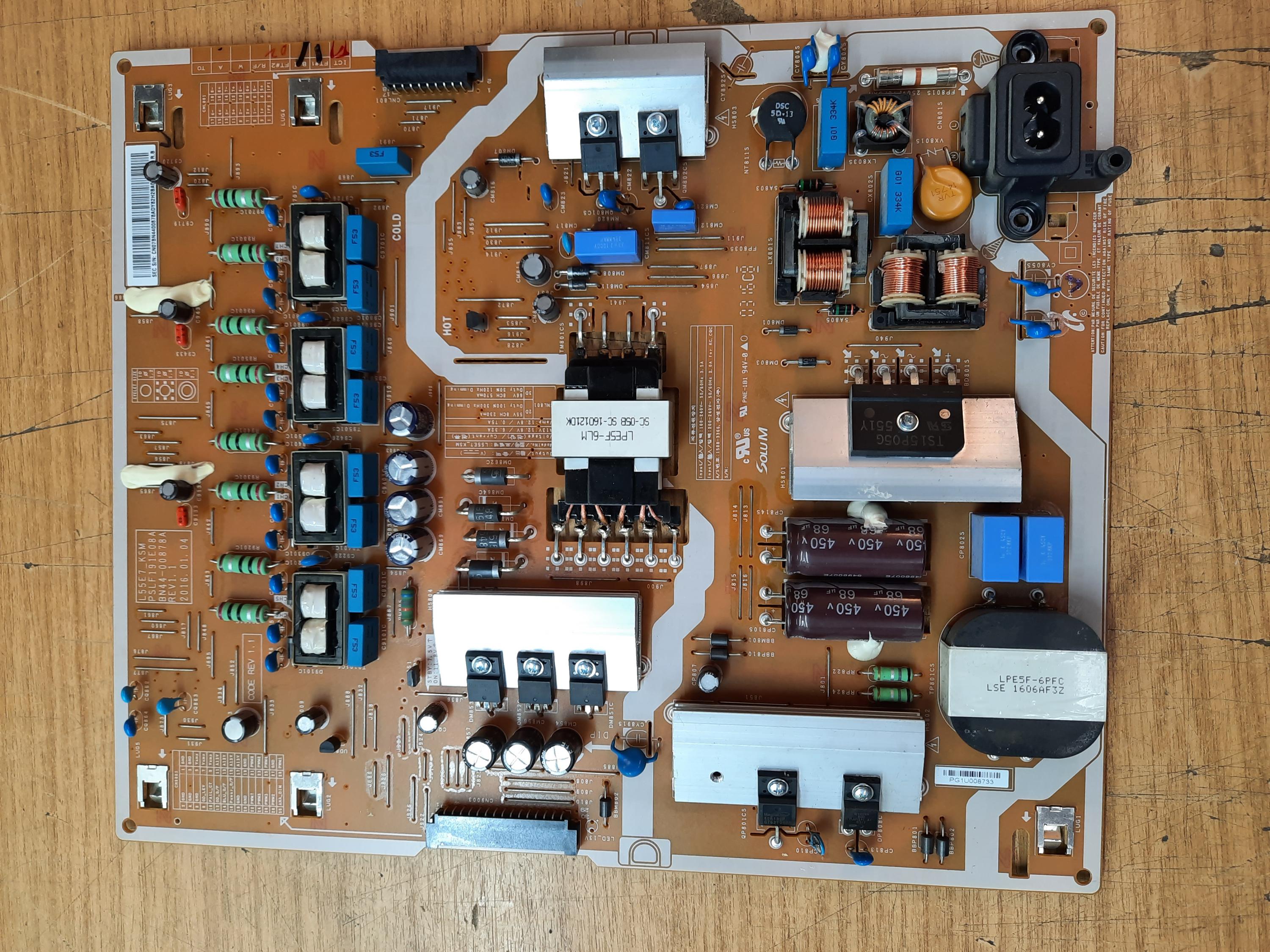

    Hi all
    This set has no power
    CP810 blown apart . Can anyone help with value ?
    PSU P/N = BN4400878A
  • nomoresonys
    • Jan 2013
    • 12307
    • U.S.
    Re: UE55KS7500U , component ID help please .
    looks to be the same as cp813, could probably go up a little in voltage.
    • zen
      • 511
      Thanks very much for your reply
      Checked through my power supplies & found one with an almost identical part of circuitry .
      Cap used was a 470PF
      After replacement powered the module in stand alone , PFC at 390V & chopper secondary supplies also seemed good
      Fitted back into TV yet still no power & PFC drops to 100V .
      Disconnected everything from PSU , but again but PFC stays low .
      Suspect the violent demise of CP810 has caused some other issues or at least weakened some associated components .
      Oh well , not an easy life .
      • nomoresonys
        • Jan 2013
        • 12307
        • U.S.
        wonder if it messed up that diode or transistor on the heatsink next to it?
        • zen
          • 511
          Would most likely need to replace FET next to cap , plus drive chip .
          Don't have any of them in stock .
          • nomoresonys
            • Jan 2013
            • 12307
            • U.S.
            yep, prolly got that fet/transistor bad, maybe test it out of circuit.
            • nomoresonys
              • Jan 2013
              • 12307
              • U.S.
              can't remember things but seems like there must be a way to test the ic related to that fet.
              • zen
                • 511
                Probably easier just to order one a replace it .
                Cheap enough , only downside is the wait from China .
                • nomoresonys
                  • Jan 2013
                  • 12307
                  • U.S.
                  I hear that, sometimes I try ebay, i know it's a crapshoot, might get junk, only thing to do is go by buyer feedback I guess.
                  • zen
                    • 511
                    To be honest , had my fingers burnt several times buying components from random Ebay seller .
                    If i have to buy outside of the UK , or Ebay , i only use trusted sellers that i know source quality parts .
                    • nomoresonys
                      • Jan 2013
                      • 12307
                      • U.S.
                      yep, after once bitten, I started checking out their reputation real closely, it's a shame but you gotta be cautious of the new sellers, because there's so many fly by night, hit and run scammers out there.
                      • zen
                        • 511
                        Set going out with a replacement board .
                        I will repair original in my own time when parts arrive .
                        Can confirm CP810 is a 470PF
