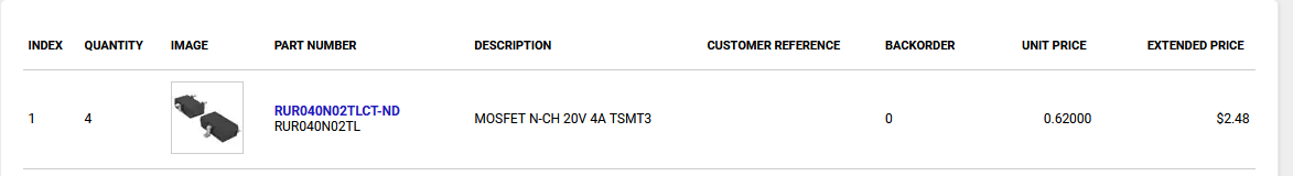

      Digikey has the AO3420 which is a 6 amp version that should be ok. They also have a RUR040N02TL 4 amp version.
      I believe RUR040N02TL 4 amp version is the one I have in the TV right now. The one's that are marked XF. Attached is what I bought from DigiKey.
        [ATTACH]267674[/ATTACH]
        That will work, You should have mentioned you got the mosfet from Digikey earlier as there is also a 100ma transistor with the marking XF, which would not work.
        So good to here you have it repaired. The red/green line is the R.F. channel indicator
