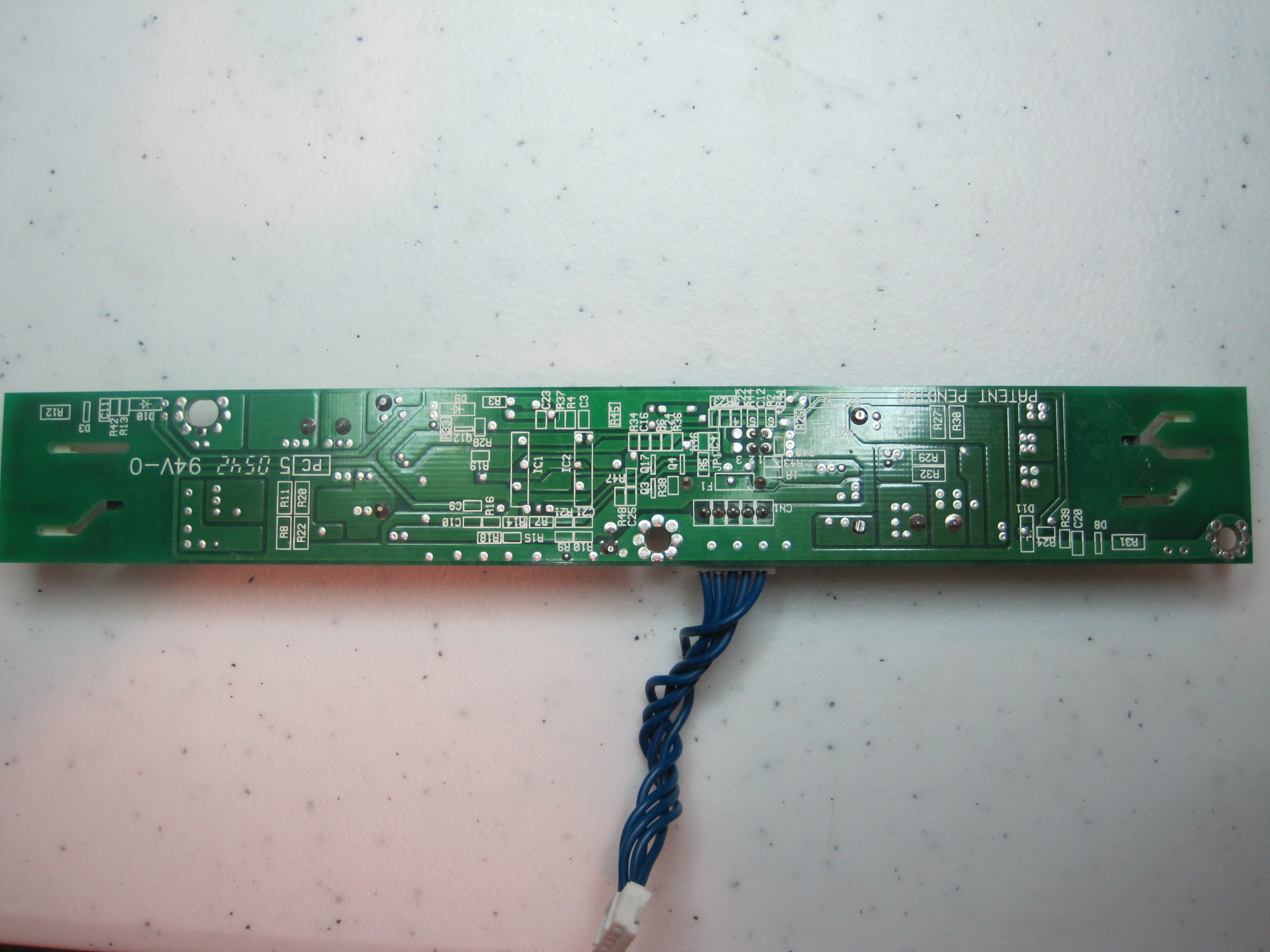

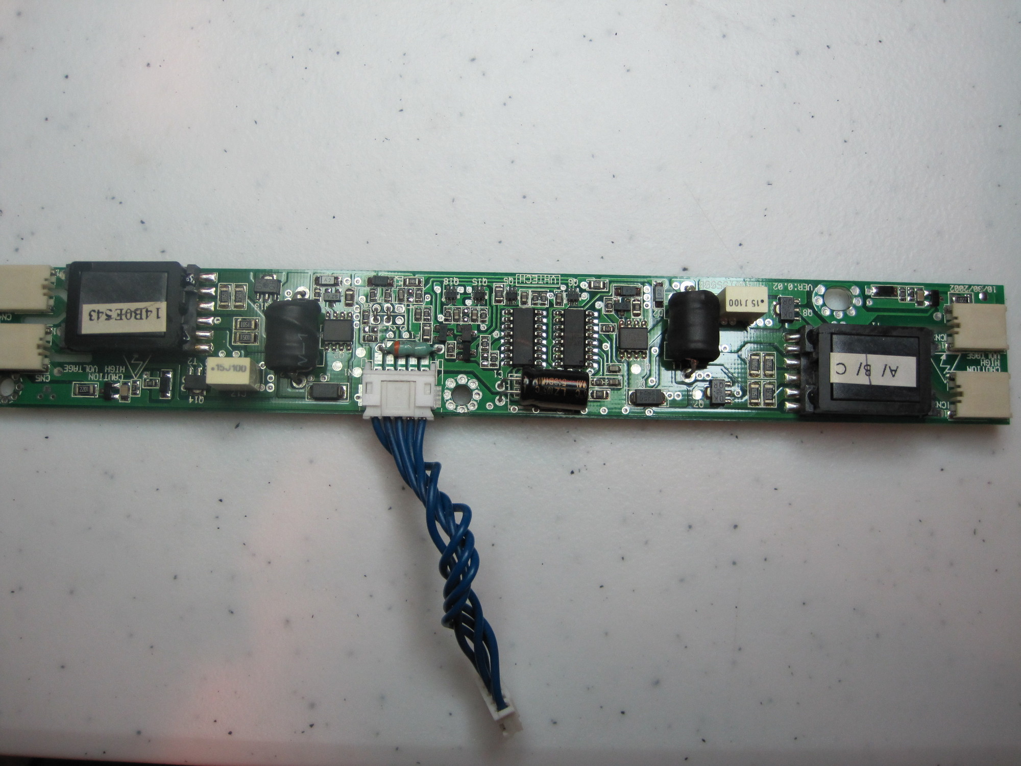

                                  http://www.simonlo.com.tw/download/s...0QDI17_noC.pdf
                                  This PDF shows a schematic and has crazy detail that is way out of my league.
                                  Inverter pictures attached.

                                      • retiredcaps
                                        • Apr 2010
                                        • 9271
                                        #39
                                        Re: Soyo VT17N71
                                        Originally posted by bsweasel
                                        Both green and orange light up at the same time. With or without a source.
                                        Sorry, I'm confused with the green and orange light up at the same time statement. Are you saying that the power LED (one LED) is green and orange?
                                        Or are there two LEDs and one is green and one is orange? If there are two LEDS, what are they?
                                        In fact, post a picture of the LED that is on.

                                        • bsweasel
                                          • Jun 2010
                                          • 82
                                          #40
                                          Re: Soyo VT17N71
                                          Its a dual color LED. one LED that lights both green and orange. I'm guessing its green when power is on, and orange in sleep mode.
