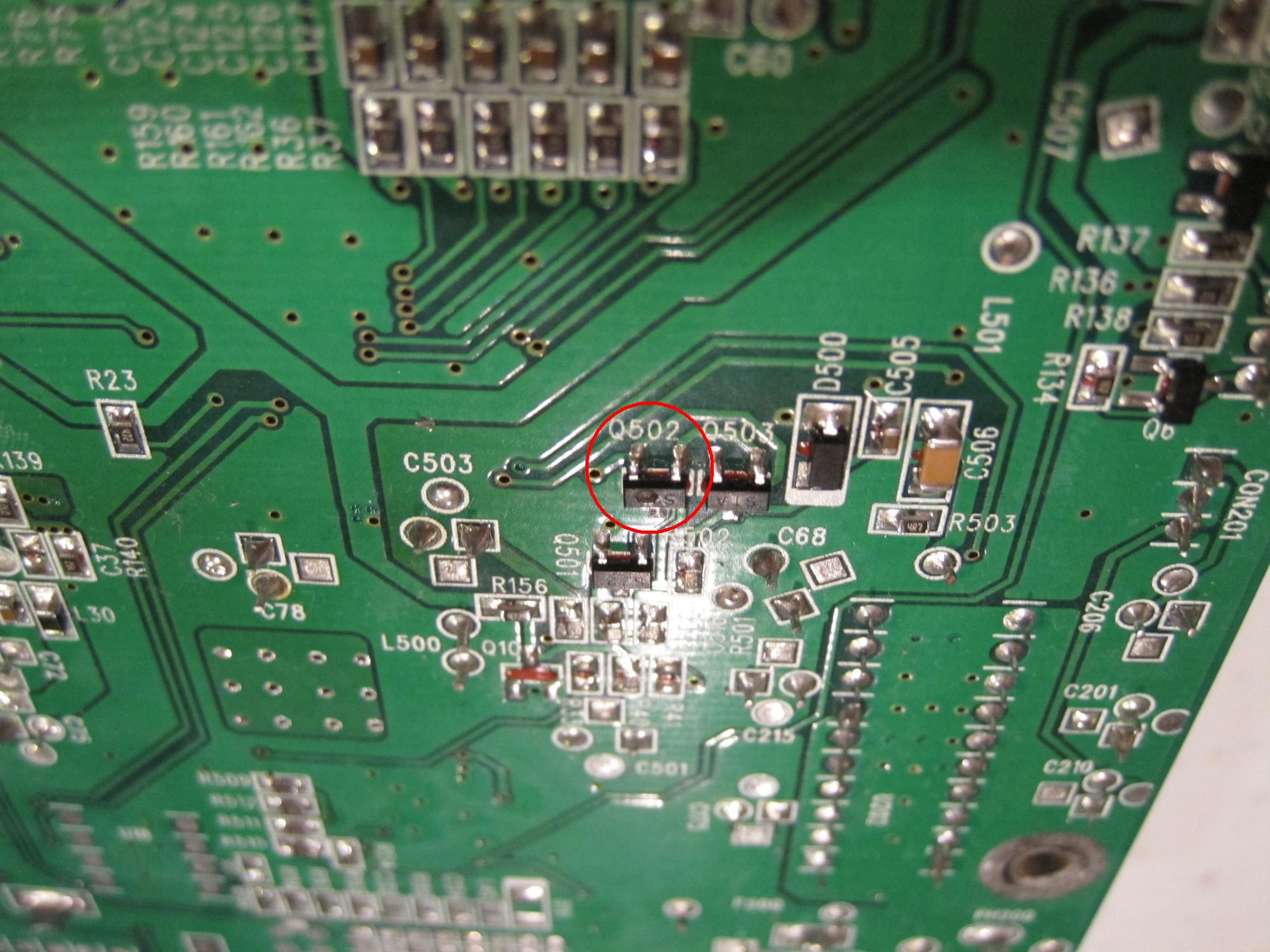

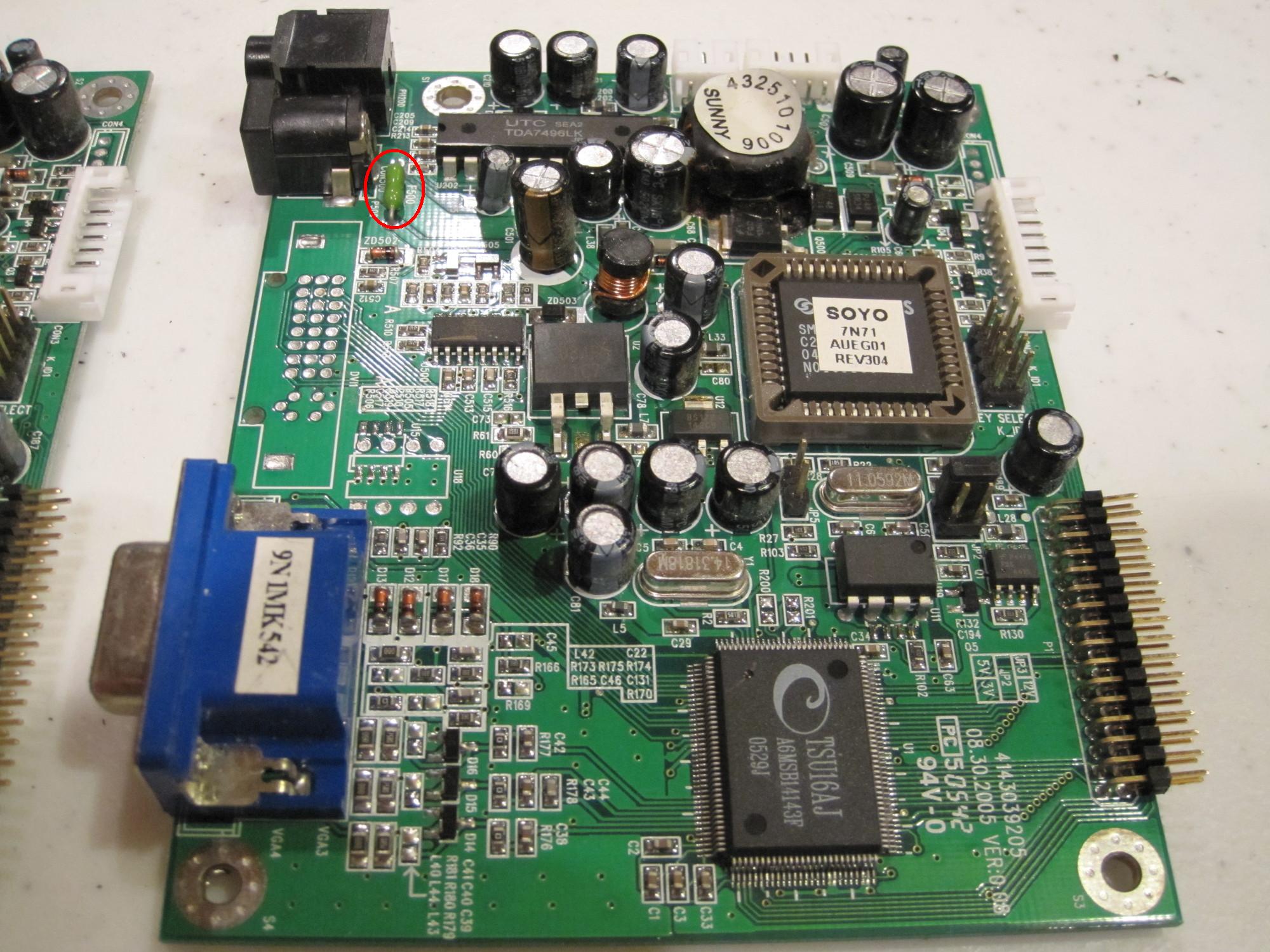

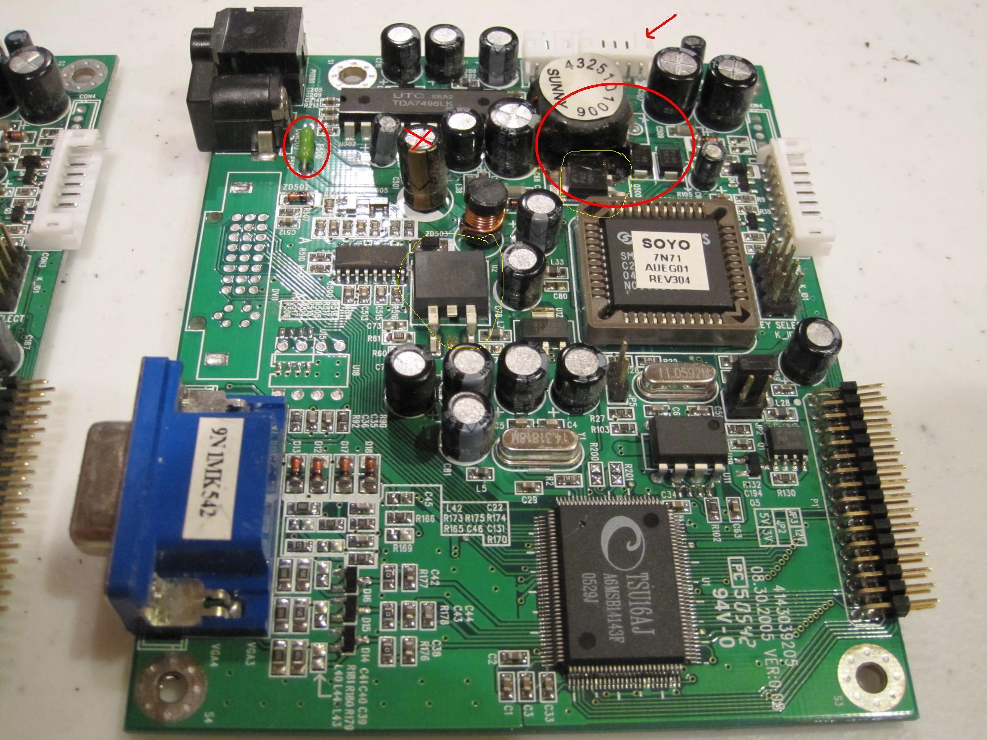

    I acquired a (2) 17" Soyo monitors to try and repair. Looks like they both have blown fuses. Picture 2 shows blown fuse, picture appears to have a blown diode on the back side (picture 3)??? It looks burnt in the corner. The other board appears to look ok. I'd like to get both working, but I may use one for parts. The input is a 12v DC external power supply which appears to be dishing out a clean 12.3 volts. Could someone point me what to look at next? I don't want to put in a new fuse and blow it without some more diagnosing.
    Thanks.
    PS. Inverter boards have fuses just after input and both fuses on both inverters are fine, so I'm thinking the problem lies in the board shown not in the inverter? Safe to assume or no?

    I'm not entirely which picture you mean is 1, 2, or 3. Anyway, the circled part Q502 is NOT a fuse. It's a transistor of some sort.
    The circled part F500 is a fuse.
    Step 1: Figure out what that part is that's fried. We need the writing on the top of the part. Does it look like it could be the same as the part next to it: Q503?

      Yeah, my pictures did not number right..... Q502 has "S2 A" on it. Like I said I have 2 of these boards both, with blown F500 fuses. and ony the one S2 A at Q502 looks burnt. Caps all "look" good too.
        Re: Soyo VT17N71
        That's a SMBT3906 PNP transistor. Remove it and then Check the other transistors for shorts, check ESR of caps in the area (on other side of board) if there are any.
        Then replace transistor with good part and test. This may be the same part that failed on the other board, just without visible effects of the failure.

          Well, I can't get the burnt q502 off the board.....no matter what I do, its like its glued and soldered on. So I started on the other board....just replaced the fuse and tested the largest cap that appears to be first in line on the trace, light came on for about 10 seconds, heard a pop, fuse blown again. The cap is G-Luxon 220uf 16v. Since I don't have a cap tester. by testing it, I removed from circuit and I just verified it would take a charge with my meter set to high ohm, and it was slowly climbing. Other transistors that look like Q502 all have readings on my diode test on my meter...none appear to be shorted. Any other thoughts?

                To get the Q502 off: add some solder to the pin on the side that only has 1 pin. Next use a metal pick and insert it under the leg while heating the solder. Still heating the solder, pry the leg up, and pry up the part some. Repeat on the other legs.

                          Ok, if that is truely a SMBT3906 PNP: . I lifted pin 3 the collector and did a diode test on 1 (Base) to 3 (Emitter) and it read shorted. Base to collector gave me a reading. So I'm guessing its shorted. I've replaced it with Digikey part SMBT3906INCT-ND and replaced pico fuse with Digikey part F2315-ND. Do you think I should power on and test?

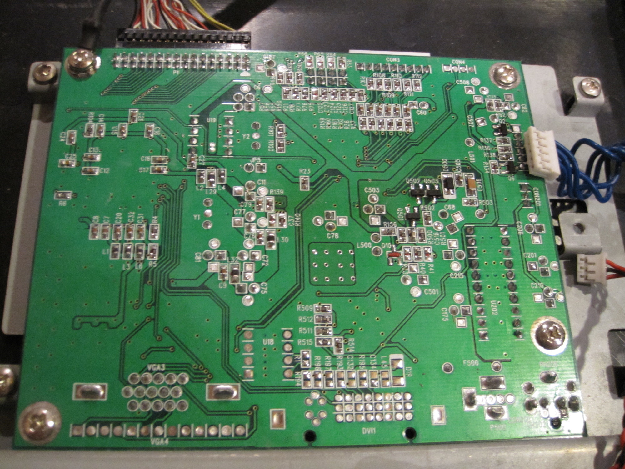

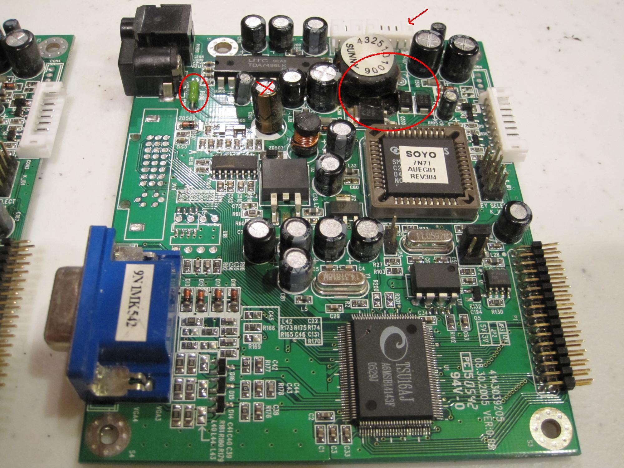

                                  Since I don't have an ESR meter, here is my latest replacements and tests. Attached is a newly marked picture. Cap with red X on top has been replaced with a used but most likely good rubycon 220uf 16v cap. I tested all the SMD resistors in the area, all seem ok. I plugged it in. The power led lights then gets dimmer. I tried the menu button and it attempts to light the CCFL's as they blink, but don't, then the power LED gets dimmer. It started smelling hot, so I unplugged it. The Large circle is the area that was VERY warm to touch after I shut it down. Can anyone help explain this? Is it that Coil labeled Sunny 4325101006? or the Diodes PJ48 SR34? Or Transistor that looks to be covered in some crusty burnt looking glue??? Any comments?
                                  PS the red arrow is the Connector that goes to the inverter board.
                                    Check the voltage regulator too in addition to the diodes for shorts.

                                      Re: Soyo VT17N71
                                      Could you tell me which one is the voltage regulator? I'm still learning the basics of this stuff.
                                        Re: Soyo VT17N71
                                        See yellow circled items. There may be more, but your pic isn't top down. It is slanted and hard to see.
