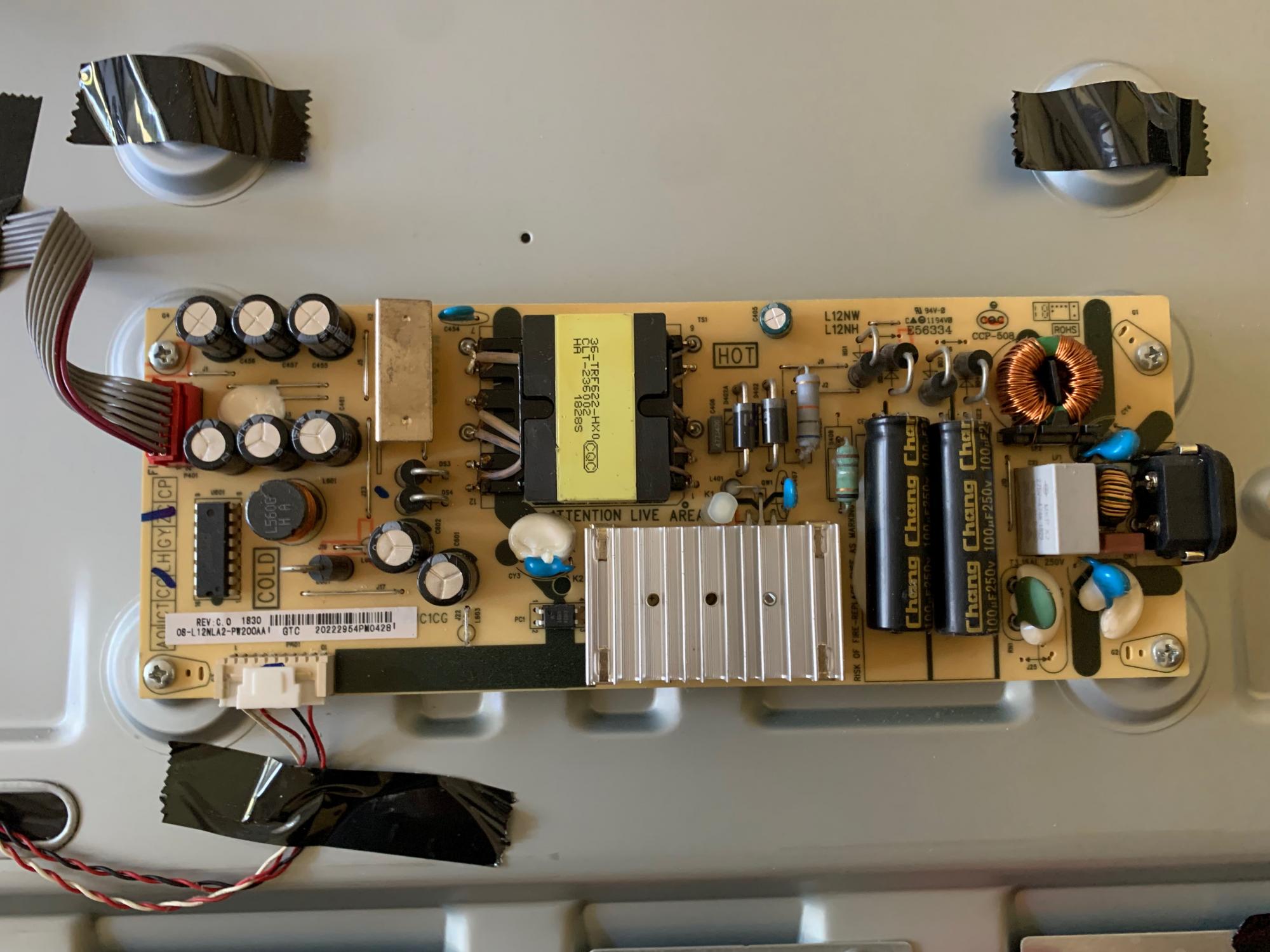

    Likely backlight strip but thought I check before tearing into this panel (read maybe easy to crack along the top edge due to glue so unclip the glued on bracket rather than separating glue... I'll definitely becareful!!! haha)
    Flash light shows image on LCD display
    Have sound (there is notification sound when powering off)

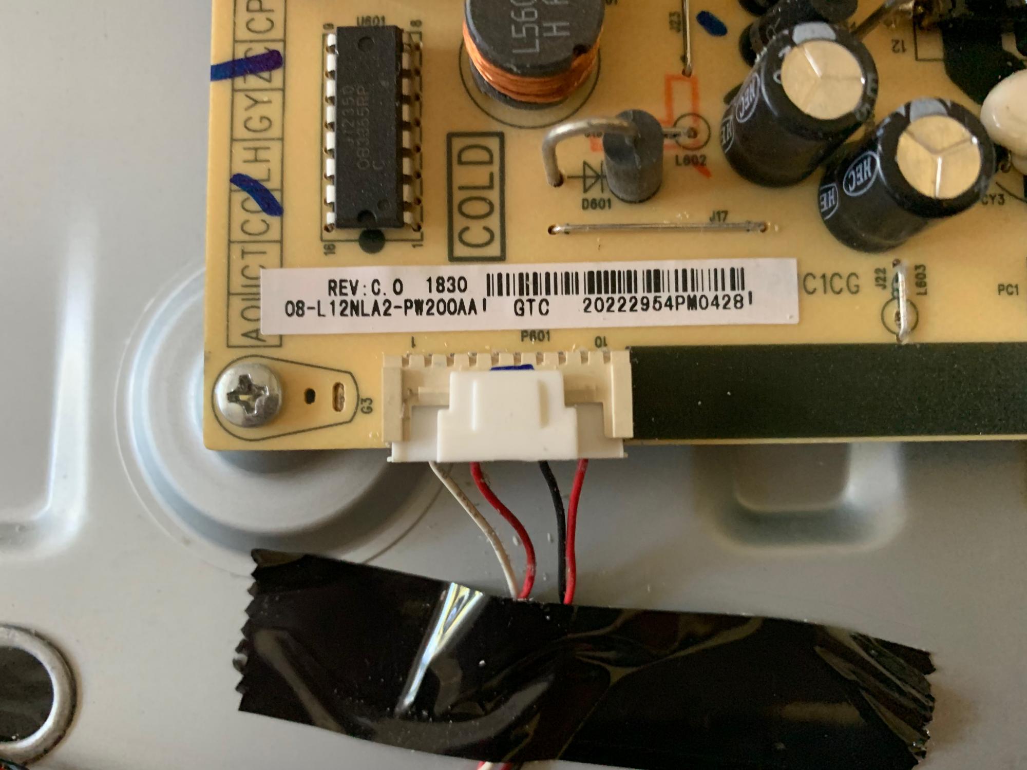

    PSU P401 connector BL_ON 0v -> 3.3v when powering on
    PSU P601 connector (4 wires to 2 LED strips, Each strip = 2 segments with 8+7 6V LEDs). When powering TV from off to on
    Pin 2 0v -> 0v
    Pin 4 85v -> 120v and gradually settle to 85v
    Pin 7 0v -> 0v
    Pin 9 85v -> 116v and gradually settles to 85v
    Pin 4 and 9 mostly holds at 85v while TV powered off after being powered on. If AC plug is removed, these will slowly drain down.
    Does this suggest LEDs are good or bad?
    Don't have LED strip tester but thinking about buying one. I should be able to connect tester on P601 pin 2+4 and pin 7+9 and see either strip light up if good right?

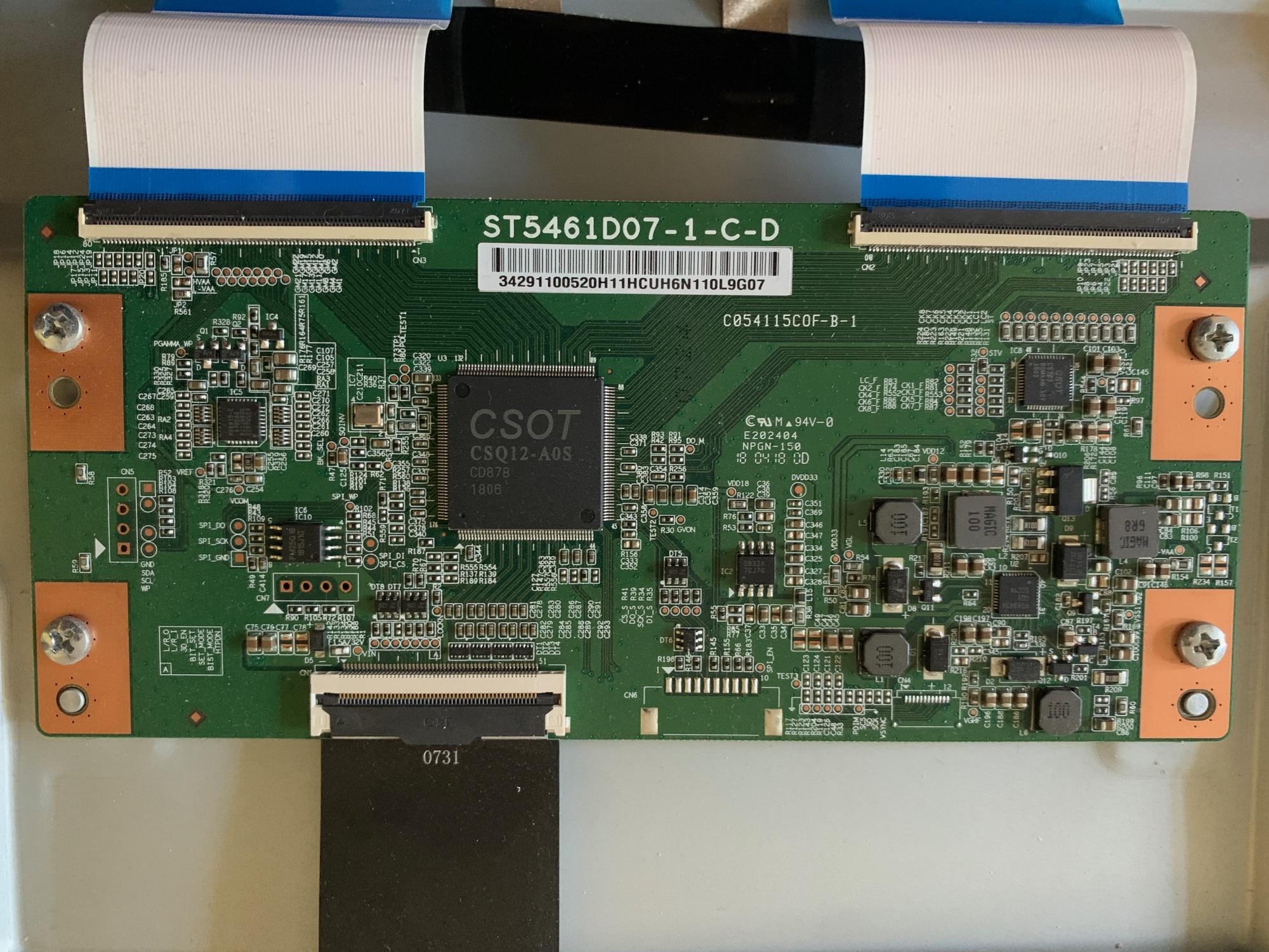

      Re: TCL 55S421 powers on + LCD display + sound but no backlight

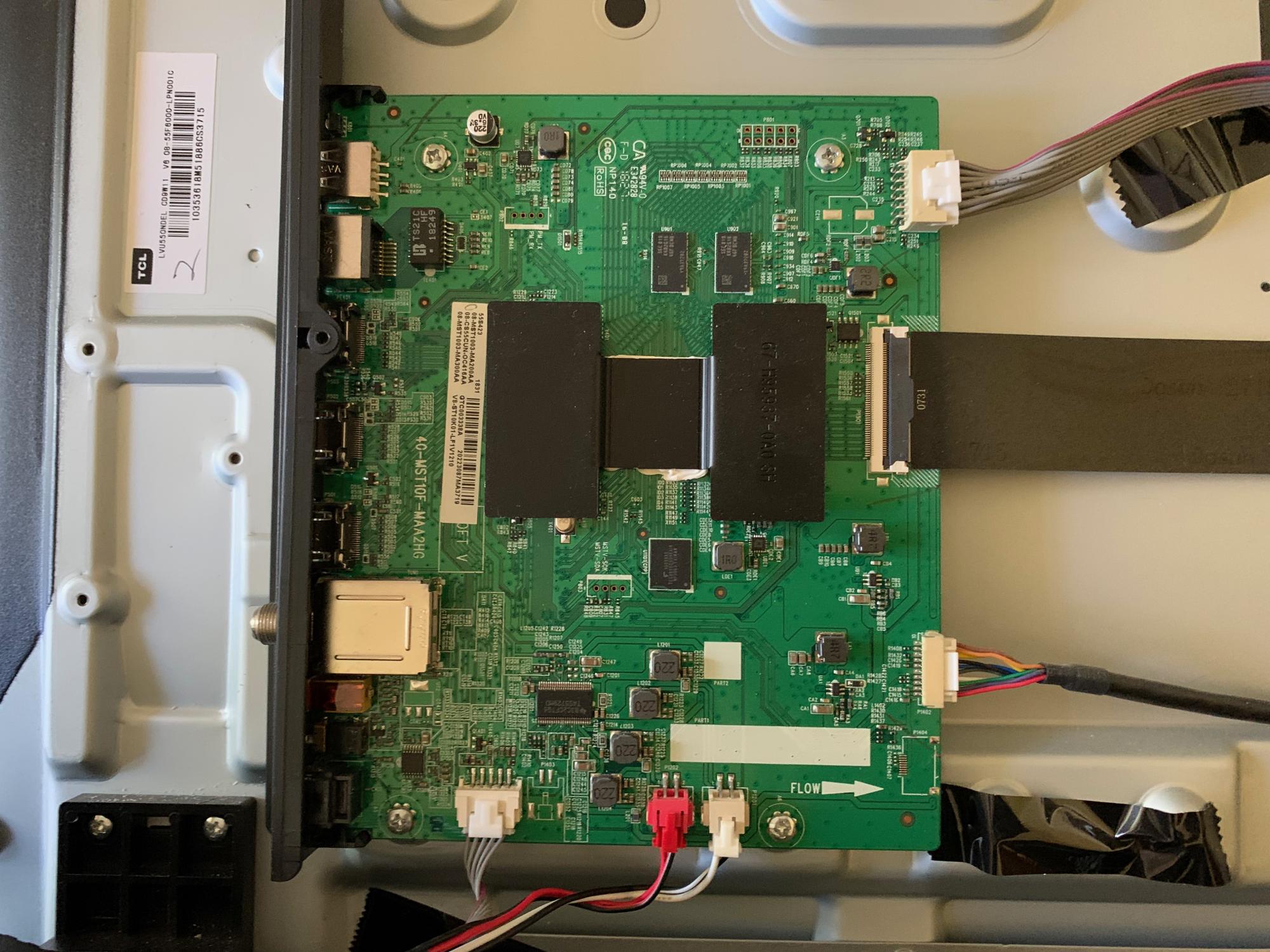

      check tcon fuse might be f101, see if you have about 12 volts on each side, using chassis ground.
      • howardc64
        • Jun 2017
        • 653
        do you get a backlight flash when you power up?
        No backlight flash ever.
        Uploaded more clear tcon pic on original posting. Fuse on top left of ribbon connector from main board reads 12v on both sides as well as the probe point to the right (Board says F1 5A/32V, I've seen mislabel before on Vizio TV boards)
          You already proved your t-con is ok with the flashlight test, You likely have an open backlight string causing the backlight driver to shut down.

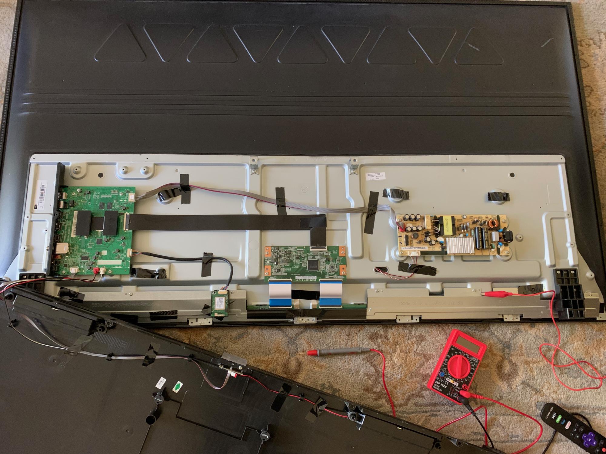

              3 more data point before diving into panel tear down for backlight access.
              From power off to on
              A_DIM 0.7v -> 2.6v
              P_ON 3.1v -> 3.1v (never changes)
              P_DIM 1.2v -> 3.4v
              Don't know whats normal.
              And just to double check, should be able to drive the LED strings from the PSU connector to see if they are good before panel teardown right? Should see 90v? (15 x 6v LED / string)

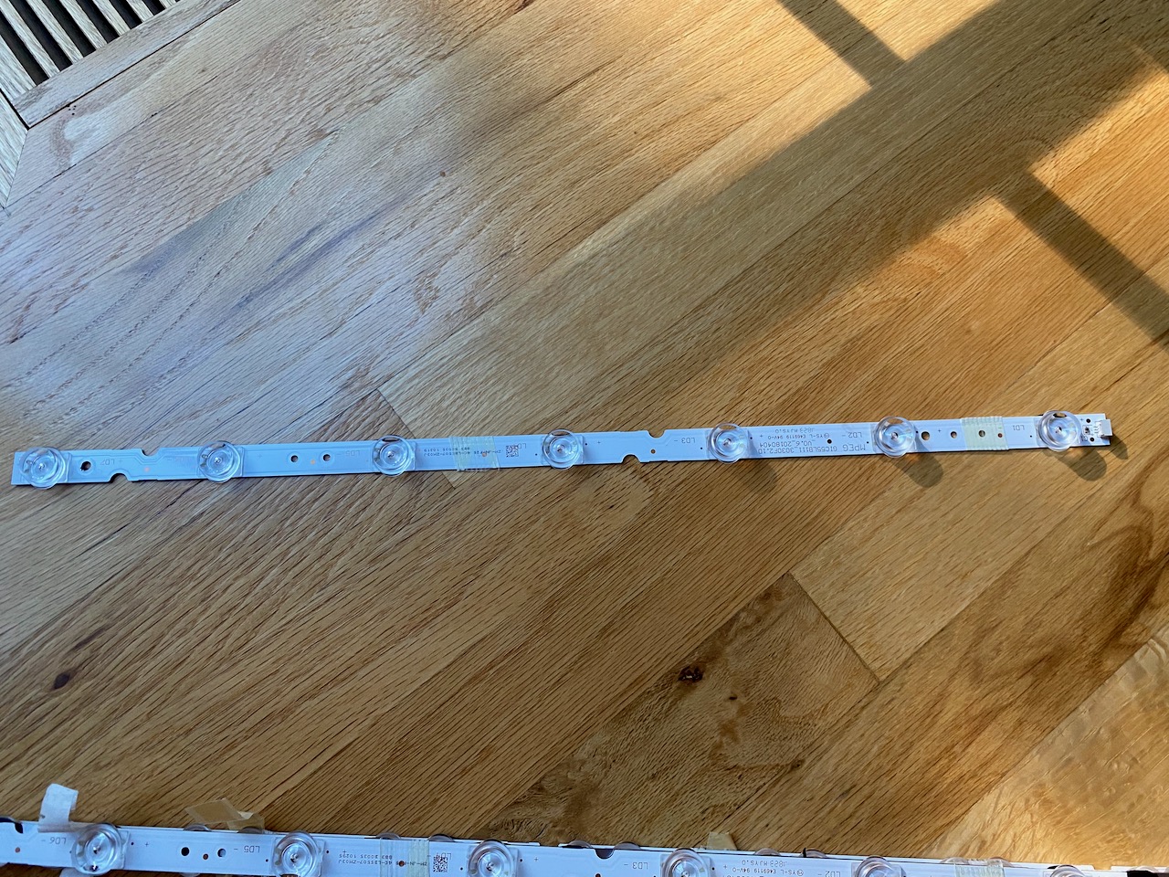

                    UPDATE
                    LED tester came in and sure enough 1 string has an open while the other string lights up fine towards 80v+
                    Waiting for 6V LED to arrive and will try to do individual LED repair on this one. Will post follow up later.

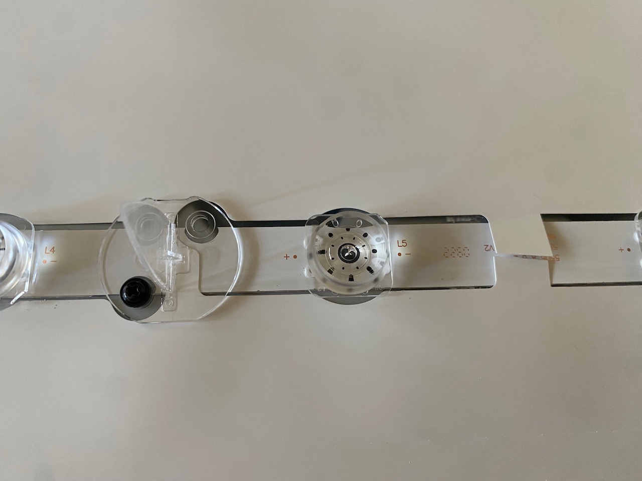

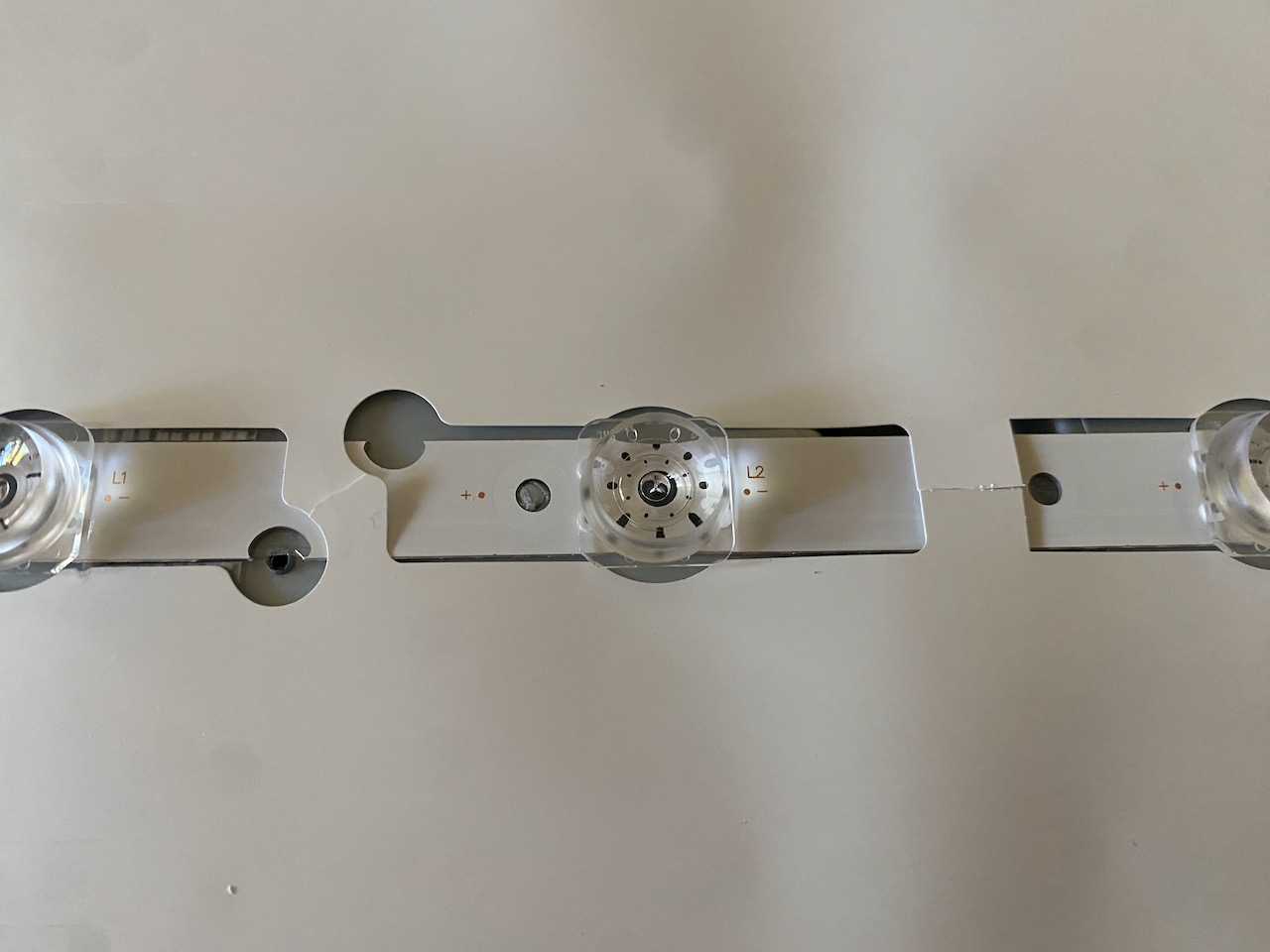

                        • howardc64
                          • Jun 2017
                          • 653
                          Tried single LED replacement. Definitely not for the first timer.
                          - Cutting off old LED left a copper plate that shorted anode/cathode. Not sure why. Perhaps was part of the old LED? Had to exacto knife to separate.
                          - Soldering iron is impossibly difficult. LED bar is a big heat sink taking away heat on the iron tip. Difficult to mount LED flat rather than tilted on one side.
                          - LED color temperature don't match
                          - Result is lightly tilted LED and likely higher than normal height under the lens
                          - Hot air requires low temp solder paste (had none on hand). Otherwise, too easy to toast the reflective white paper nearby.
                          Combined all these issues produced a circular ring bright spot when viewing flat bright colors in the replaced LED region.
                          Back to the entire LED bar replacement method. On this set, does require cutting the white reflective paper to get the bar out without ripping it.
                              UPDATE

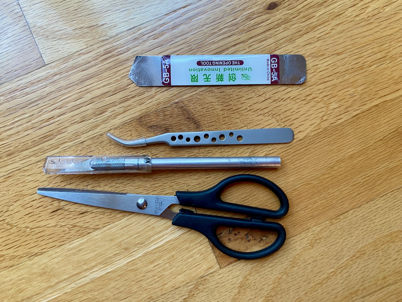

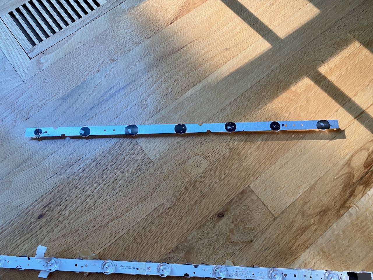

                              LED bars came in from Aliexpress ($12). Came with 2sided tape on the back. Installed it and here are few notes for future efforts
                              - Seems impossible to remove the white reflector paper above the LED bars without damaging it. So I did some cuts to get the bars out. Cuts are all in the center of the paper bridge over the LED bars. Plastic diffuser stands goes over some of these bridges. So if careful, can get old bar out and put new bar in without any problem.
                              - Old LED bars are only glued on under each LED and taped to the tub in 2 sections. A thin blade tool cut the bar glue pretty easily from under the bar. Clean the tool after each cut as the black glue will make their way onto the white reflector sheet (pick off any that gets on with tweezers) Xacto knife cut the tape on the edge of the bar. Some tapes are under the reflector sheet bridge so need to lift up the cut bridge to cut the tape. See pics.
                              - LED on 1 of the old string was warmer color than the other so best to just replace all bars.
