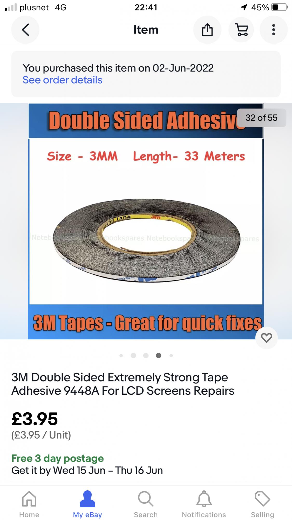

      Hi. I've just replaced the backlights on a 55" Hisense "bezel-less" television and used 3mm wide, double-sided 3M tape to bond the screen to the frame. Initially the panel remained attached to the housing and I was very pleased. However, when I checked a few hours later I was horrified to see the panel had detached itself and was leaning at 20 degrees. Before fitting the tape I ensured the housing and screen were clean and none of the original foam tape was present. I honestly thought that using 3M tape, a world leader in adhesives, would guarantee the panel remained in place. Can someone pleased tell me what else I need to do or send a link of a video showing me the correct process.

        Which 3M tape did you use and where did you purchase it from ?

          Hi Diff. Thanks for your question. I bought it on EBay and it has a 3M code of 9448A. I have uploaded a photo for your reference

            Re: Borderless TV screens (without bezel)
            You've used the wrong tape. That's not strong enough and coming from ebay is possibly fake.
            It's some 3M VHB tape you should be using,

              Thanks again for the advice. Do you know where I can buy 3mm VHB ?
                rs online
                  Thank you Vince. I'll let you know how it goes.
                  • djmka
                    • Aug 2021
                    • 35
                    • England
                    Quick update - the tape that vinceroger69 suggested worked perfectly. Thanks again to all who those who respond to cries for help.
