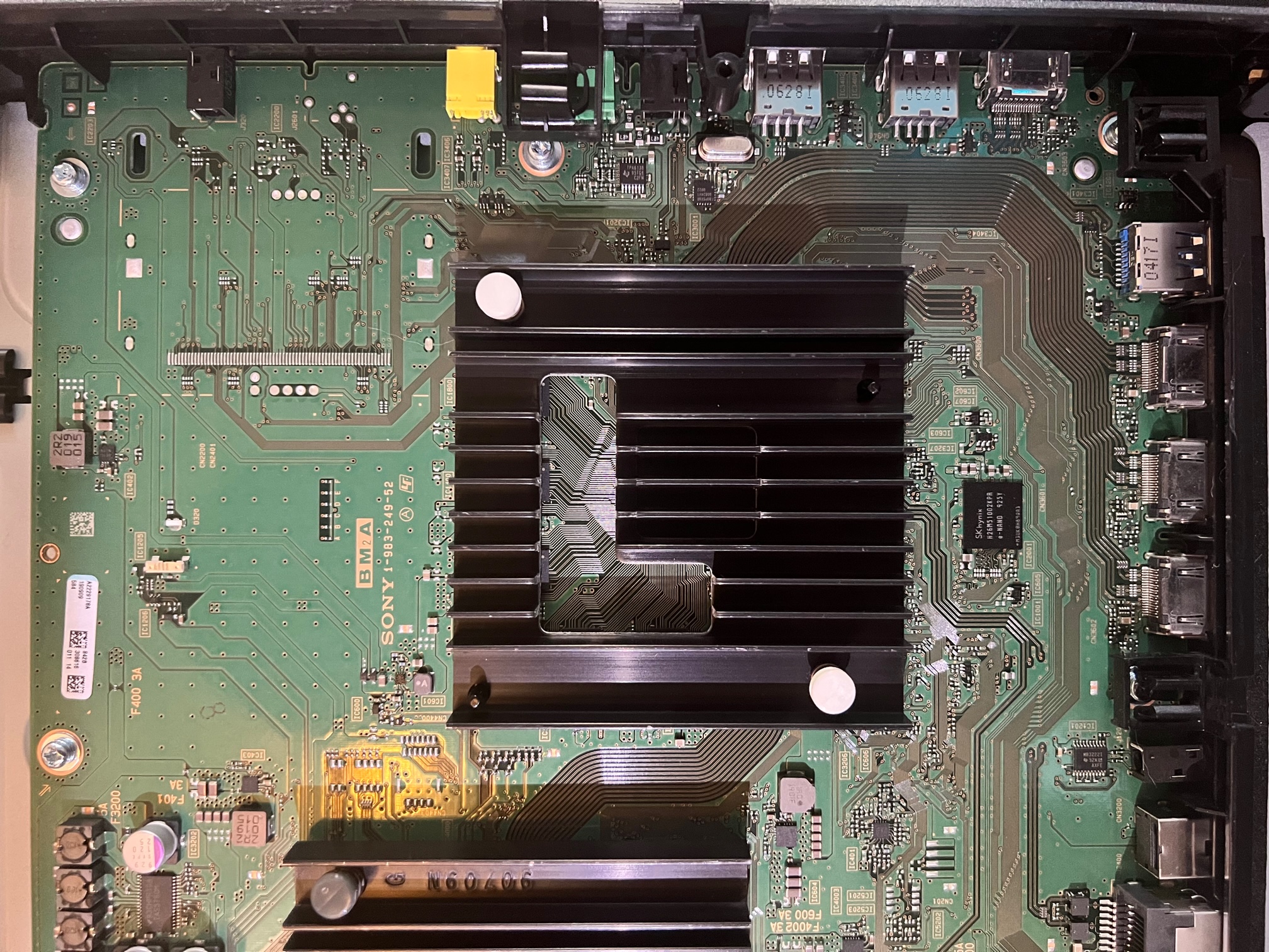

          Re: Sony XBR-55A8G 4K OLED image ghosting/jumping around
          Repair the MB by reflew it by heating. show us the photo please over here use GO advanced and post the MB photos clear and focused from the TOP and down side.
          • Cheesesteak
            • Apr 2022
            • 11

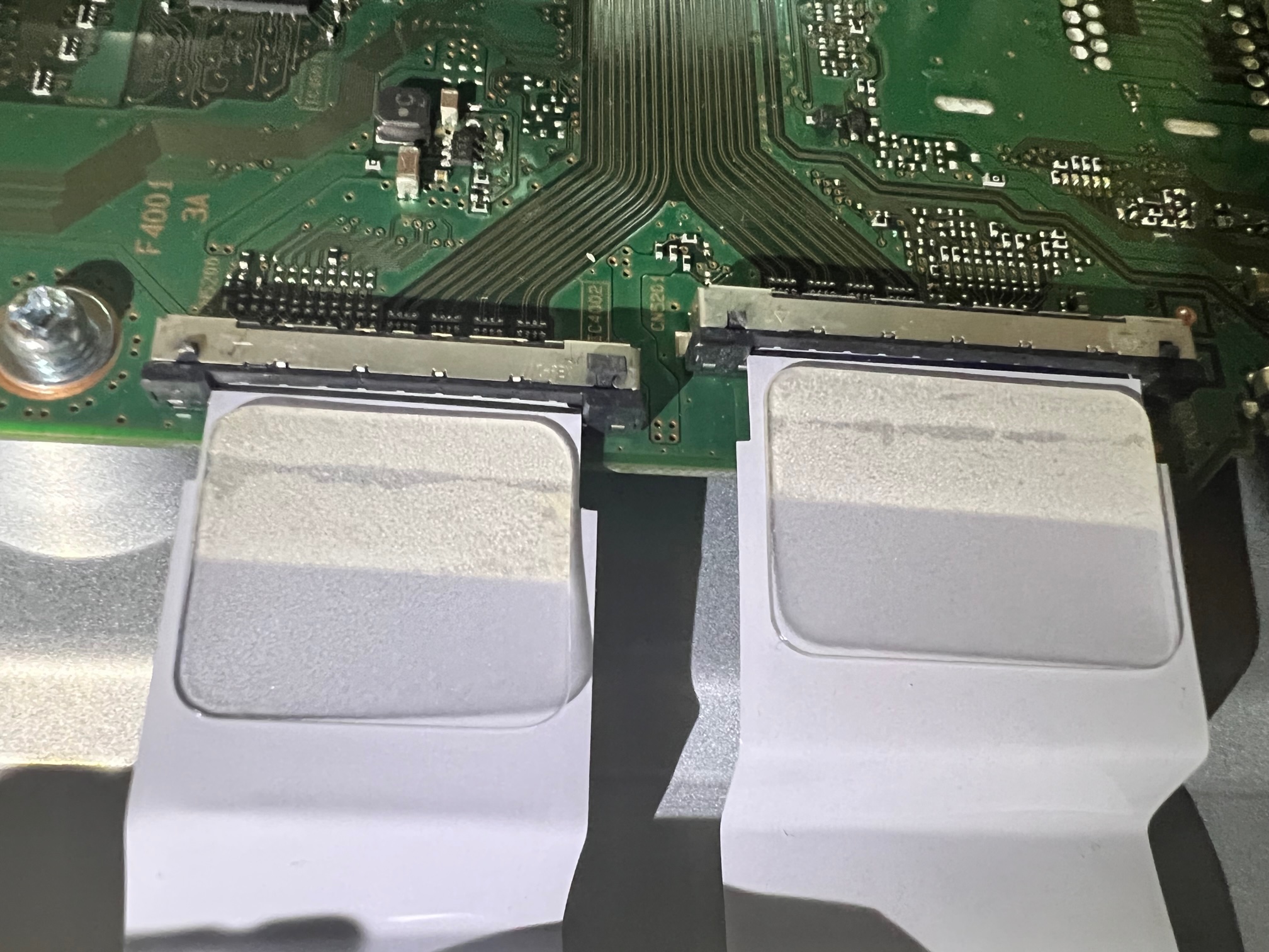

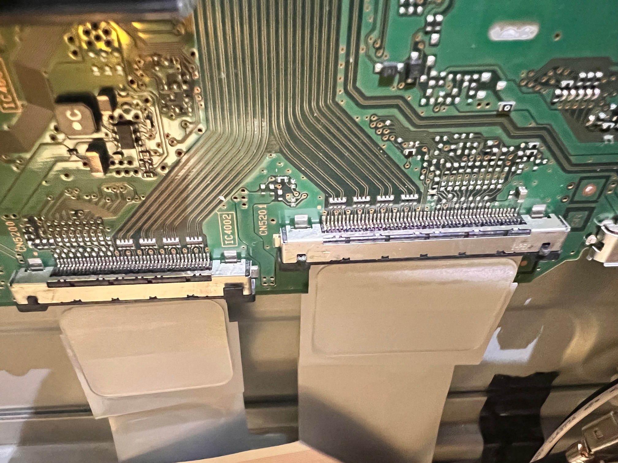

            I uploaded pics of the front of the mainboard, any suggestions on getting these ribbon cables out? These are the only two I could not get, I don't want to break them.
            I will upload pics of the back once I get these out, thank you for the help so far.

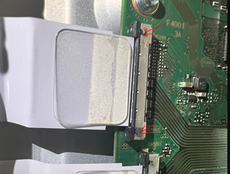

                1- Press
                2- Pull
                • Cheesesteak
                  • Apr 2022
                  • 11
                  Originally posted by Diah
                  1- Press
                  2- Pull
                  Hello, the side of these is hard molded plastic, there is nothing to press in.
                  • Diah
                    • Feb 2013
                    • 6419
                    this is yours problem... bad connection... i wrote at post #3

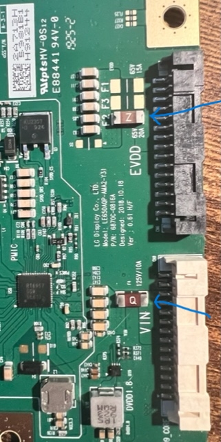

                              as i thought in my post#3 as BGA and he did changed MB... so the issue remain BGA or bad connection at LVDS /T-CON / Ribbon / you need to put yours DMM and measure the 12V rail and 22V rail which coming from PCB to T-CON if they are stable or jumping as the picture change.
                              • Cheesesteak
                                • Apr 2022
                                • 11
                                here OLED Panel not LCD.
                                Thank you Diah, I will check those with multimeter and respond to the thread with results.
                                I have also ordered replacement FLEXIBLE FLAT CABLES 41P/51P for connection from mainboard to TCON but they will not arrive for a couple weeks.
                                  You need to press on these latches, one of you is broken on one side.
                                  • Cheesesteak
                                    • Apr 2022
                                    • 11
                                    Thanks Lotas, I figured that out, the connectors are still secure and function, just the little tab thing broke at the top.
                                      Hi Diah,
                                      Are you referencing testing these input voltages from PSU rails to TCON? (See image)
                                      • Diah
                                        • Feb 2013
                                        • 6419
                                        Hi Diah,
                                        yes
