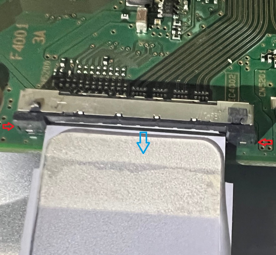

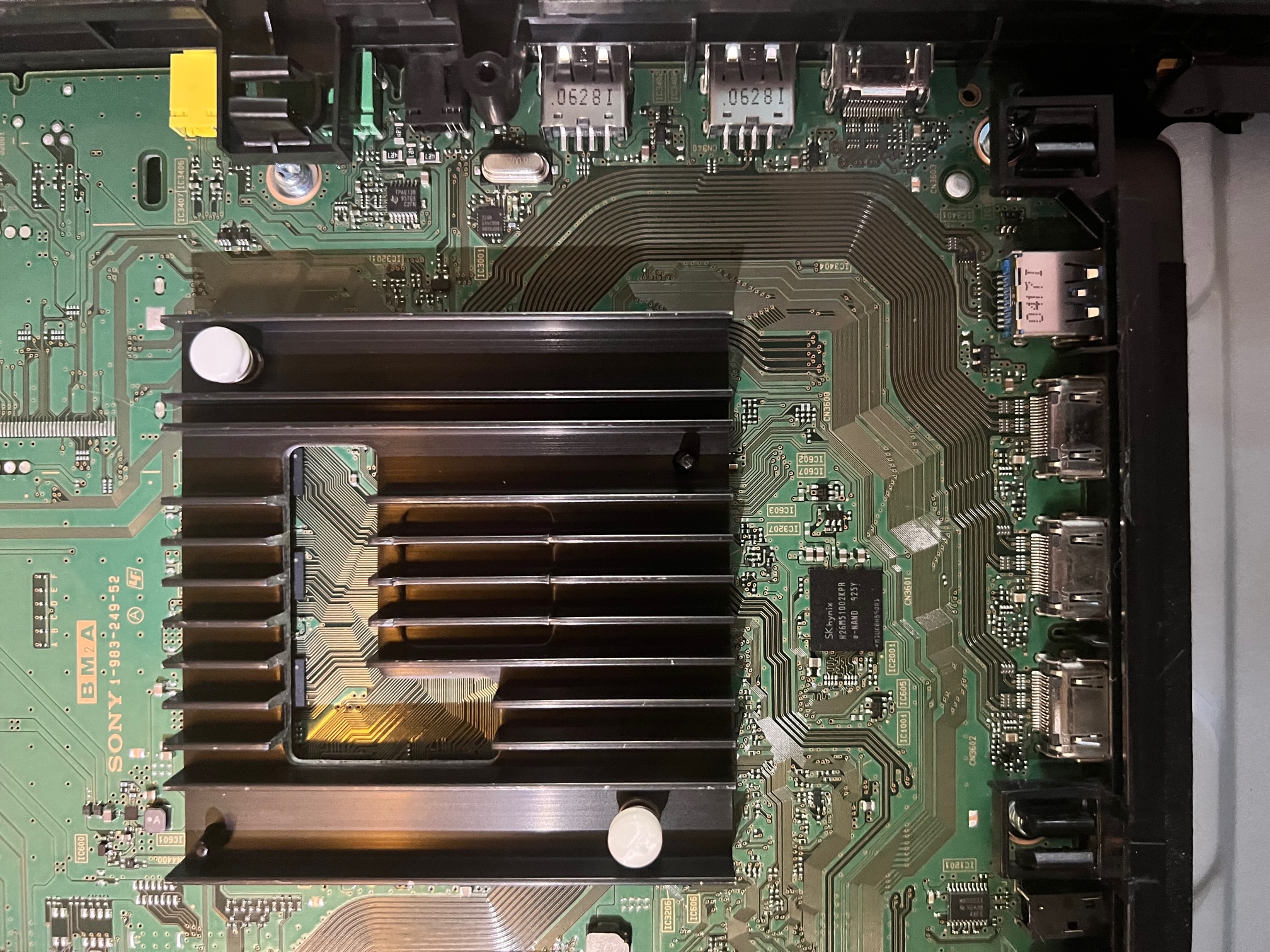

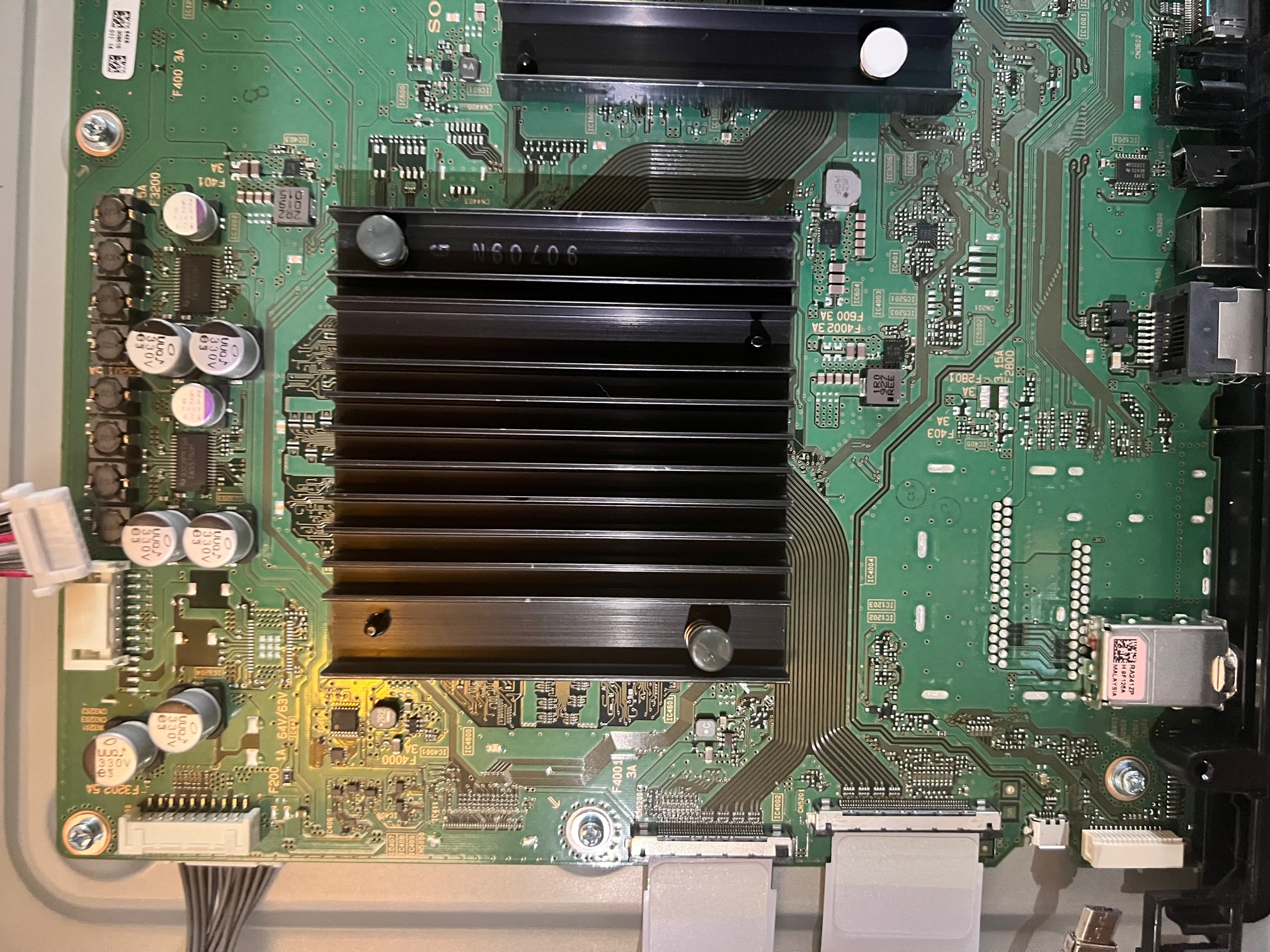

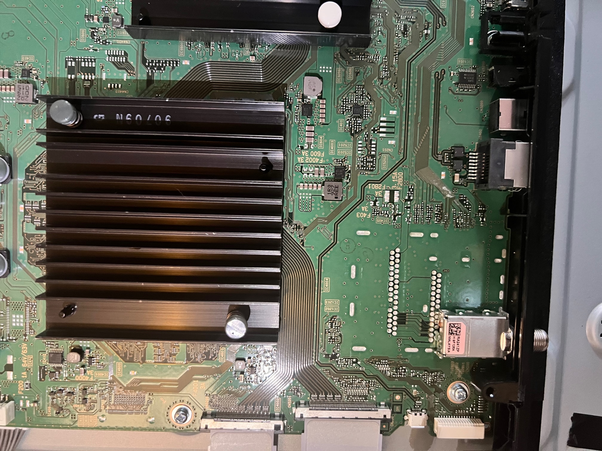

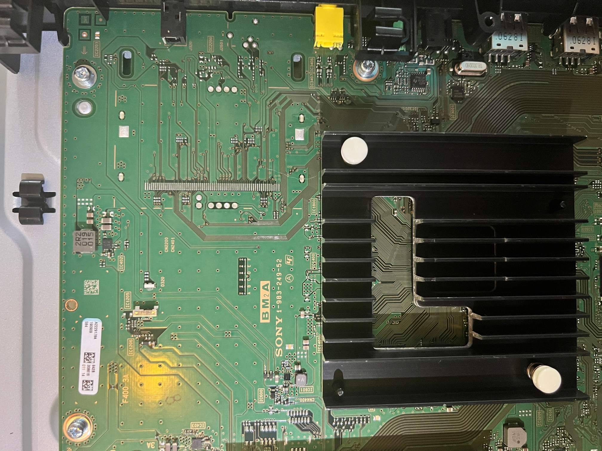

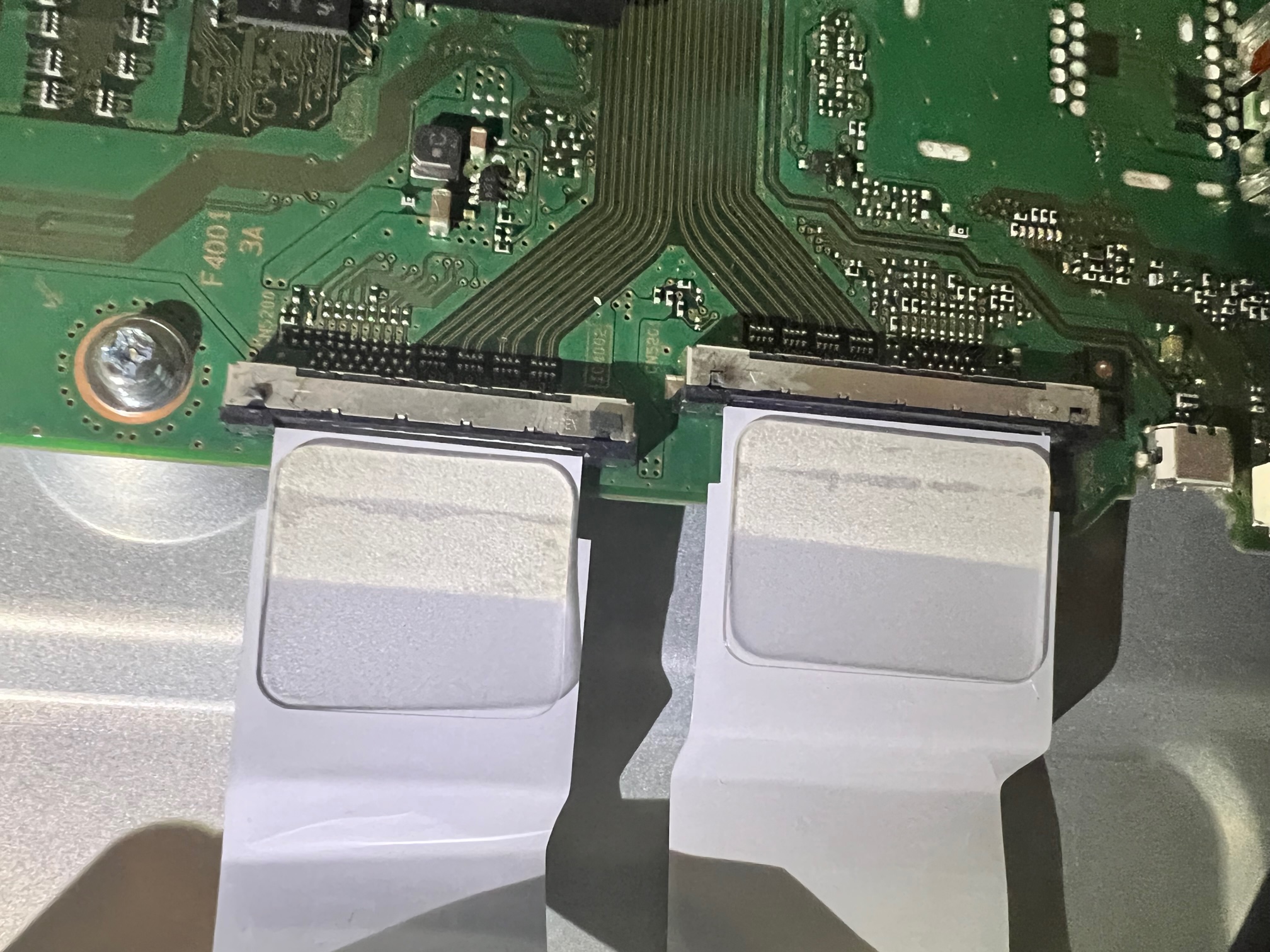

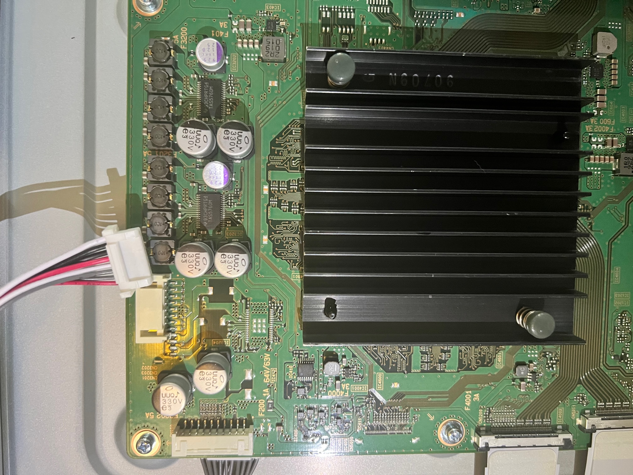

Sony XBR-55A8G 4K OLED image ghosting/jumping around
  • Diah
    replied
    Re: Sony XBR-55A8G 4K OLED image ghosting/jumping around
    about the point which Lotas bring it at post #17, its seriouse , we didnt judge the socket self if it scure connected ot not... but the LVDS cable are flat one and at the end of it the pins by pressure connect to the LVDS end plug, if there no tight mean we do have the issue as i wrote in post #3 & #10
    Leave a comment:
  • Diah
    replied
    Re: Sony XBR-55A8G 4K OLED image ghosting/jumping around
    Originally posted by Cheesesteak
    Hi Diah,
    Are you referencing testing these input voltages from PSU rails to TCON? (See image)
    yes
    Leave a comment:
  • Cheesesteak
    replied
    Re: Sony XBR-55A8G 4K OLED image ghosting/jumping around
    Originally posted by Cheesesteak
    Thank you Diah, I will check those with multimeter and respond to the thread with results.
    I have also ordered replacement FLEXIBLE FLAT CABLES 41P/51P for connection from mainboard to TCON but they will not arrive for a couple weeks.
    Hi Diah,
    Are you referencing testing these input voltages from PSU rails to TCON? (See image)
    Leave a comment:
  • Cheesesteak
    replied
    Re: Sony XBR-55A8G 4K OLED image ghosting/jumping around
    Originally posted by lotas
    You need to press on these latches, one of you is broken on one side.
    Thanks Lotas, I figured that out, the connectors are still secure and function, just the little tab thing broke at the top.
    Leave a comment:
  • lotas
    replied
    Re: Sony XBR-55A8G 4K OLED image ghosting/jumping around
    Originally posted by Cheesesteak
    Hello, the side of these is hard molded plastic, there is nothing to press in.
    You need to press on these latches, one of you is broken on one side.
    Leave a comment:
  • Cheesesteak
    replied
    Re: Sony XBR-55A8G 4K OLED image ghosting/jumping around
    Originally posted by Diah
    here OLED Panel not LCD.
    as i thought in my post#3 as BGA and he did changed MB... so the issue remain BGA or bad connection at LVDS /T-CON / Ribbon / you need to put yours DMM and measure the 12V rail and 22V rail which coming from PCB to T-CON if they are stable or jumping as the picture change.
    Thank you Diah, I will check those with multimeter and respond to the thread with results.
    I have also ordered replacement FLEXIBLE FLAT CABLES 41P/51P for connection from mainboard to TCON but they will not arrive for a couple weeks.
    Leave a comment:
  • Diah
    replied
    Re: Sony XBR-55A8G 4K OLED image ghosting/jumping around
    here OLED Panel not LCD.
    as i thought in my post#3 as BGA and he did changed MB... so the issue remain BGA or bad connection at LVDS /T-CON / Ribbon / you need to put yours DMM and measure the 12V rail and 22V rail which coming from PCB to T-CON if they are stable or jumping as the picture change.
    Leave a comment:
  • Nick's Tvs
    replied
    Re: Sony XBR-55A8G 4K OLED image ghosting/jumping around
    You might have a faulty panel, but you might still be able to fix it by blocking the correct clock lines.
    Check out this video from frugal TV repair on how to do this.
    https://youtu.be/pfrRhw7-ZII
    Leave a comment:
  • Cheesesteak
    replied
    Re: Sony XBR-55A8G 4K OLED image ghosting/jumping around
    might need to update/pair the firmware.
    Yes I upgraded firmware to latest from Sony website already as well.
    Leave a comment:
  • nomoresonys
    replied
    Re: Sony XBR-55A8G 4K OLED image ghosting/jumping around
    might need to update/pair the firmware.
    Leave a comment:
  • Cheesesteak
    replied
    Re: Sony XBR-55A8G 4K OLED image ghosting/jumping around
    Hello again, I have replaced the motherboard with a new motherboard and the issue still persists exactly the same, any other suggestions of things to try?
    Leave a comment:
  • Diah
    replied
    Re: Sony XBR-55A8G 4K OLED image ghosting/jumping around
    this is yours problem... bad connection... i wrote at post #3
    Leave a comment:
  • Cheesesteak
    replied
    Re: Sony XBR-55A8G 4K OLED image ghosting/jumping around
    Originally posted by Diah
    1- Press
    2- Pull
    Hello, the side of these is hard molded plastic, there is nothing to press in.
    Leave a comment:
  • Diah
    replied
    Re: Sony XBR-55A8G 4K OLED image ghosting/jumping around
    1- Press
    2- Pull
    Leave a comment:
  • Cheesesteak
    replied
    Re: Sony XBR-55A8G 4K OLED image ghosting/jumping around
    Originally posted by William1967
    Taping cables will result in a shut down / error. This t-con is not similar like the ones from lcd/led tv's.
    The problem looks like a gate error but i'm not 100% sure because i've never seen this failure in an oled tv.
    Thank you for the information William. That helps me from going on a wild goose chase.
    Leave a comment:
  • Cheesesteak
    replied
    Re: Sony XBR-55A8G 4K OLED image ghosting/jumping around
    I uploaded pics of the front of the mainboard, any suggestions on getting these ribbon cables out? These are the only two I could not get, I don't want to break them.
    I will upload pics of the back once I get these out, thank you for the help so far.
    Leave a comment:
  • Diah
    replied
    Re: Sony XBR-55A8G 4K OLED image ghosting/jumping around
    Repair the MB by reflew it by heating. show us the photo please over here use GO advanced and post the MB photos clear and focused from the TOP and down side.
    Leave a comment:
  • Cheesesteak
    replied
    Re: Sony XBR-55A8G 4K OLED image ghosting/jumping around
    Originally posted by Diah
    it sound you have BGA issue at MB. FRC IC react of losing signal from main IC.
    FRC IC = the one close to LVDS.
    Do you think replacing the mainboard would fix this issue? Or mainboard and cables?
    Leave a comment:
  • Diah
    replied
    Re: Sony XBR-55A8G 4K OLED image ghosting/jumping around
    it sound you have BGA issue at MB. FRC IC react of losing signal from main IC.
    FRC IC = the one close to LVDS.
    Leave a comment:
  • William1967
    replied
    Re: Sony XBR-55A8G 4K OLED image ghosting/jumping around
    Taping cables will result in a shut down / error. This t-con is not similar like the ones from lcd/led tv's.
    The problem looks like a gate error but i'm not 100% sure because i've never seen this failure in an oled tv.
    Leave a comment:
    ASUS VivoBook Vivobook Pro 15 OLED D3500QC-L1351W Notebook Pro 15 OLED Specification for Upgrade or Repair
    This specification for the ASUS VivoBook Vivobook Pro 15 OLED D3500QC-L1351W Notebook can be useful for upgrading or repairing a laptop that is not working. As a community we are working through our specifications to add valuable data like the Vivobook Pro 15 OLED D3500QC-L1351W boardview and Vivobook Pro 15 OLED D3500QC-L1351W schematic. Our users have donated over 1 million documents which are being added to the site. This page will be updated soon with additional information. Alternatively you can request additional help from our users directly on the relevant badcaps forum. Please note that...
    09-07-2024, 04:30 AM
  • Glaval
    Sony OLED XBR-65A8G 4 flashes
    by Glaval
    Hello, my Aunt recently gave me her broken Sony XBR-65A8G OLED after getting a replacement. It had a 4x led flash error, a replacement T-con didn't fix the error but with helpful info from this forum I found one of the smd ceramic caps on the panel pcb (C575/C378) on a 24v line was shorted to ground. I removed that cap and the tv turned on without error. It still had a black screen with the original t-con back in it, once I put the replacement t-con in it finally had a picture. After doing a panel refresh it had a very good picture but with a few vertical lines for some scenes. For owners with...
    01-23-2025, 04:04 PM
    Gigabyte AERO 16 OLED BSF-A3LA964SP Notebook Specification for Upgrade or Repair
    This specification for the Gigabyte AERO 16 OLED BSF-A3LA964SP Notebook can be useful for upgrading or repairing a laptop that is not working. As a community we are working through our specifications to add valuable data like the 16 OLED BSF-A3LA964SP boardview and 16 OLED BSF-A3LA964SP schematic. Our users have donated over 1 million documents which are being added to the site. This page will be updated soon with additional information. Alternatively you can request additional help from our users directly on the relevant badcaps forum. Please note that we offer no warranties that any specification,...
    09-07-2024, 07:12 AM
    Gigabyte AERO 14 OLED BMF-72ESBB4SH Notebook Specification for Upgrade or Repair
    This specification for the Gigabyte AERO 14 OLED BMF-72ESBB4SH Notebook can be useful for upgrading or repairing a laptop that is not working. As a community we are working through our specifications to add valuable data like the 14 OLED BMF-72ESBB4SH boardview and 14 OLED BMF-72ESBB4SH schematic. Our users have donated over 1 million documents which are being added to the site. This page will be updated soon with additional information. Alternatively you can request additional help from our users directly on the relevant badcaps forum. Please note that we offer no warranties that any specification,...
    09-07-2024, 07:12 AM
    Gigabyte AERO 14 OLED 9MF-E2USBB4SH Notebook Specification for Upgrade or Repair
    This specification for the Gigabyte AERO 14 OLED 9MF-E2USBB4SH Notebook can be useful for upgrading or repairing a laptop that is not working. As a community we are working through our specifications to add valuable data like the 14 OLED 9MF-E2USBB4SH boardview and 14 OLED 9MF-E2USBB4SH schematic. Our users have donated over 1 million documents which are being added to the site. This page will be updated soon with additional information. Alternatively you can request additional help from our users directly on the relevant badcaps forum. Please note that we offer no warranties that any specification,...
    09-07-2024, 06:40 AM
