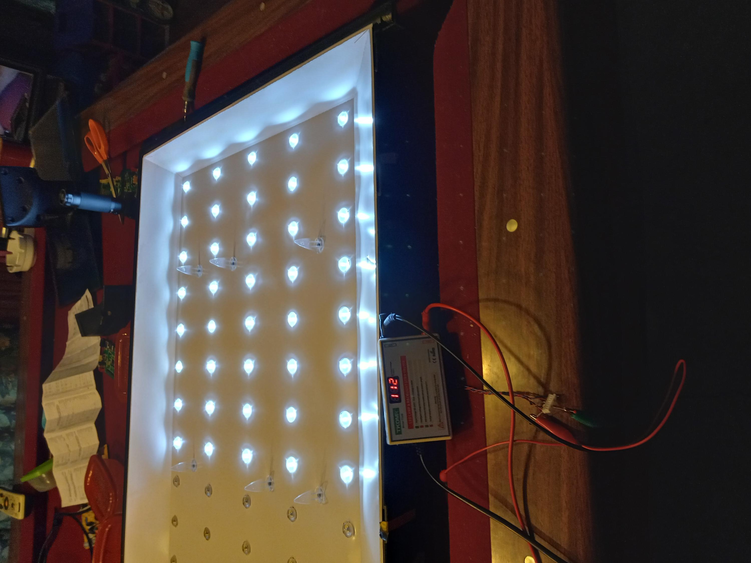

        Re: RCA LED46C45RQ,Sound but no Back lights
        bl 1 fast flash then off

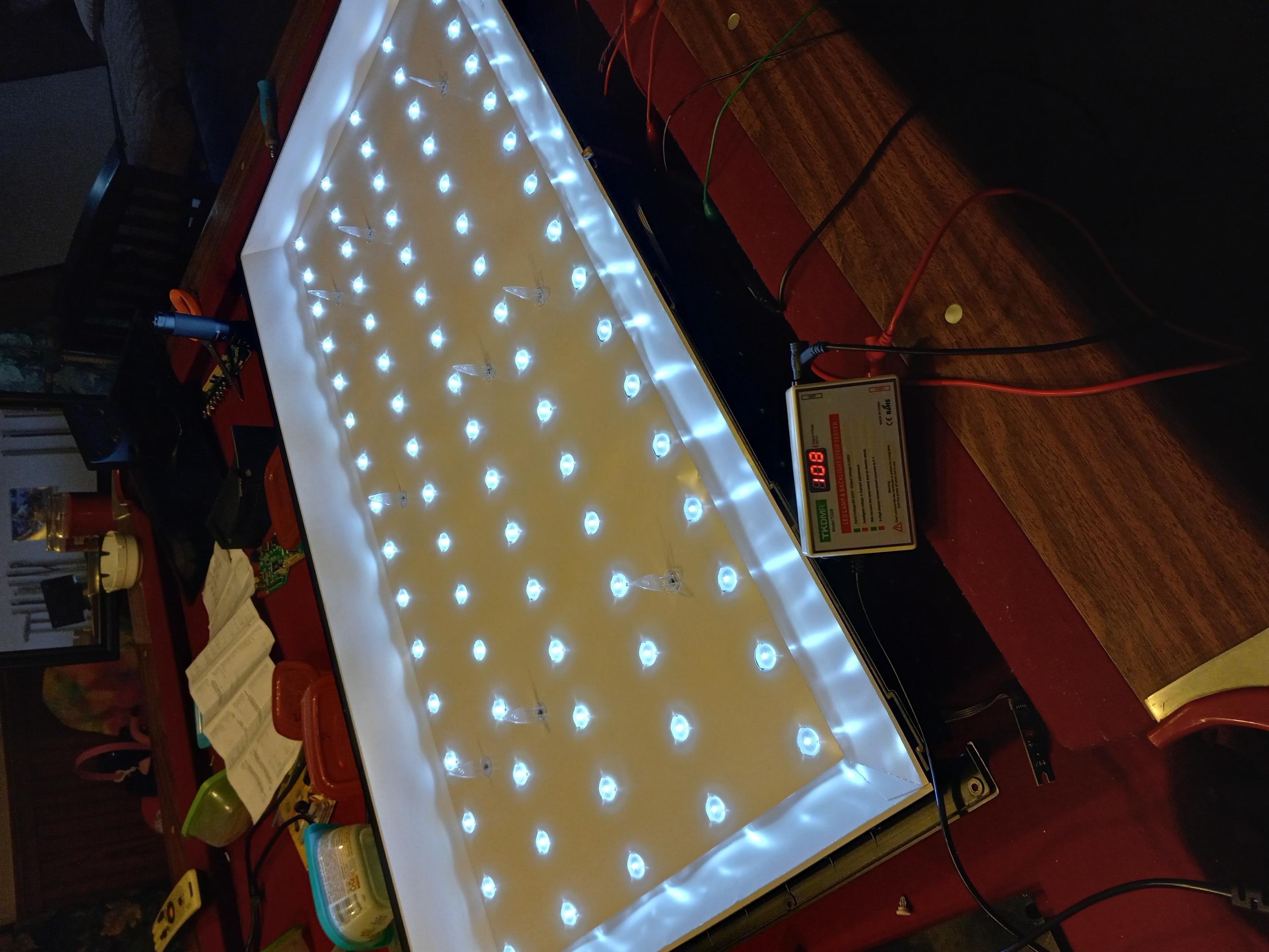

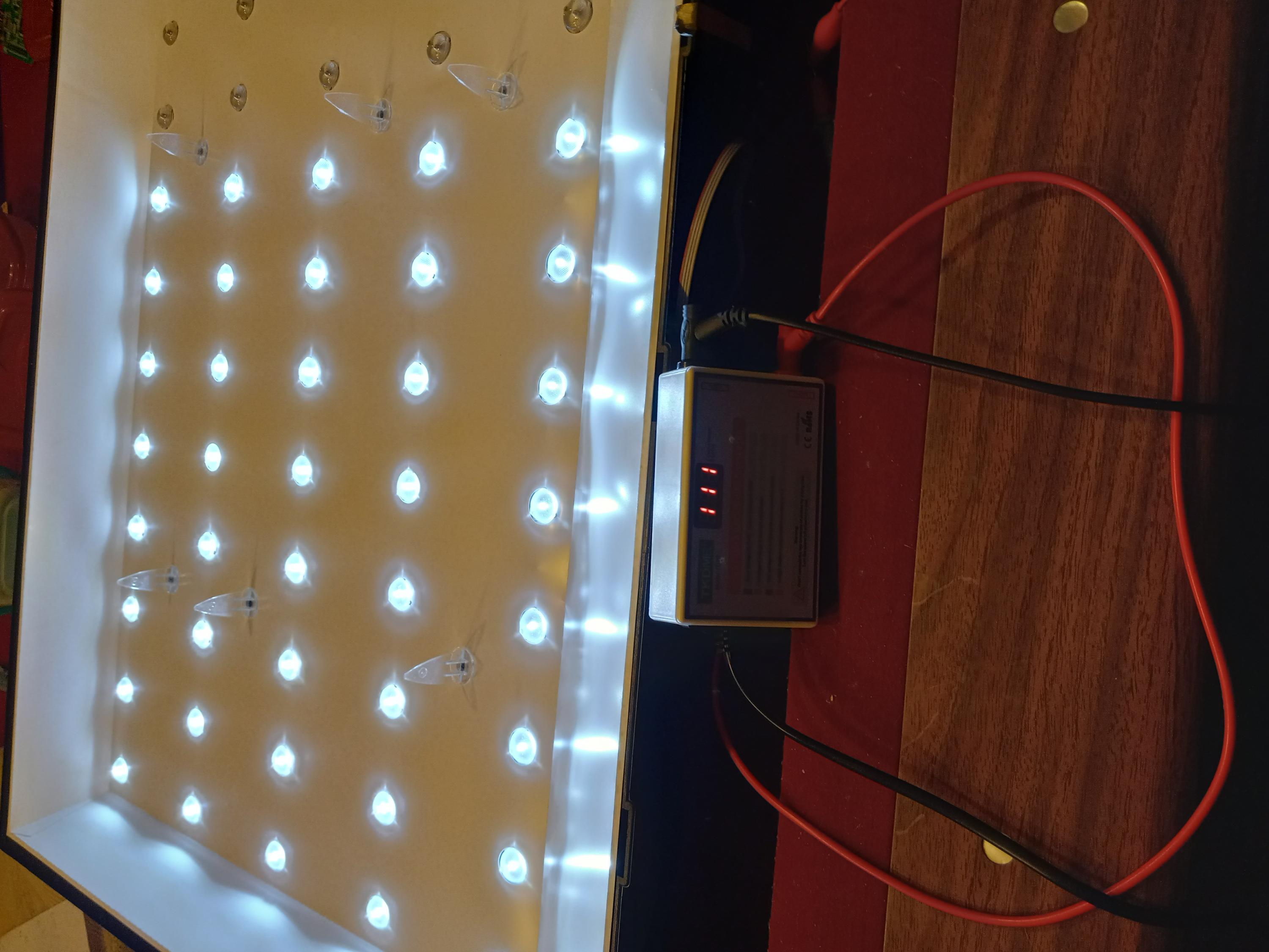

                      back lights
                        Make sure all the backlight connections are clean and not loose and have no resistance.
                        • tennno`
                          • Nov 2013
                          • 37
                          • usa
                          #32
                          all seems good

                                          #40
                                          Since you have the panel off, power up the led's with the TV's power supply and not if any led's are not the same brightness before it shuts down.
                                          The backlight tester only provides about 10~15 ma of current and also does not monitor the current like the power supply board does, I suspect a led is failing when provided with a higher operating current.
