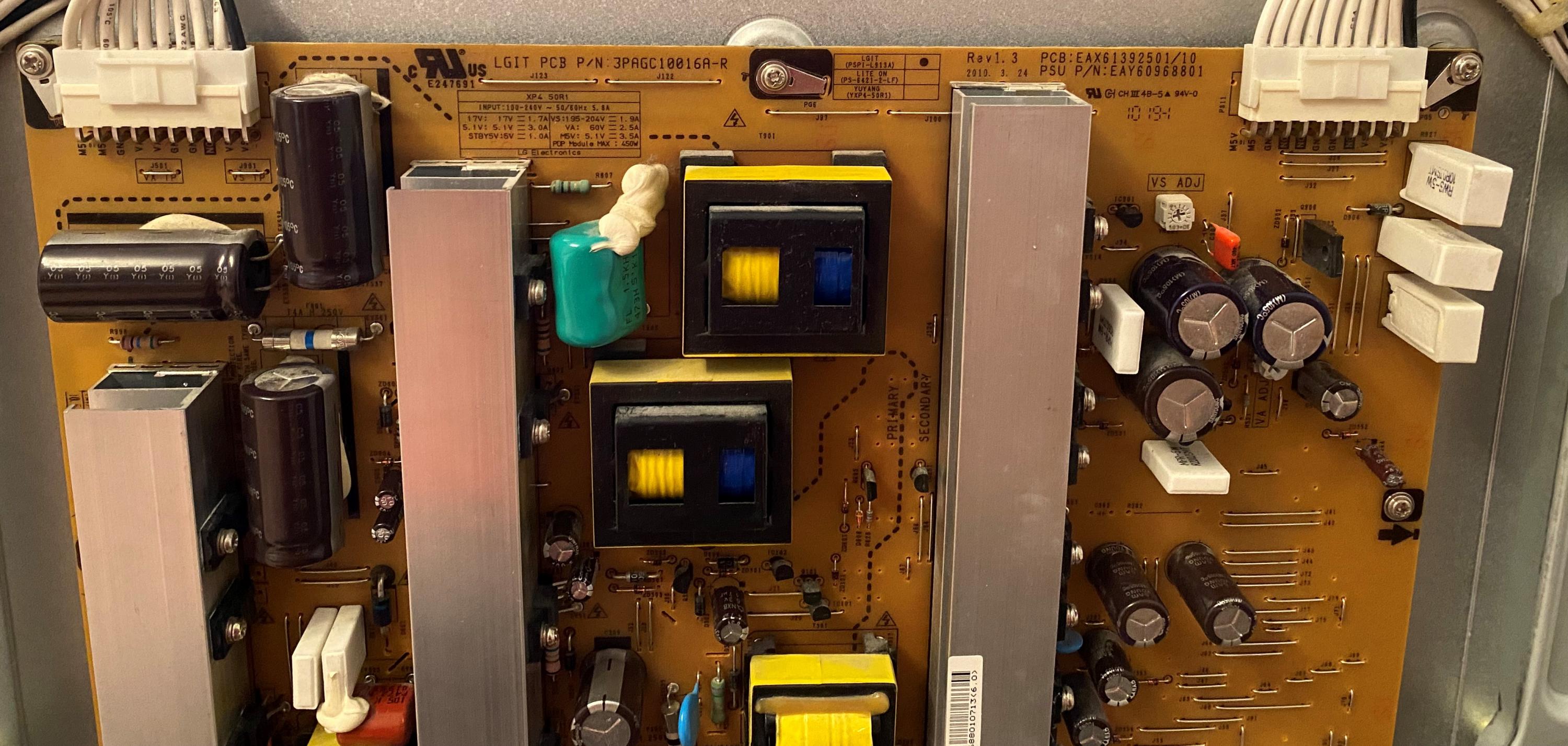

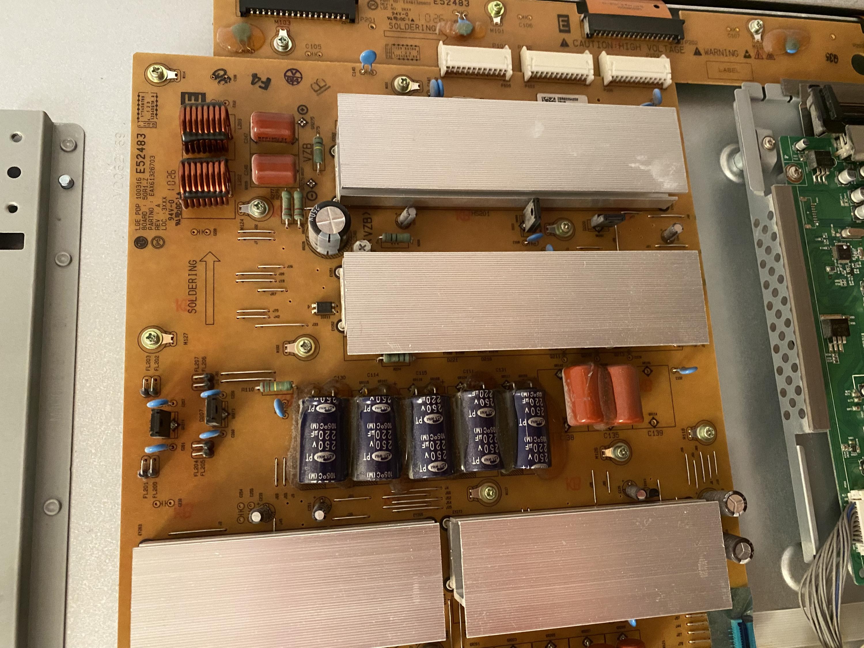

    Hi there,
    my old tv (~11,5 years) has a problem since 3 days.
    After 15 Minutens watching he is turning himself off - red light is on.
    When i try to turn him on - "click - clack" and going off immediately.
    After ~ 20 Mins i can turn him back on.
    on the Power Suppile Panal in the middle:
    I opend it, and i tested the three white resitors, all three 10,2 Ohm.
    The others are 0,2 Ohm.
    I tried to test the capacitors, but my device can only handle 99 yF.
    Is there any chance for me to save this?
    Best regards from Germany

    Re: LG 50PK950 - Turning off after 15 Minutes
    Need good pictures of boards and voltages from power supply.

              • Diah
                • Feb 2013
                • 6593
                Originally posted by Data45000
                Oky - atm the TV dont go on anyway - he is going back to standby immediately.
                I loved the real black
                you played with PCB as you wrote.. so it mean the PCB had crack solder joint point... inspect it all transformer points and resolder them.
                BTW its good chance to shoot photos and upload here
                • Unspun01
                  • Jun 2011
                  • 349
                  I agree with Diah:
                  If your large white ceramic resistors on the upper right corner of the power supply are not "open", then your problem is likely cracked or intermittent solder connections on the yellow jacket transformers.
                  Just repaired a LG 50PK250 that had your same problem - would turn on and work for a bit then turn off, or would click without turning on. The problem was identified under magnifying glass as bad solder connections to the large yellow-jacket transformers.
                  Re-touch with fresh leaded solder AND FLUX. You may want to also inspect all heat-sing mounted ICs like transistors or power management ICs, or bridge rectifier, etc.
                  Best of luck.

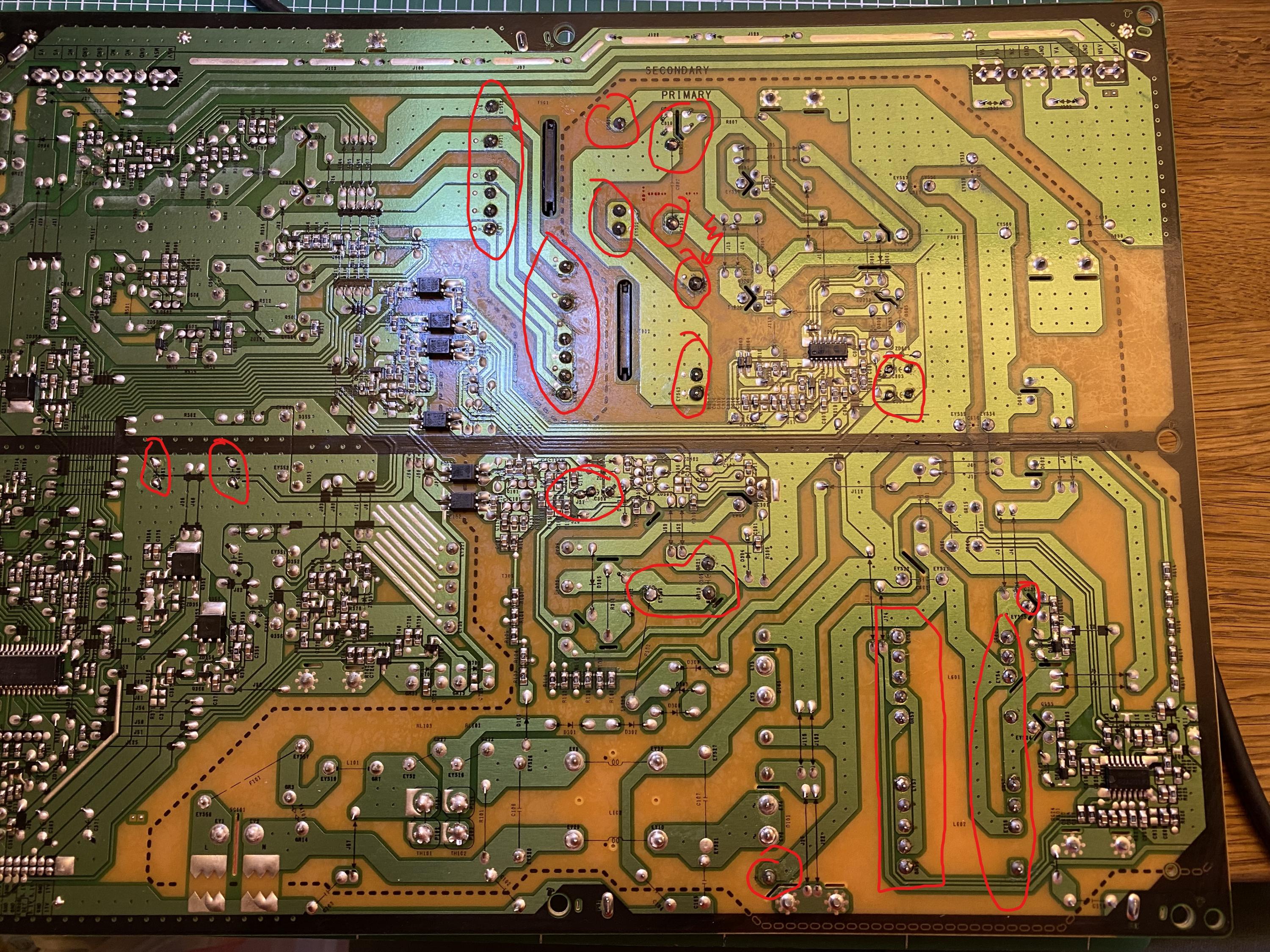

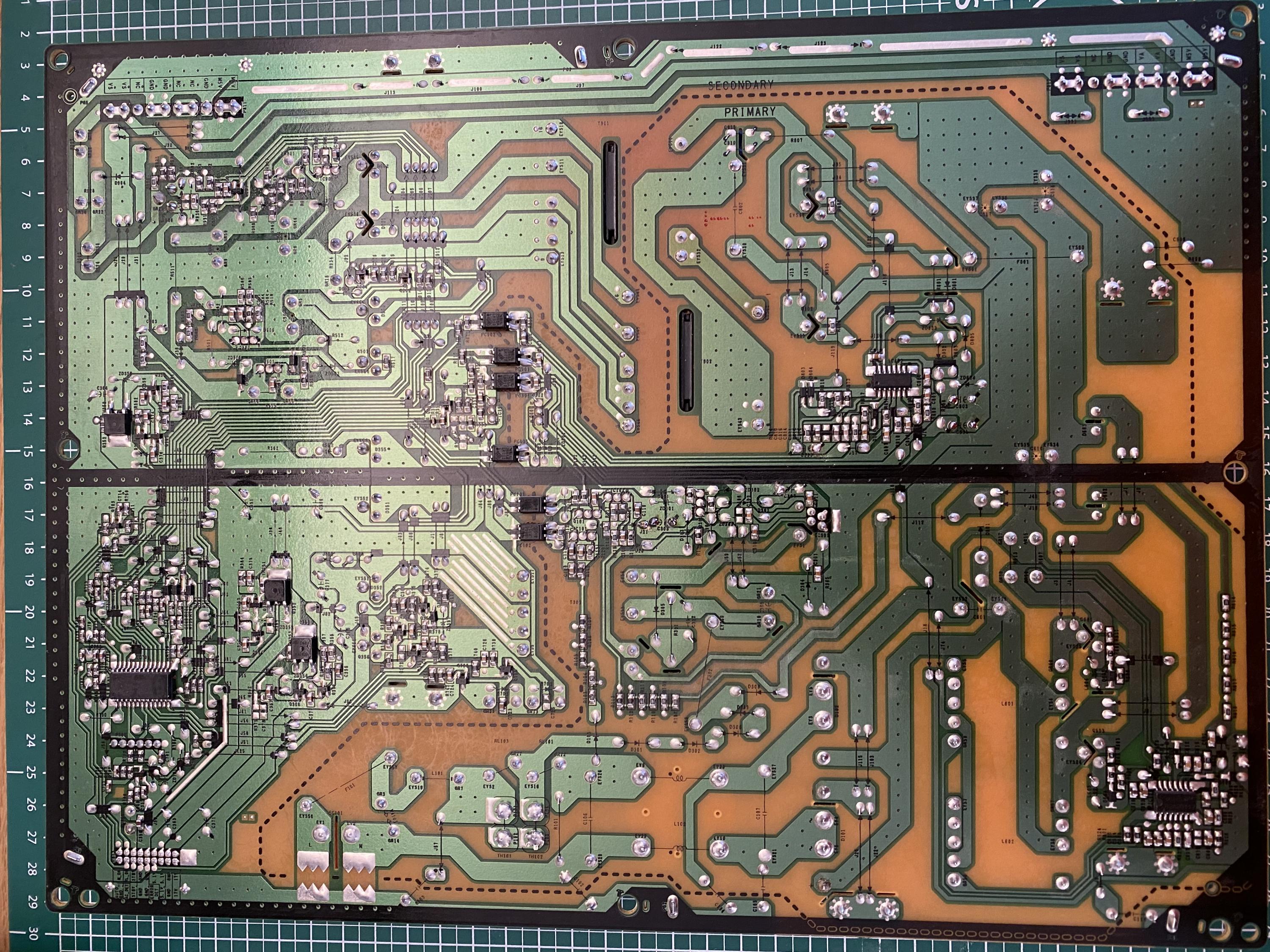

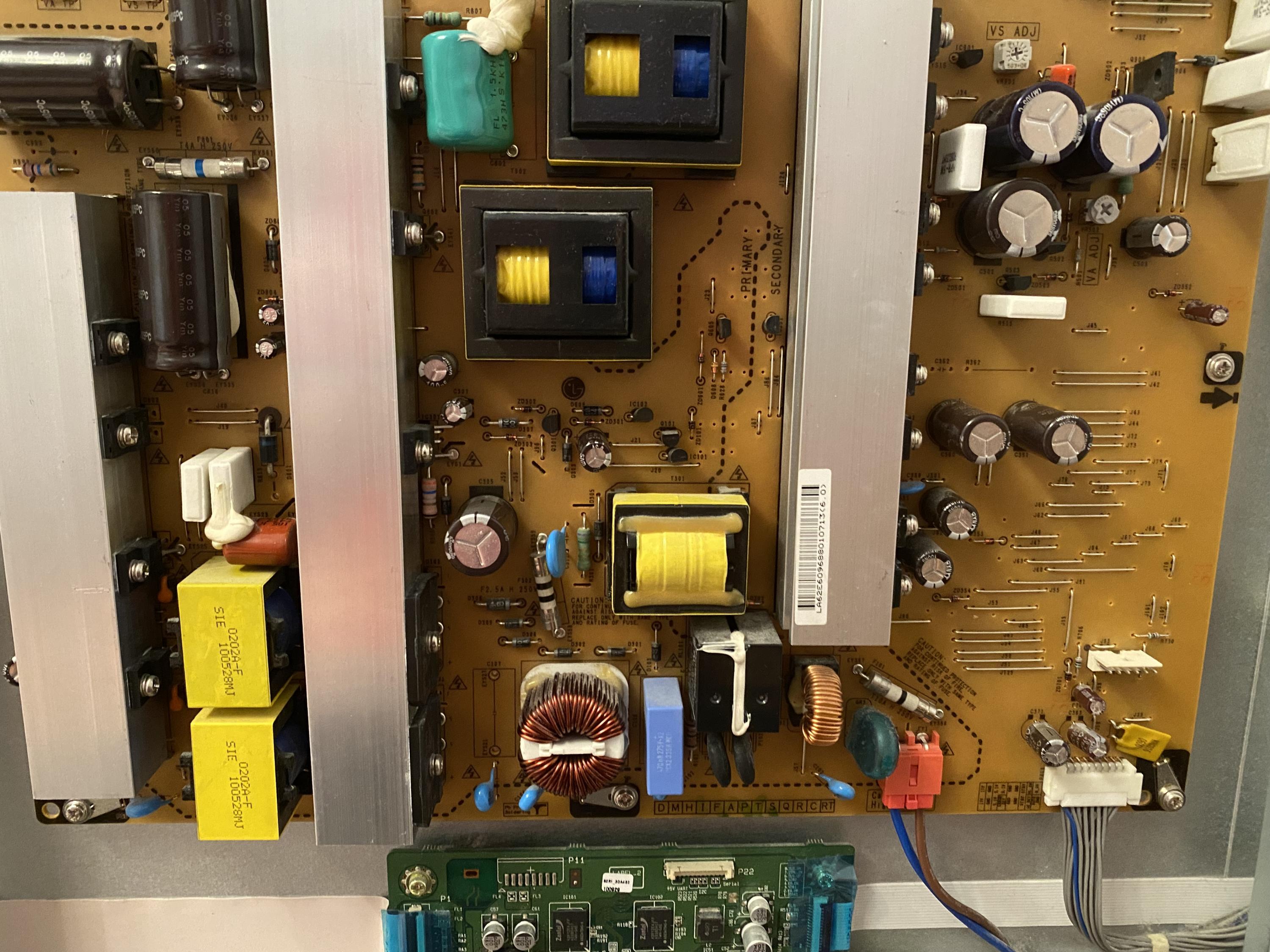

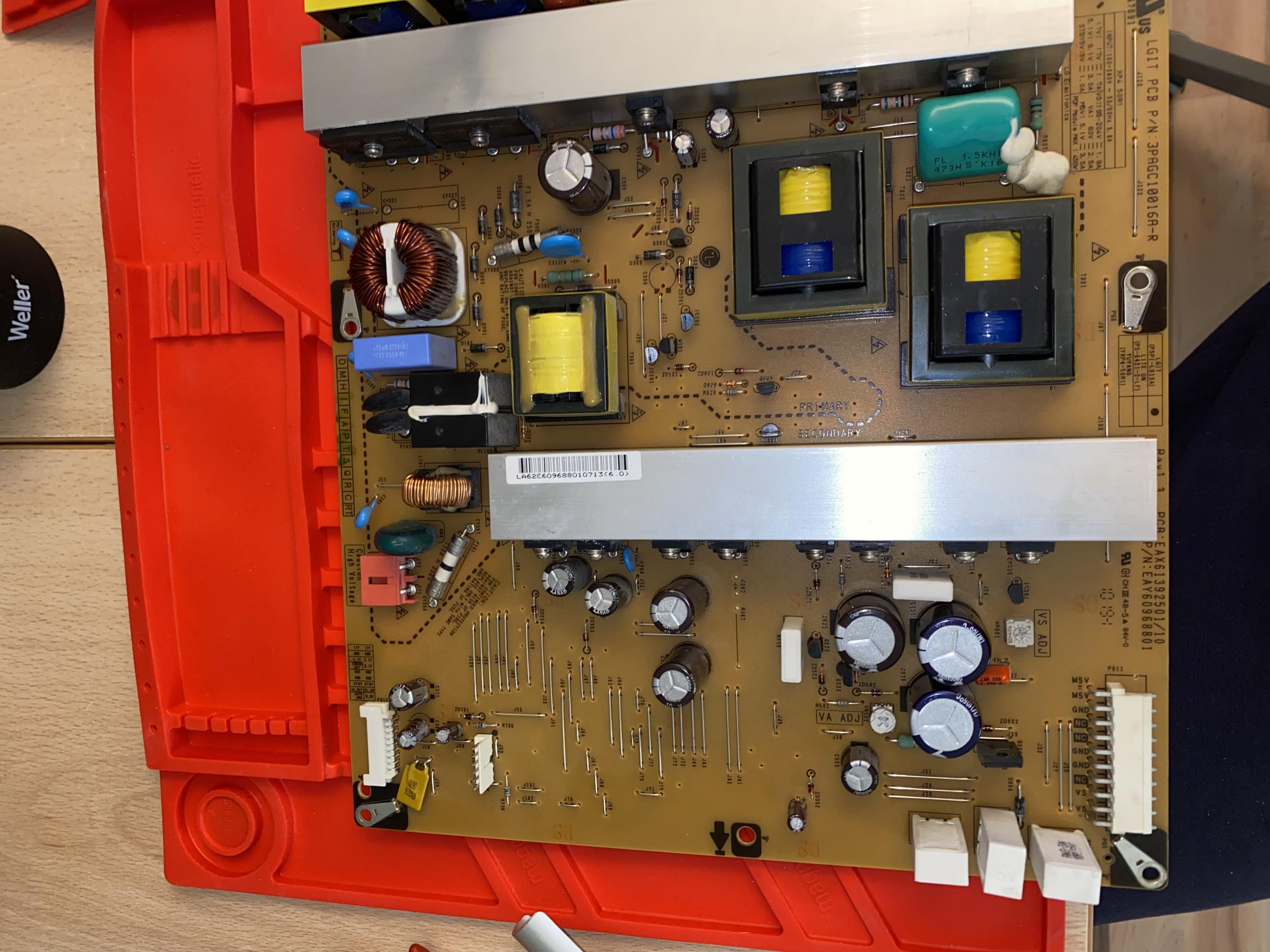

                  • Data45000
                    • Apr 2022
                    • 9
                    Hi there, thank you for the tipps, I will test it.
                    Here are the pictures Maybe you see something i did not see.
                    • Unspun01
                      • Jun 2011
                      • 349
                      The last photo of the bottom side of the power supply definitely shows bad solder connections on the large transformers T901 and T902. For sure the upper rightmost pin on each transformer needs to be resoldered. Resolder all pins to be sure. USE FLUX. And I'm talking about the large blue/yellow transformers in upper center of power supply board.
                      You should also inspect and resolder any ICs or mosfets or diodes mounted to the large heat sinks since they might need attention.
                      For now I would focus on the visibly bad joints of the transformers
                      • Data45000
                        • Apr 2022
                        • 9
                        you are right, the one is broken. That makes sense, when it is getting hotter, the distance will grow.
                        I made the a lot of the solder points new.
                        Going for a test now.
                        Edit: 40 Minutes now, and he is running - i close the case now and test it again.
                        • Data45000
                          • Apr 2022
                          • 9
                          2nd Test over 1 hour and the TV is running without any problems!
                          I will test it the next week, but I think the Problem is solved
                          Thanks guys.
