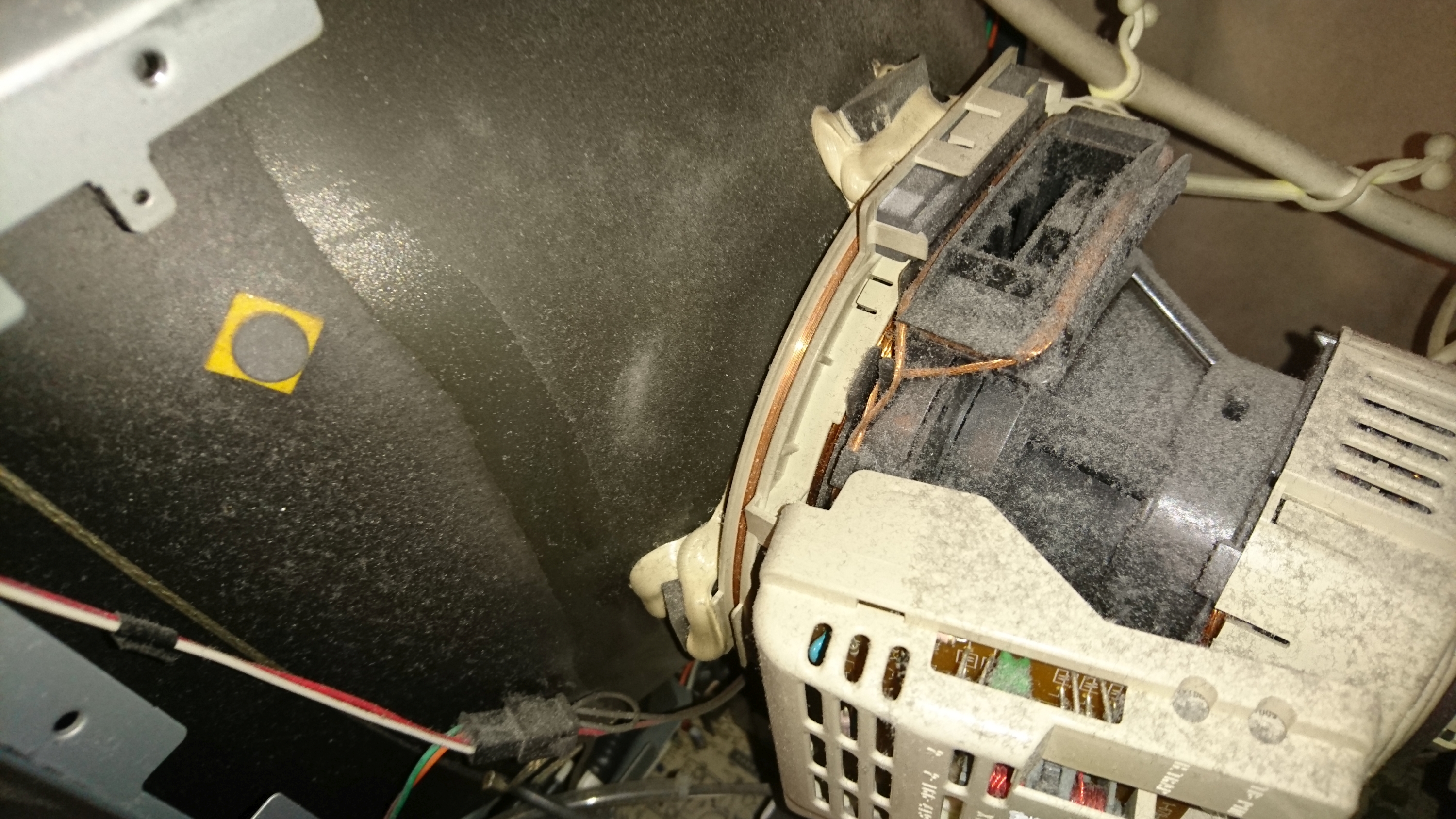

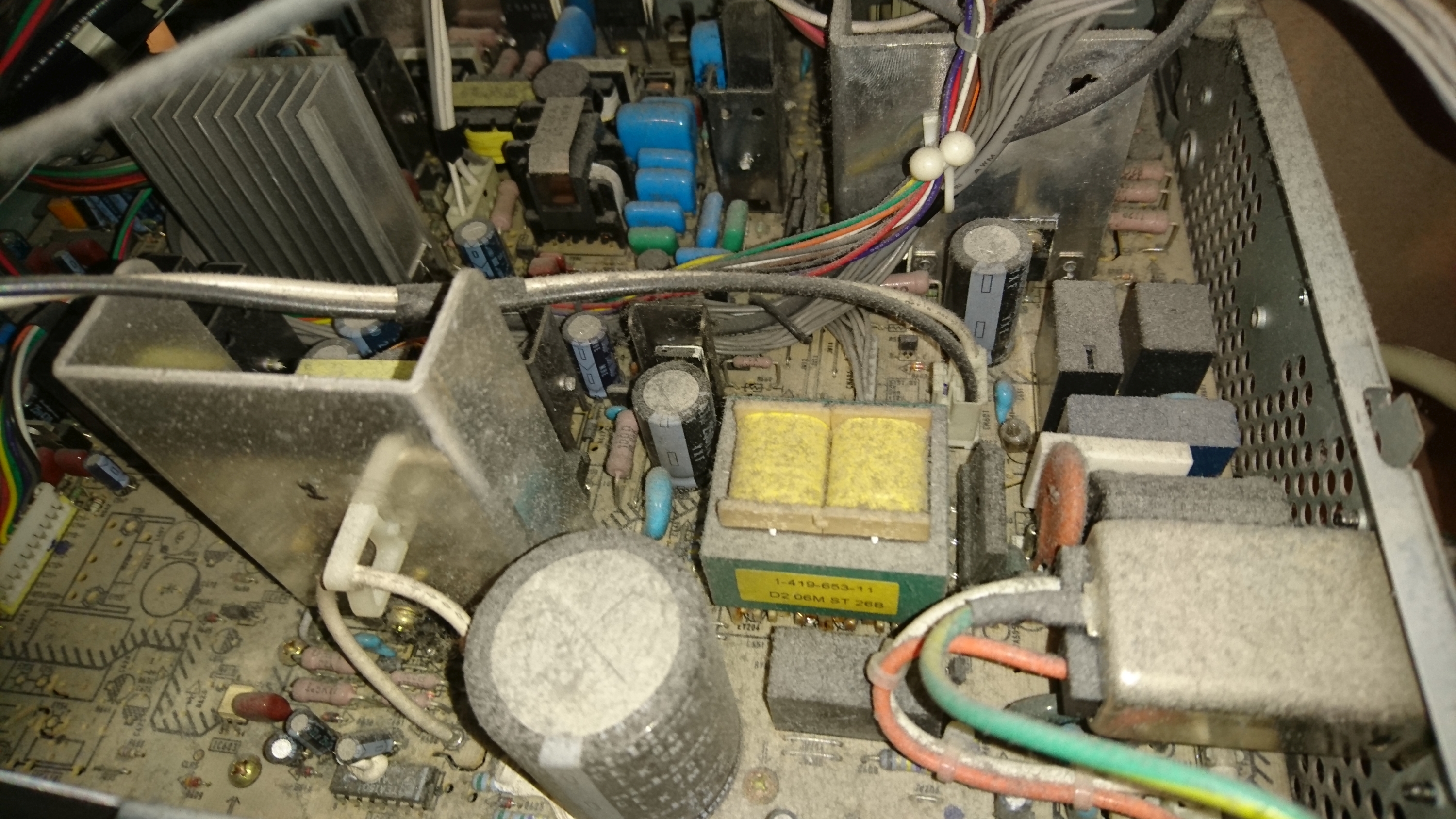

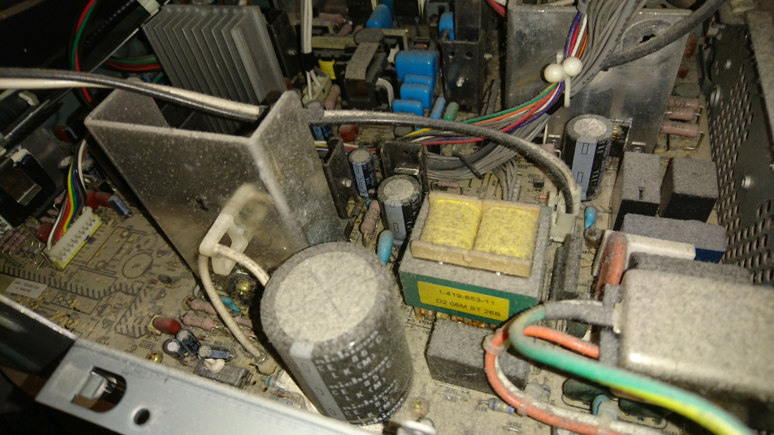

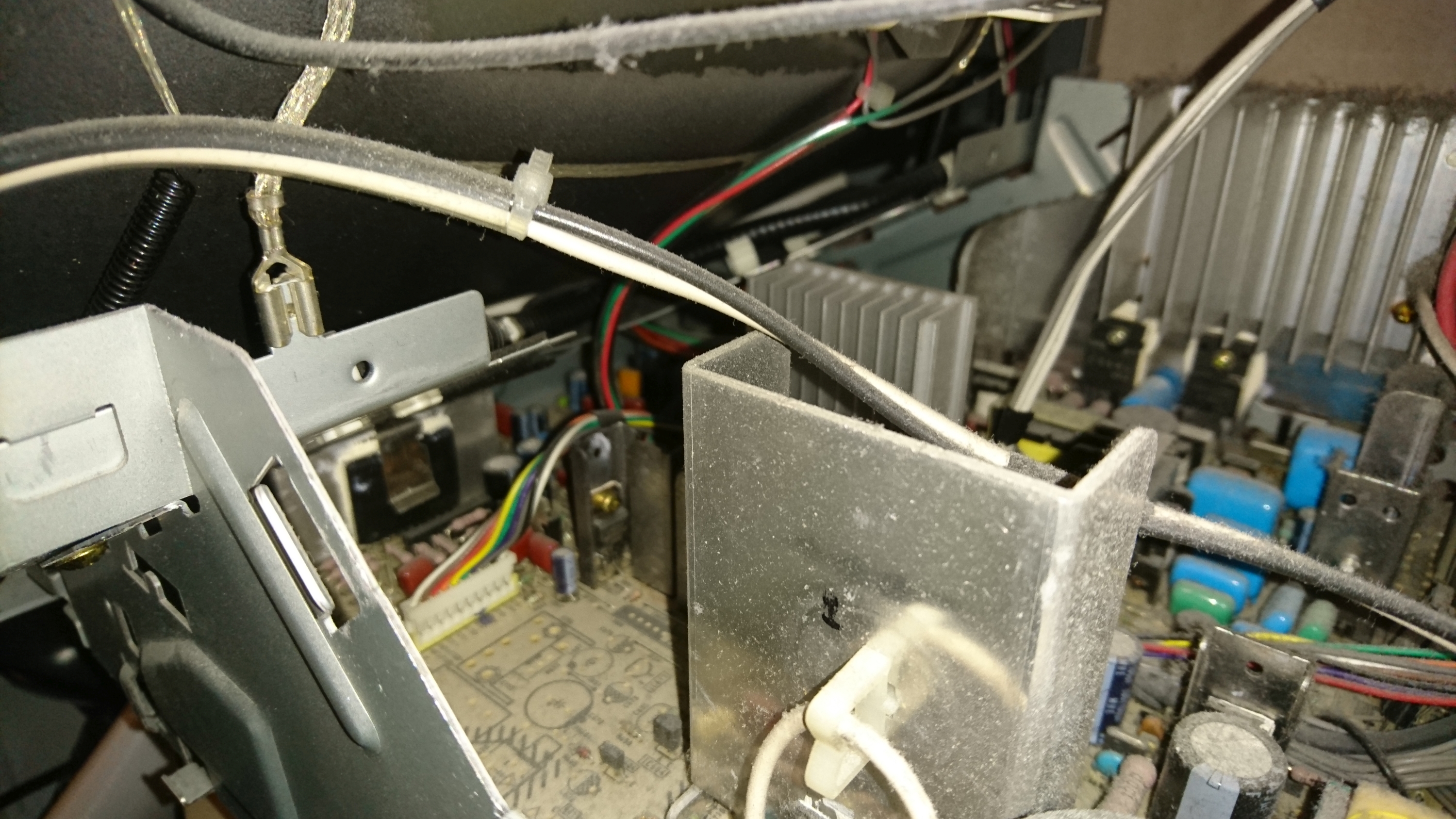

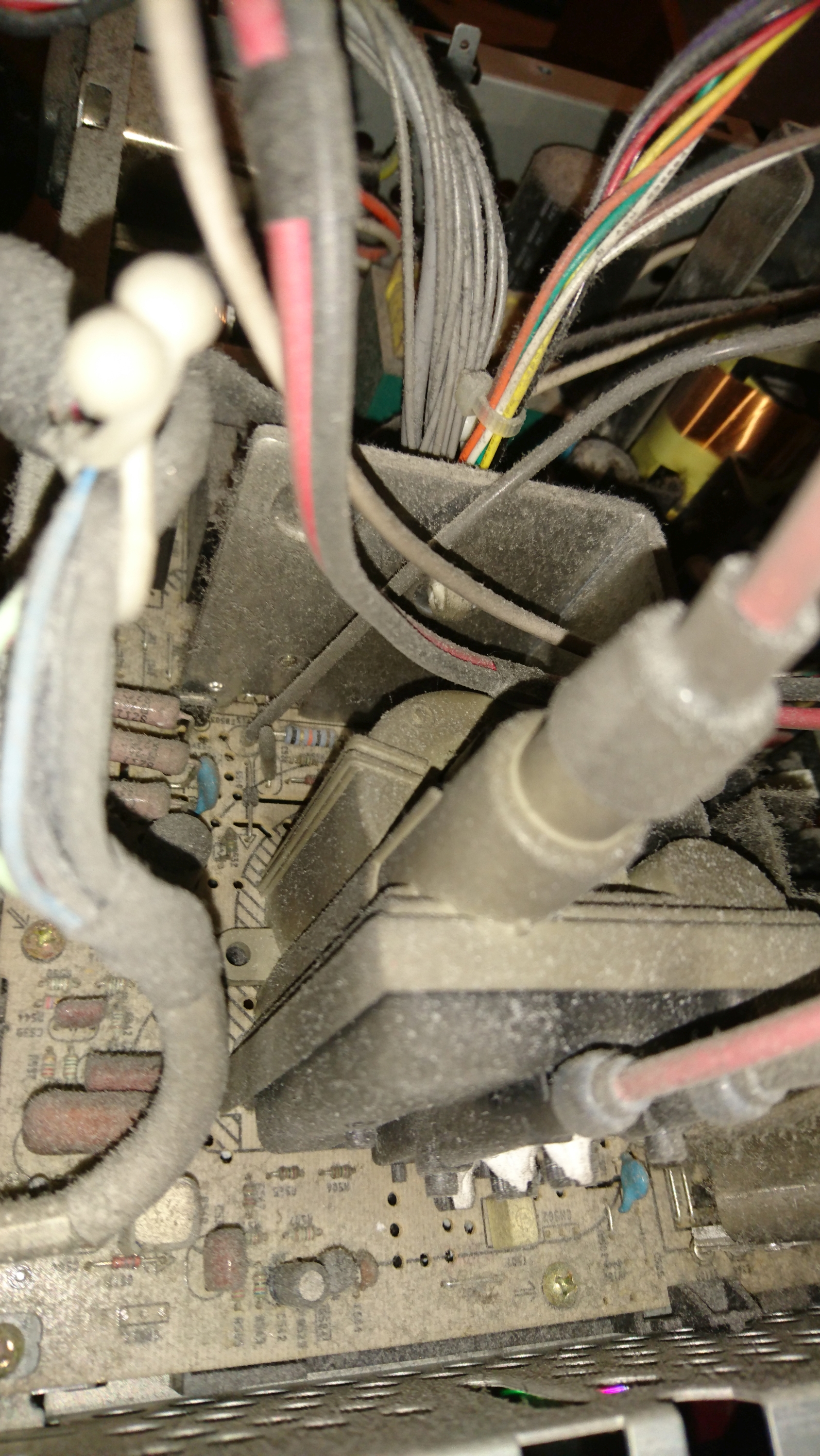

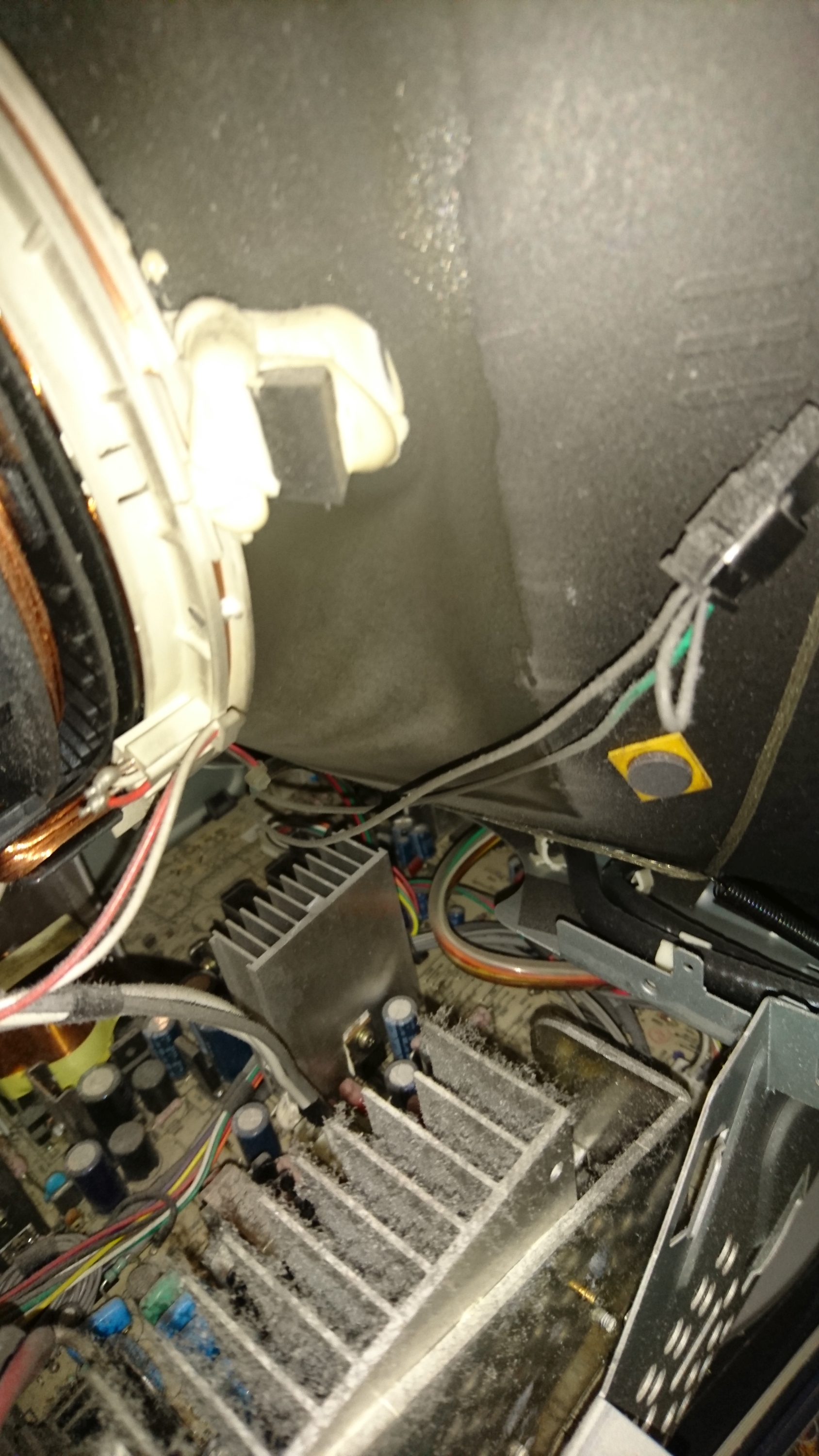

                                    Here's some pics of the (terribly dusty) inside of the E450 that I had forgotten to attach before; note the significant unpopulated area on the board and magnets attached on the tube; I wonder if that's from the factory, have not seen that on any other monitor before. And yeah, getting the chassis out and going over it with compressed air would probably be a good idea as well.

                                      It is dusty but I have seen them a lot worse than that. The magnets are there from the factory to improve purity, there position and orientation are important, leave them alone.
                                      The circuit boards are manufactured for different models so all the areas are not populated.
