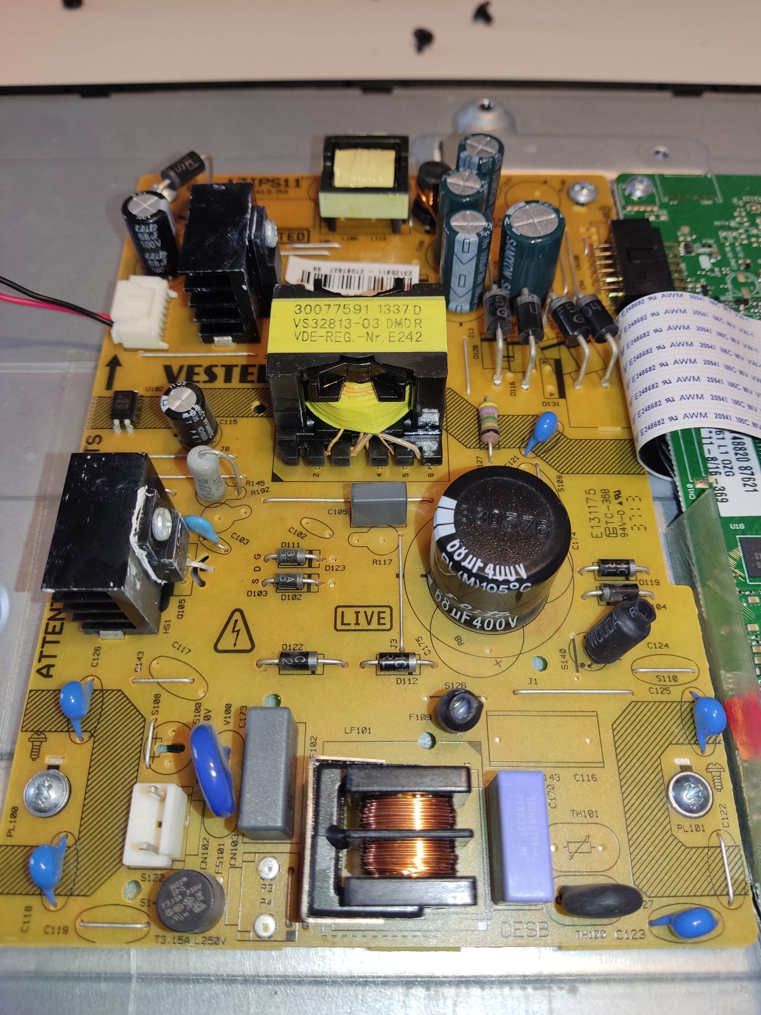

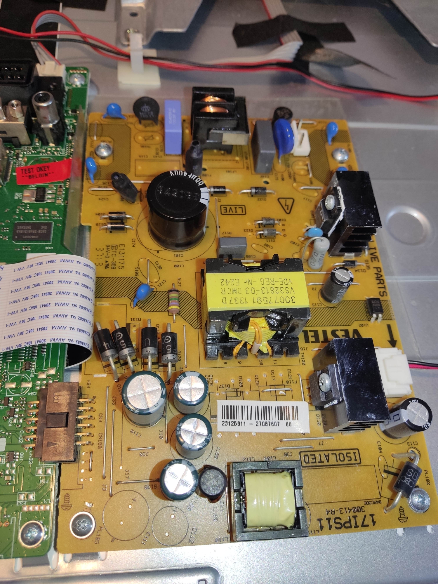

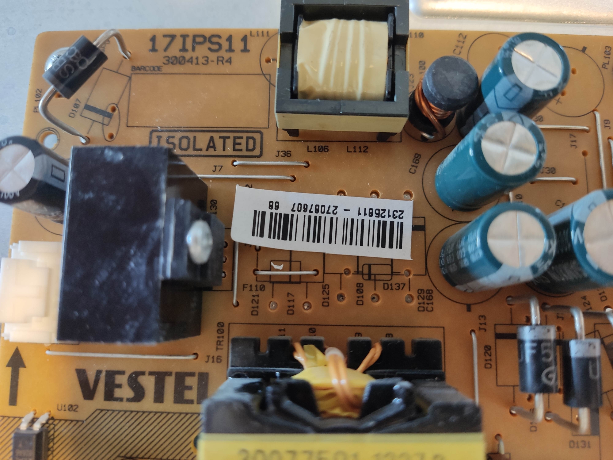

      Re: Blinking stby led on a TD systems TV with 17IPS11 PS
      Vestel mainboard issue I would say. I suggest you put clear pictures of your main board and psu for other people to help you. The fact you haven't will just delay you resolving your issues with it.
      Normally any Vestel set with flashing standby led is a firmware issue on the main board. The fact that you don't get any significant output for the led connector suggests your mainboard has firmware issues which isn't turning on the led driver circuit.
        You could be right but why does +5v_STBY not provide +5v? Even while PS is unplugged from main? I will try to open it up again today and take pictures.

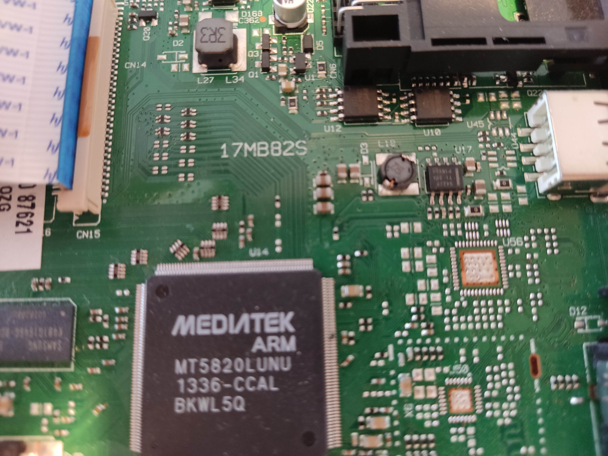

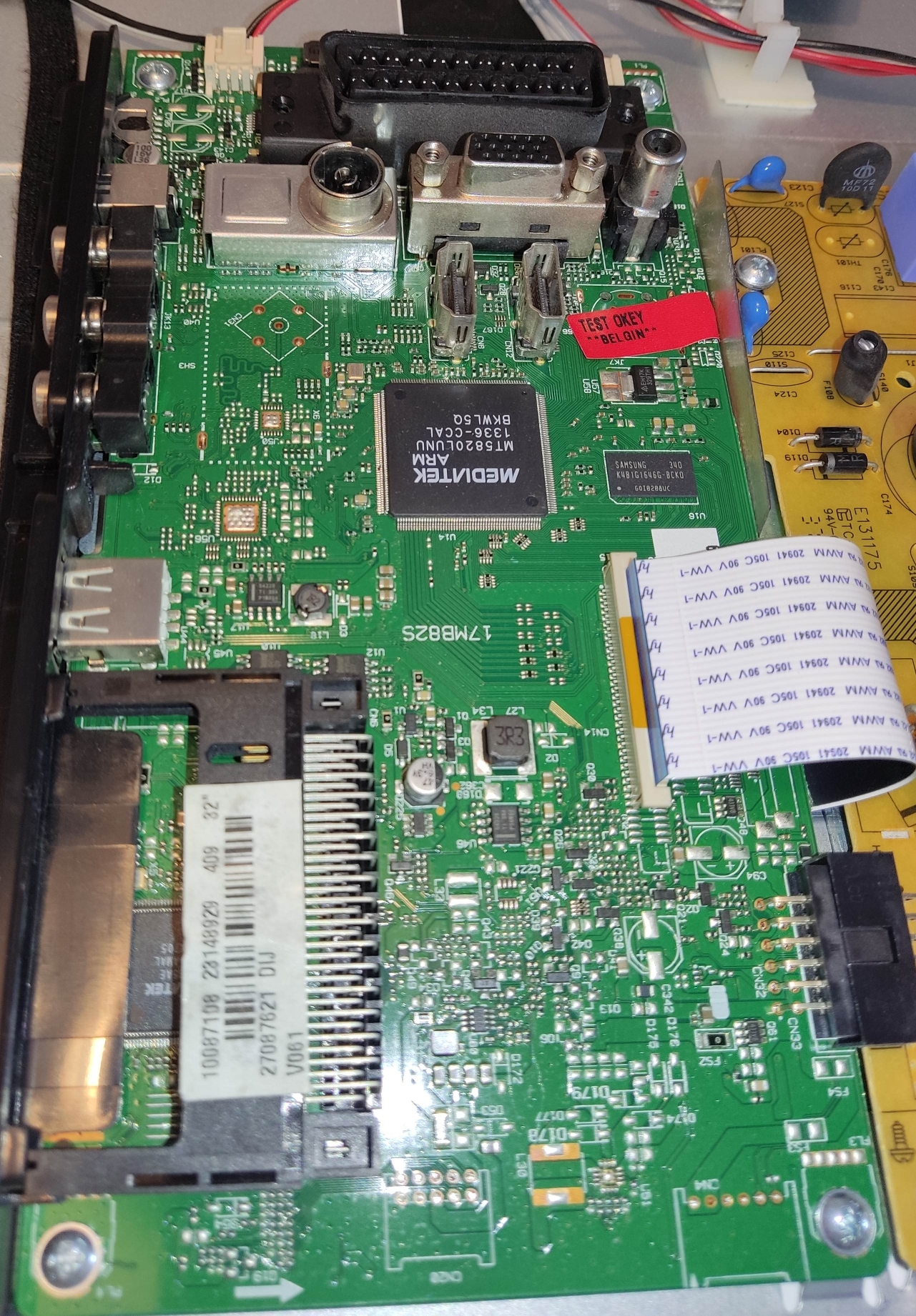

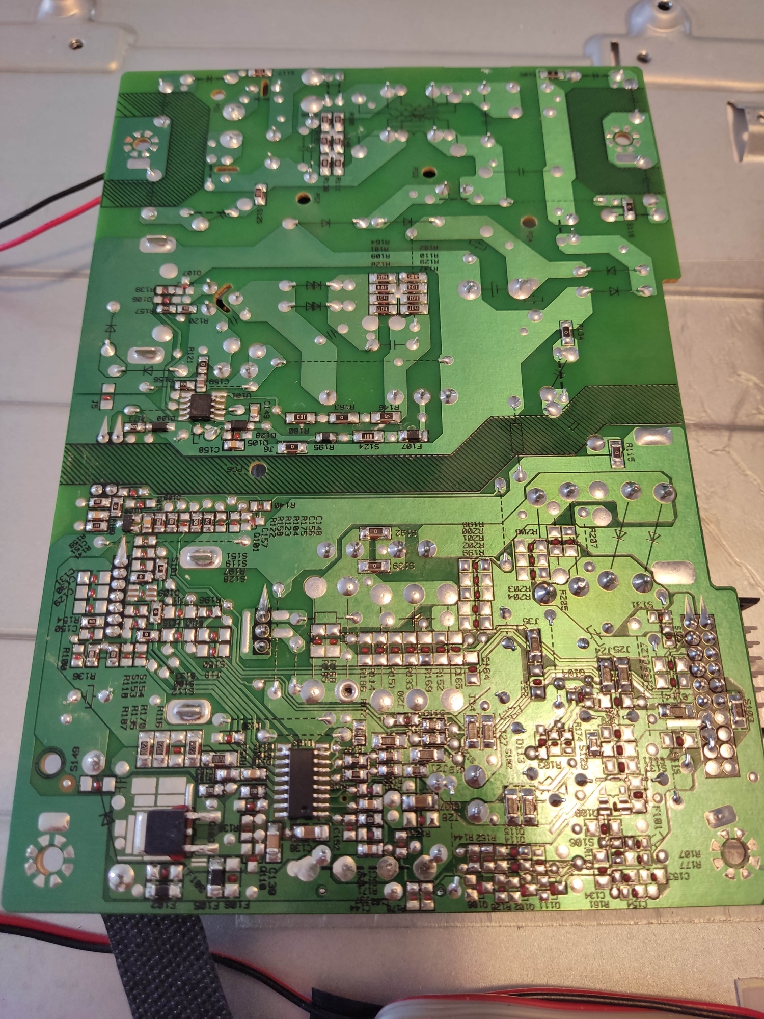

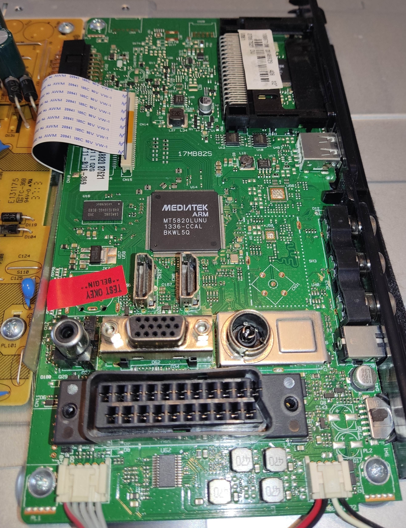

          Ok I took all the pictures.
          Main from both angles
          PS from both angles and bottom side
          Labels, etc
          What I noticed now I opened it up again, is that not all Vestel 17IPS11 PS are the same, as I was looking for the zener+ transistor responsible of generating the +5_STBY voltage from the +12v line, and it was missing. Along with dozens of other parts showing in the schematic that are not there either. So I guess this TV set doesn't generate/use the +5v voltage and that's why it's absent in the PS->Main connector. Maybe it's generated (if needed) inside the main board
          Ok, these are the pictures, is there any simple way I can determine if this is a firmware issue? When we're talking about firmware corruption..is this something that can be fixed with a USB drive +.bin file ? Or do I need to remove a memory IC and flash it outside? (more scary for me)
          Thanks a lot!
            Thanks a lot!
            you see.. when you uploaded photo we discovered yours MB82S not as you wrote before.. look at this threat and download the files i put. use the NVM clean first.
                  Ok looks very easy to try if that's the case. I also found a video from a guy who freezes the flash chips before he flashes it and somehow the set boots up temporarily. Weird!!!!
                  Will try tonight. Thanks!!

                    #29
                    Ok, I just tried this. No luck
                    Used both files (one at a time, renamed to upgrade_loader.pkg, only this file in FAT32 formatted pen drive). Plugged off, inserted pen drive, plugged back in while holding OK button on the remote. Nothing happened, stby led solid red, flash drive not being lit.
                    Pushed "power" button behind the set while holding OK in the remote, and blink started but no flashing happened. Internal activity inside flash drive showed no read activiy, but flash drive was powered (solid light inside). It's like it didn't like this file or filename?
                    Tried other pkg, and also another from from another forum., No luck
                    What Could I test next?

                      #30
                      use different usb pen. old one no more 2gb fat32. and don't do any experiment by your self. just do as i wrote at other threat how to flash no more or less... if this didn't help then you have other issue.. shorted BL could be or other issue at MB.
                      BTW why you worte you renamed... no rename need as the end file after extrack are .pkg... if your pc didnt show the file extention.. mean now the file after your rename become at end .pkg.pkg

                        #31
                        No no, renaming was because I unzipped both files in my desktop and as they had the same name I had to rename them to avoid overwritting, but in the flash drive I made sure they have the original name. I always have "show extension for unknown file names" activated on my computer so the extension is not duplicated
                        Ok I don't have an old flash drive around but I will check, thanks
                        EDIT-> Used a different flash drive (older), and it WORKED!

                          #32
                          Ok it worked. Found an older flash drive, put the FOR_CLEAR_NVM file, and it flahsed right. Now it turns on and seem to work fine.
