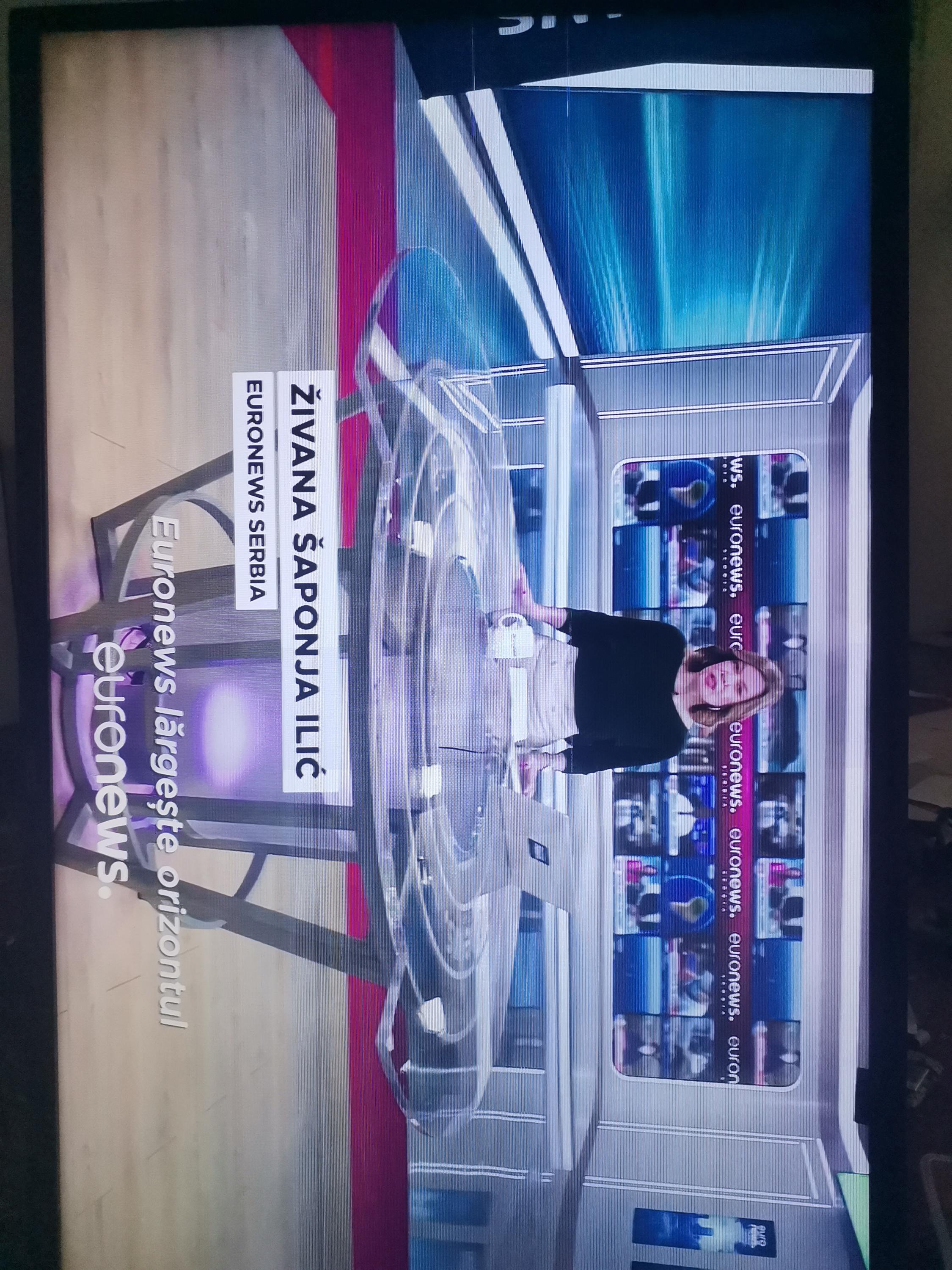

      Re: Toshiba (Vestel) 50UL2063DB - bad COF?
      I have the same issue with the same panel and so far I was able to partially solve it by isolating some pins in the right hand side Tcon ribbon. Pressed and wiggled all the tabs with absolutely no change, it is a shorted line in a COF or on glass, nothing to do with tab bonding.
      TV went from NO picture with backlights and sound to half a picture, either left side good or right side very distorted but completely unable to show a full screen, to full picture, slightly distorted with bouncing shadows and horizontal lines of varying shade on the top 2/3 of the screen, from the shorted line above. The bottom 1/3 s has completely cleared up with full 4k definition.
      Got more messing about to do but I am confident I will be able to get a 99.9% good picture out of it. I bought it from a neighboring city for $80. I think not a bad deal especially since it is still on offer in local stores for about $300 new.
