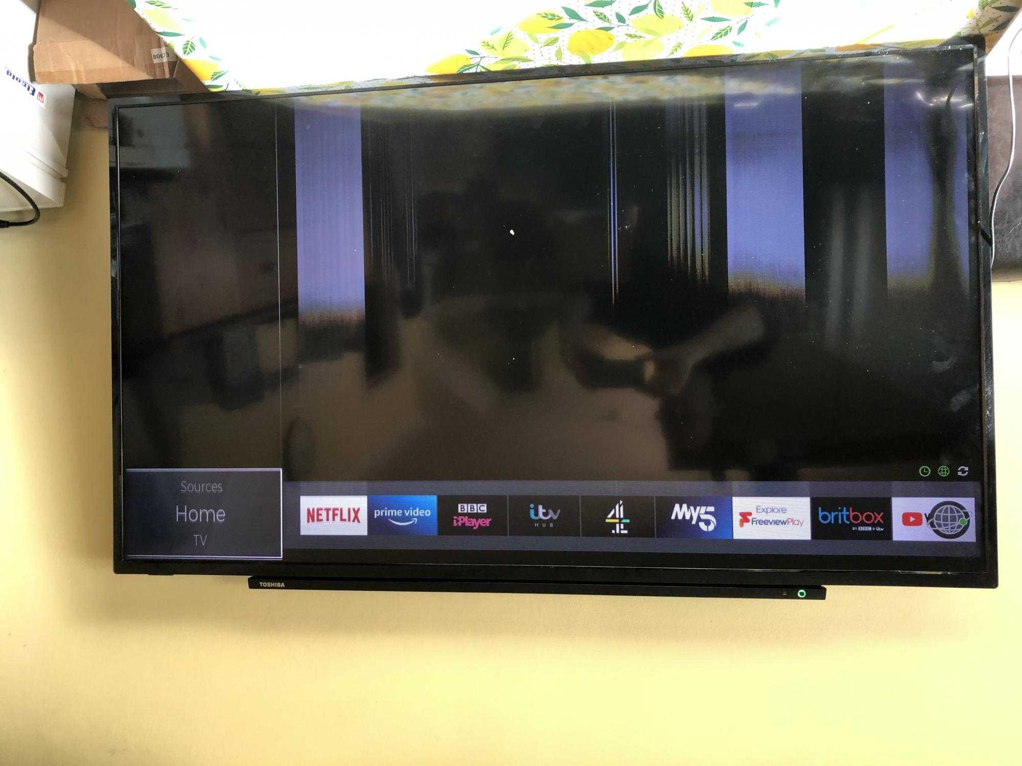

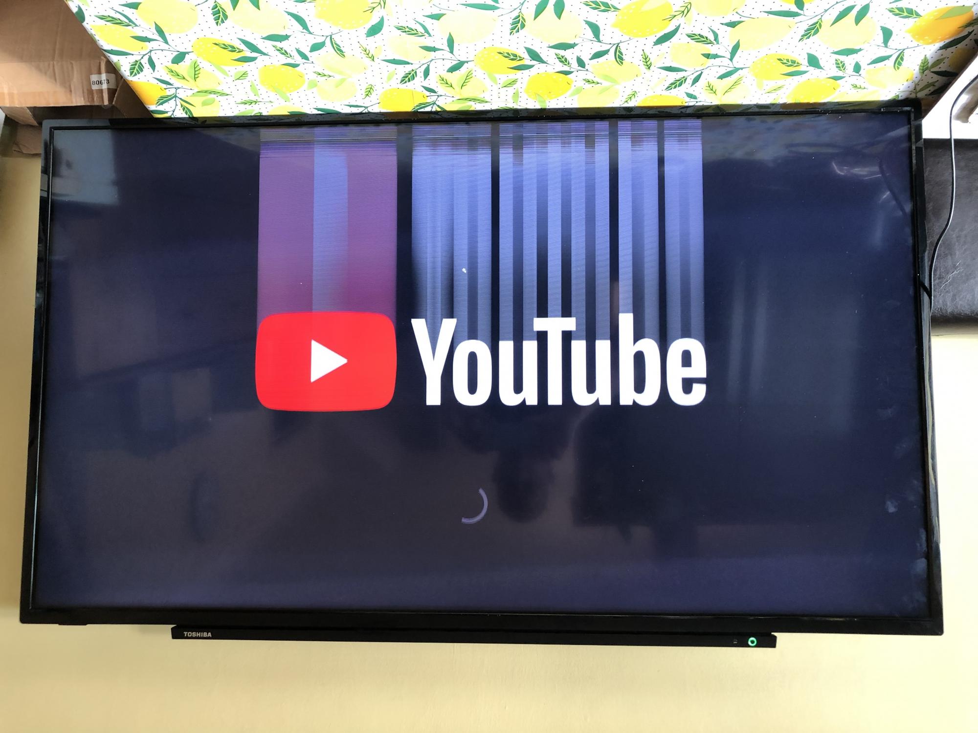

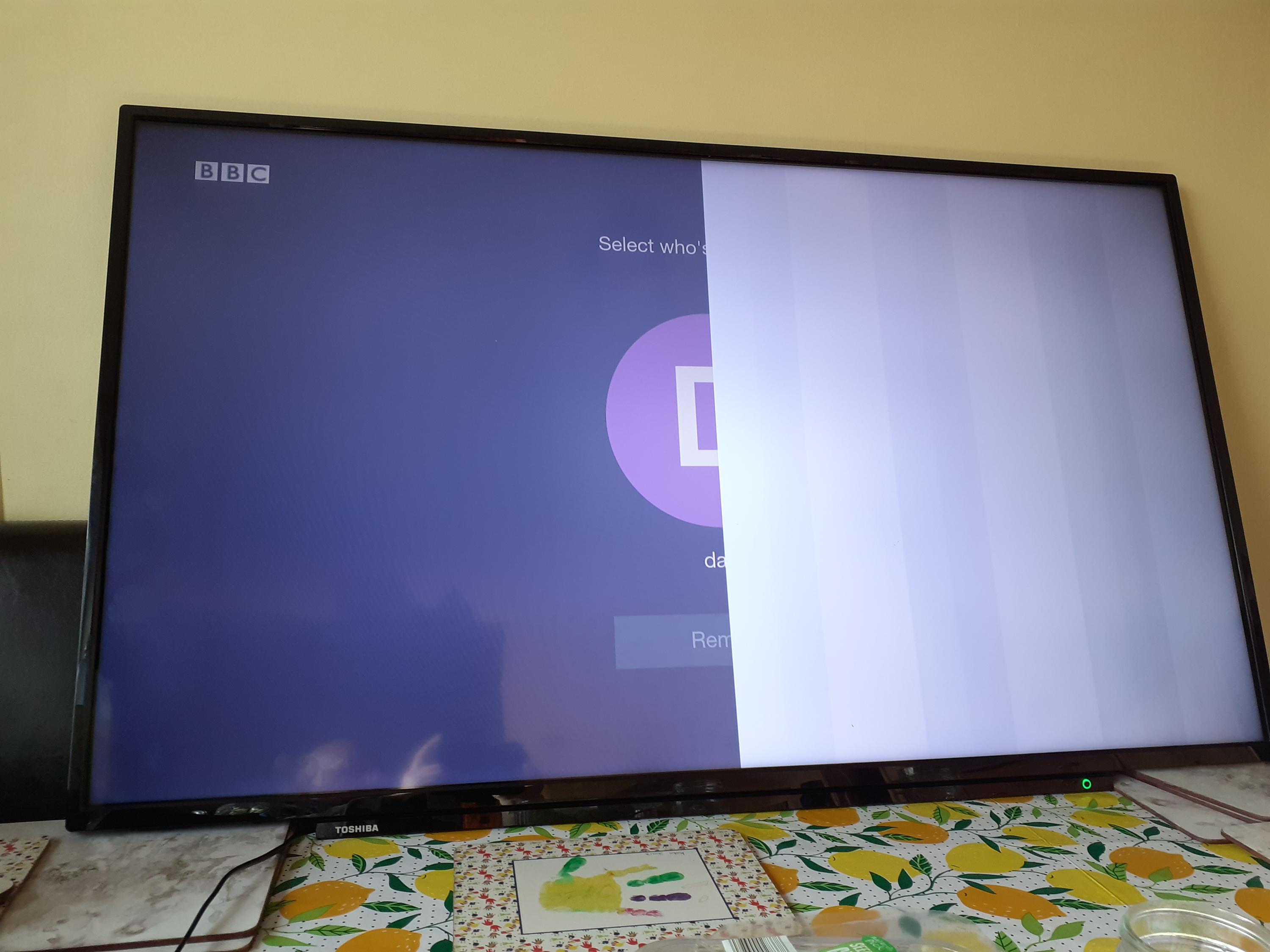

    I have a Toshiba 50UL2063DB.
    Most times , screen shows no image, but backlight is on.
    Voltages:
    Vcc = 3.3v
    Vcom, Havdd, Avdd, Vgh & Vgl ate all 0v
    If the right side t-con ribbon is disconnected I can see an image on the left , and get the following voltages on the screen PCB for the left (right side of screen has grey and white bars as there is no ribbon connection):
    Vcc 3.3 = 3.28v
    Vcom = 7v
    Havdd = 7.47v
    Avdd = 16v
    Vgh = 24.7v
    Vgh = -6.9v
    If the left side t-con ribbon is disconnected I see scrambled data on the right and grey and white bars on the left as there is no ribbon connection and I get the following voltages on the screen PCB for the right side:
    Vcc 3.3v = 3.28v
    Vcom = 7v
    Havdd = 7.48v
    Avdd = 15.72v
    Vgh = 24.7v
    Vgl = -6.07v (this is the only voltage which is significantly different compared to above readings)
    Sometimes I do get a picture with both ribbons connected but it has motion artefacts.

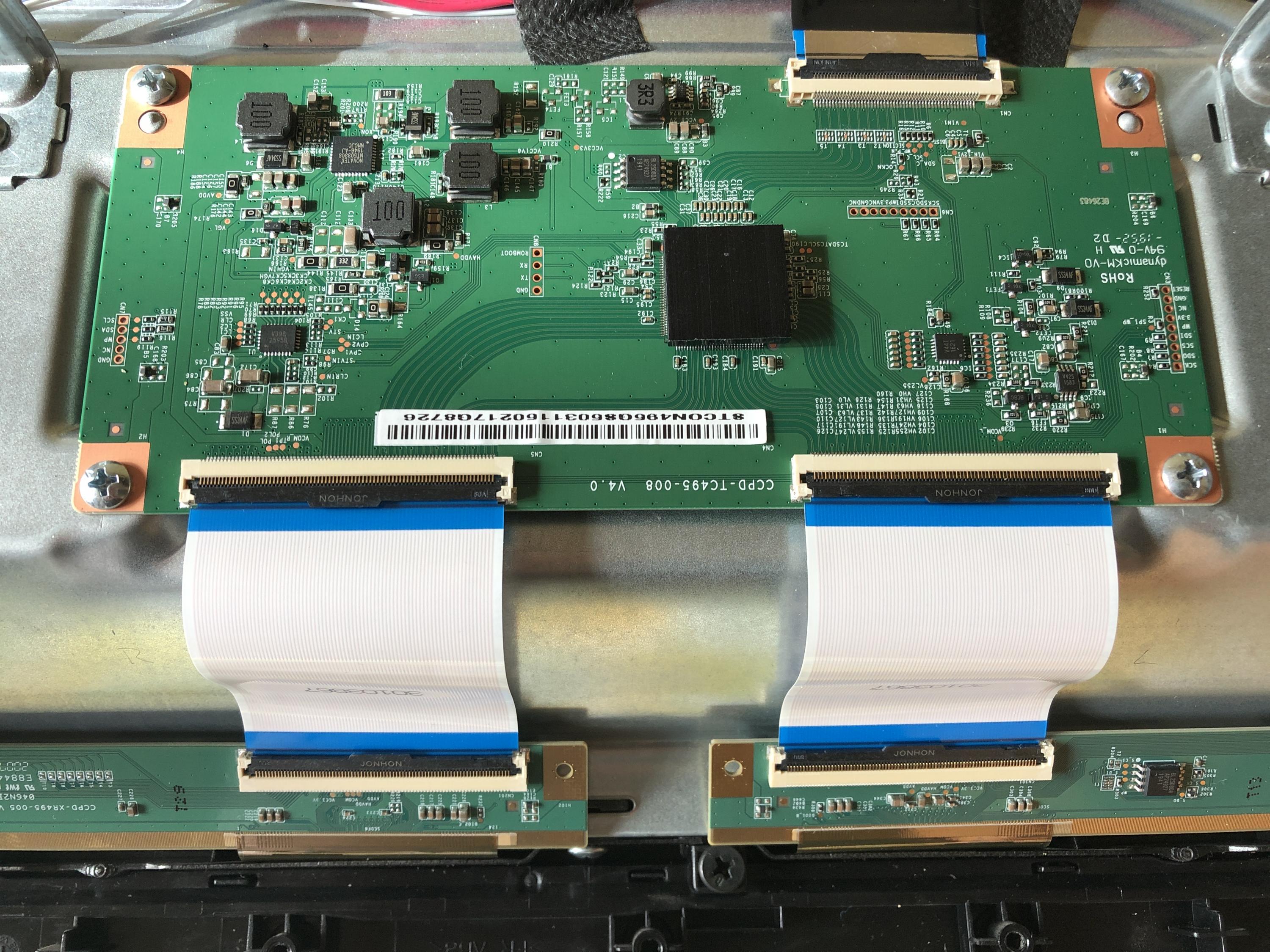

    I have replaced the t-con board from a salved tv (identical PCB part number and tv model number) bought from an auction site, and voltages above are from after I replaced the t-con, and the symptoms are the same, so unlikely a t-con issue.
    I have been tempted to remove the COF tabs on the right side of the screen (although I haven't actually disassembled the screen yet, so I am assuming it has COF tabs).
    Before I do this, is there anything also I could do to confirm that this diagnosis is correct, as it is obviously a one way action.
    Regards
    Russ

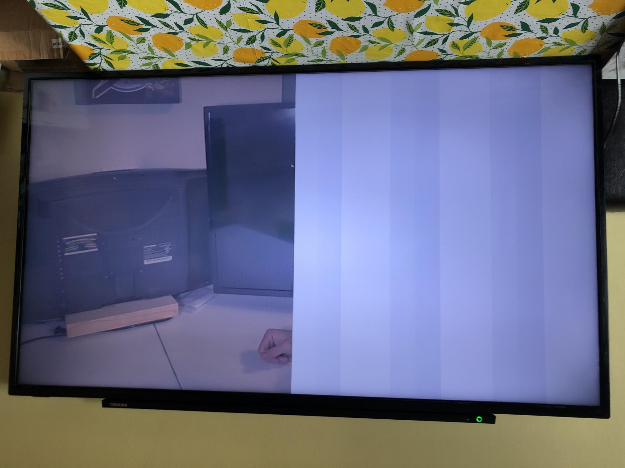

      Re: Toshiba (Vestel) 50UL2063DB - bad COF?
      When I can see a picture on the left, (with right side ribbon 1disconnected), the picture seems a bit washed out, with black being more grey (attached images are BBC iPlayer main page for reference, the half screen is the faulty Toshiba the full screen is a similarToshiba TV) but maybe this is simply because the right side ribbon is disconnected. Any thoughts on this?
      Thanks in advance

                I watched a YouTube video and some threads on here, where side COF’s can cause one side to be faulty, which drags the Vgl and Vgh lines to zero volts, as in my case. Removing ALL COF’s on the faulty side restores operation, but maybe only for a limited time, but better than trashing the TV.

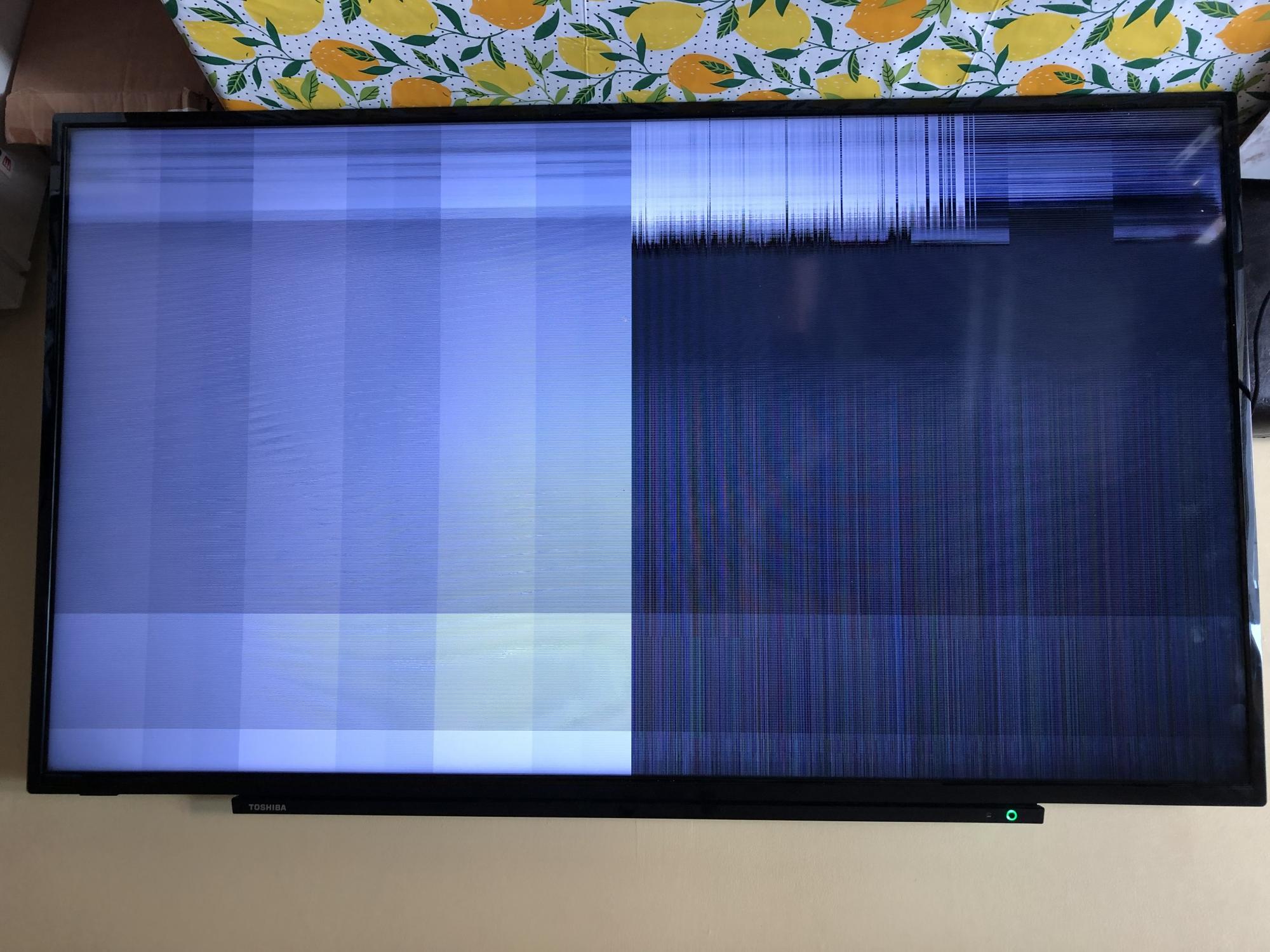

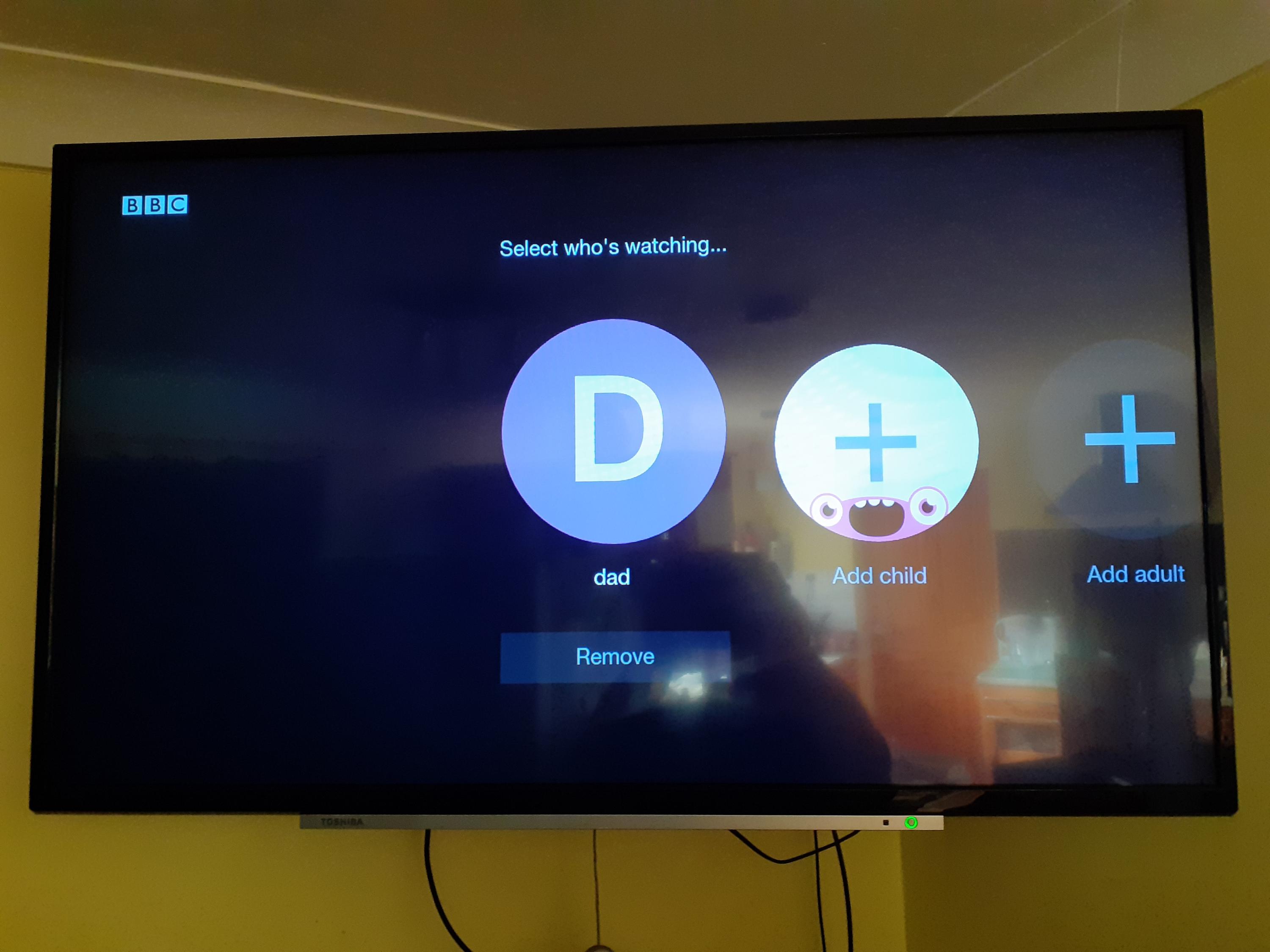

                            Most times, I get no picture when both ribbon from t-con to distributor PCB's are connected.
                            I can always get a picture on the left when the right ribbon is disconnected (pictures lacks black depth).
                            I get scrambled data on the right when the left ribbon is disconnected.
                            My first issue is getting a full picture on when both ribbons are connected.
                            That in itself may fix the "lack of depth" issue - maybe.
                            So how do I diagnose that problem with the voltages I have observed.
                            Coukd the LVDS 51 pin flat cable or the connection to the tcan or mainboard cause this issue?

                              yours picture and this one too
                              the depth wasn't Voltage you can measure.. its Freq I2C data any corrupted will cause to (cut off / unstable signal) which drive the T-CON stop working ( destroyed or No Picture & Vgl and Vgh = 0 )
                              i asked photo of the Mb and its label. i don't know why users who seek help hesitated to response for others request. i cant write full story over here to explain how things work. when i did before on other threat.
                              yours TV if its 100% discharged it will show full picture at start up while the 2 ribbon in place.
                              start with hard reset with one ribbon in order to see where you click. plug off from wall discharge and re-plug second ribbon and do the test.

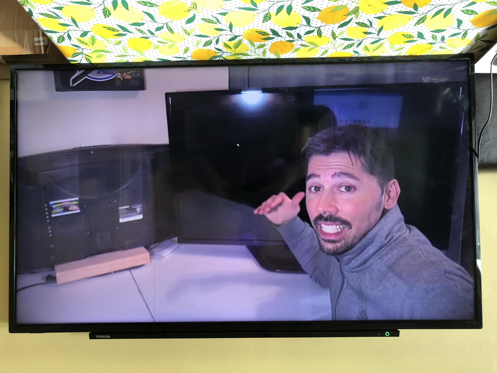

                                @diah
                                Thanks for your assistance, I do appreciate you donating your time to assist me.
                                The pictures you linked (yours picture) is the faulty tv, but I only get a picture about 1 in 20 times of switching on, almost always a blank screen with just back light glow. When there is no picture, I don't even see the Toshiba logo at startup.
                                If I start with right ribbon disconnected I always get a Toshiba logo and always get an image on the left.
                                If I start with left ribbon disconnected I never get a Toshiba logo and always get scrambled data on the right.
                                The picture (this one too) is a picture from a different tv, just to show the difference in picture colour. This tv works correctly.
                                If I understand you correctly, there is an I2C data connection from mainboard to t-con, which gives “picture data” and then from t-con to screen distribution board. I have observed a I2C chip on the t-con, with sds and scl test points, which are usually an indication of an I2C bus connection.

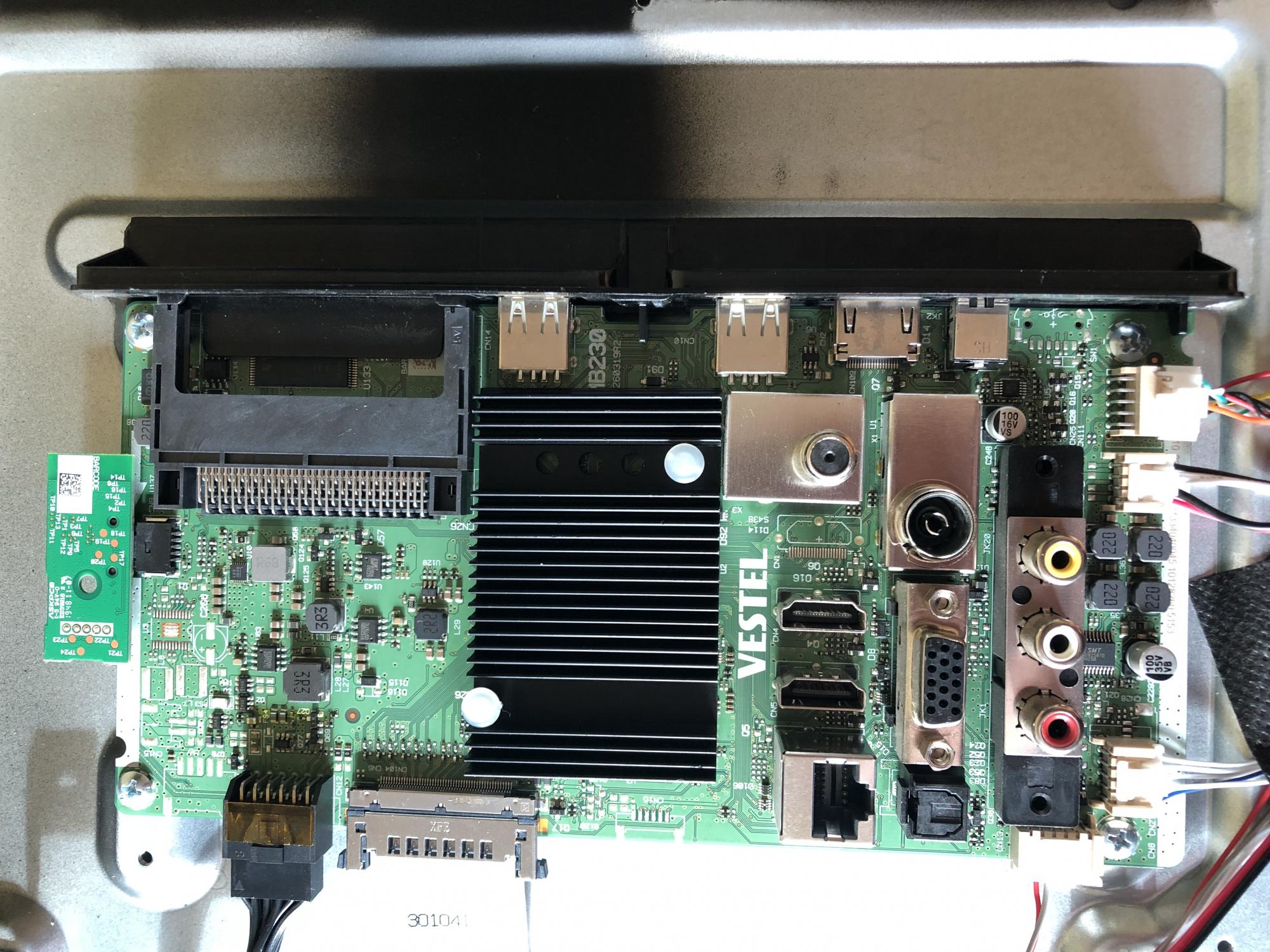

                                I have linked a picture of the component side of the mainboard (17-mb230), but the cannot get a picture of the rear just yet as the tv has been stored, but will get a picture when time allows.
                                I just wanted to try and confirm I understand what you want me to try.

                                  okay so its the funny MB from Vestel 17MB230
                                  ... since you can have picture on the left side of the screen when you disconnect one ribbon do the following
                                  while its on press Menu followed with 4-7-2-5 you will be at service menu.. shoot photo for the screen and upload here to see the panel data if it is suitable with DoVi function or not.
                                  then go down to diagnostic/diagnose and from there you can run factory reset or too self diagnose.
                                  if you had done the hard reset... and it went to standby . plug it off from wall and connect the other ribbon tell if you will be able to see the logo and full screen
