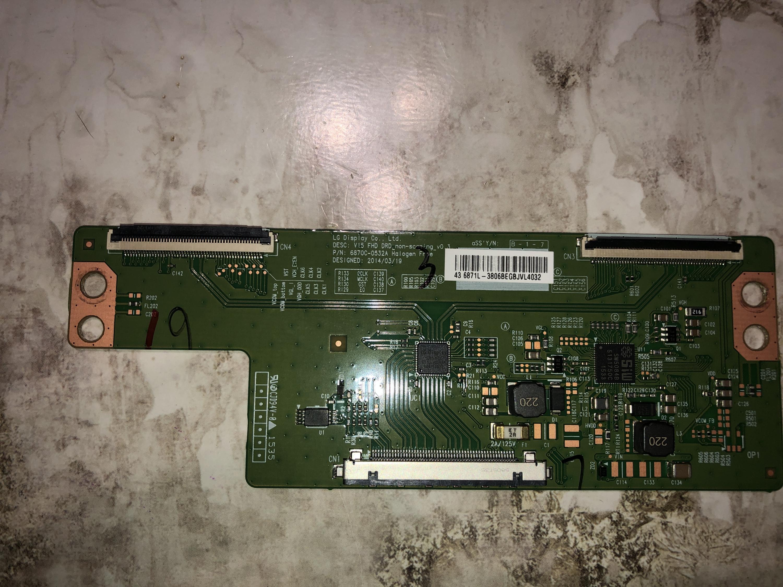

      Originally posted by Diah
      there are discharger machine which do the job, but for some one didn't have its enough if you plug it out from wall socket for 10 minuets and connect the tv chassis to real earth (GND ) point.
      how about the T-CON of the JVC do you still have it.. we may able to know which panel was on it via the 40th t-con
      Thanks for discharge information- didn't know such a device existed.
      I found a t-con, but cannot say if this is one from the JVC LT-40C880N - it is an LG t-con

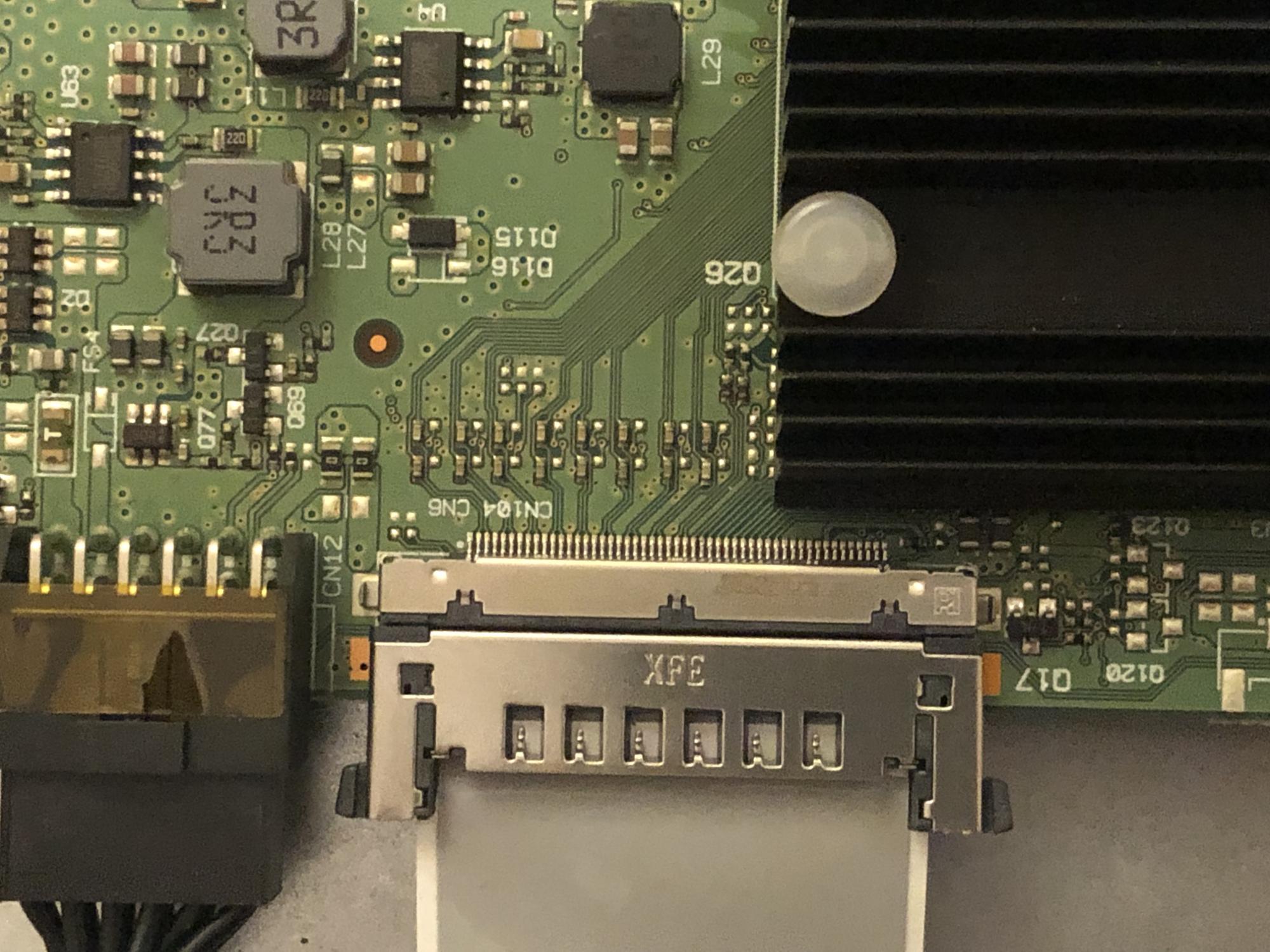

        Re: Toshiba (Vestel) 50UL2063DB - bad COF?

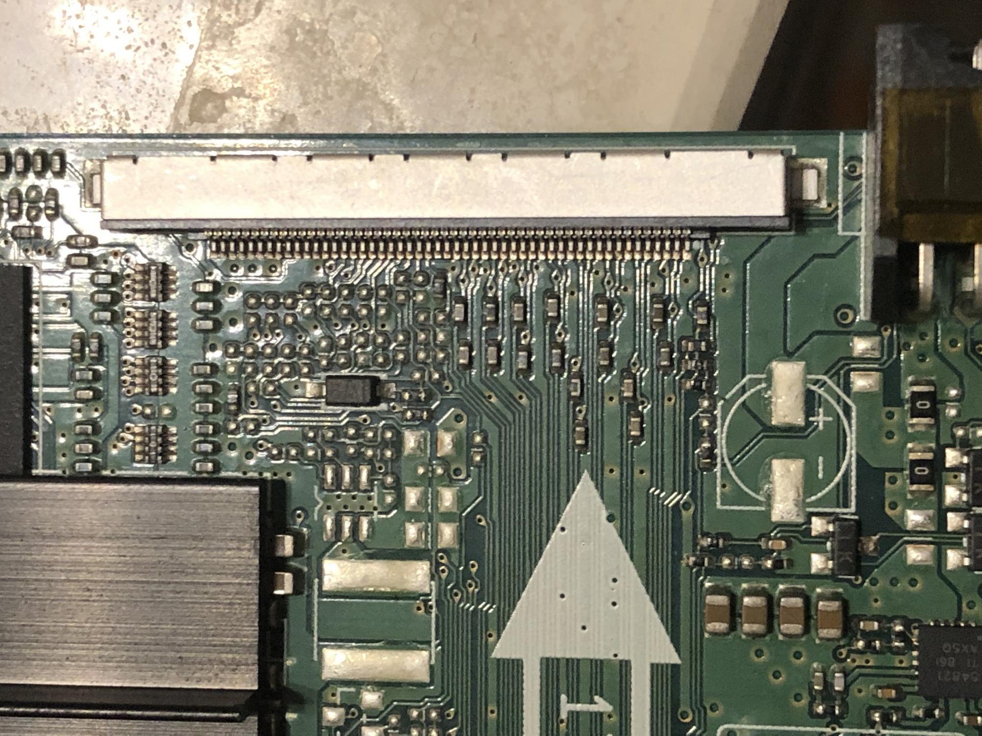

        it would be better if you upload focused clear high resolution photo on the MB LVDS socket at 130S and 230 to compare vin clk etc.
            First picture is M230, second picture is MB130

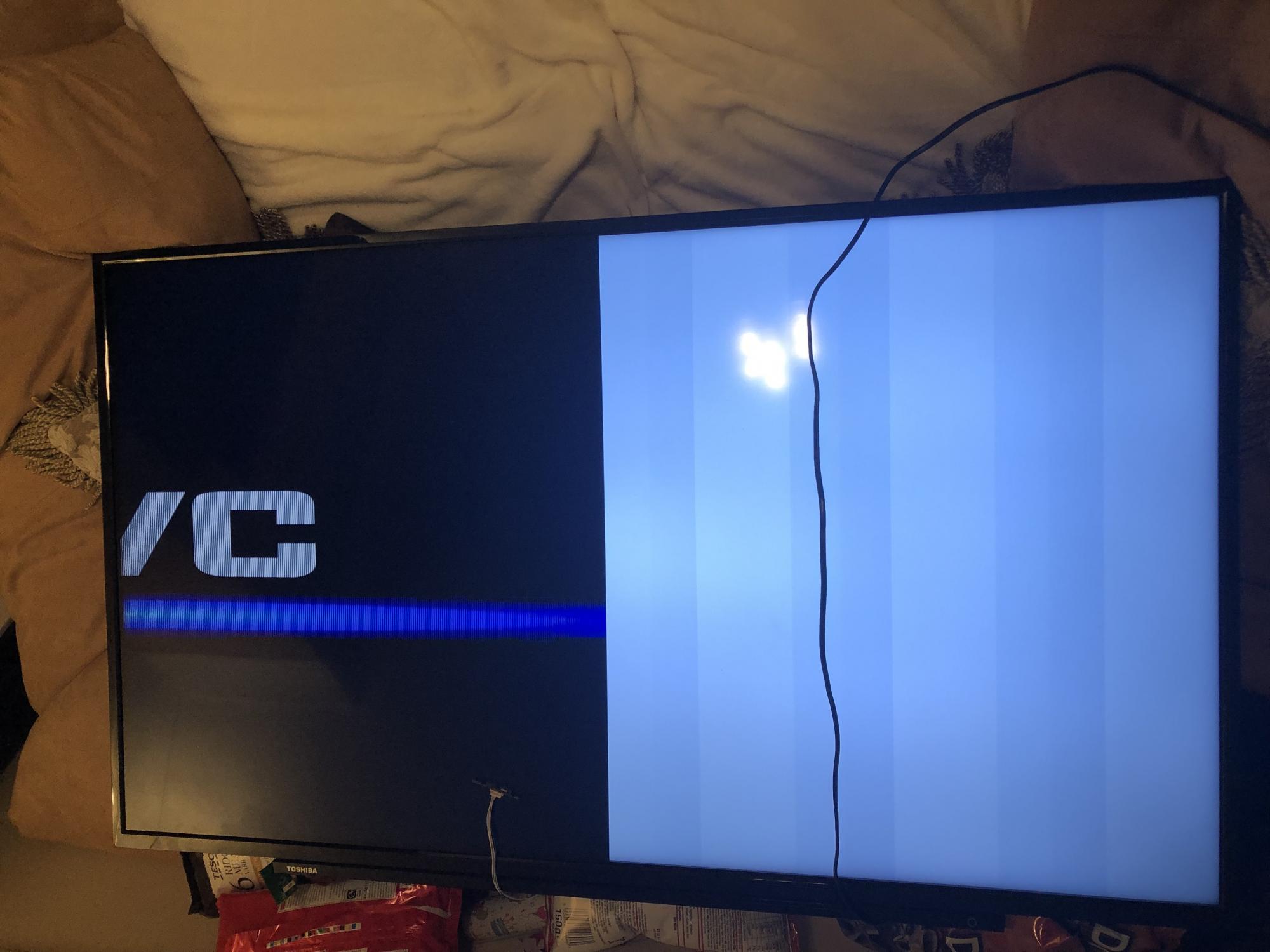

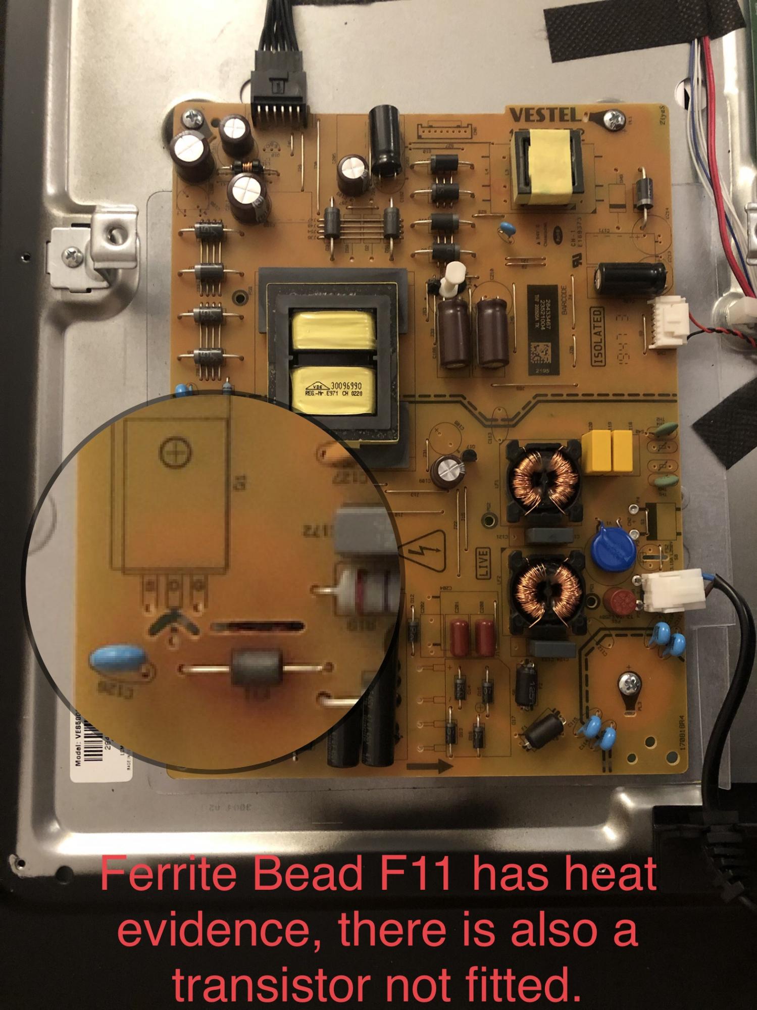

                I fitted 17MB130, using Toshiba PSU, and Toshiba t-con and JVC WiFi and IR boards, and got no picture (TV had been off for >1 hour), but backlights on.
                I disconnected right side ribbon and got a stretched image on the left, but the was for the right side of the screen. But at least I got an image! I assume this is due to software mismatches between MB and T-Con.
                Does this suggest the issue is more likely to be the panel, as the only way to consistently get an image is to disconnect the right side ribbon?

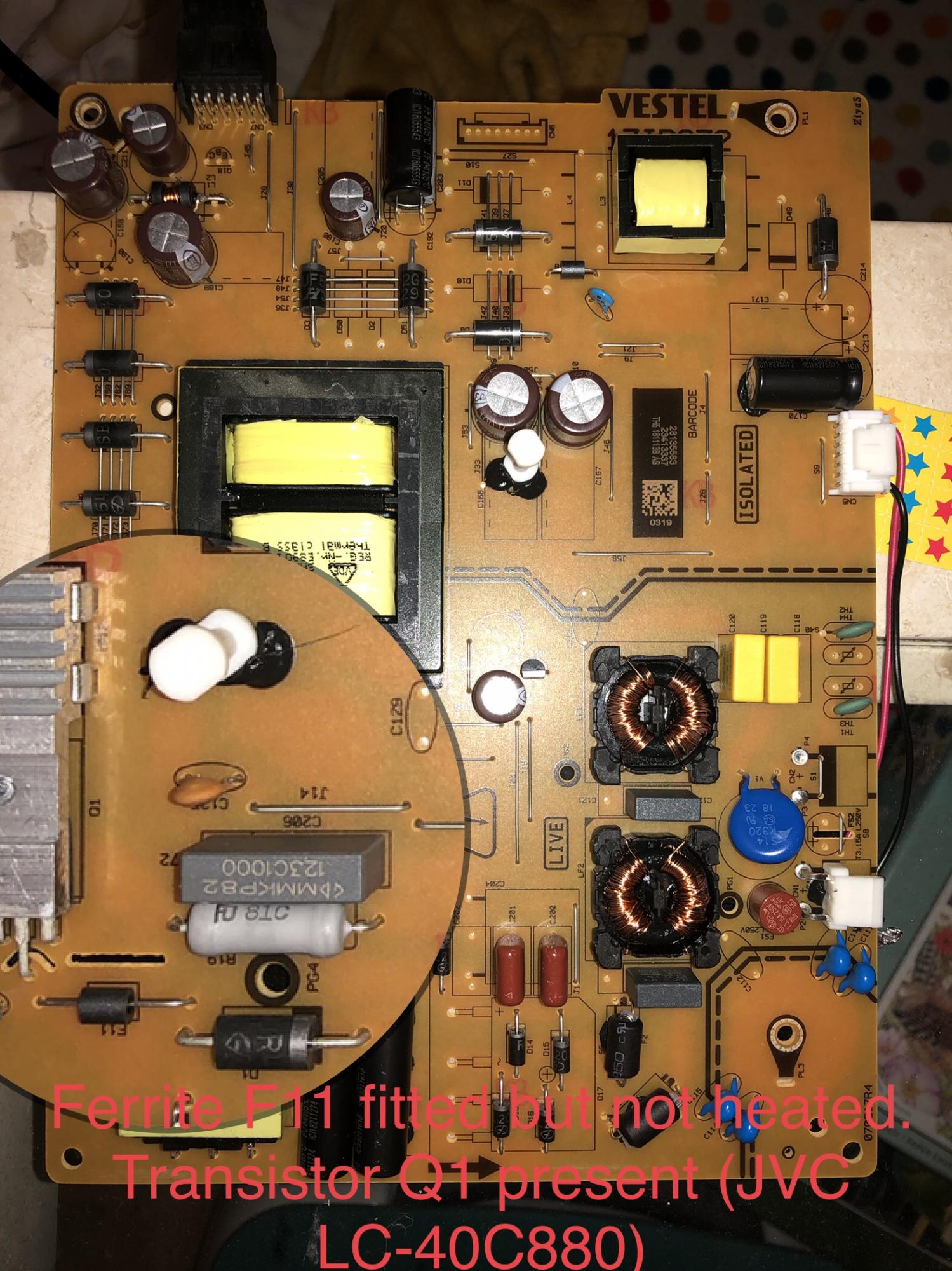

                I have noticed the ferrite bead F11 on the Toshiba PSU has heat evidence and Q1 transistor is not fitted.
                However, the same PSU type, removed from the JVC LC-40C880, has no heat evidence on Ferrite F11 and transistor Q1 is fitted.
                Could this indicate a PSU issue (not enough power available) on the Toshiba PSU, which could cause the processor on the 17MB230 to glitch the screen due to power dropping?

                  #48
                  then stop the jvc board.. put back your toshi back and update first... let see what will happen after update.

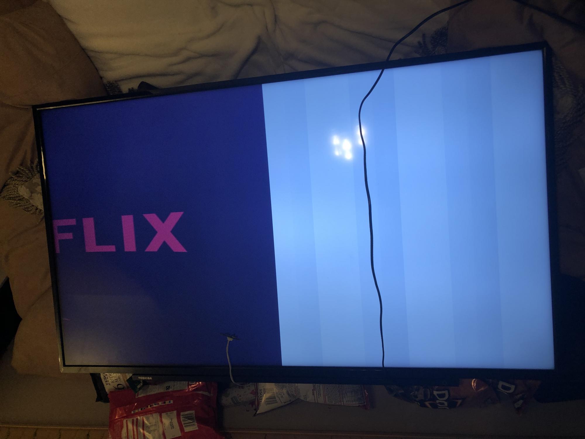

                    #49
                    but why it show first flix logo and then JVC !!!! when you put the 130S ... isn't strange
                    i would consider to put yours original t-com always

                      put the 40 PSU of JVC instate of Toshi one.... it will work only the LED BL will be little dim dosnt matter for testing
                        That is just how the pictures were uploaded. The JVC logo was shown first, while booting, then I pressed Netflix button to show a different picture.

                              So I tried the JVC PSU, and back lights trip due to more than expected LED Current (40” screen has less LED’s than 50” screen - Diah, I know you already know this, this is for others reading the thread).
                              Refitted Toshiba PSU.
                              Tomorrow: replace t-con (salvaged, believed to be good) with original t-con.
                              Then update software in 17MB230.
                              Being honest, I give the software a 10% chance of being issue.
                              For me, with no other evidence so far, I think the screen itself has an issue, maybe a damaged track (Vgl or vgh) within the glass substrate, which sometimes works, but gives lines, due to impaired switching of the gates (Pixels not switching at the right time) but other times trips vgh or Vgl (and other voltages) giving no picture, until I disconnect the right side of the screen. Or a bad COF or COF connection or even source film connection issue.
                              I think I might try isolating the Vgl and Vgh signal lines to the right side, with ribbon still connected to see if Vgl and Vgh remain good, then if vgh or Vgl are not the problem, try isolating vcom, avdd & havdd also.
                              When I can get a picture, the fact that the whole screen suffers with lines leads me to think the issue is something that is common to both halves of the screen.

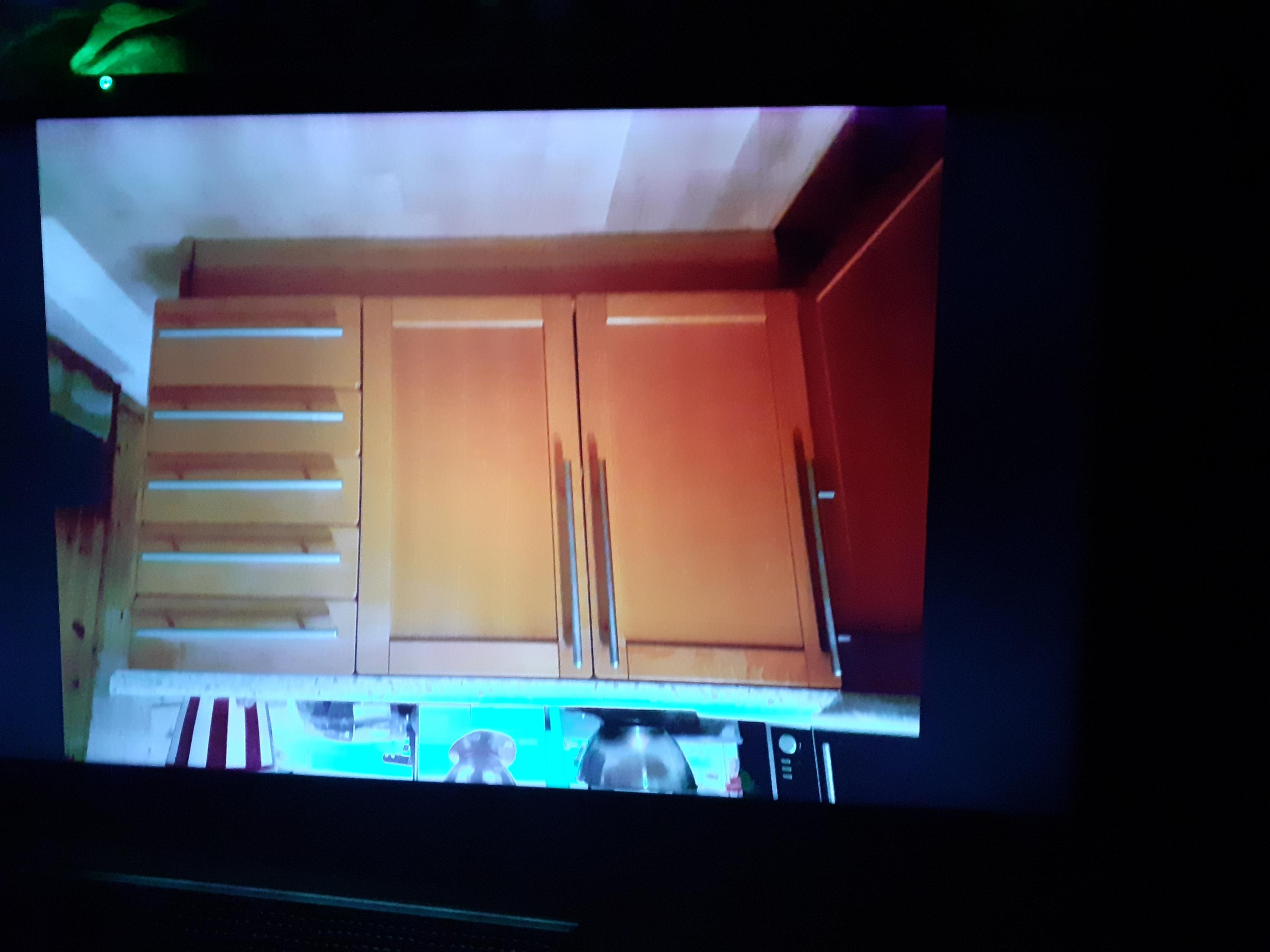

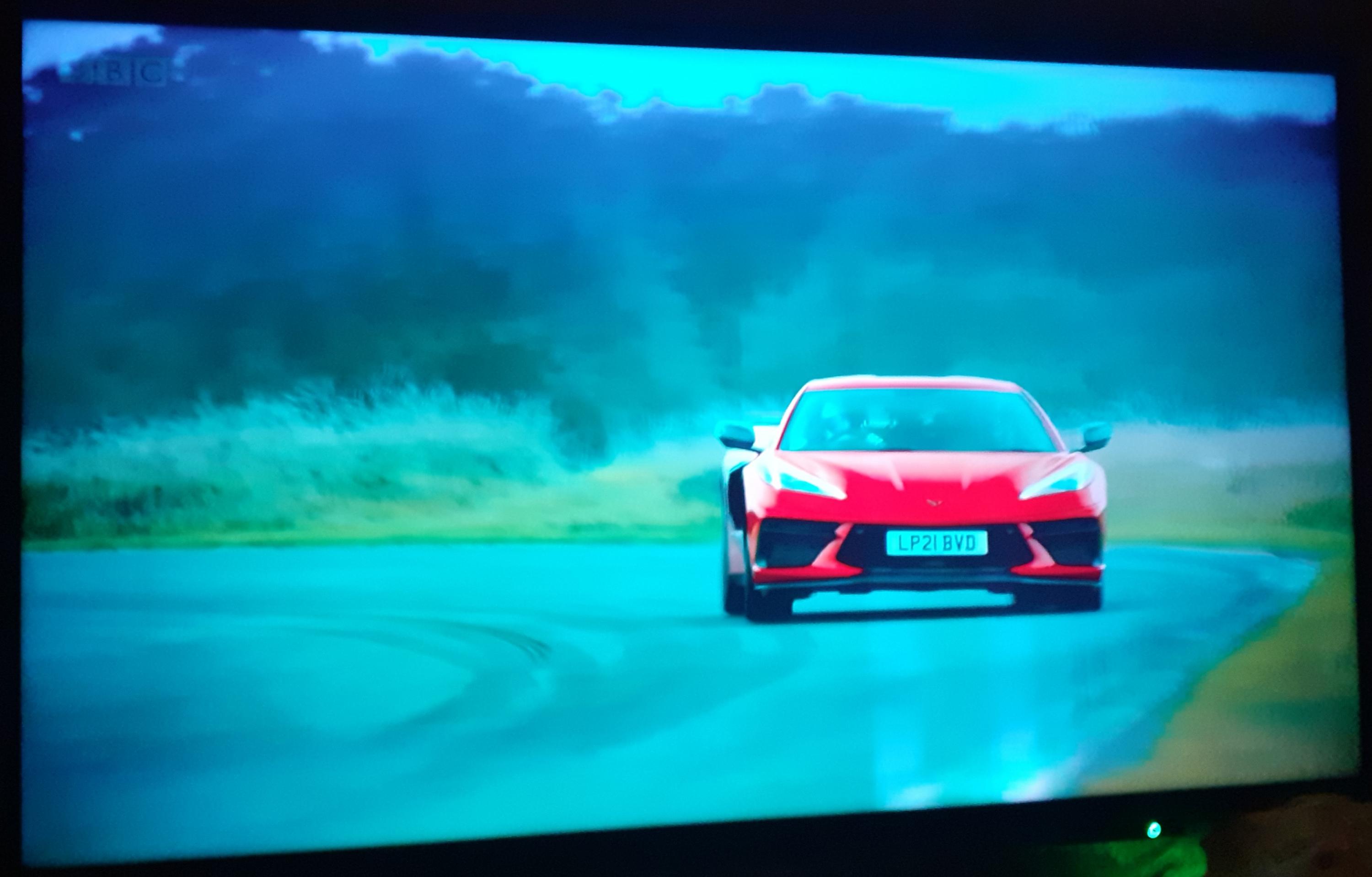

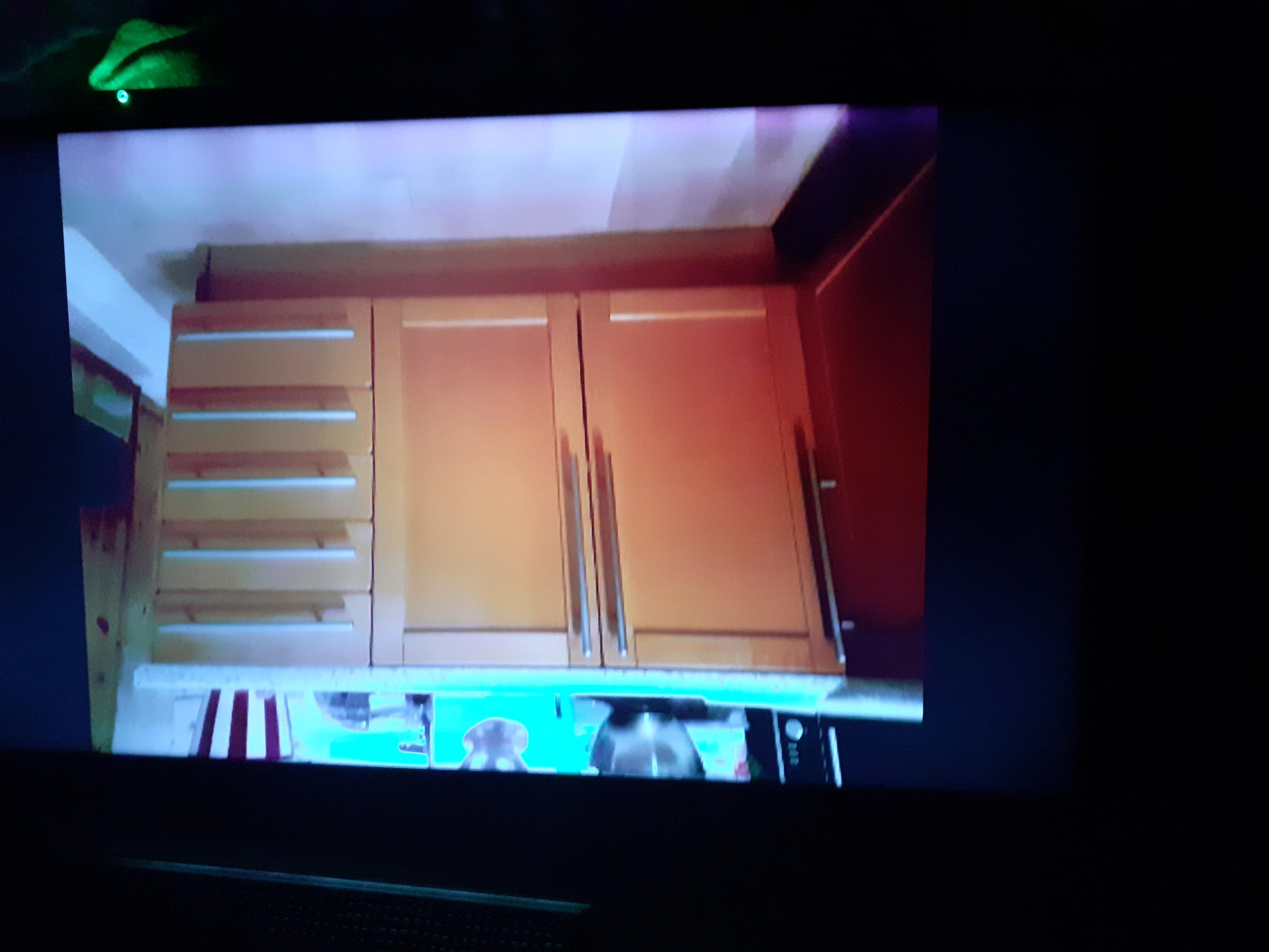

                                      @Diah
                                      I have now refitted the original T-con.
                                      I have been running the TV for 3 hours and have a full picture, but where there are white or very bright places in the picture, this causes vertical lines and "tearing" of the image - see the car picture and see the lines at the bottom of the image, which are in line with the white car licence plate.
                                      It doesn't look too bad as a still image, but as a moving image, there is some jumping of the picture and lines are more visible.
                                      I have also attached 3 pictures at different resolutions, as requested.
                                      The high resolution image was photographed, then I used windows picture re-sizer to reduce the resolution to 1080 and then again to 320x480 to give the same picture at three different resolutions, they were viewed on the TV, then I photographed all three images and uploaded them here.
                                      Hope this is of some use.......
