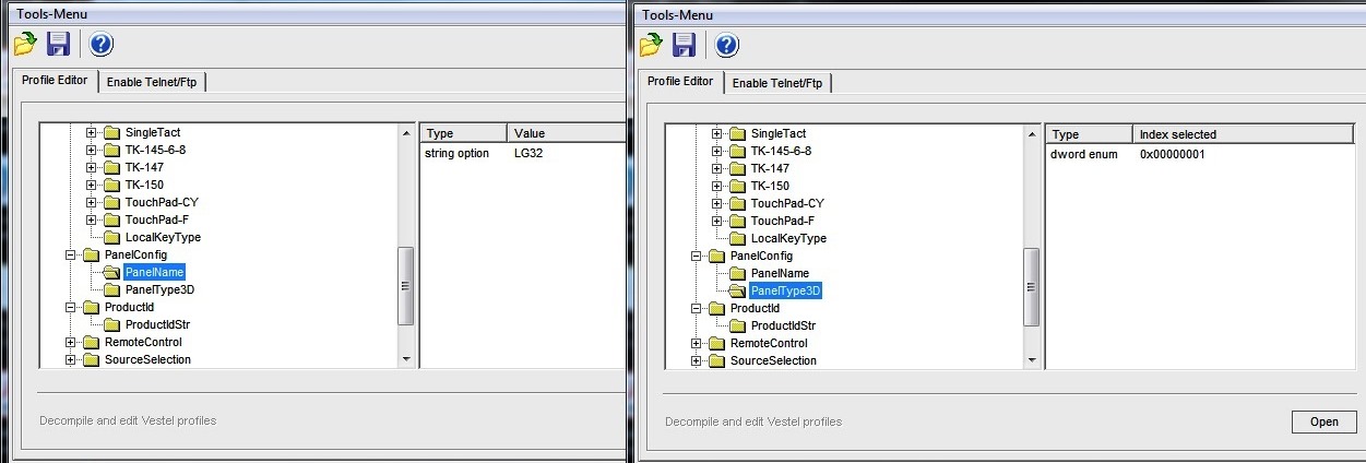

            i found on yours HW profile some things strange at pannel config i cant explain..
            it say panel are LG32 and 3D comparable
            maybe yokono or other can find file mb230_hwprofile.bin for compare or full firmware for MB230
                The 40" JVC MB130S was removed from a TV with a broken screen two years ago, and screen was recycled, so screen is not available to me anymore.
                Even though panel config is unusual, this does not prevent correct operation on some occasions.

                  then dont do it... let solve this question about panel ID... are yours toshiba 3D UHD TV?

                        not a good option.. focus on finding full recovery firmware .. masking with this condition make no sense to me.. but if you like try it..
                        by the way yours toshiba panel are LG IPS

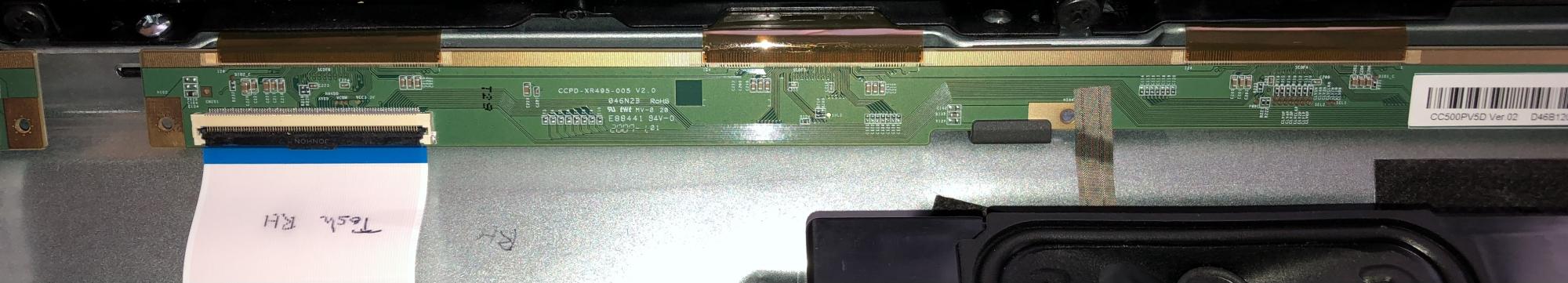

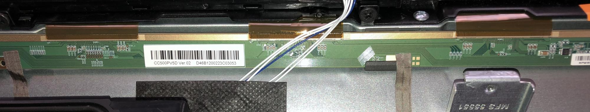

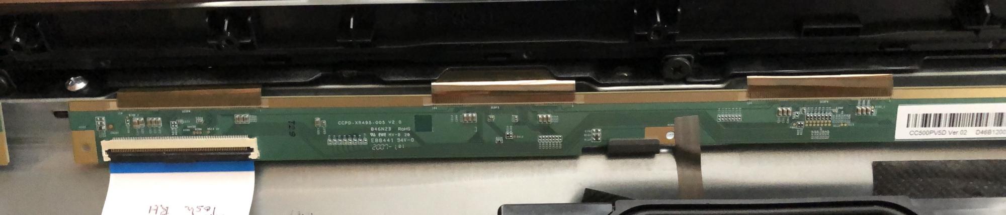

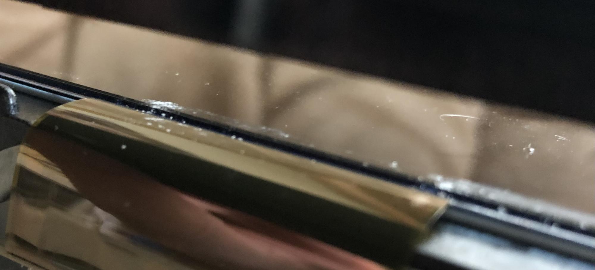

                              • Russ17
                                • Mar 2018
                                • 125
                                #95
                                Re: Toshiba (Vestel) 50UL2063DB - bad COF?
                                Thank you yokoono for the firmware, I will give it a go.

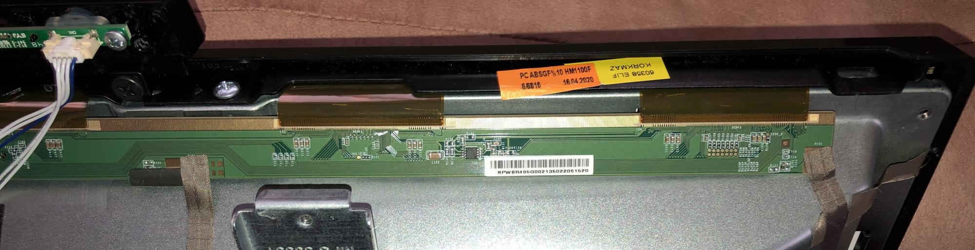

                                @Diah:I did release the lower edge of the bezel, to expose the right side COF connections to the distribution board.
                                There were some deposits (see picture) on the COF towards the centre of the screen, which is the first COF. for the right side distribution board, which I have removed with 70% IPA. All others are clean.
                                There was no improvement.
                                Something I have noticed (when I am
                                lucky enough to get a full screen) is that the dc-dc converter inductors on the tcon get really hot to touch after only a few minutes (only when a full screen is displayed) and the inductors are making a buzz sound. The picture disturbance follows the frequency of the buzzing sound also.
                                If I disconnect either left or right ribbon, the tcon operation is silent and inductors are only a bit warm, but I only get have picture shown (as expected).
                                If both ribbons are connected and I apply power to TV, after a few seconds I can hear a slight buzz of the tcon dc-dc converter, then the buzz stops and I get no picture as the tcon dc-dc system has been shut down.
                                I have had access to the buffer (distribution) boards all the time, as the lower half of the rear cover must be removed to access the tcon. The buffers boards only connect to the tcon, not to each other.
                                I have attached pictures that show the right side (problem side) buffer board
                                (all six COF are shown).
                                • Diah
                                  • Feb 2013
                                  • 6498
                                  #96
                                  its look as i thought before... so the cleaning liquid rest you found and cleaned was on this first cof flex cable close to the ribbon socket at this picture
                                  in case yes please upload very focused clear photo on the area at the buffer boards to see parts
                                  at this time dont do any for firmware.
                                  ESIT: about the load and buzzer you have on T-CON could be your IPA still not dry 100% or it went down the flex cable need to dry it with hair dryer... or because you did many time ribbon plug in and out one or more pins get moved to side or broken the tips of them need to inspect them carefully... from both side.

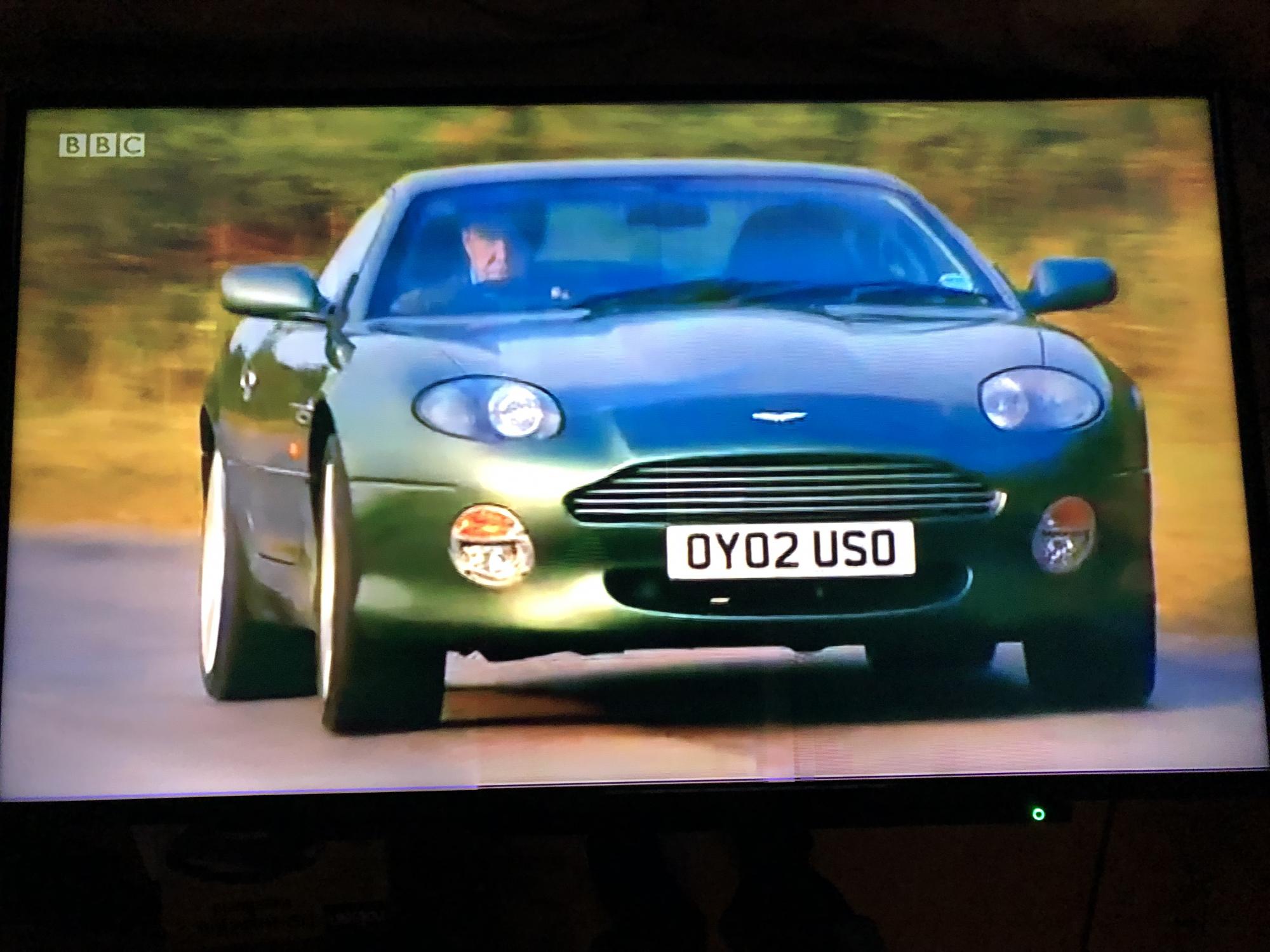

                                  • Russ17
                                    • Mar 2018
                                    • 125
                                    #97
                                    IPA evaporated before reassembly, and only small amount was used
                                    COF6 on buffer board, picture attached.
                                    I did a naughty thing - I fitted the right side ribbon, but did not close the retaining latch.
                                    I powered up, and had left side only (as expected - good quality image) and while still powered with an image showing , I closed the retaining latch for the right side - naughty I know!!. This gave a good full screen picture for about 5 minutes! So the TV is capable of providing a good picture, for short periods.
                                    Then it started having intermittent lines (see car picture - as a still image it is OK, but as a moving images, there is distortion that the camera does not show). the tv remained on, showing a picture with lines for 2 hours. I turned it off, restarted 30 minutes later - no picture and tcon power has tripped again.
                                    What can I learn from this? Could still be bad tcon when hot or a bad screen or bad MB, so really, no further forward!!

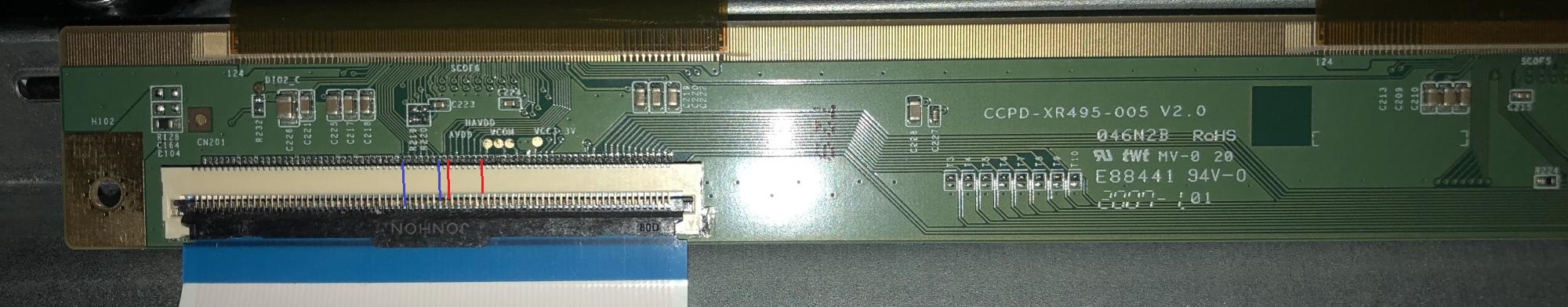

                                    • Diah
                                      • Feb 2013
                                      • 6498
                                      #98
                                      actually its belong the flex cable of this cof. didn't touch the screen glass complete and it could be there rest of that deposits went down between the screen glass and the flex cable. it could be repaired by rubber pressure apply on the area under the bezel if user don't have silicon flat pits iron used for this flex cable.
                                      alternative you can try mask one of these group at the ribbon prefer from t-con socket.
                                      • Russ17
                                        • Mar 2018
                                        • 125

                                        • Diah
                                          • Feb 2013
                                          • 6498
                                          #100
                                          Originally posted by Russ17
                                          To confirm, I should mask just ONE of the FOUR lines you have marked, and isolate them on the T-Con socket ribbon cable, using insulating tape, and not cut the tracks on the t-con or the buffer board.
                                          What do each of the four tracks do?
                                          correct, but how to explain you this four tracks what to do if there are no schematic !!! i did make remark before on post #75
