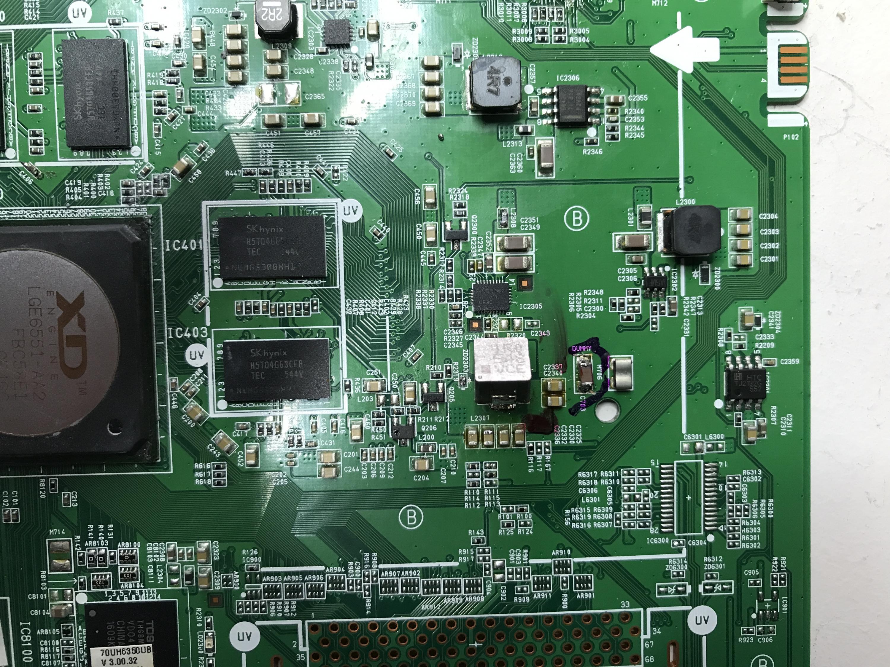

    Not sure, guess you could take out the caps closest to it, see if the cap tests good out of circuit, I would start with the biggest first, there's the freeze technique also seen lighter fluid used, have tried lighter fluid but I think freeze spray is better.

        I did some more digging around and found a coil that is shorted to ground. Not sure how to properly trace it out from here though without schematics. Coil is labeled L2307.

          If you've disconnected the coil on one side you can see which side the short is.

              I found a used mainboard for it and fixed the problem.

                  Actually I didn’t find the exact same mainboard. Very hard to find and if you do there very expensive. . I found the commercial version mainbboard used for hospitality use. It works all the same just no Wi-Fi.
                  I sold the tv to a business for digital signage use
