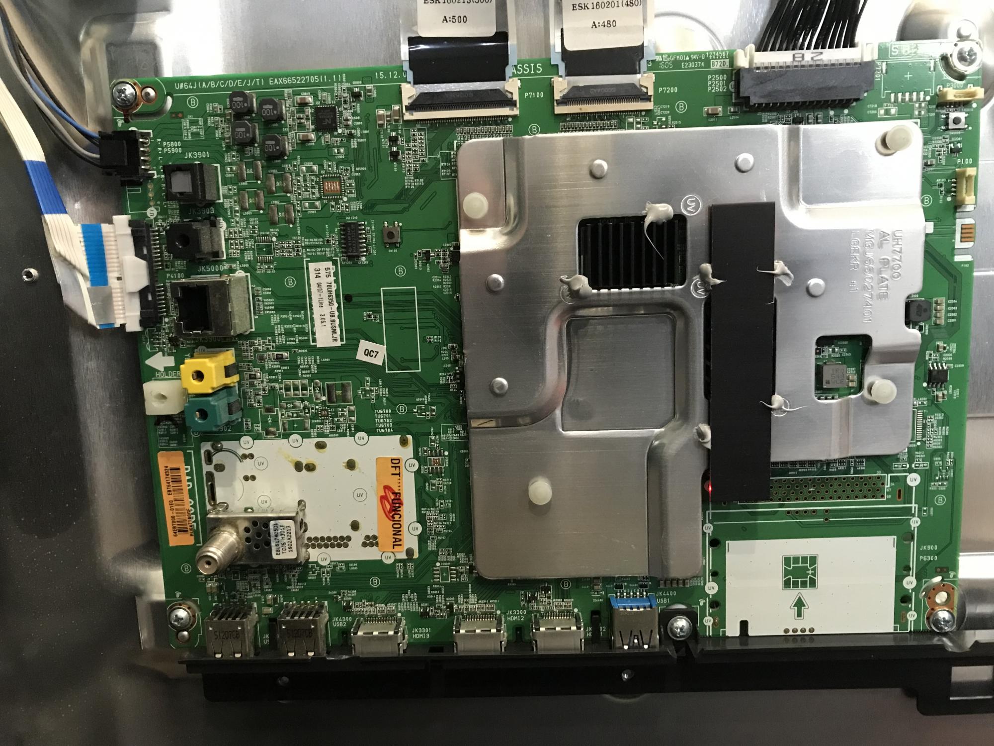

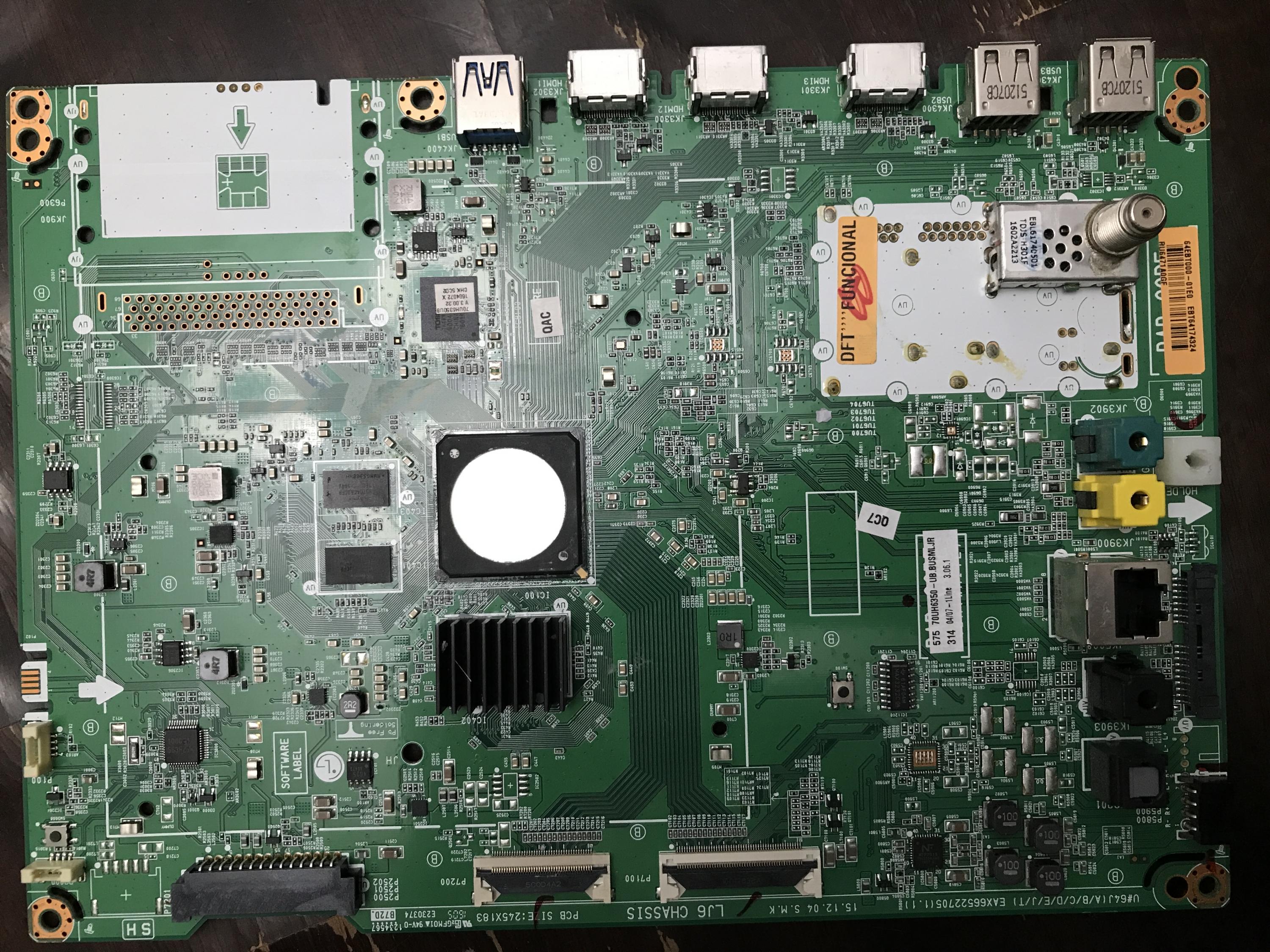

    Got this tv and tracked down the problem to the mainboard. Tv standby light shows the tv turns On but no picture or backlights. Tested backlights with backlight tester and all is working well. Also I put in another mainboard to verify and backlights turn on fine.
    Anyways I cannot find another mainboard for this TV. So I'm trying to fix the board. Any suggestions on where to start?
    Could it be the eeprom possibly?
    I don't work on many lg TVs and usually when I do it's the backlights.
    Thanks I'm advance
    Pics attached with heat sink and with it removed.

                                  I did some testing on the main board and found a lot of shorted caps. I've marked them and uploaded a phot of it. Also I found an 8 pin ic I cannot find a data sheet for that is shorted to ground on 5 of the 8 pins.
                                  It's ic101 and labeled with marking 4G25 60473
                                  I'm thinking that may be the problem but not sure.
                                  Any further help is appreciated
